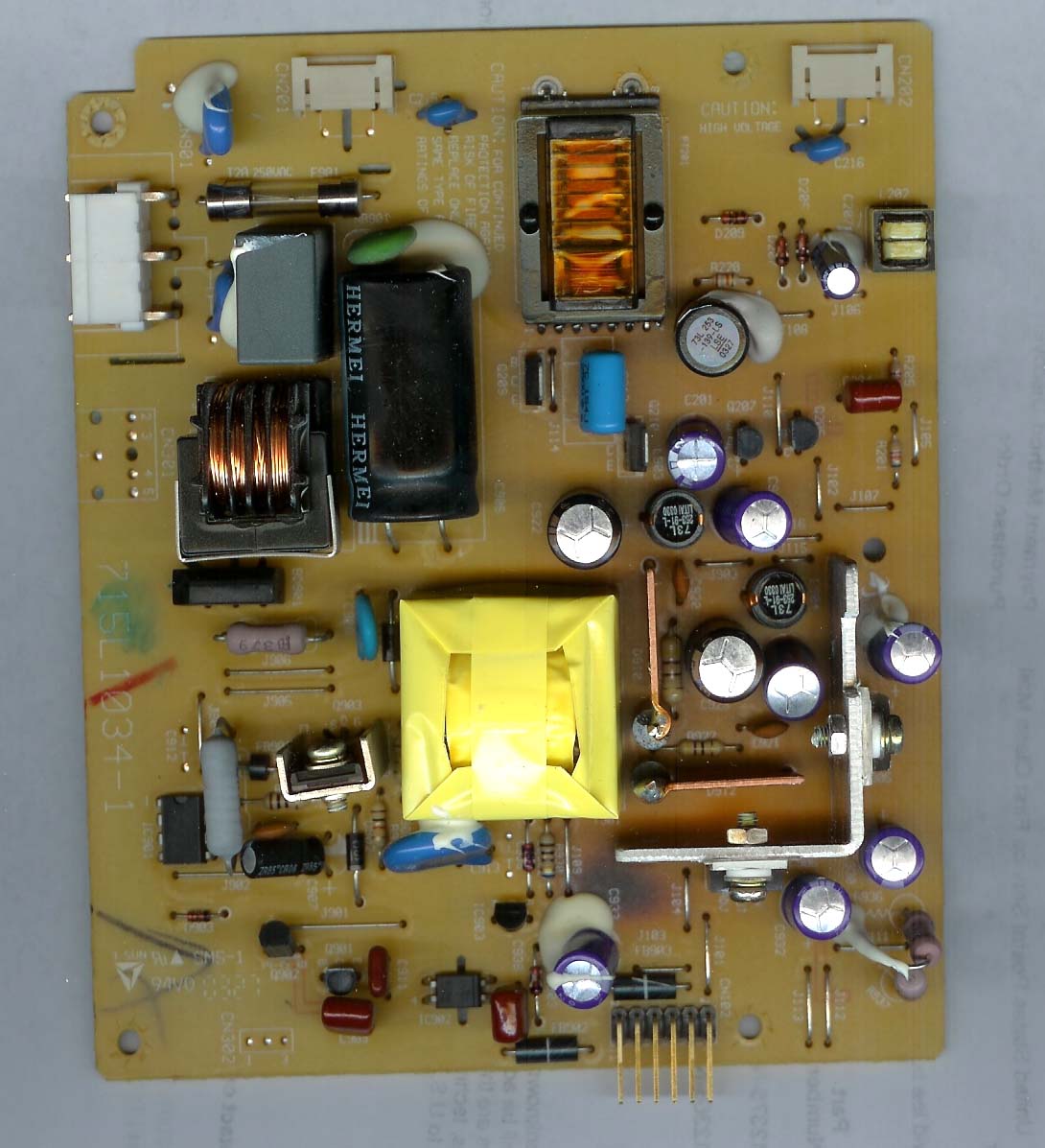

    Power Board 715L1034 in HP1502 Compaq FP15 Iyama PLE383

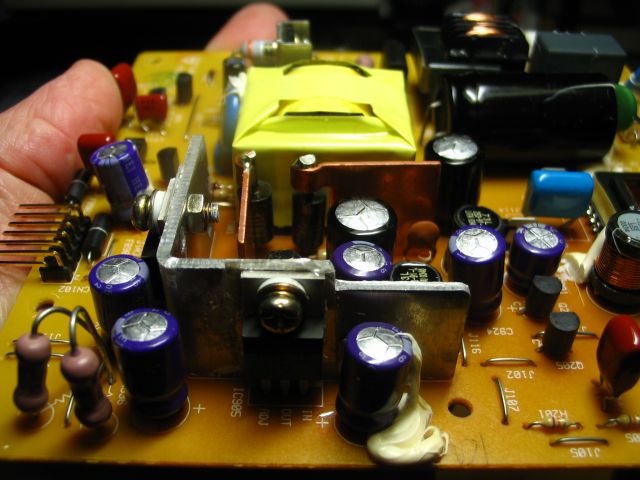

    I just repaired a Compaq 15" LCD screen Model FP15 Model Number PE1233 Product Name P9618C Manufactured in October 2003; it is similar to HP1502. This LCD monitor has 2 boards, one 'power-backlight board' reference 715L1034-1 and one 'processor board'. The 'power board' 715L1034-1 was not working properly. Main issue with the board were 7 HERMEI capacitors that had 'bulged on top and blew their gaskets at the bottom", out of the 10 capacitors on the board. I am surprised that Compaq/HP used in October 2003 caps that were questionable since 2000.
    I replaced these seven capacitors including 5 rated 470micF/16V [C926-924-929-930-930] and 2 rated 1000micF/16V [C922 & C925]. These HERMEI's are either purple or black [*C stands for degrees C]:
    - purple 470micF/16V marked LT 105*C 0326, diameter: 8.2mm & height: 12mm
    - black 1000micF/16V marked LE 105*C 0331, diameter: 10.1mm & height: 15mm.
    Due to these faulty caps, Zener diode ZD904 [7.5V, 150mW] had overheated and left a visible burned spot on the board, but it was still working. This ZD904 can be tested in circuit by connecting +12V through a serie resistor to the Zener and measuring the voltage across the Zener; should be 0.7V one way and 7.5V the other.
    After re-capping, the LCD monitor is now working.
    By the way, a decent 'Service Manual' of the power board can be found at http://www.eserviceinfo.com/index.ph...ing=vf15++fp15 but the component reference number have changed by 100 e.g. component C922 on the board will be C822 in the service manual. Hope this helps. Vince -Berkeley-
    I enclose a photograph of some of the 7 faulty caps. Good photographs of the 'power board' 715L1034-1A and another example of 'bulged capacitors' can be found in the 'allinbox' forum at http://forum.allinbox.com/aspectgee...ujet_8417_1.htm
    I believe that this "power board 715L1034-1" is used by a number of LCD monitors built circa October 2003 with potentially faulty HERMEI caps:
    - HP1502
    - Compaq FP15 & FP5315
    - Iyama PLE383
    Vince

    Re: Power Board 715L1034 in HP1502 Compaq FP15 Iyama PLE383
    welcome and thanks
    seems that crap HERMEI caps
    are used all over the place and what you got is the end result of what happens to them
    Don't know if they were victims of the bad lytic formula or were the victims of them producing crap but there is a few posts around here on them thats for sure

      LCD monitors can get rather hot inside - and poor quality capacitors inside can fail prematurely. I recommend Chemi-Con KY Series.
      • Krankshaft
        • Jan 2007
        • 2328
        Panasonic FC series from Digikey are also a good brand to use in those infernos known as LCD inverters.
        Hermei with their turtle-shell vents always seem to fail in LCDs.
        Hermei every time I hear that name I think it sounds like a new sexual disease .
        Hermei is you guessed it a Taiwanese craptacitor company the same country where the plague originated.
        I personally stick with Japanese electrolytes like those in Panasonic, Ninpon Chemi-Con, and Nichicon.
