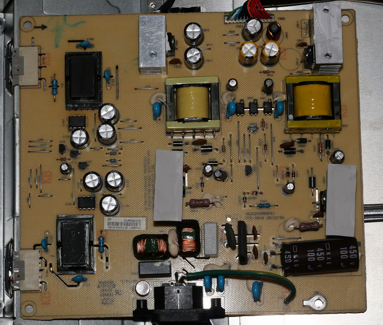

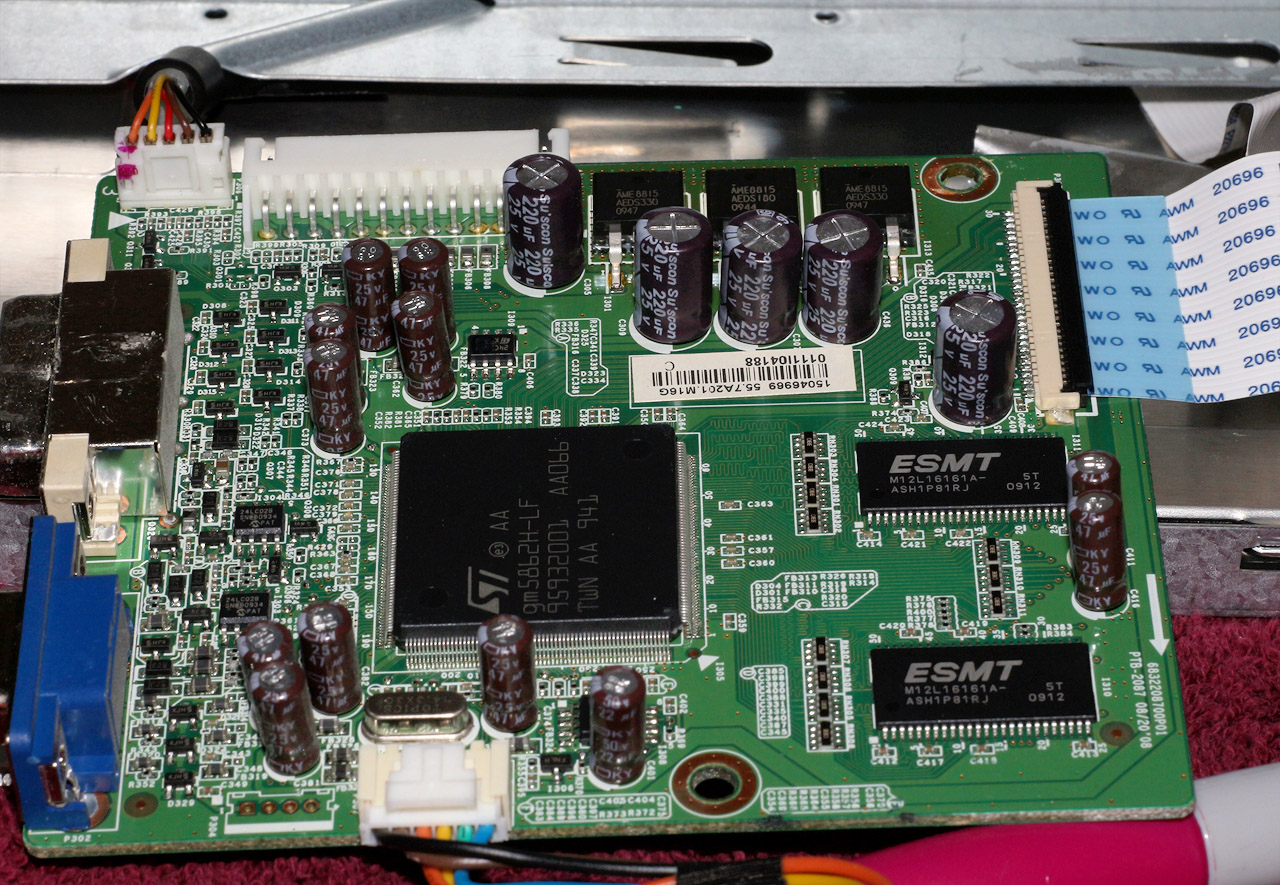

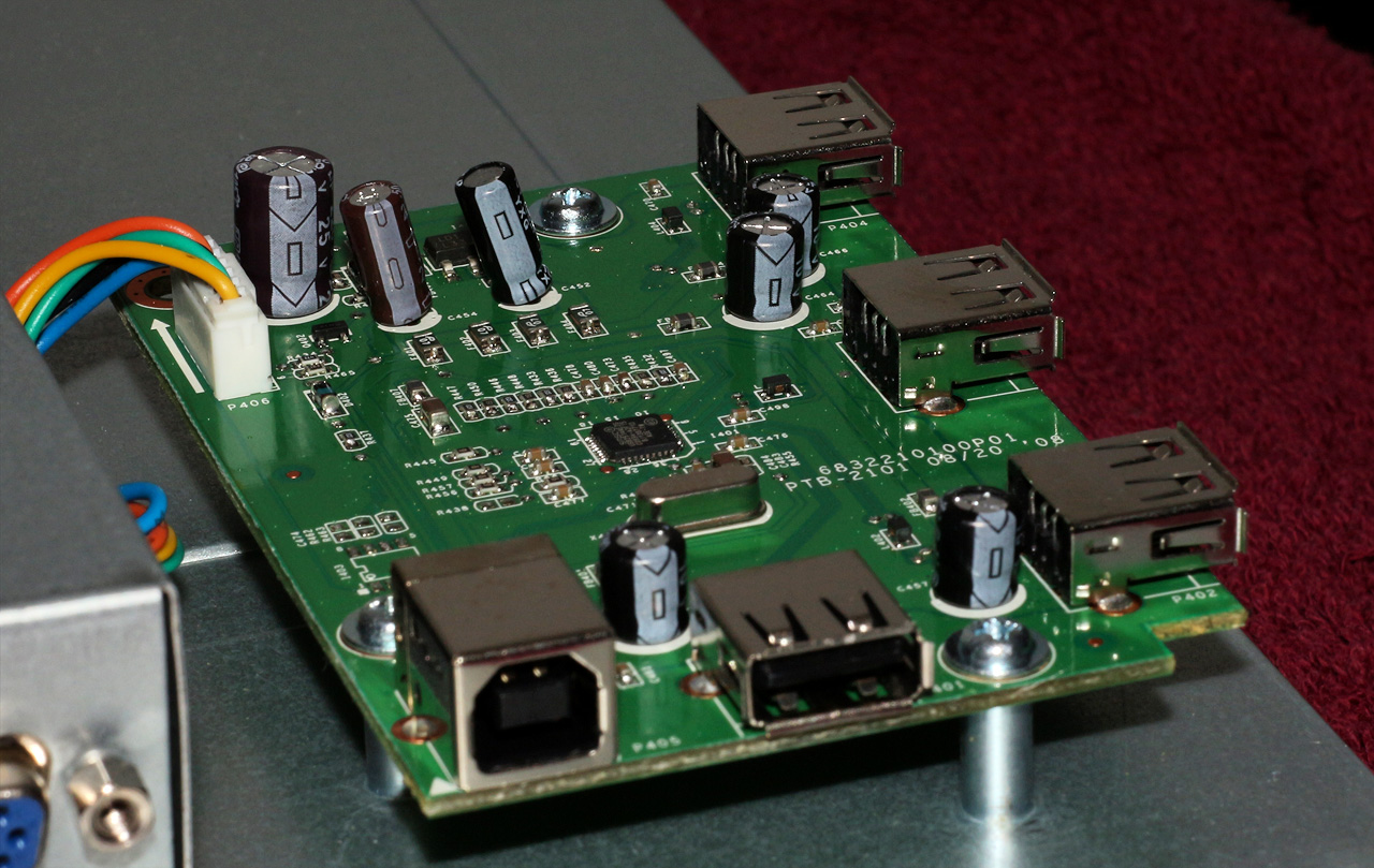

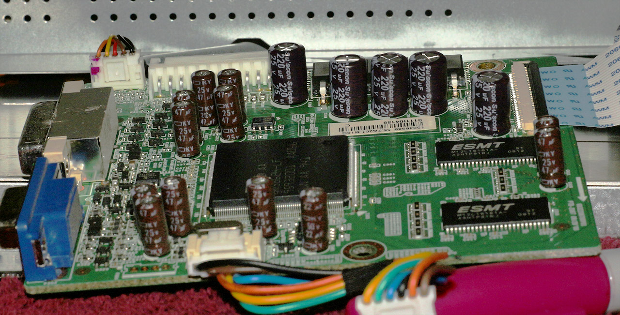

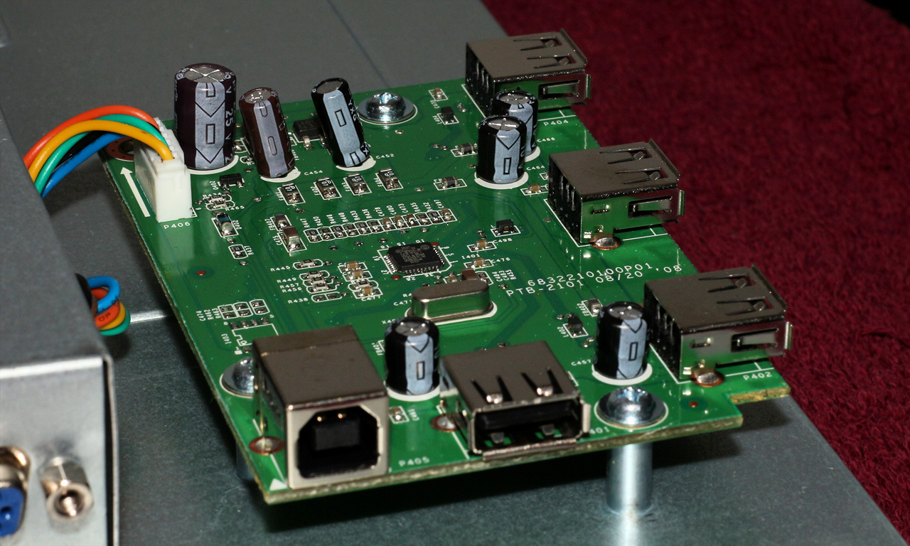

    I took a lot of pictures, looked at the caps, and they don't "look" bad, but of course, that is not always the case. The back of the boards look fine too; no burn marks that I can notice anywhere. I have attached the pictures I took.
    -Would you suggest that I just buy caps (about 15 of them) and replace all of them FIRST?
    -Or should I try and test with a CFL first, to see if the inverter circuits are working? I'm a bit confused if I need to take the bulb apart to connect the wires, or if I can connect directly to the outside of the bulb. I think if I understand correctly, I need to cut it open to connect to the "filament" connections as the voltage coming out of the connectors on the board is already converted.

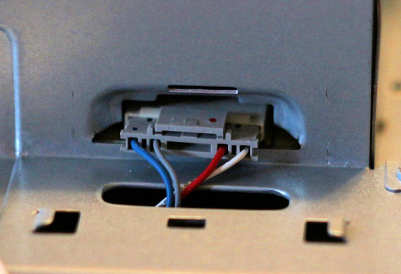

    Ok, so after reading the CFL post I decided to make one, I had a 13W bulb in one of my closets that I took apart in order to use for testing.
    This monitor has two outputs for the light tubes, they look identical. When using the bulb to test and switching power on:
    1.With the wires inserted in WHITE and RED (picture reference), the bulb lights up all the way (then off in 2sec).
    2.When I have the wires inserted in BLUE and GREY (picture reference), the bulb lights up 1/3 of the way and it making an "arcing" noise.

      Re: Lenovo L2440pwC "2secs to black"
      No, it's not normal. That's why when you plugged the test bulb into the White and Red, you still had 2 seconds to black. The bad bulbs were still in play. Sounds to me like you have either a bad connection, or bad bulb(s) on the Blue and Grey wires. You tested this problem perfectly. You'll need to tear it apart and check out those bulbs and connections on the Blue and Grey wires.
        On 2nd thought. Here's what normally happens when you use test bulbs. When you plug the connector from the good bulbs to the test lamp it will still go out after 2 seconds because the bad bulbs are being used on the other wires. When you connect the test bulbs to the connector with the bad bulbs, it should light up and stay lit, because the bad bulbs are out of the circuit. You mean the test bulb lit up 1/3rd and made arcing noises? In that case it might be the inverter.

          Thanks for the feedback. I will explain in a bit more detail what I did.
          The picture in my second post is the output to the monitor bulbs. There are two of these connectors on the board (can be seen here, left side https://www.badcaps.net/forum/attach...7&d=1442080380)
          I unplugged the monitor bulbs from these connectors. I'm not sure what the colors of these plugs mean, blue+gray, and white+red.
          I used a 13W CFL with a tail, and plugged it in each pair:
          Connector 1:
          B+G
          W+R
          Connector 2:
          B+G
          W+R
          So 4 tests, each time, I would power cycle.
          Same thing exhibited, 2sec to black, the only difference being when the bulb was plugged into W+R, it would "fully light up", while plugged into B+G it would be lit up 1/3 of the way (of W+R) and make this popping/arcing noise.
