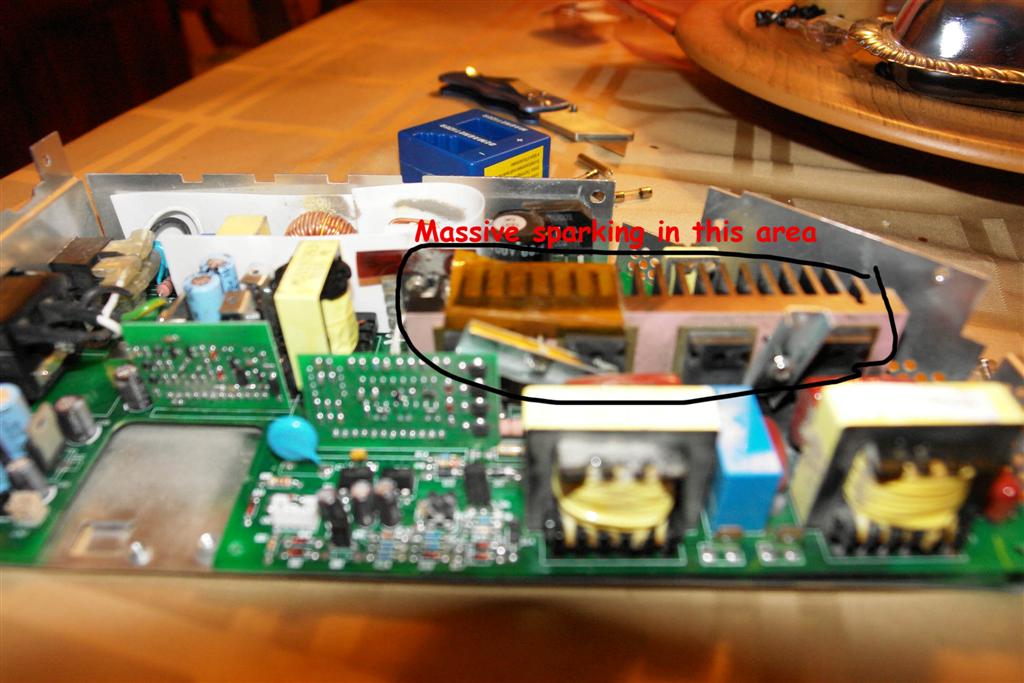

    dukane optoma
    Ok guys have another problem no this time it isn't user stupidity
    while teaching today my fathers projector blew the fuse so I changed the fuse it blew the new one so i removed the internal power supply from the unit and and hooked it up and it blows every fuse that is installed it appears that it is a voltage regulator on the psu board I have incuded a couple of images and i will take some better photos when my good camera is done charging

    Re: dukane optoma
    They look like rectifiers or MOSFETs.
    One at a time, remove a burnt-out component attached to the heatsink, and note its location and markings on the component.
    It would be helpful if you have the model number for the projector.
    • shadow
      • Feb 2007
      • 732
      Re: dukane optoma
      The components that are 'sparking' seem to be MOSFET's. These components tend to fail short. That is that when they fail, most of the time the connections are shorted together. You can do a quick test to see this is the case with a multimeter. It is advisable to take the components out before testing, however I am not sure if it is absolutely critical. If the MOSFET's are shorted, then any fuse will blow because excessive current would flow.
      The next question is has anything else failed due to the failed MOSFET's?

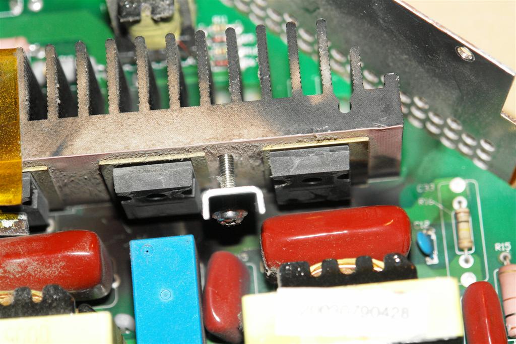

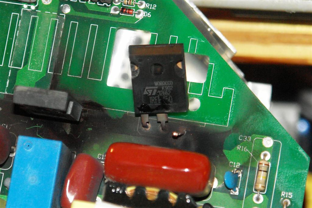

              Re: dukane optoma
              here is the image

                  Re: dukane optoma
                  Your picture definitely confirms that these are MOSFETs, see the IRF number as the part number. The other device to the left appears to have black on the PCB.
                  Clearly a very heavy current has caused the lead to burn out. This is usualy protect by the fuse. If the fuse has been upgraded this protecion is lost and the lead burns up.
                  You will need to replace both MOSFETs and clean up the PCB because the black is conductive. Check for any other affected components.
                  When replacing always check that the device is completely isolated from the heatsink with the insulator using an ohmmeter on the high resistance range, replace the insulator if there is a risk.
                  Check the soldered joints and PCB track to the transformer that is part of that circuit.

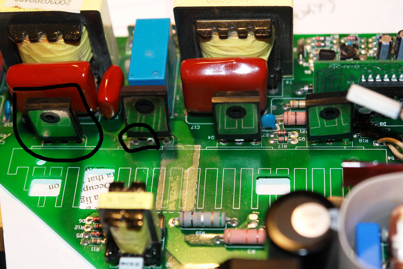

                    should I go ahead and replace all 4 mosfets or ust the those 2 and what is the best way to clean up the board?
                    • japlytic
                      • Oct 2005
                      • 2086
                      Re: dukane optoma
                      Use metho to clean up the board and replace all four MOSFETS (all four look like they have blown). The MOSFETs are IRFP450 - 500V 14A, with an ON resistance of 0.33 ohms - rds(ON) is 0.33 ohms.
                      You should also check the components connected to the MOSFETs too.
                      • davmax
                        • Dec 2005
                        • 899
                        Re: dukane optoma
                        I am unable to see that the second pair of MOSFETs is blown. Clearly the two that are visible need changing. As these are two seperate circuits, two devices to each transformer, the others do not need changing unless they are blown.
