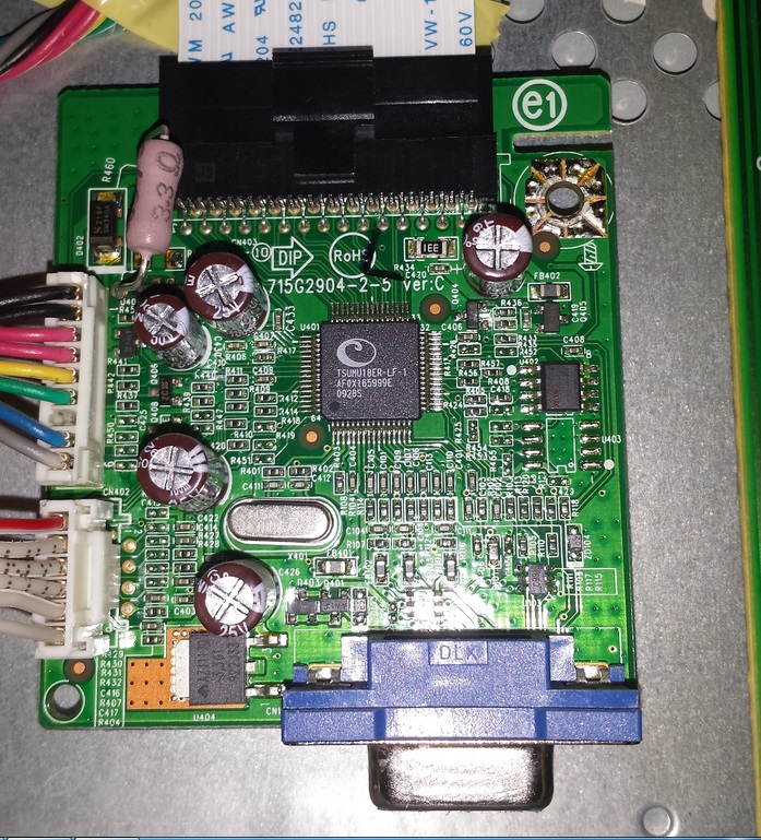

    I have had this monitor for a good few years but am getting this banding problem only when a certain shade of blue (usually sky blue) is displayed on screen. The banding can often cover half or the whole screen, depending on how much of the culprit blue colour is on there. I have taken a video of the problem and also taken pictures of the monitors caps.
    The video can explain the problem a lot better than I can..

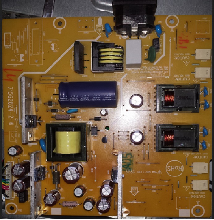

    As you can see.. crappy "Elite" brand caps.. but they don't look bad to me. and the large 450v cap just says "PET" on it. Never heard of them either.
    So I am wondering if any other components are causing the problem? Maybe the 2 transformers in the last pic?
    Help would very much be appreciated. I would like to try repair this monitor soon, as my brand new one has to be sent back for ghosting.. so hopefully can get a quick fix.
    I figured out if I were to replace all of those "Elite" caps with Panasonic ones from ebay.. it would cost me about £8.

                    Ok i've seen the video by downloading.. have you tested your pc/video card with another monitor? If it's the monitor then probably a tab bond issue, must to check the flat flexible connection tabs on the top of the screen, you have to dismonut the lcd panel metal frame, touch those FPC(tabs) when displayed a picture to see if it changes, it's an hard work..

                        Ah definitely not my graphics card.. If it was that easy I wouldn't have opened the monitor up hehe. It's definitely the monitor. my new monitor looks fine with that card apart from some ghosting which I'm sending it back for.
                        It started off just horizontal banding last year but now just a handful of the right shade of blue pixels causes what you see in the video.
                        I will try to see what you mean about the tabs Davi.P when I get home later. Cheers guys!!

                          When you open up the mon. first of all test power board outputs, compare with pcb markings if present if not find out the service manual.

                              Ok will try this with my multimeter. Cheers!

                                OK - here is a much more technical idea
                                Carefully remove the flat ribbon - both ends ( unless the screen end is not detachable and rub across the contacts with a pencil eraser.
                                While you are testing the voltage output on the power supply please also test the voltage reg on the main board U404?. Also the voltage at each end of the diode D402 top left in your picture near the big resistor. Also the voltage both ends on the black resistor R434 marked IEE. All with respect to ground on that board.
                                By the way does the problem show on a static picture - game shots are not the best.
                                Pics of power supply and main attached
