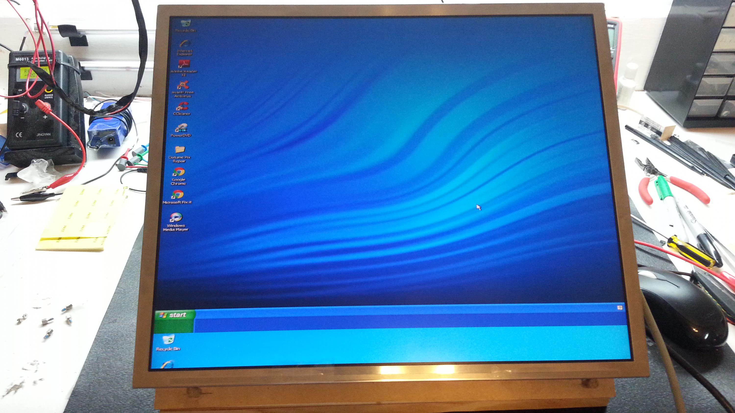

    Hello all
    I have a al 1916w with an 3"bar on the bottom duplicating the top of screen
    power supply caps tested good on a ESR meter, mainboard had 1 bad 4.7uf 50v cap replaced it. I also tried another LVDS cable and two other test screens
    same problem I assume it's the mainboard or that I am not using a wide screen for testing. original screen was cracked and not working.

    That look weird - is the panel you are using really tall and narrow? or is the picture of it distorted?
    Can you adjust anything on the pc to get it to fit?
    What is the end result you are aiming for?

      No I screwed up on the resolution uploading image
      what I want to do is make sure this mainboard, power supply is working ok
      so I can sell them for parts.

        Well that looks better but I dont know why it displays like that as you suggest may be because its not a W panel.
        Did you try changing resolution / dpi/ refresh rate on the PC?

          Just tried playing with resolution refresh rate, dpi same problem
          I am going to hold of one selling them until I get a wide screen
          thanks sell door.
