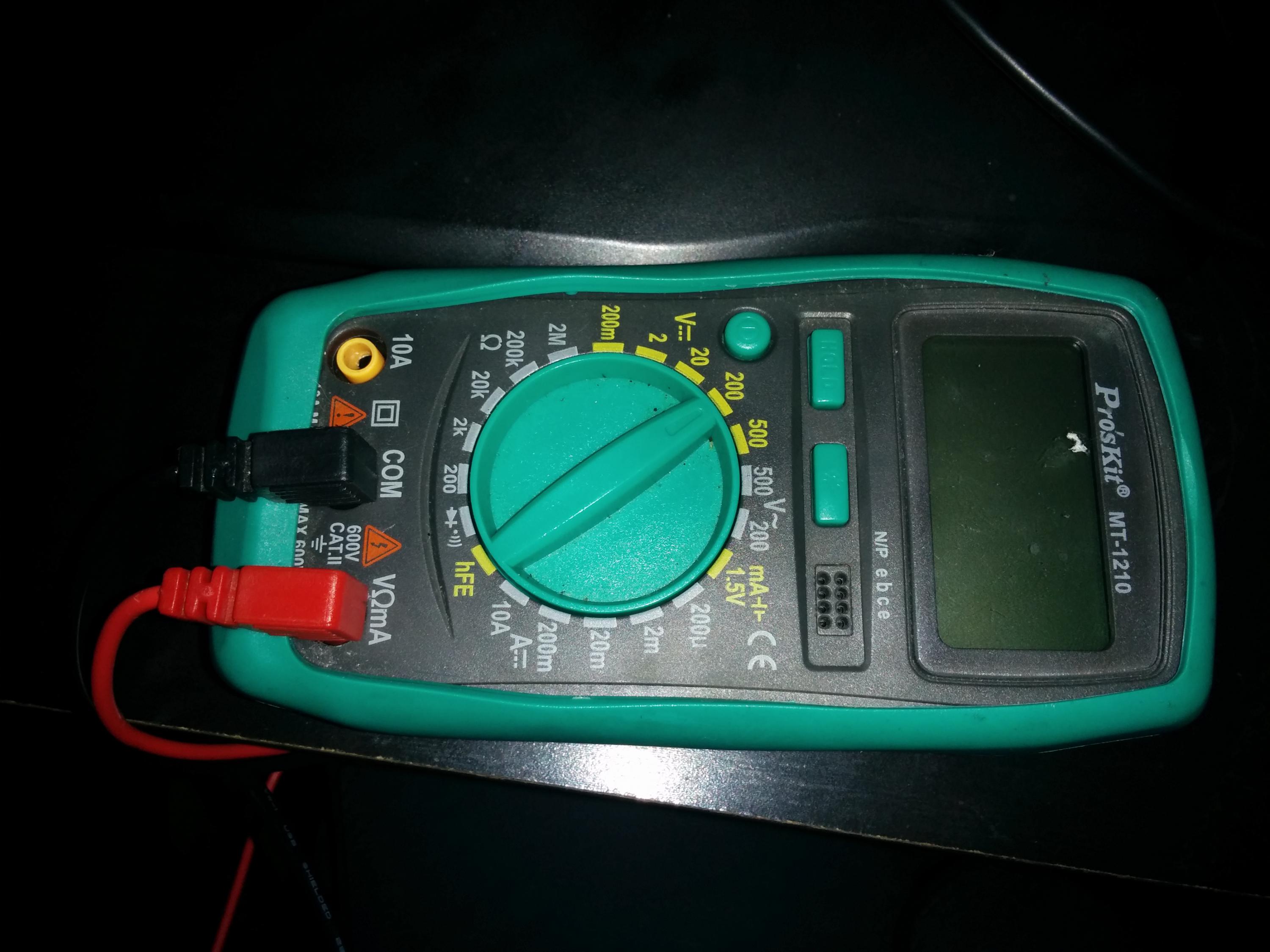

    OK You HAVE to have a voltage on the big cap else it would never work
    Please try again meter on vDC600 put one prob to each leg of cap.
    CARE high voltage.
    The little cap I think is the start up cap and that again should always have some voltage - Perhaps re solder it and try - need the main board connected for that.
    Still need a picture of the bottom of the board.
      Re: Samsung SyncMaster 2253LW - Flashes
      my meter doesnt have dc 600 option
        whats the maximum dc voltage your meter goes up too can you post a picture of your meter so we can see what ur using?
          This is the one. The big cap does output voltage. All of them do except that one I mentioned. Is there any voltage number I should be looking for
            Yellow V500 for the big cap - answer should be your mains voltage x 1.41
