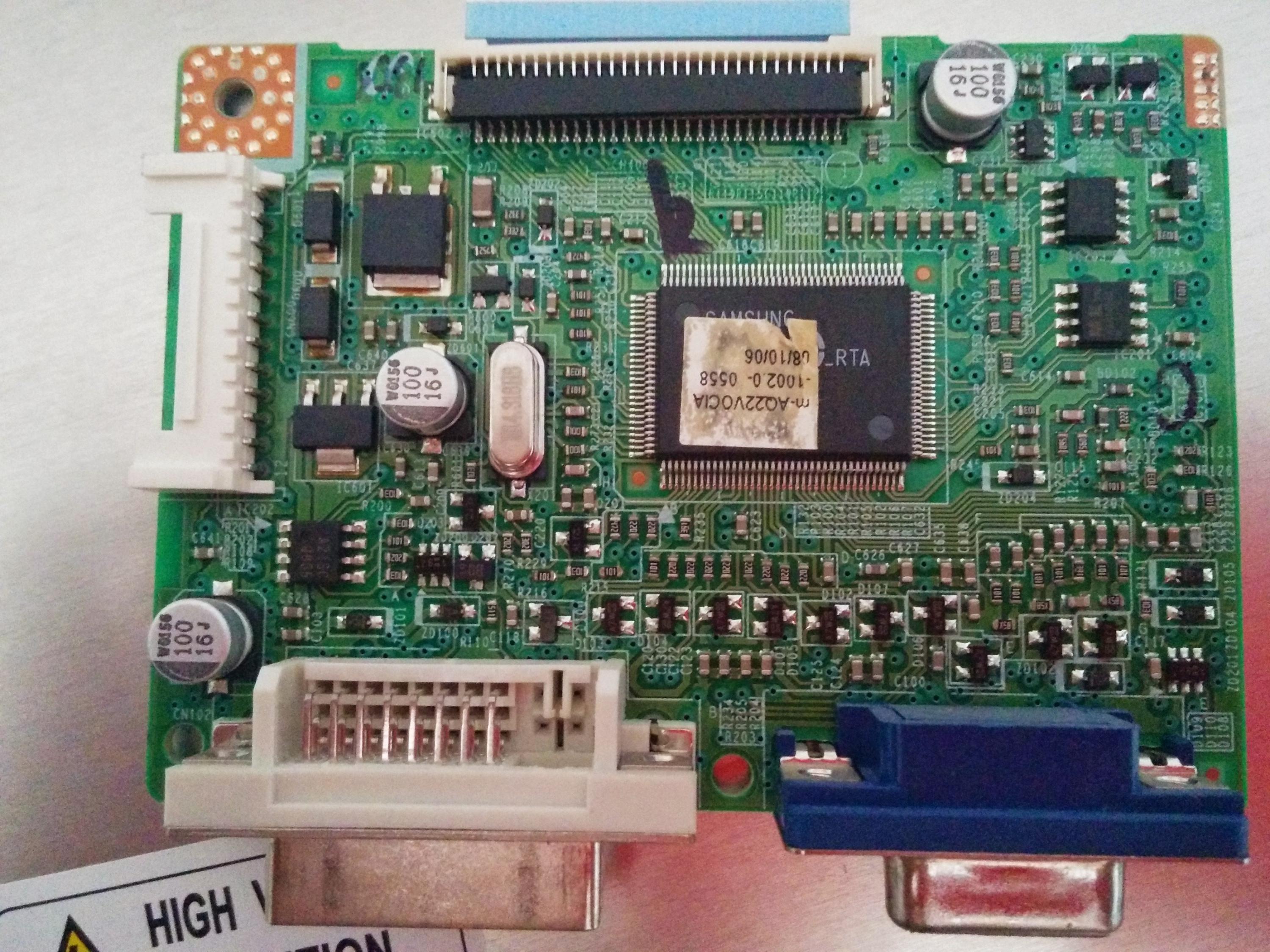

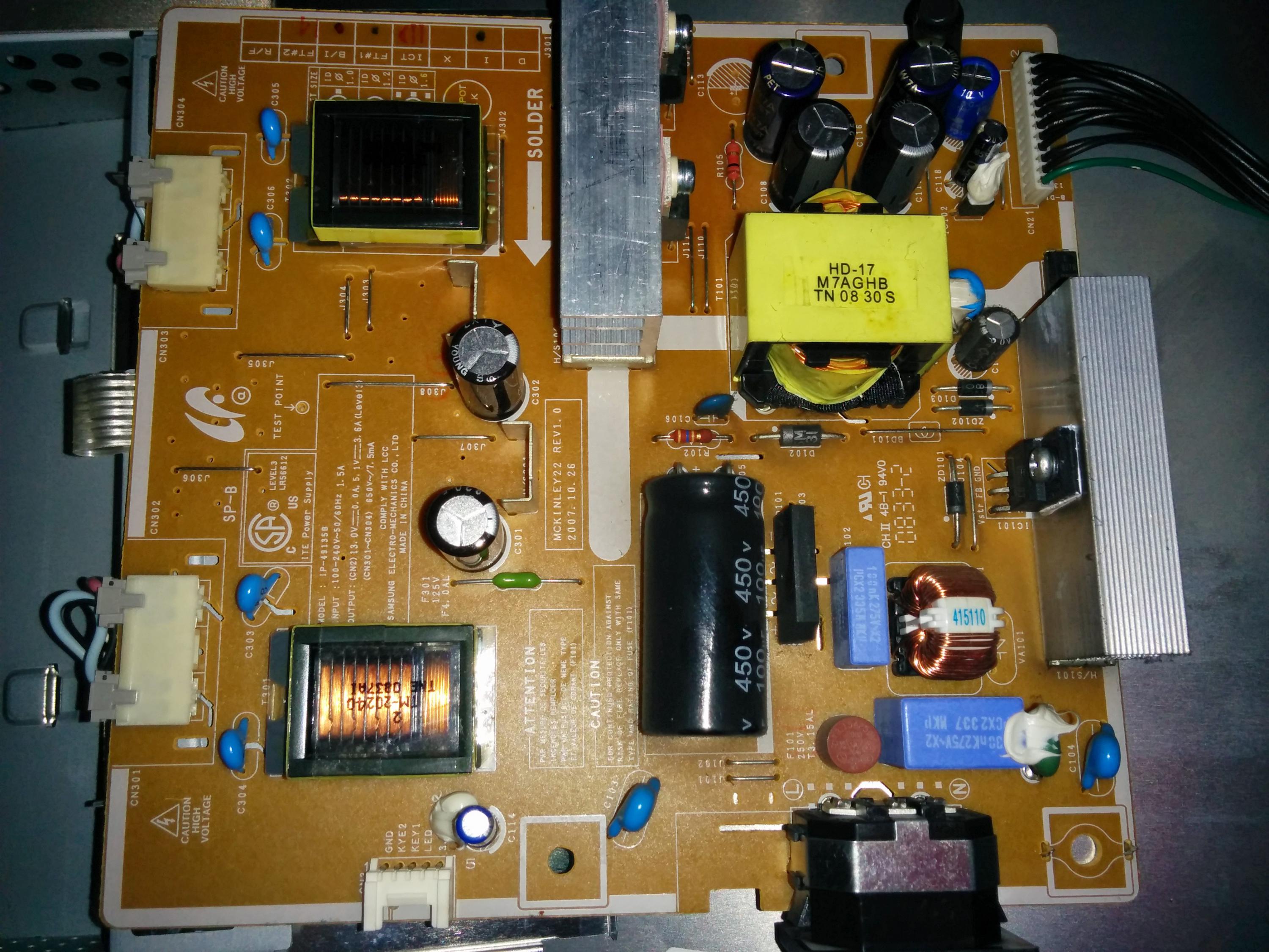

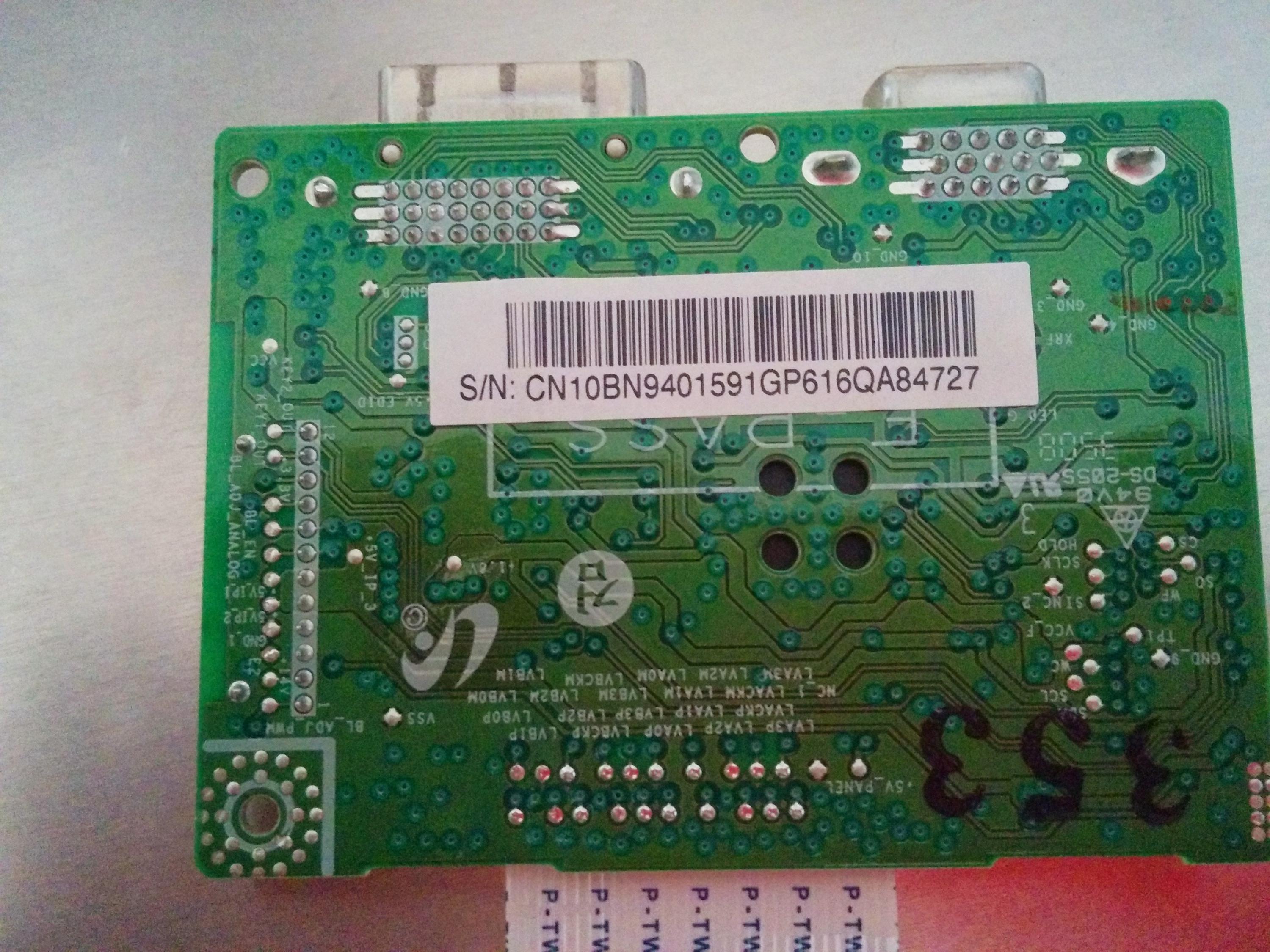

            Here are a few photos of the boards.
            Here's the link to my Google+, the last post contains all the photos i took.
            plus.google.com/u/0/+AlexandreDuarte/posts

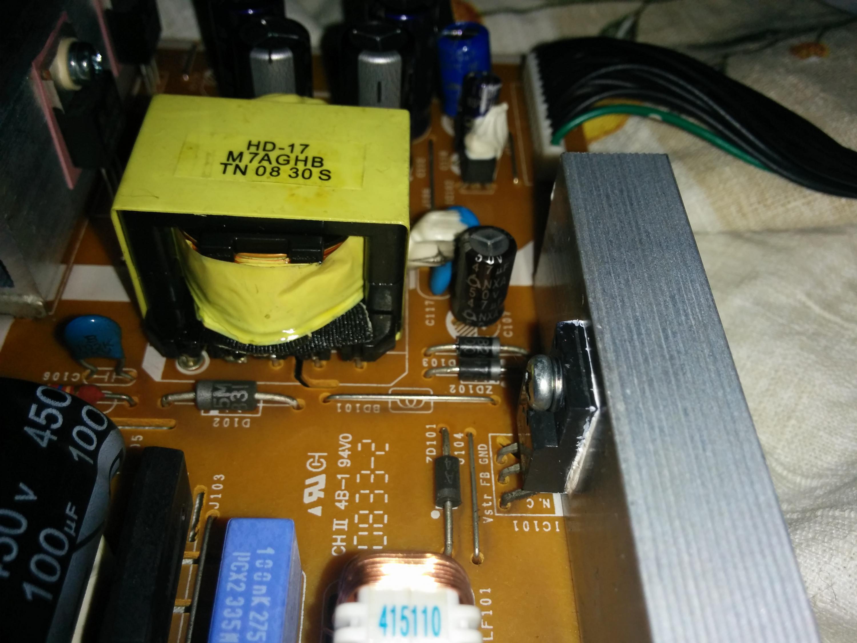

              Re: Samsung SyncMaster 2253LW - Flashes
              just by looking at the caps i didn't see anything wrong aside from the 4th pic showing a cap that is starting to leak.
                Not leaking that is just flux

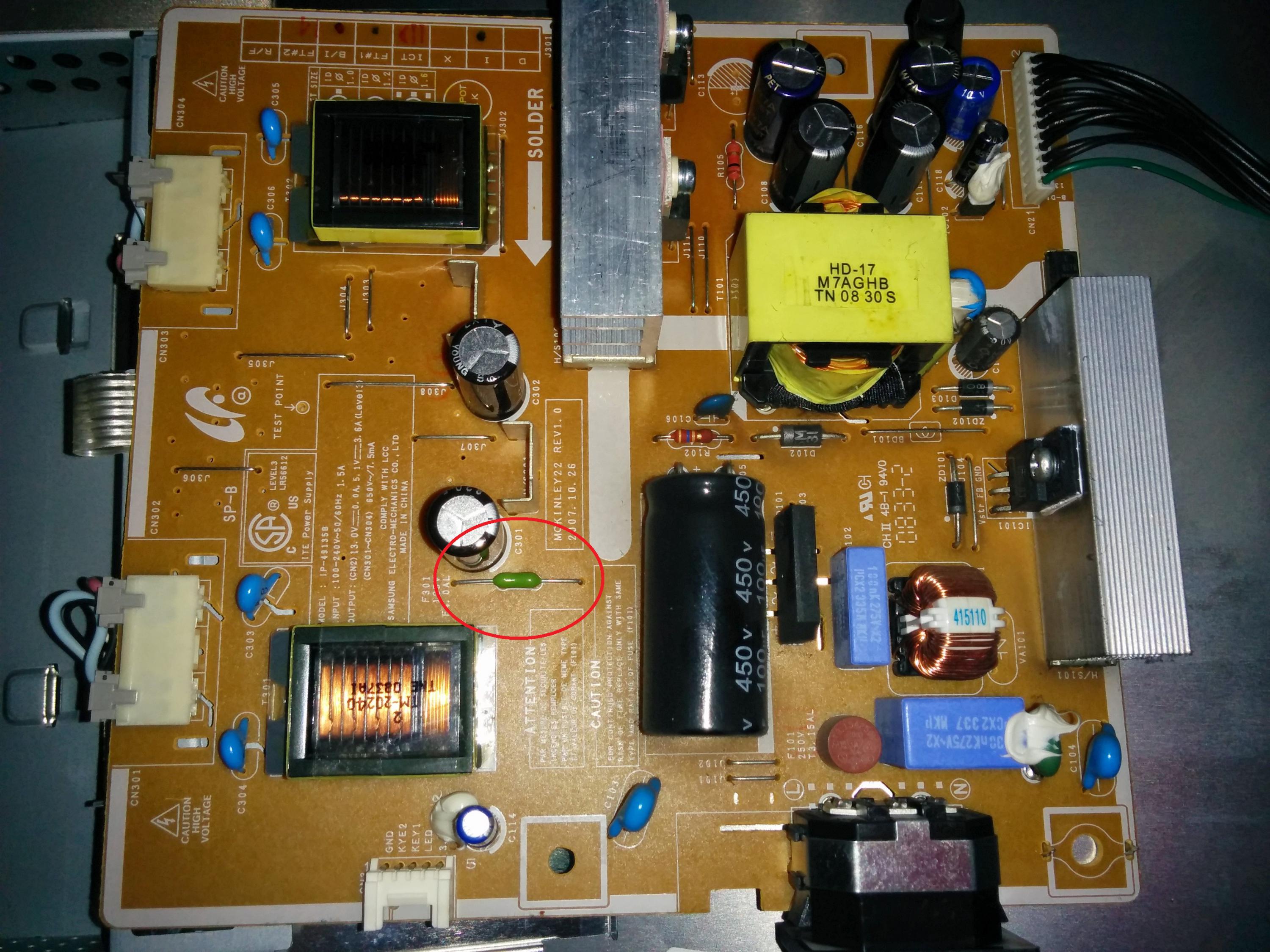

                    Ok - can you get at the green torpedo fuse when it is all set up?
                    If so test the voltage at that fuse - meter on vDC200 - depending on the result
                    you might be able to lower to 20vDC . Keep the probe in place and see if it varies as the monitor goes off/on/off Black probe on chassis ground.

                        Is that the one?
                          Yes - how many other green things do you see?

                            Hi. I'm testing it. With the monitor off it gives me a reading of 13.4 with it on it reads 10.2

                                Next is BIG cap Carefull HIGH VOLTAGE. Set meter on vDC600 and test
                                across the legs. Hold to see if it varies with the on/off/on.
                                If that is steady then next would be the two inverter section caps- one above the green fuse and the one above that - should be the same type.
                                Set meter on cDC200 - may be difficult to get at

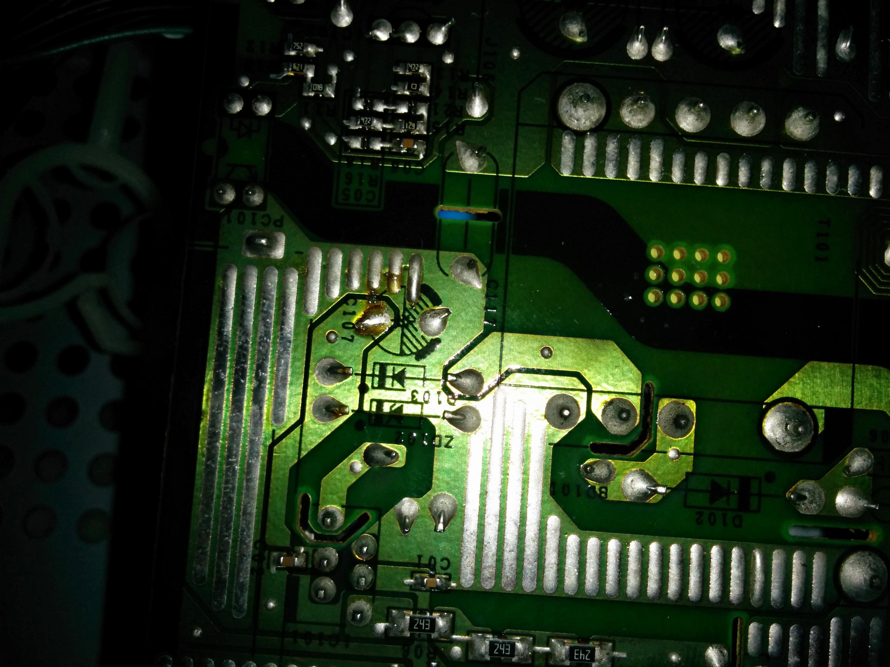

                                We do not have a good clear picture of the back of the power board, I am thinking could be a bad solder joint - dont look great in the section.
                                Does the fault come on straight from a cold switch on or does it start after a few minutes?
                                I dont think there is much wrong just needs more tests if you have time.

                                  just to make sure you tested the fuse right black probe on chassis ground and test voltage to one side of the fuse then then test other side.

                                      The big cap doesnt output any reading, monitor on or off. The next two caps give me a reading of 13.2. I've tested all the caps and the only one the doesn't give me any reading is the one I thought it was leaking. The one in the picture above.
                                        Its the one in this picture
