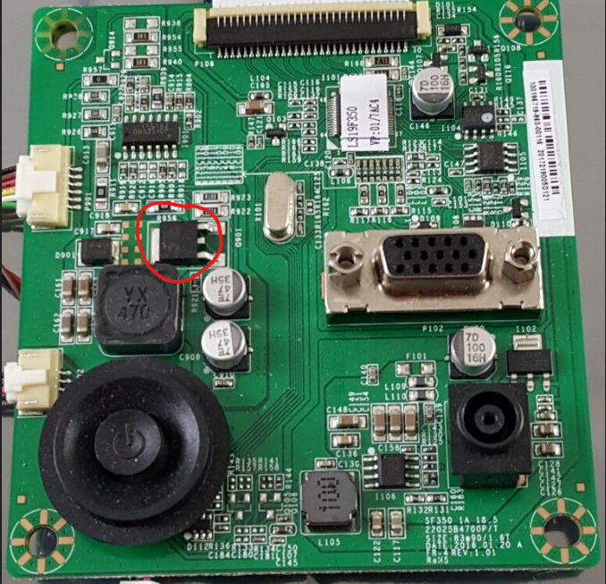

    Hi! The backlight doesn't work, but the board itself works. I checked every diode on it and they all light up. Shim is definitely working as I changed it for a new one.

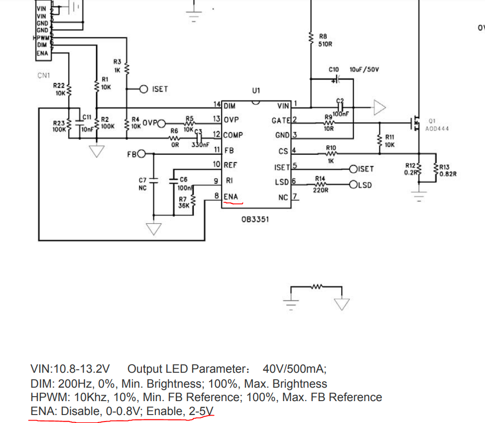

    I found the datasheet for a similar chip OB3351.
    VCC (1 leg)
    14v comes
    VDD (leg 14)
    It has 3.5v.

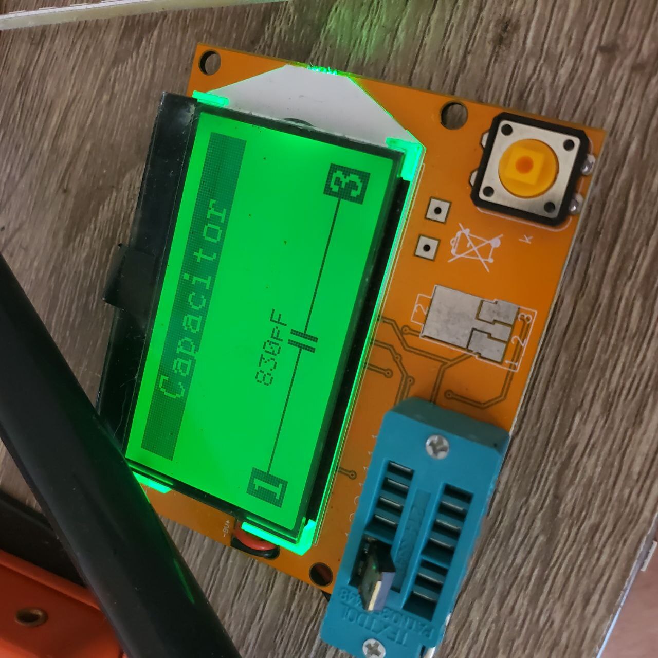

    Smd capacitance checked C913 it has a thousand nanofarads.

      What is the voltage on the control pin (enable)?
        Hello! 3.5V.

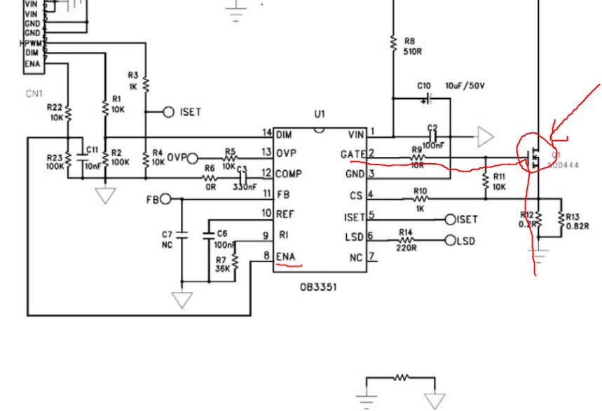

        By the way, I found before that the 2nd leg was planted on the ground and it was the r919.
        I took it off and a short passed and the chip started up.

              If pin 2 is grounded, then the mosfet is most likely broken, have you checked it?
                  Thank you very much for your help.
                  1.If I understand correctly, it is him.
                  I checked it with a tester, and I can say for sure that it's out of order.
                  2.Both of its contacts are connected to the ground, which is definitely not the case.
                  Plus, the low resistance from 2 contacts has not gone away.

                    a mosfet has 3 contacts. The tab on the rear is connected to the middle pin and then there are the two outer pins. Gate, drain and source. So your second pic above is wrong, because the middle pin and the tab aren't in the calculation there.

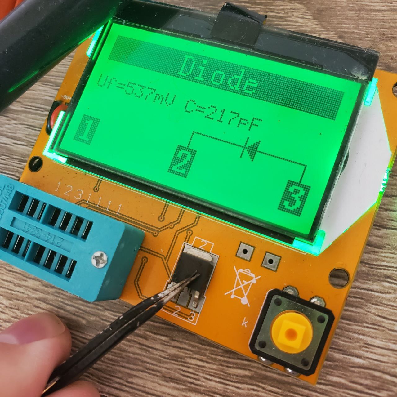

                      Okay, but in the 3rd picture it is pressed with all the contacts and also shows incorrectly.

                        I don’t really trust these cheap little component testers and just test MOSFETs with my DMM, as I want to see that mosfet turn on and off again. What part number is written on the mosfet?

                              Funny, it did see the body diode in the mosfet, but not the gate. Solder a little leg to the middle pin and use the socket again on the component tester… just curious…
                              but to really check that mosfet, test it with your DMM.

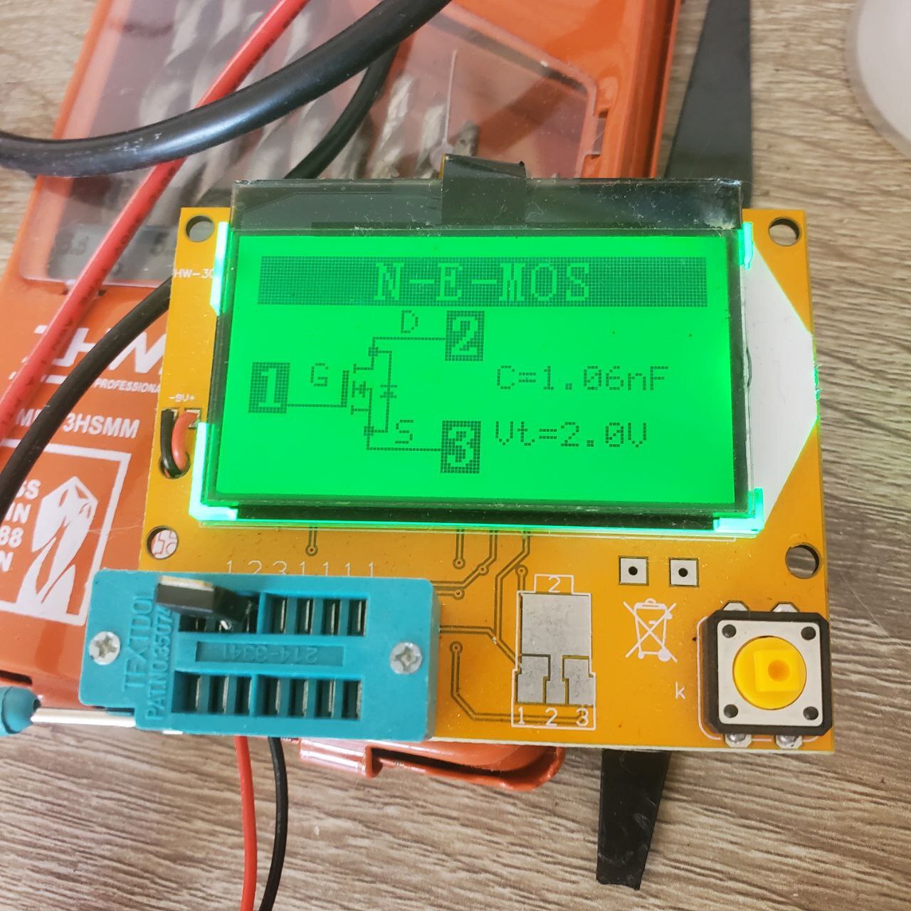

                                  I thought it was interesting too, so I soldered the leg on. That apparently the problem is not in him for sure. Something is putting the other leg on the ground.
