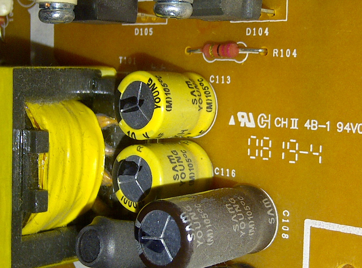

    Hi, I was looking for information on the problem I'm having and there seems to be a lot of knowledgeable and helpful people in this board.
    The monitor is a Samsung Syncmaster T260, it started doing this when it was about two years old and has been getting worse in the past three years, in the beginning it would only be sporadically, now it does it daily. The power supply is the IP-54155A.
    Setup:
    The monitor is either plugged via DVI to a 2007 mac mini or to a macbook via HDMI. I have 5 outlets behind the desk and the monitor is the only device that fails, no mater where I plug it.
    The symptoms:
    • The monitor will completely shut down sometimes after an hour, sometimes after 30 mins. The screen goes black and the led turns off. If plugged to the macbook the computer stop recognizing it.
    • Sometimes it will turn on again by itself after a second, sometimes it would need me to "touch" the switch to turn it on. Is intermediately recognized by the macbook when it comes on.
    • On a good day it will fail two or three times during the whole day day.
      In a bad day it will come on again almost instantly but then it will turn off a few minutes later. On a bad day it wont turn off at all after the first glitch (nor the led or the screen that is).
    I have read a lot of post about the "2 sec to black" problem but those monitors don't turn off completely, just the back light.
    Do you think it could be a power supply capacitor problem? The ridiculous "touch" on-off switch? Or the main logic board (in which case, there isn't much I can do).
    Thanks in advance for any ideas. i have a multimeter if you need me to check something but it only have the basics: Ohmmeter, AC/DC voltage/current, transistors and diodes.
    UpdateI forgot to mention that I measured the secondaries of the inverter, both windings are around 1K with very small difference between them, I don't have the exact value here.

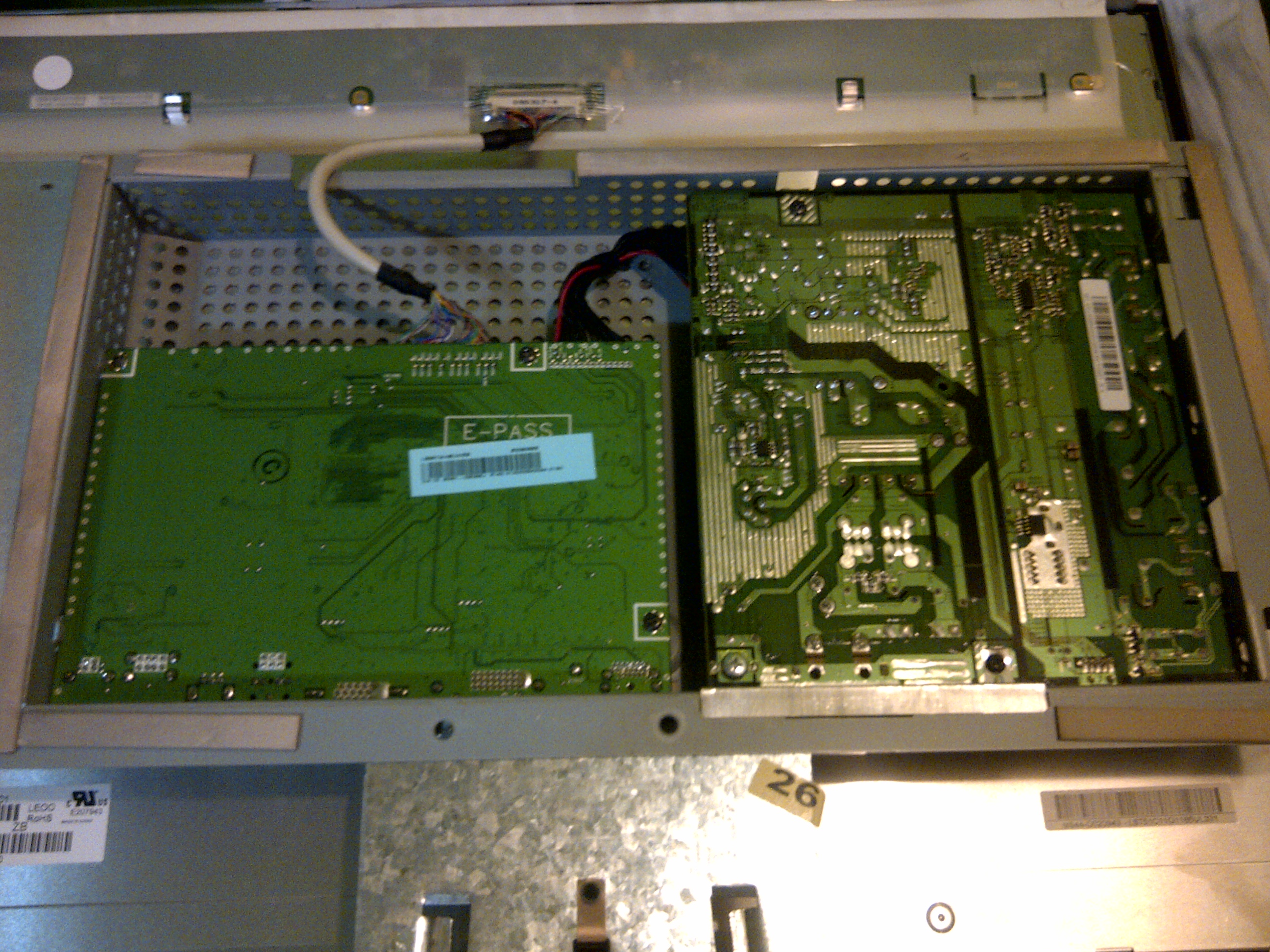

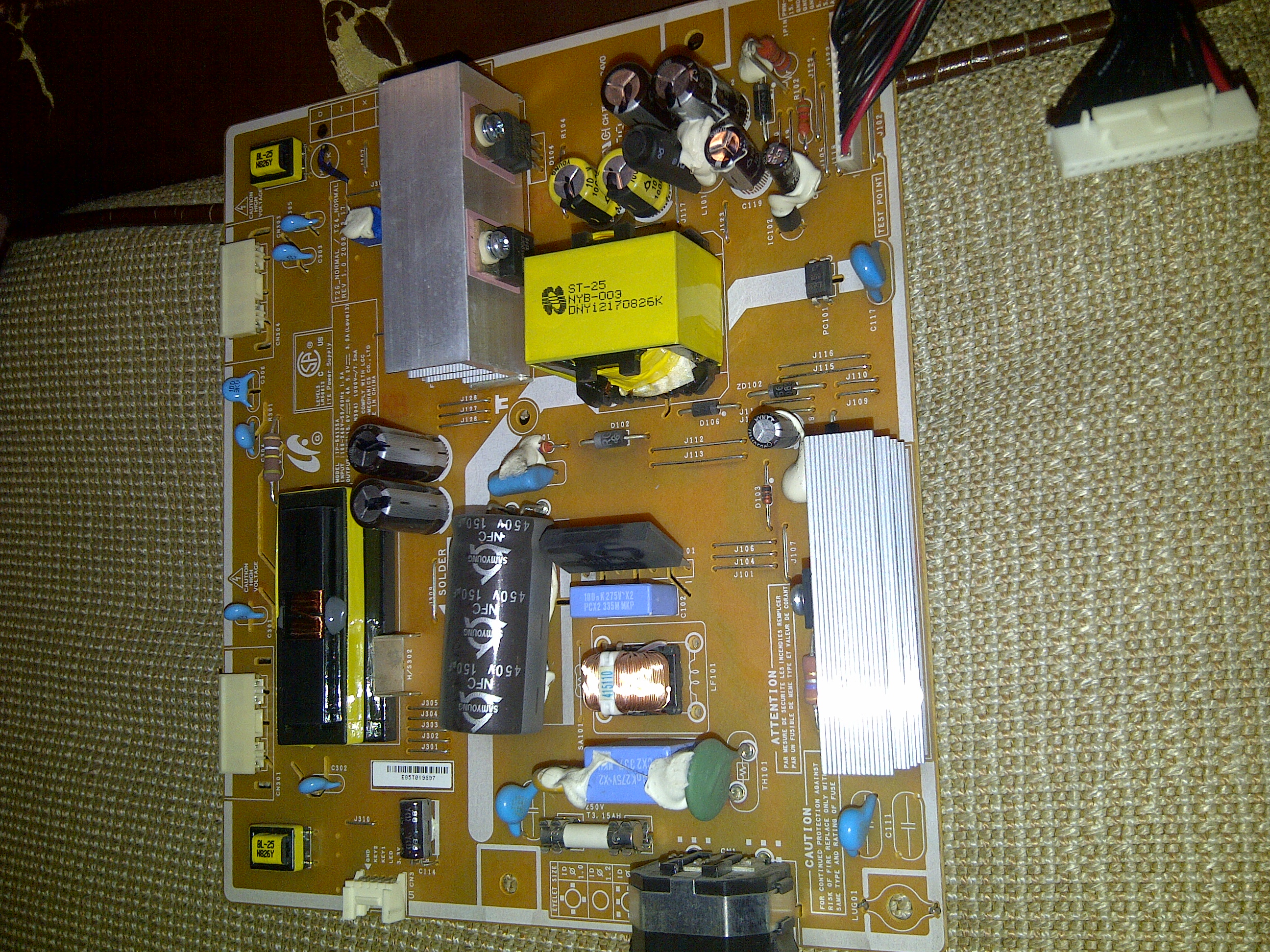

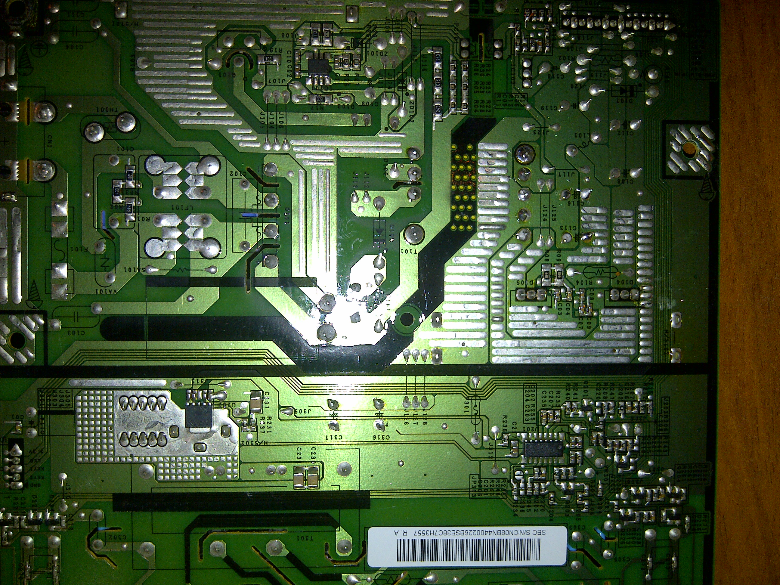

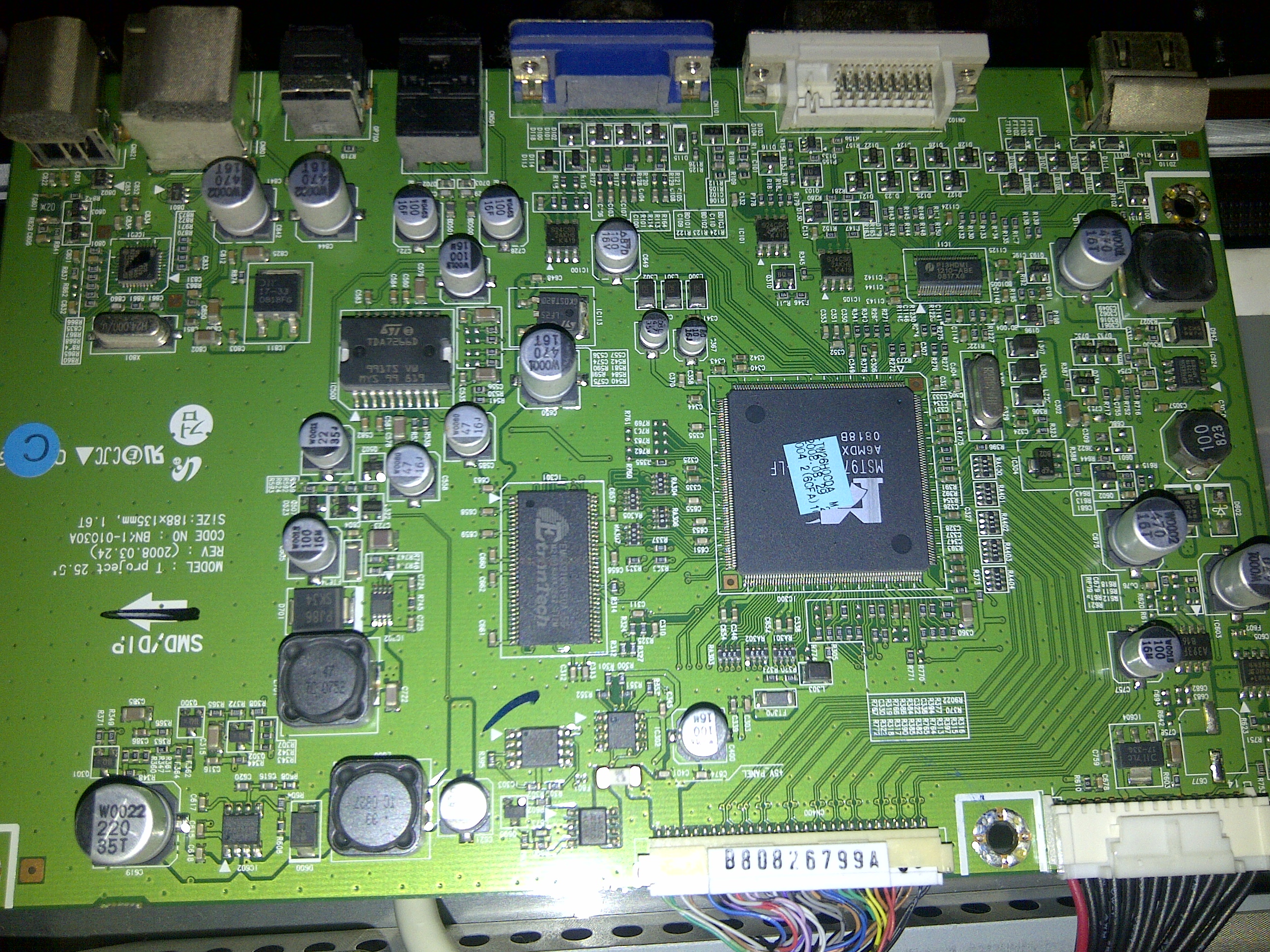

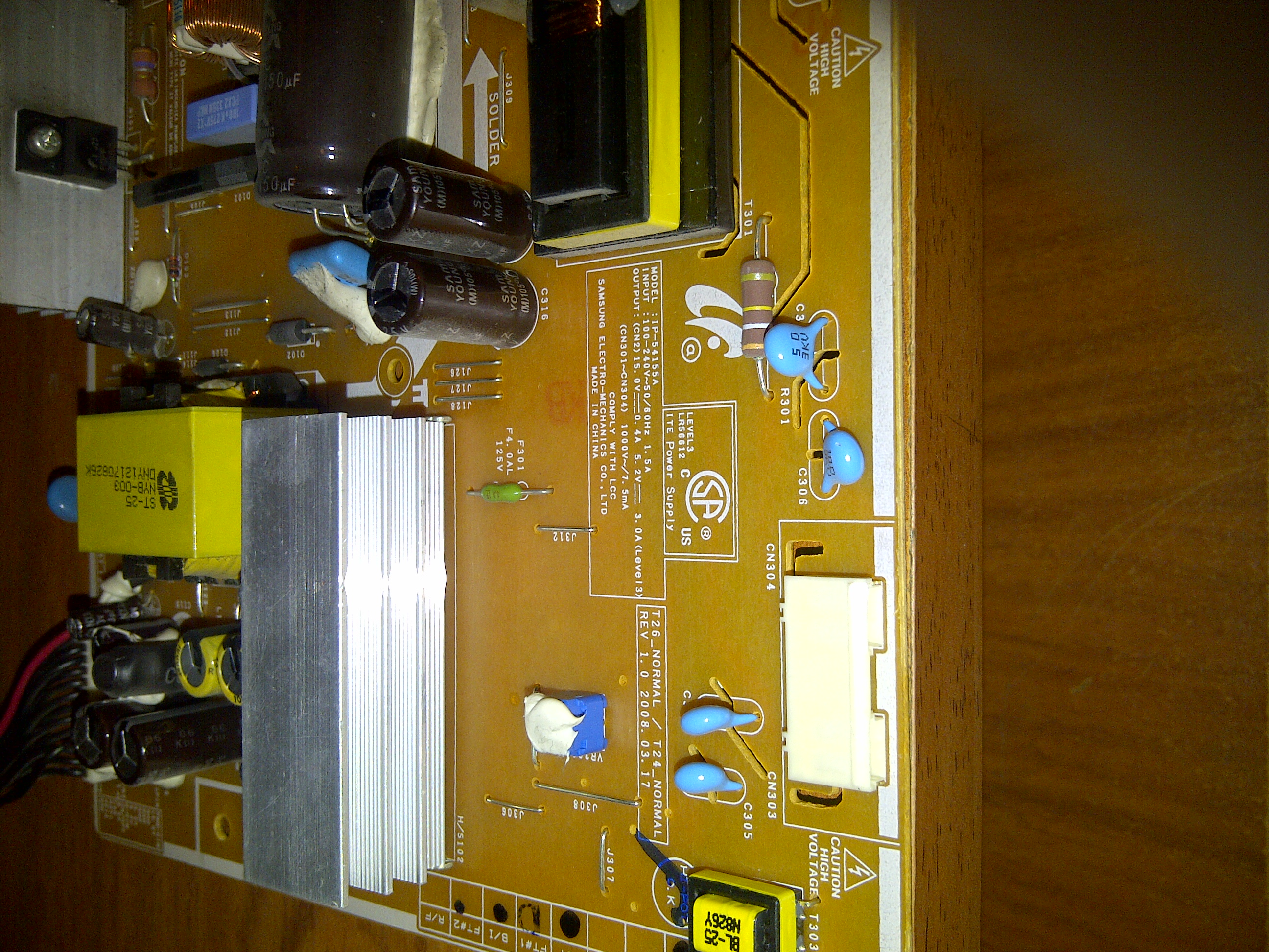

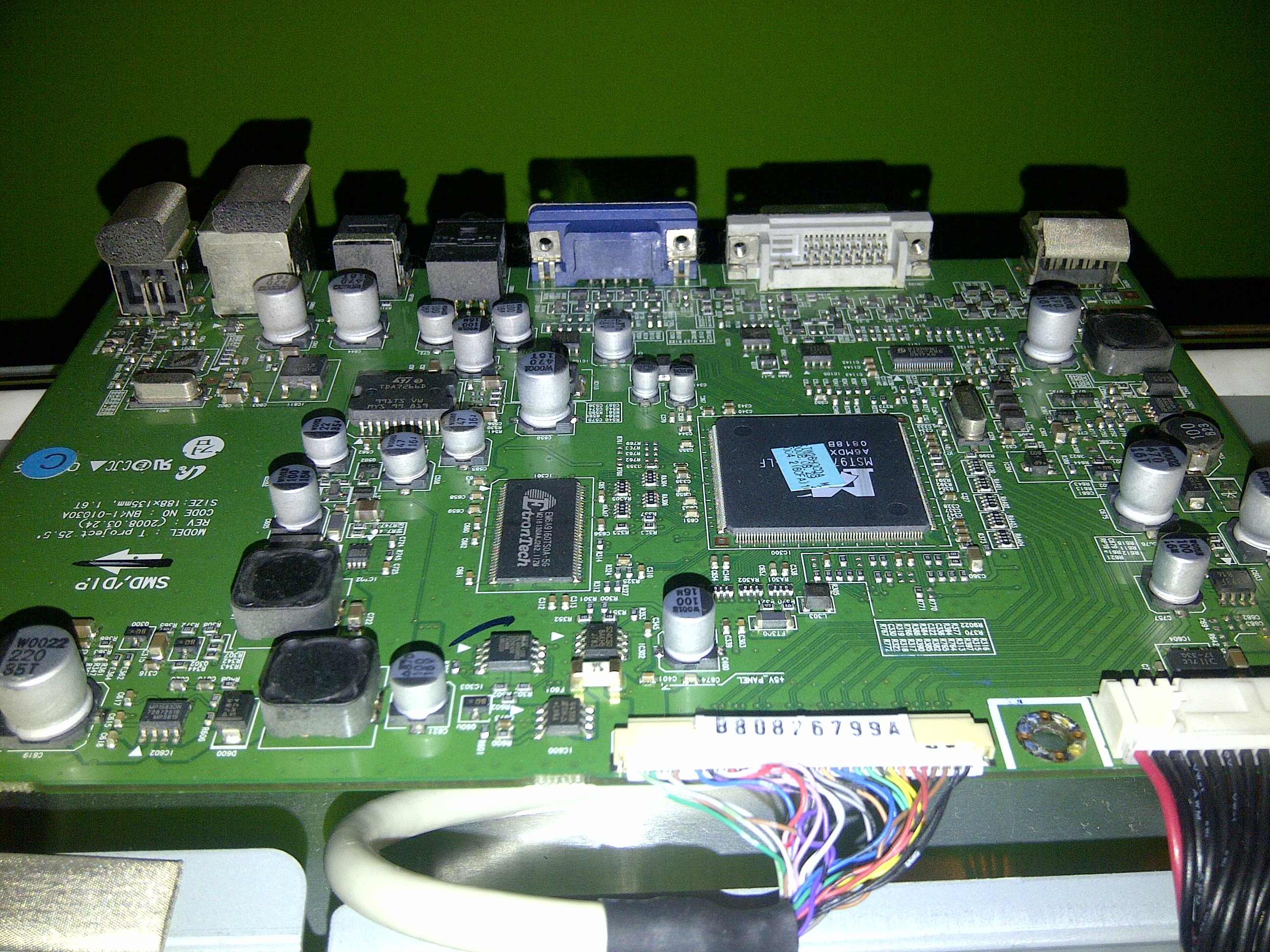

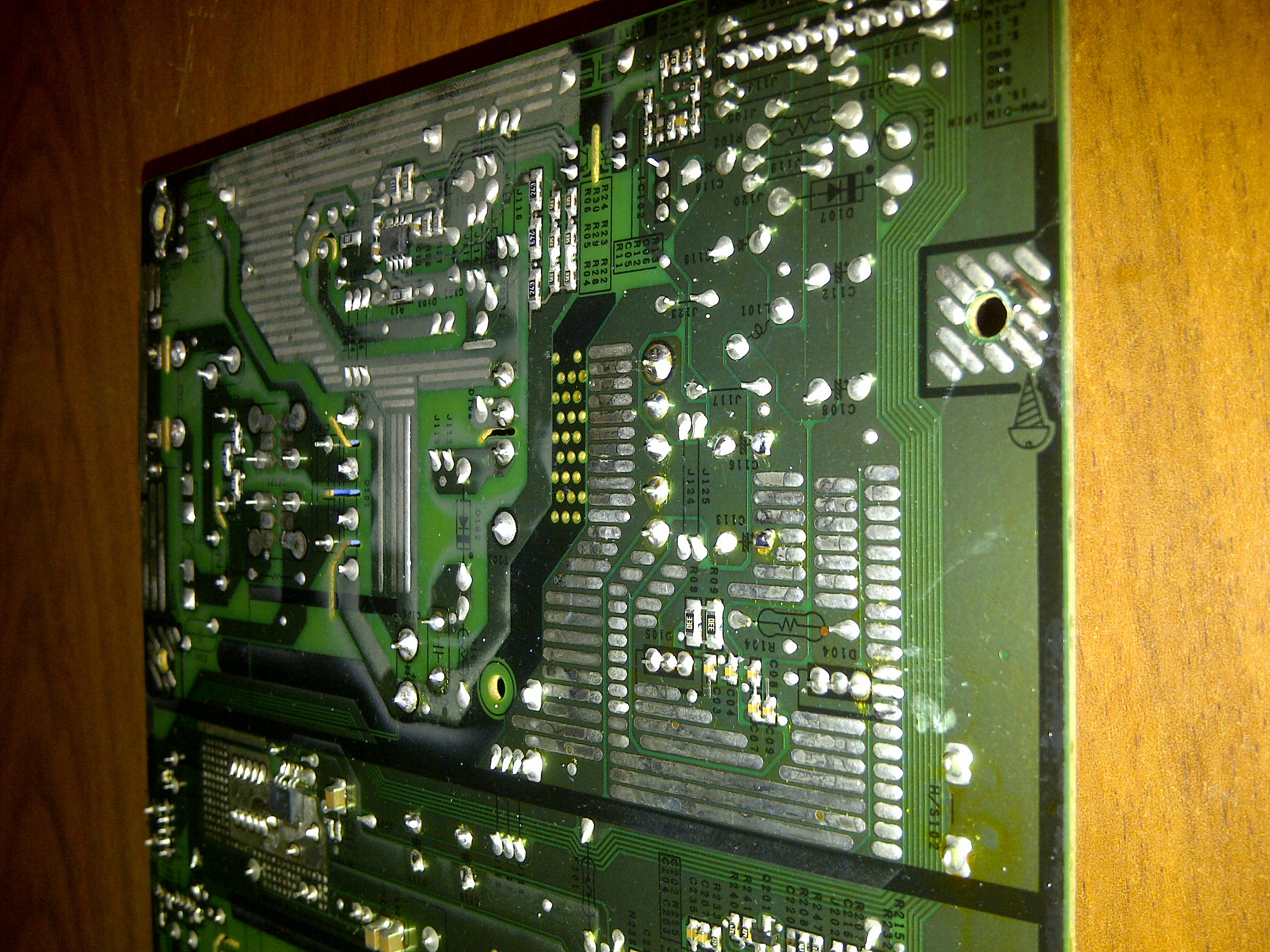

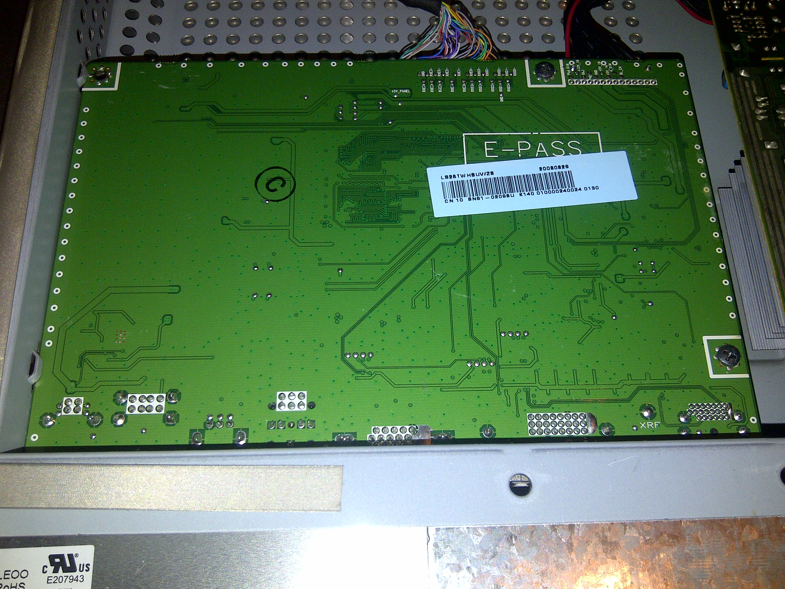

    Update 2It is a 26", I uploaded a pic of the model # and the rest of the boards:

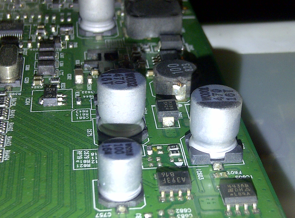

    Main logic board: it has all the ports, everything looks clean, I did a close up on the corner where the power connector comes in.

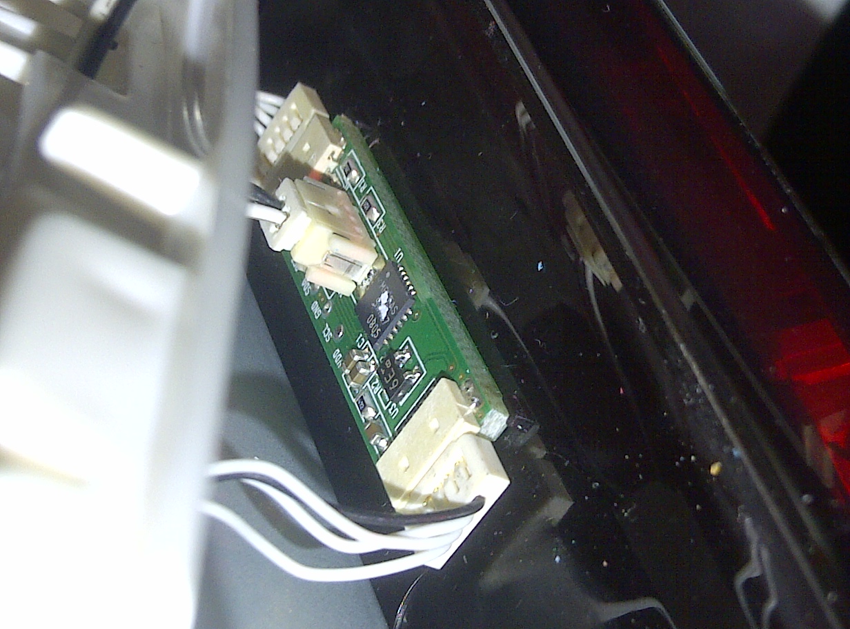

    There is also a small board that manages the led, side buttons and the "touch" sensor.

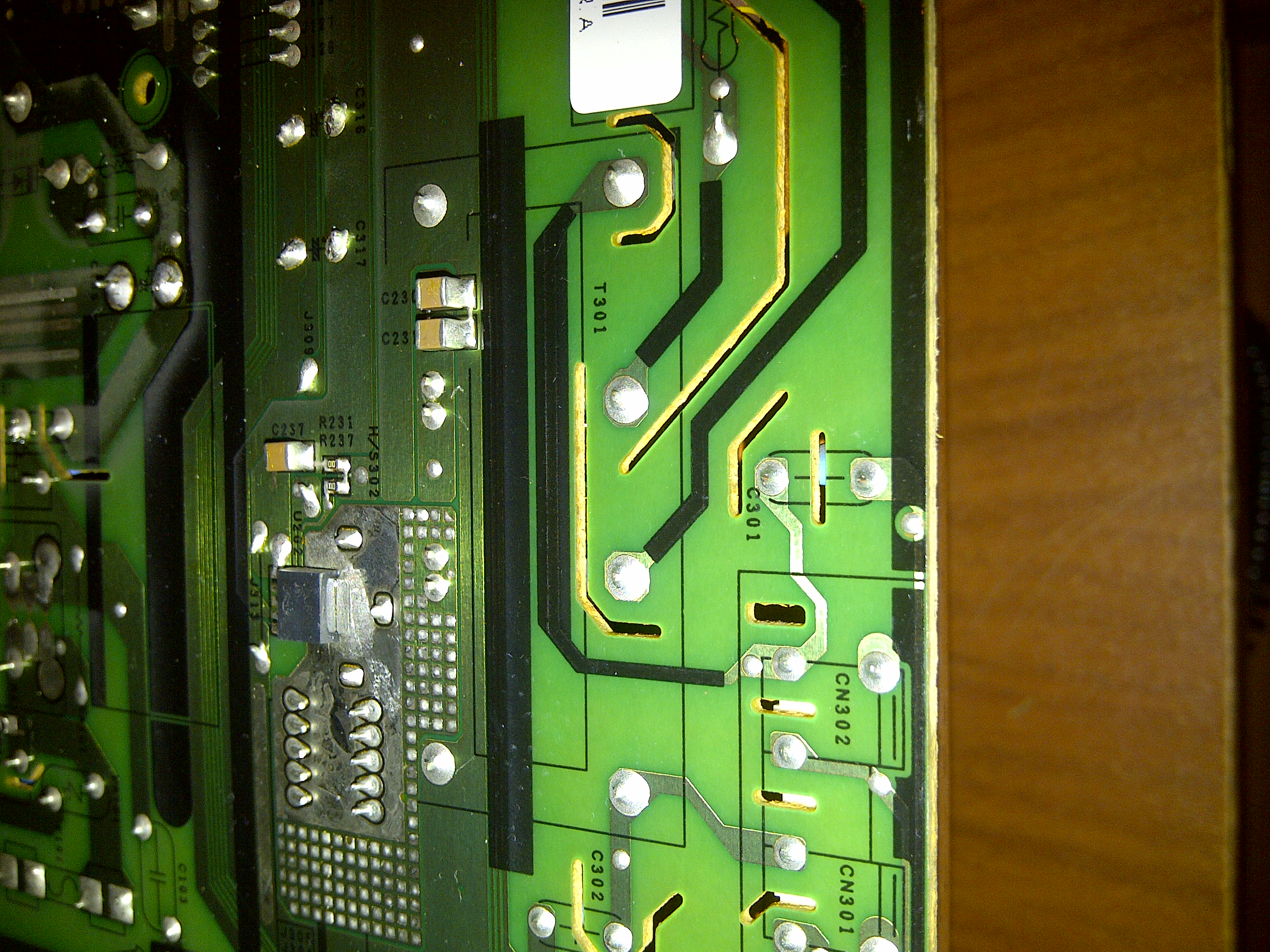

    The pictures: The board was this clean when I took it out. I don't see bulging on the caps and the pcb around the high tension components is not brown or toasted. Is one of the cleanest board I have seen.
    Last edited by diegus; 06-17-2014, 05:26 PM. Reason: Add new info/pictures as requested

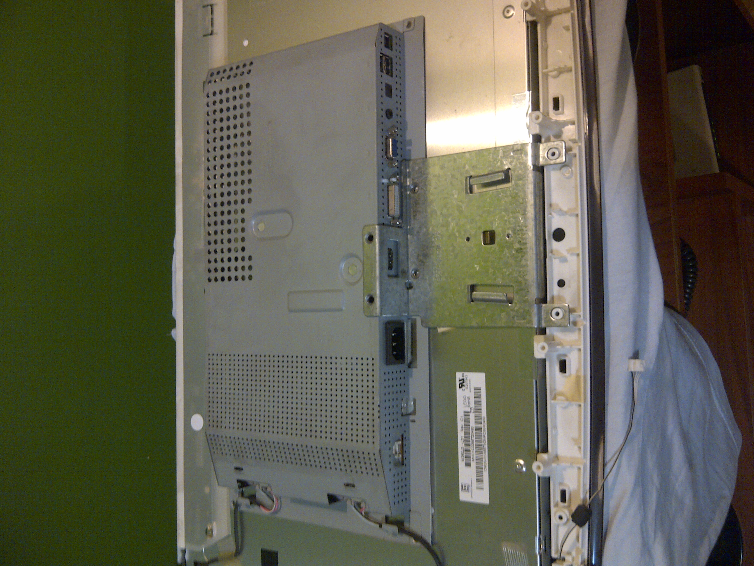

    Re: Samsung T260 turns off and on by itself
    Seems this is a 26" so it may have a t-con board besides the main and power supply
    Can you post a picture of the entire back ?
      bammbammfran, thanks for the reply.
      I updated the original post with the info you requested.
      I'm not sure yet how the touch sensor works, but I have been thinking if maybe it has some kind of "leak" issue. It has to be capacitive probably so maybe is sending false signals to the power board.
      Samsung has made testing this monitor really difficult, there is no way to use it without the back cover on since the boards are not attached to anything.

        It does not have a separate t-con, the board at the top of the screen is permanently attached and serves that purpose
        I am also surprised that they went with what looks like conventional bulbs on this size screen. Most monitors I work on switch to rear lit backlight on the 24" and up
        And since they are that way and that long, they could be posing issues.
        It obviously has overheating issues
        one way to check that is to run it open and or with the boards loose which is a bit tricky to do on these layouts
        do you have any plastic zip ties ? sting could work too
        What you would do is cut a decently thick piece of cardboard the almost the width of the screen and from the bottom to about where the wide ribbon plugs into the screens panel
        then layout the boards on that and mark some of the screw holes so that you can tie the boards to the cardboard for stability. I have done this with tape alone but sometime the tape lets loose and boards slide.
        then tape the cardboard to the screens back so that the bottoms are flush
        then you can set the monitor on a non-slip surface and what I do is use something like the center cardboard of household saran wrap as a kick stand to the top of the face of the screen to stand it up so that I can run it and see what is going on. It actually does not have to be held up more than a couple inches (just enough to not trap heat on the screens face.)
        Then see if it runs longer.
        If it does run for quite a while longer
        then you can do a start again with it cold, and try to heat one board at a time to see which board might be causing the issue.
        if it doesn't run quite a bit longer, then it may be a bulb

          I suggest you measure the voltages at the the power supply wiring harness while the monitor is working properly and again when it goes dark. It looks like there is a legend on the side of the harness which identifies the function of each wire. Photos are good, but for the record, straight down photos are preferred, so that members can read all the writing and see all the components on each board. And yes, it could be the "touch" button as they are more trouble than they're worth.

            jetadm123: thanks for the suggestion, I will change some of the pictures and take measurements when I get to make it work open.
            What I have found is that if you disconnect the touch button the screen will go off immediately and there would be a clicking noise coming from the power board, so next time it fails I will also check for the presence of such noise.

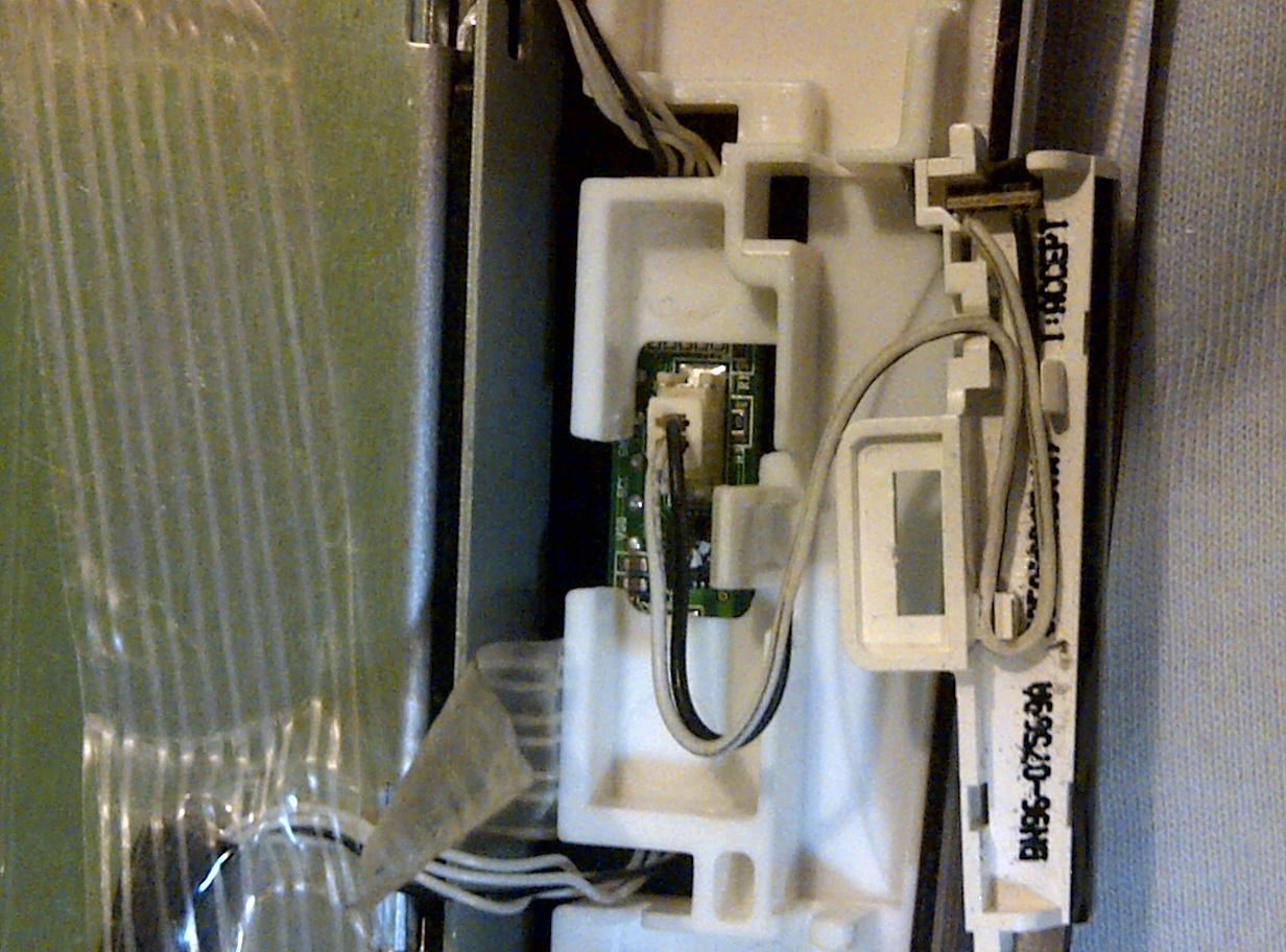

                      I took a look under the white bezel and the touch button seems to be glued to the frame, tried to pry it away with the spudger but could not find the slightest separation.
                      If anyone have any idea how to remove it, I haven't found anything in google yet.
                      Repair is noble.
                      • Maverick Wolfe
                        • Jun 2014
                        • 14
                        This might sound crazy, but have you tried the spudger and a hair dryer? I've had to use a hairdryer to loose stuff that was glued on, once I even had to as in a forum post I read many years ago heat up a heatsink with the hairdryer to get it to let loose enough to gently twist and pull off and out of the board.. that was a rather nerve racking experience.
                        • bammbammfran
                          • Apr 2014
                          • 476
                          heating it can sometimes help release the double faced tape
                          heat the front side of the front trim till you feel the heat from the rear getting pretty warm on your fingers
                          you might have the get it started with something pointy like the tip of an exacto knife since these are sometimes sitting down inside a channel.
                          then do the rest with something more flat and plastic like a credit card

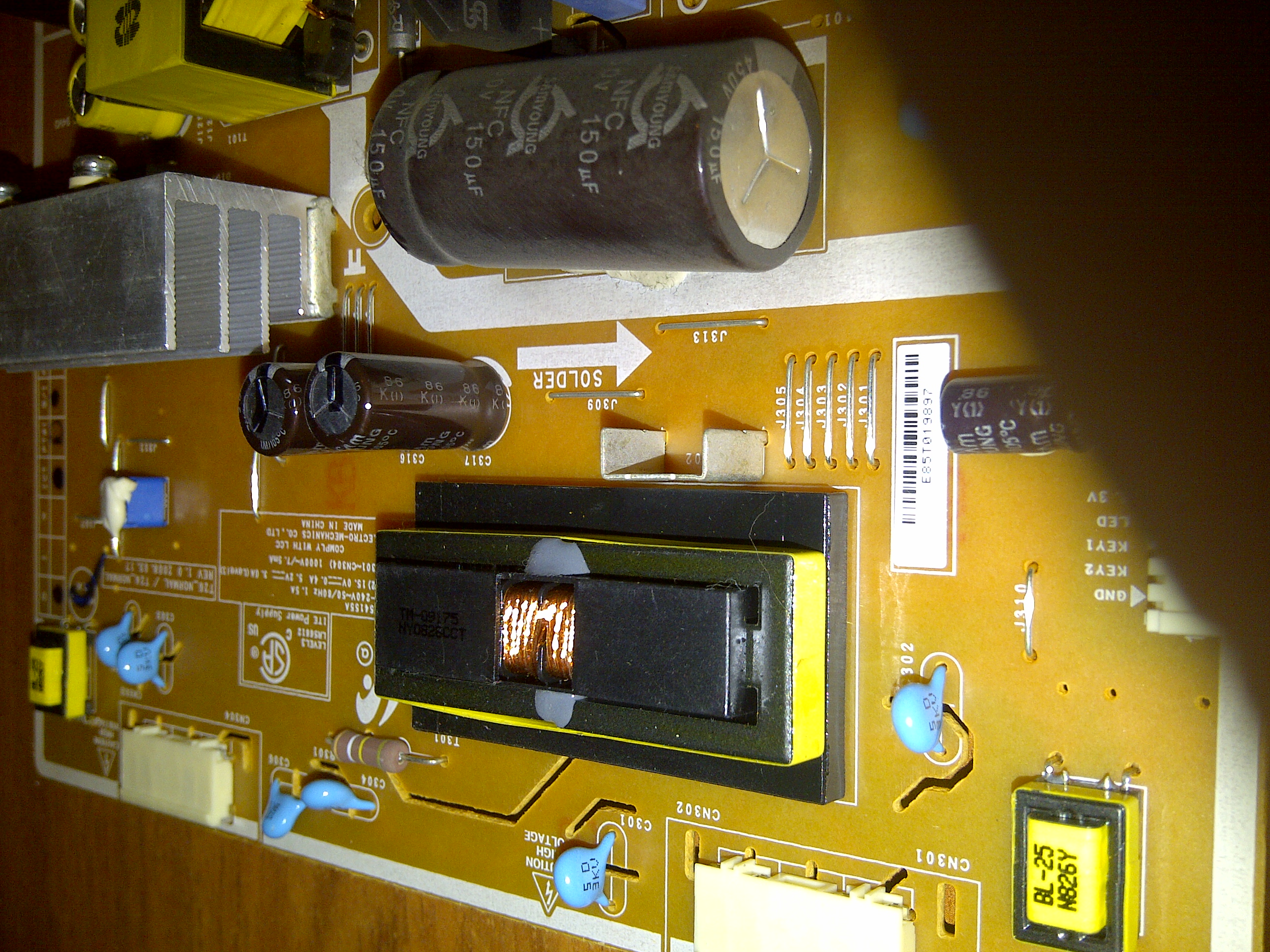

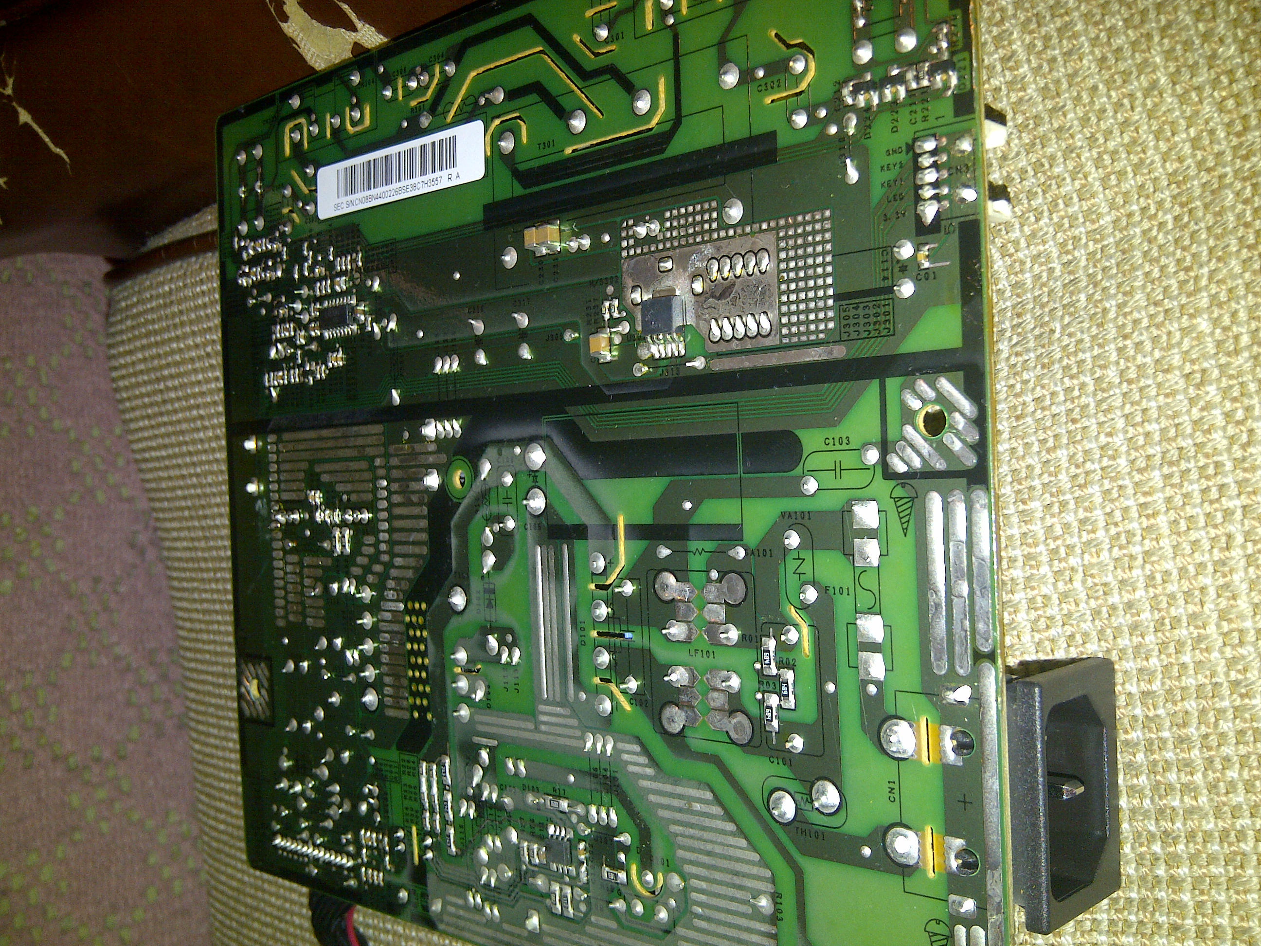

                                looks like that power button goes to the power supply which is an odd place for a touch button to go ??
                                can you post a few pictures of that area from both sides of the board
                                • bammbammfran
                                  • Apr 2014
                                  • 476
                                  NO need for those pics
                                  I managed to track them down to the larger connector.
                                  they just travel trough the power supply
                                  see if you have voltage on key 1 and key 2 pins with that plug unplugged
                                  the ground pin is the first pin and is marked for testing

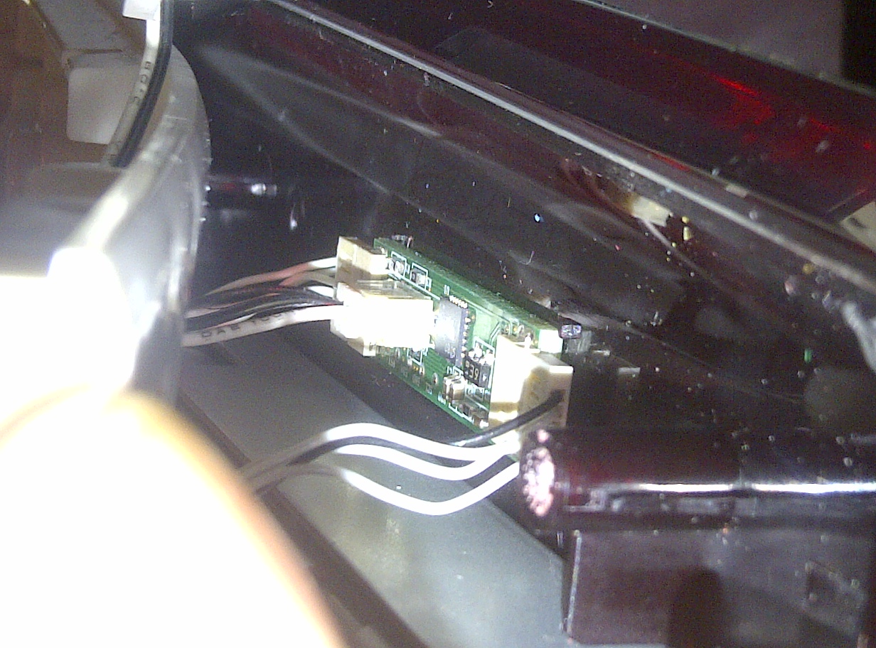

                                    Here are the last two pictures I took last night.
                                    Repair is noble.
                                    • bammbammfran
                                      • Apr 2014
                                      • 476
                                      That square black chip in the center of that board is probably what is overheating.
                                      let me know on those voltages
                                      do those other wires go to a remote control board ? if they do, does that turn it on and off ?

                                        Hello again and sorry for the lack of updates, had a very long work day yesterday. I have the day off tomorrow so hopefully will have enough time to find a solution for this.
                                        The cables come from another board that has five or six buttons in them for menu/input/brightness/etc (no shutdown). I guess the chip reads the buttons and send digital signals to the main board.
                                        I'm thinking there is no way that chip can generate enough heat on itself to fail, if that is the problem indeed, so the heat should come form the lamps. In that case I'm thinking about adding some kind of insulation over the touch button. Opening a vent in the case with the dremel might work too, but I will try to solve it in a more "aesthetic way first".
