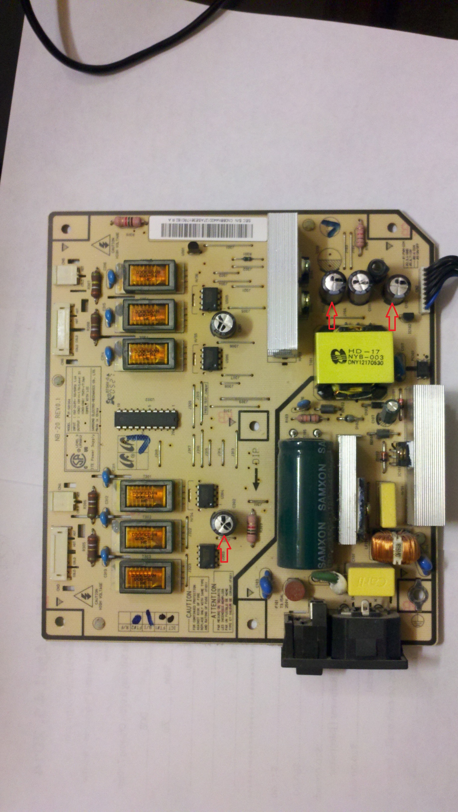

    Samsung 204t Blinking Green Light
    This one was my left in my triple monitor setup until today. Luckily I have a spare I keep around because I know these things have issues. Based on previous experience I'm assuming the issue is with the power supply board, but I can't seem to spot the faulty component. What you guys think? Sorry about the quality of pictures.

    Re: Samsung 204t Blinking Green Light
    Hello theonetrueace,
    First off welcome to this awesome forum. Second please use the "Manage Attachments" feature instead of posting your pictures inline. I see three swollen capacitors in one of your pictures. If it were me I would replace all but the big capacitor. Those big caps don't go bad as often as the other caps on those boards. I would use Panasonic Fr,Fm,Fc series capacitors from Digi-Key.com to replace all the rest of the capacitors. Measure the diameter and height of the caps on your board as a aid to purchasing their replacements.
    Good Luck With Your Project,
    lcdman
      Thanks for the forum tip and the problem identification.
