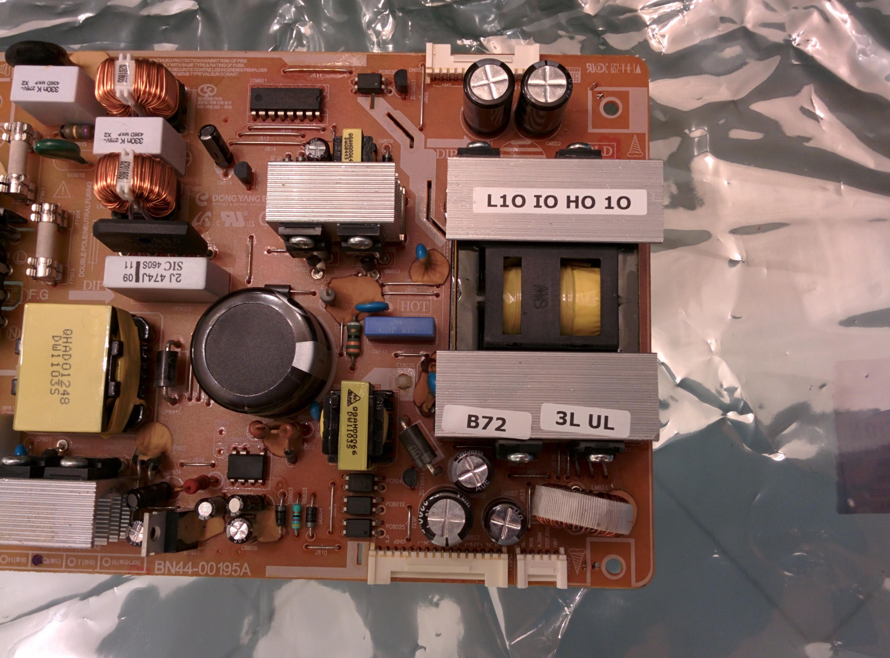

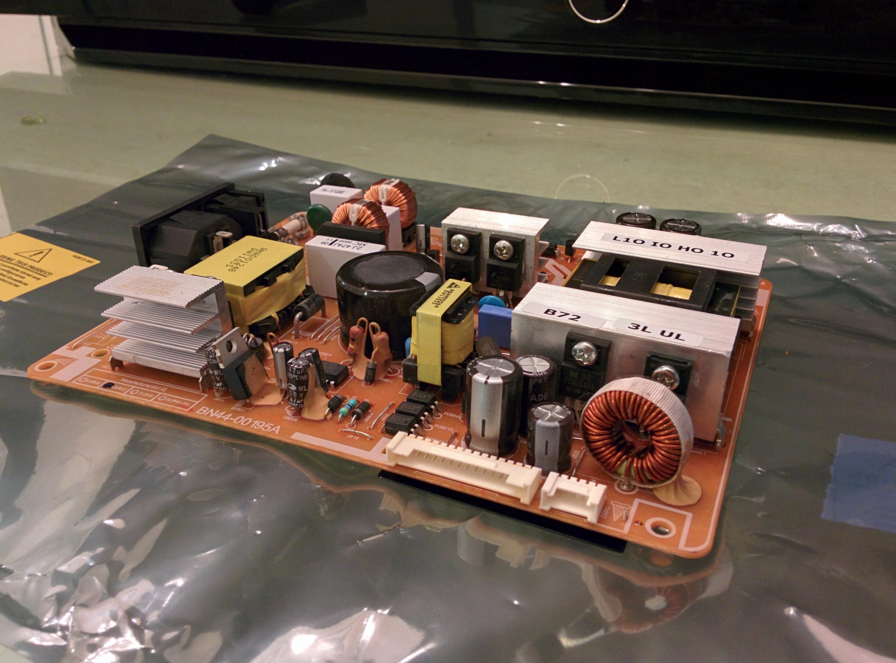

    Hello all, I wish I had found this community about a year ago!
    Model: Samsung SyncMaster 2493HM
    Power board: BN44-00195A
    Main board: BN41-00962A

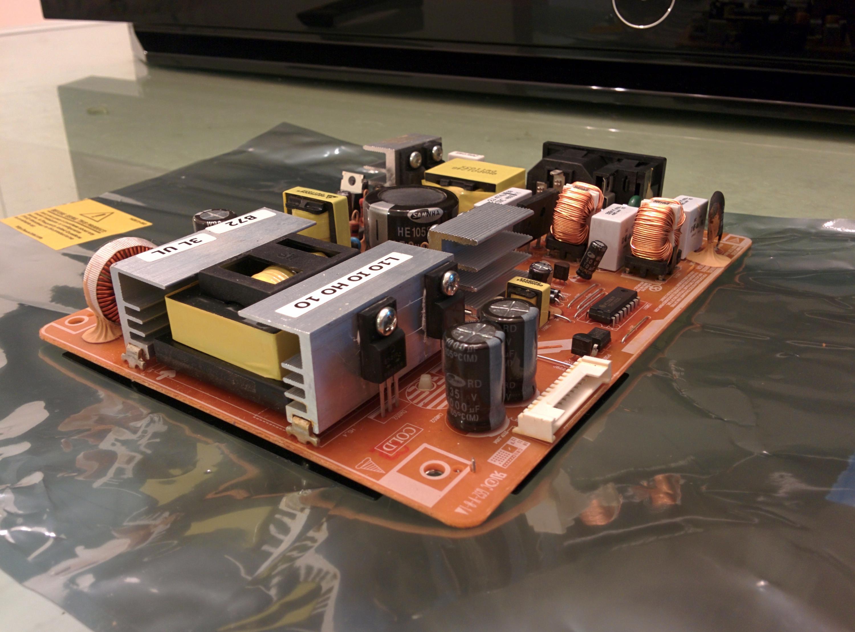

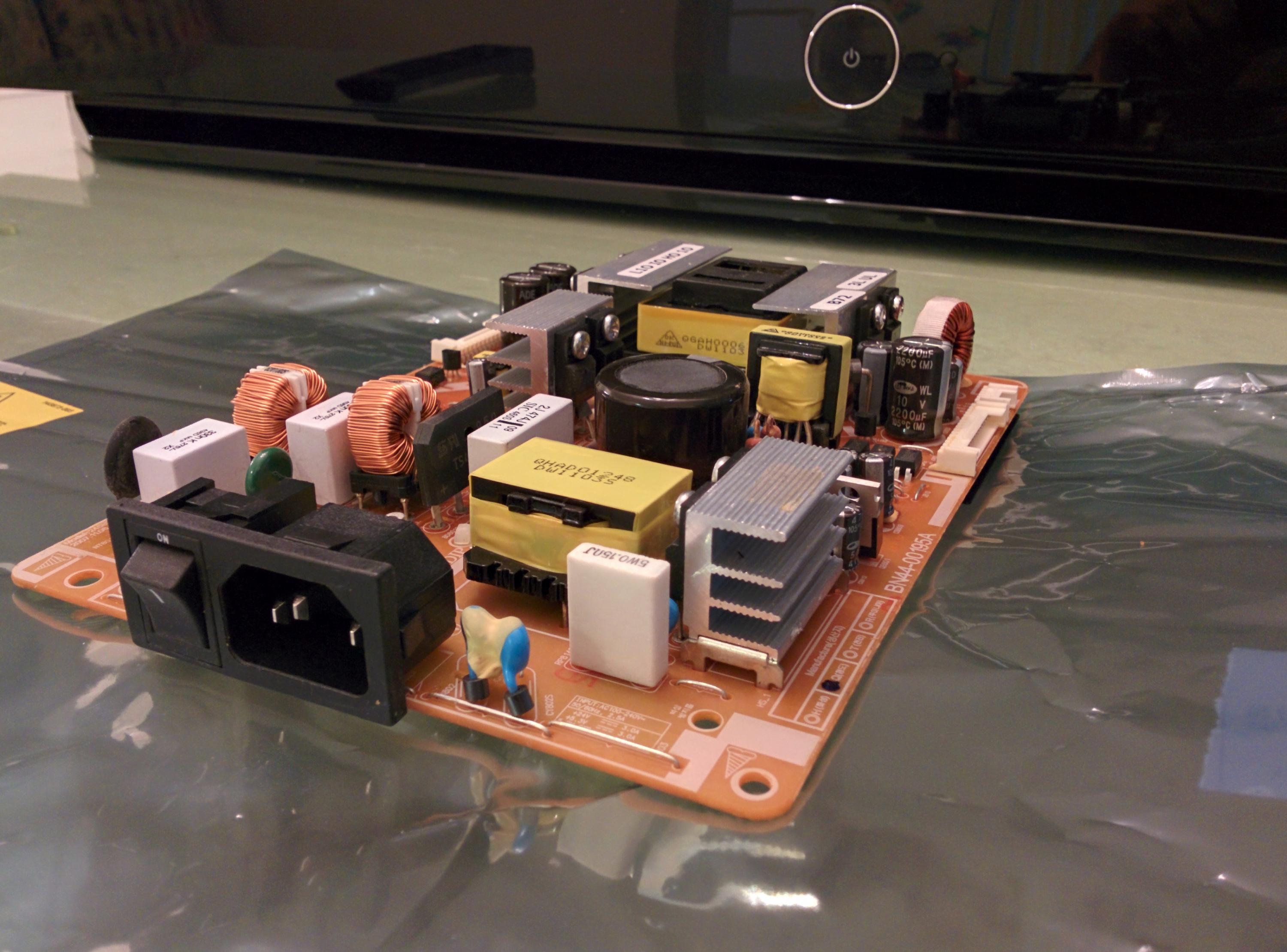

    Description: Power button blue LED flashing non-stop when power plug connected. There is no change when the button is pressed and to clarify the screen does not power on at all. Visually I do not see anything other then the browning glue. I did notice a metallic burning smell but it seems to be coming from a heat sink more then anything.

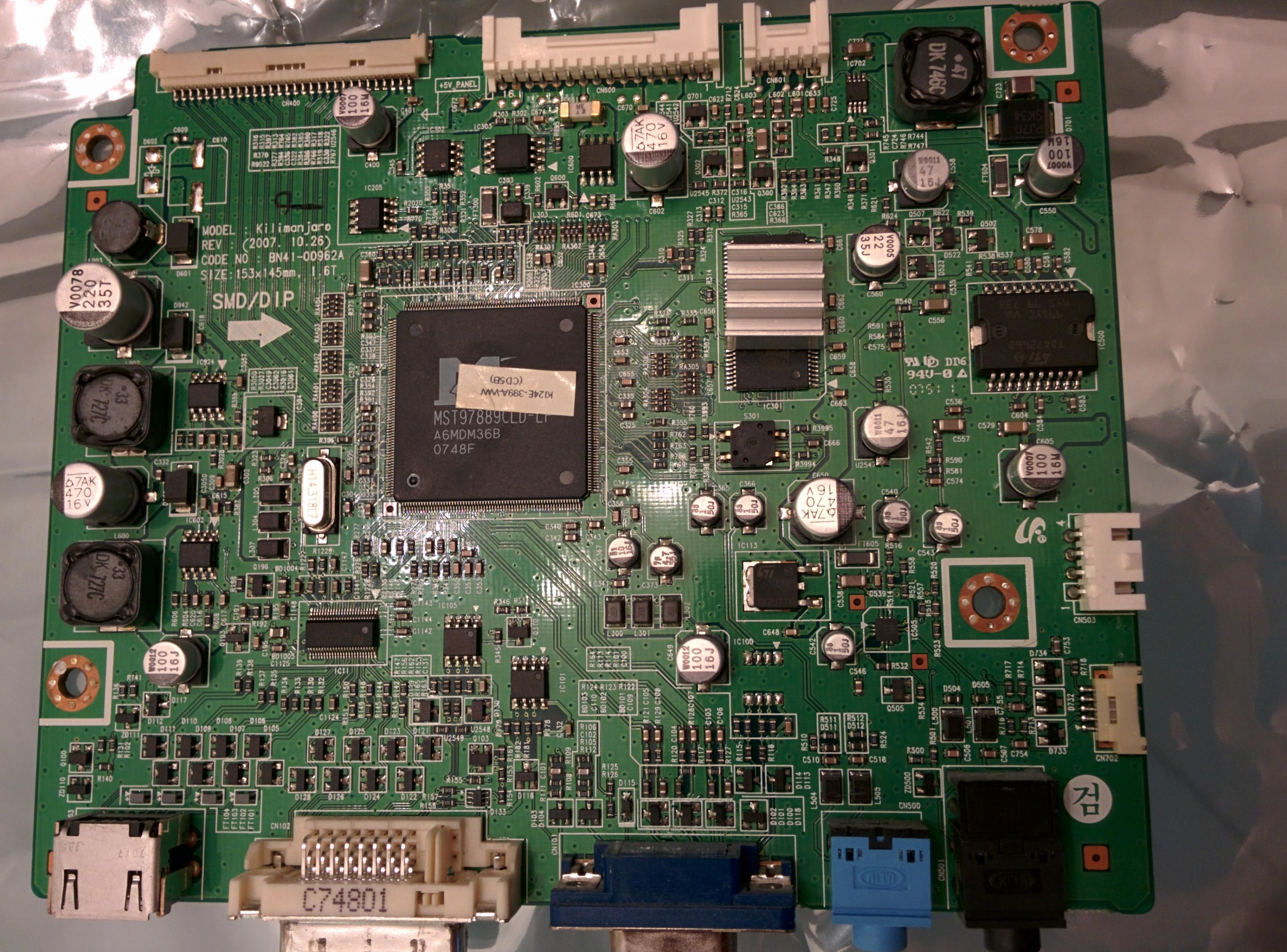

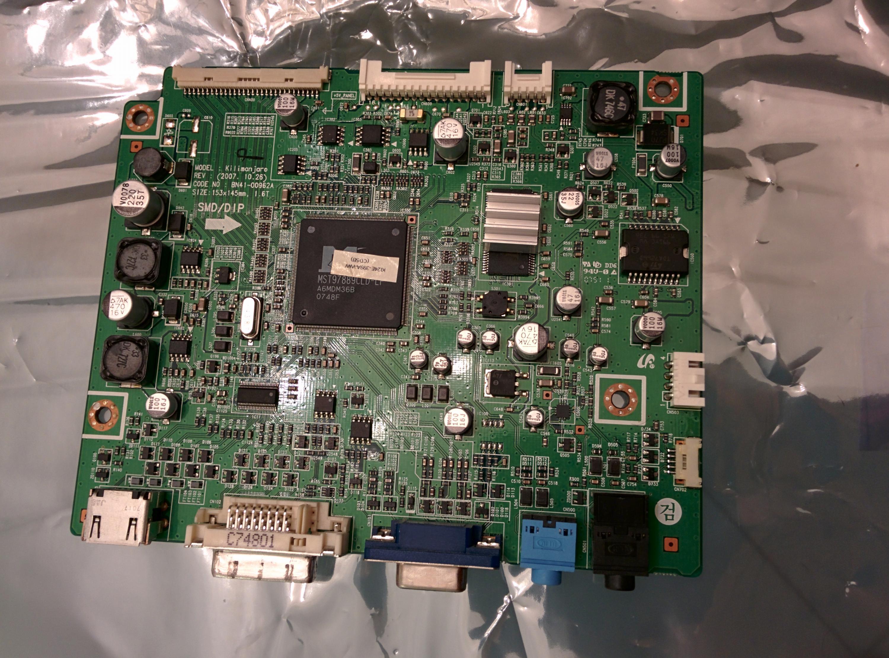

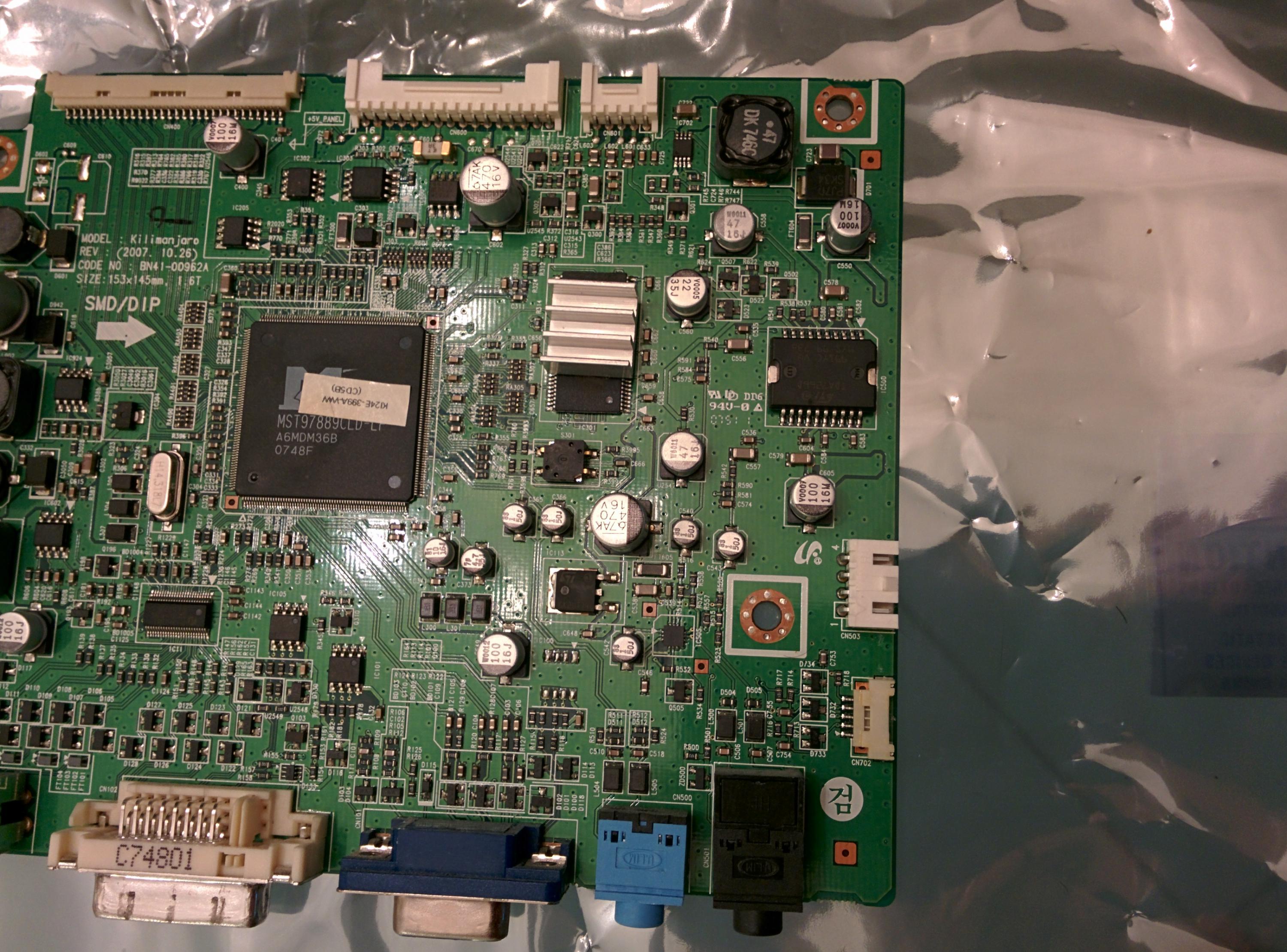

    Background: I swapped out the original power board with an eBay seller about a year or so ago. That being said, I decided to pull the controller board to visually inspect it as it may be the cause of power board failures or the failure itself this time. The controller board has a rattle sound, if I had to explain it a bb in a small can.
    Additional Notes: I have a multimeter if need be and am willing to take any additional photographs if necessary.
    While I'm technically inclined I am not an engineer and/or have no repaired surface mount components like many of you. I am willing to try though so thank you in advance for any time you contribute!

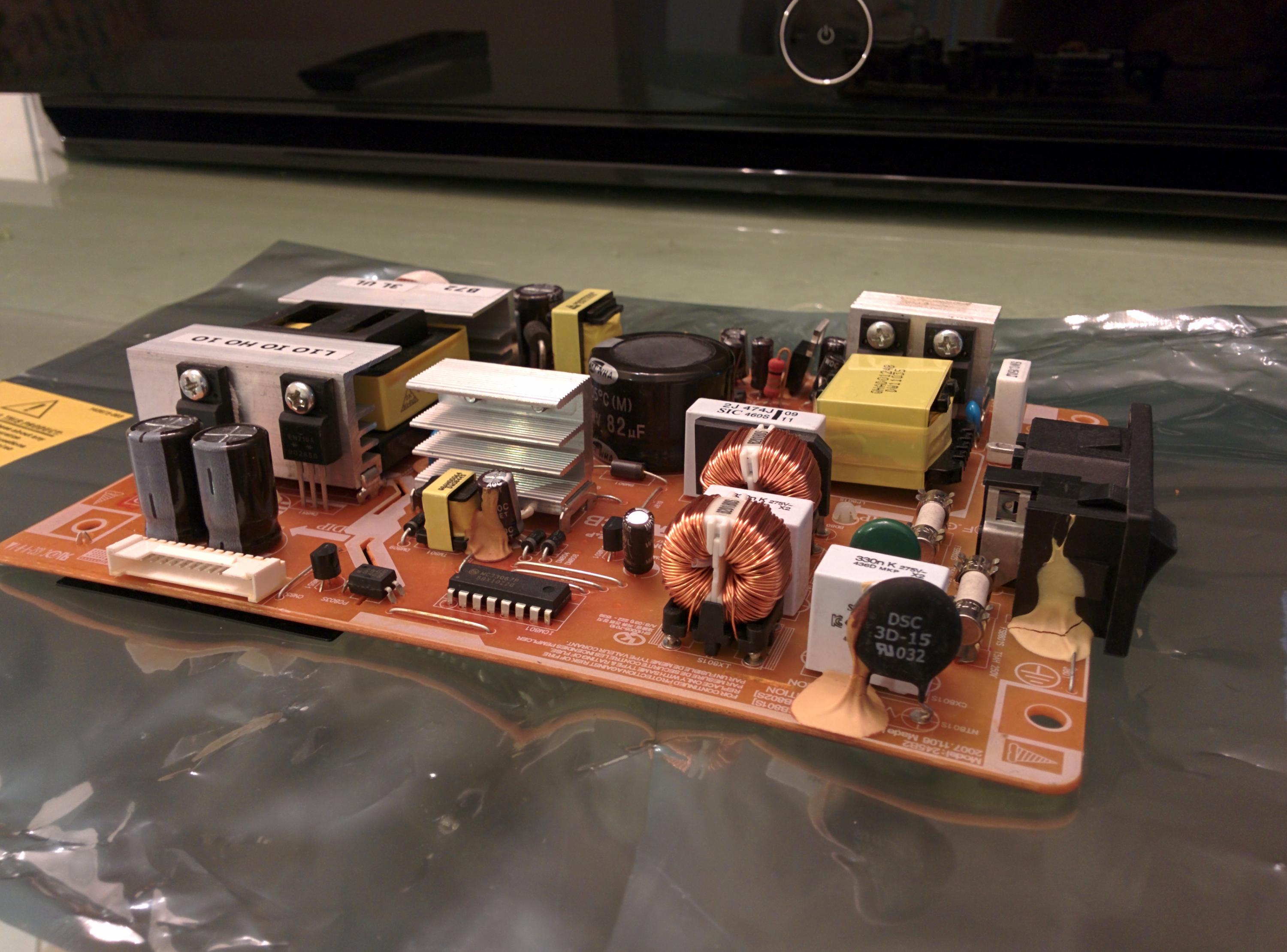

    Re: Samsung 2493HM - Power button blinking: BN44-00195A & BN41-00962A

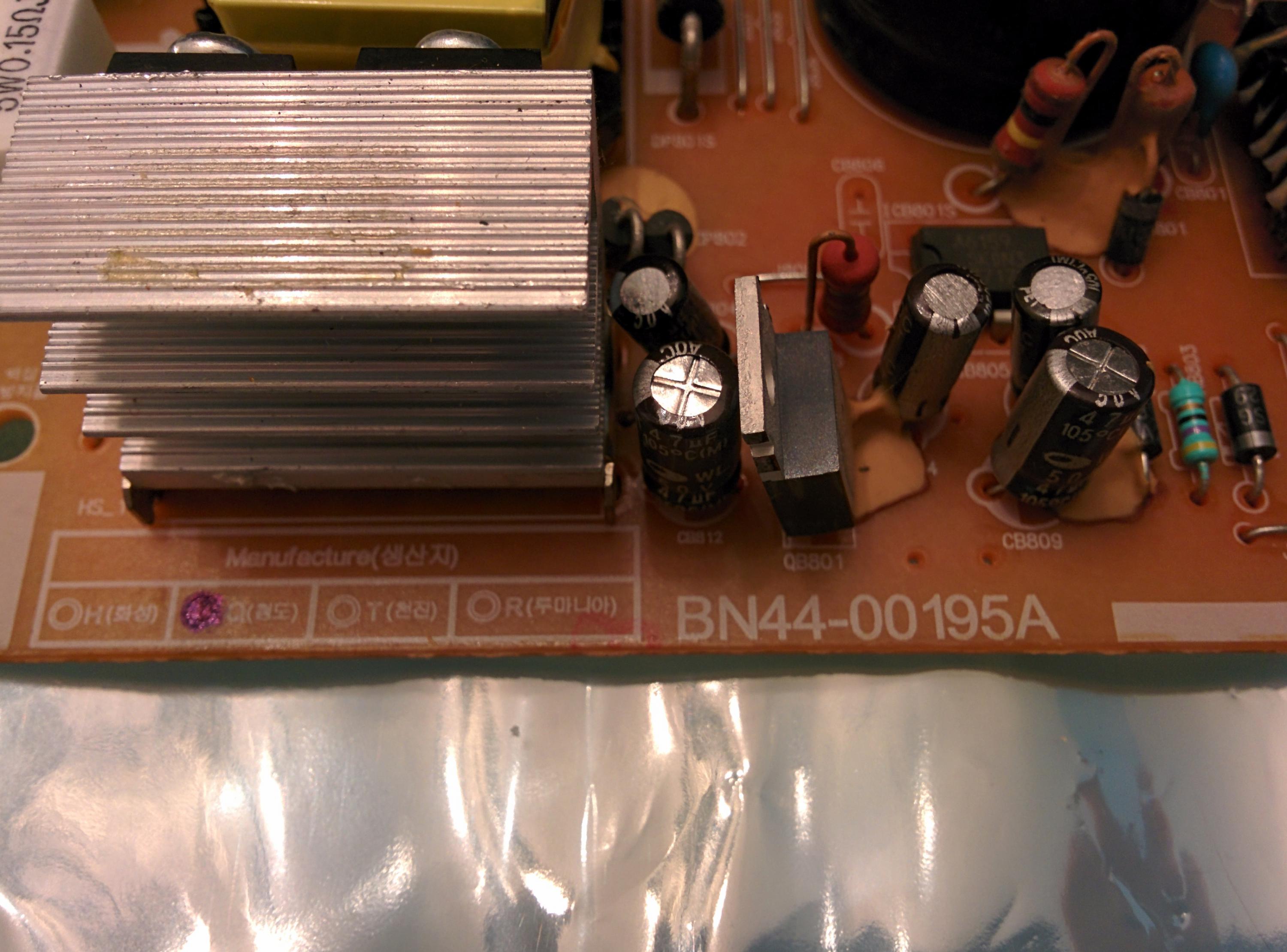

    OK - there are many threads setting out the problems with this board.
    First major task is to remove ALL the brown glue. It is corrosive and conductive.
    Check all the components it touches for rot.
    Glue might be softened with IPA but needs scraped away with a dental pick, sharp blade - being careful not to damage the board.

      Thanks, yeah I did some research on the power boards last failure and have been searching here all morning. Thank for mentioning IPA, I keep reading to remove it but no one said with what! I'll start on that shortly and post pictures of my results/findings.

      • selldoor
        Slow Learner
        • Dec 2010
        • 7870
        Originally posted by techLTE
        I'll keep searching for an explanation for the main board rattle, it just can't be normal.
        I can probably answer that - will give you more time for clearing the glue
        I think it is normal - it is a physical rattle yes? like when you shake/turn the board.
        It is a rotatable screen and has a switch S301 which has a ball bearing in to
        switch the display to match the screen.

            I am trying to fix a monitor with exactly same fault. In may case I had to replace to fets QM802/803 and power resistor RM801, zeners DZM802/3/4/5. Then DZT851/2, RT852 and QT851 as well as all electrolytic capacitors and the board still generates a fault.

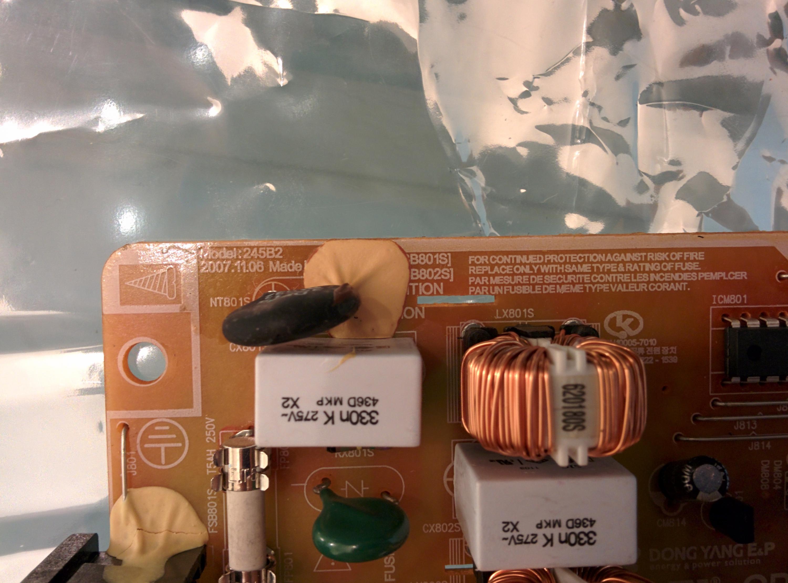

              Thanks, I think that's it. As for this glue, it's killing me. I'm having a tough time getting this stuff off.

                      Tonight, I repaired this power supply. I replaced two faulty FET's (FQPF9N50C) and the 0.22Ohm resistor. Besides, I desoldered the transformer between the FET's and IC MC33067P and removed all the brown glue. I soldered the transformer back and removed some brown glue on other parts. I preventively replaced the two 1000uF capacitors next to the white connector and one capacitor on the other side of the board next to the leaning diode. Fortunately all other smd diodes, zener diodes and resistors were OK. The monitor came back to life again!
