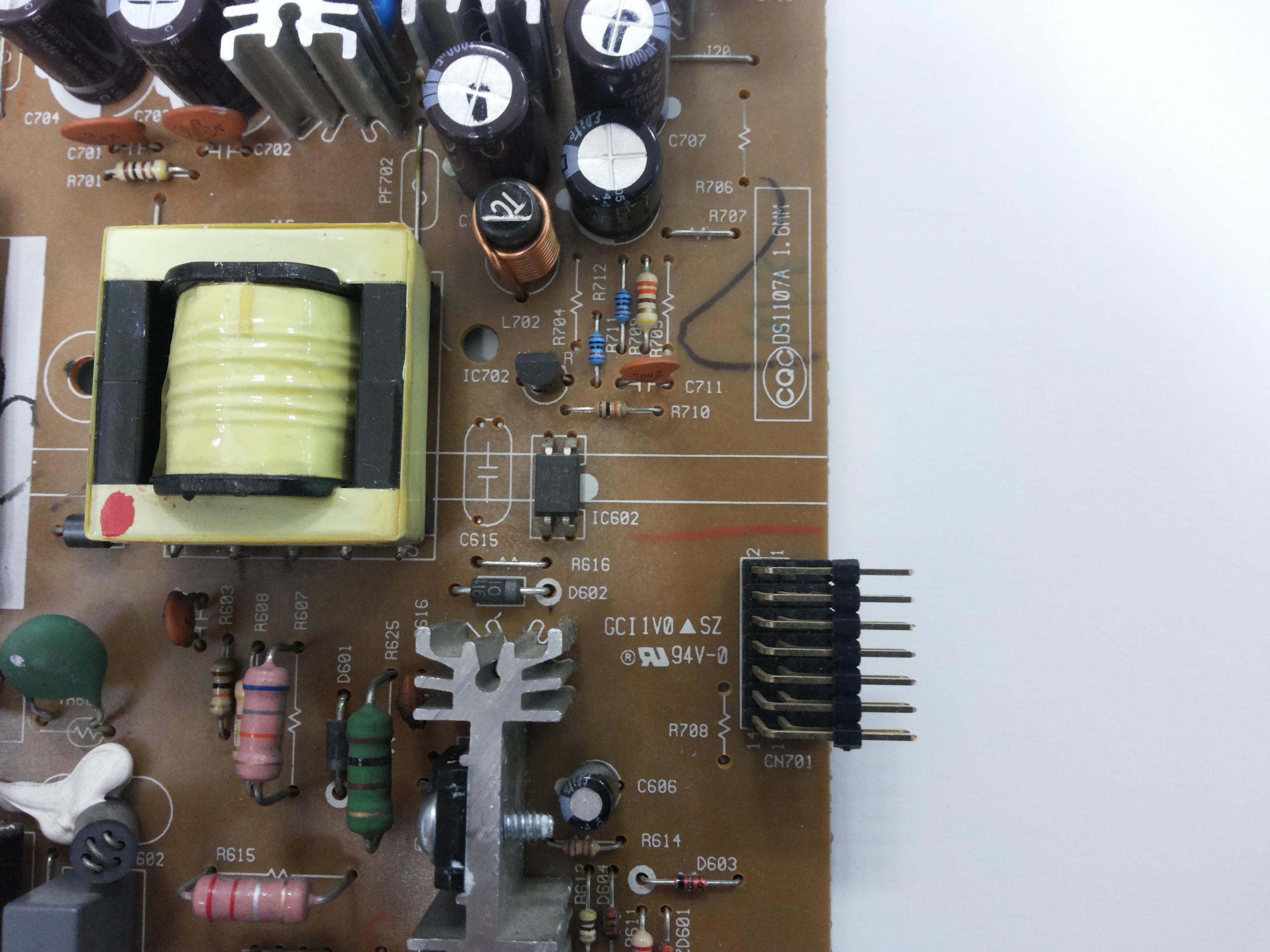

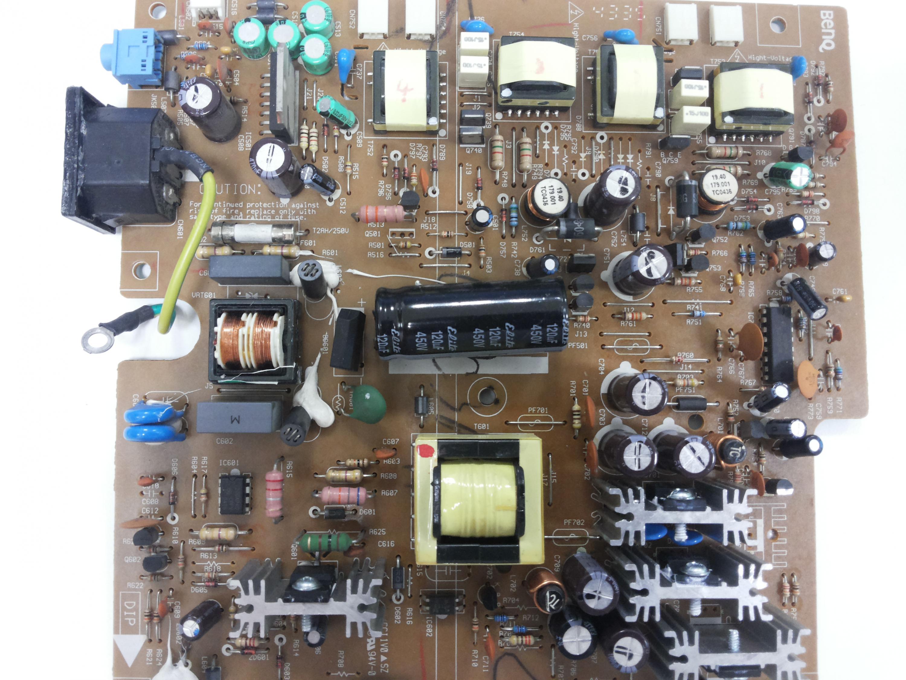

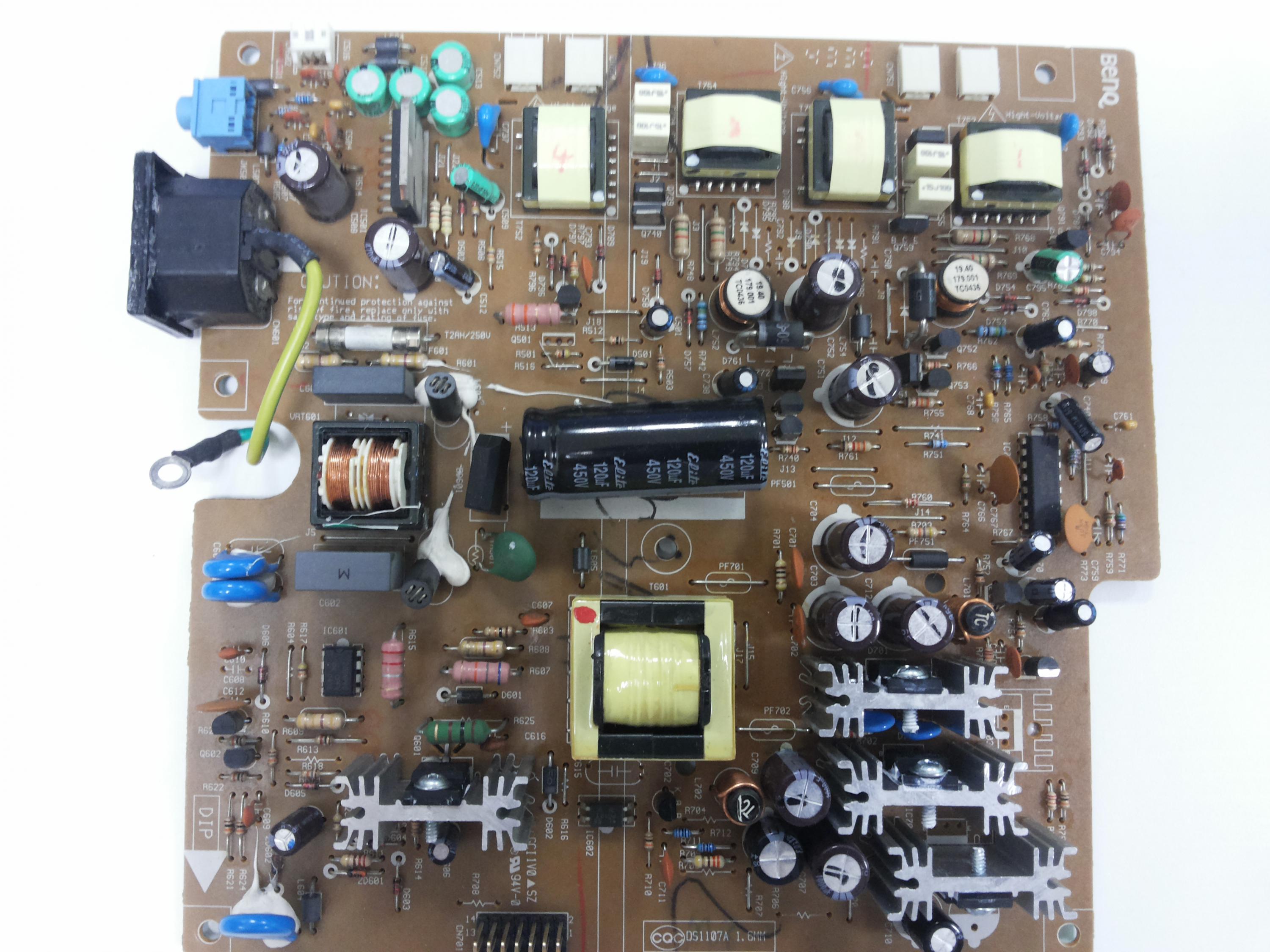

    Hi guys,

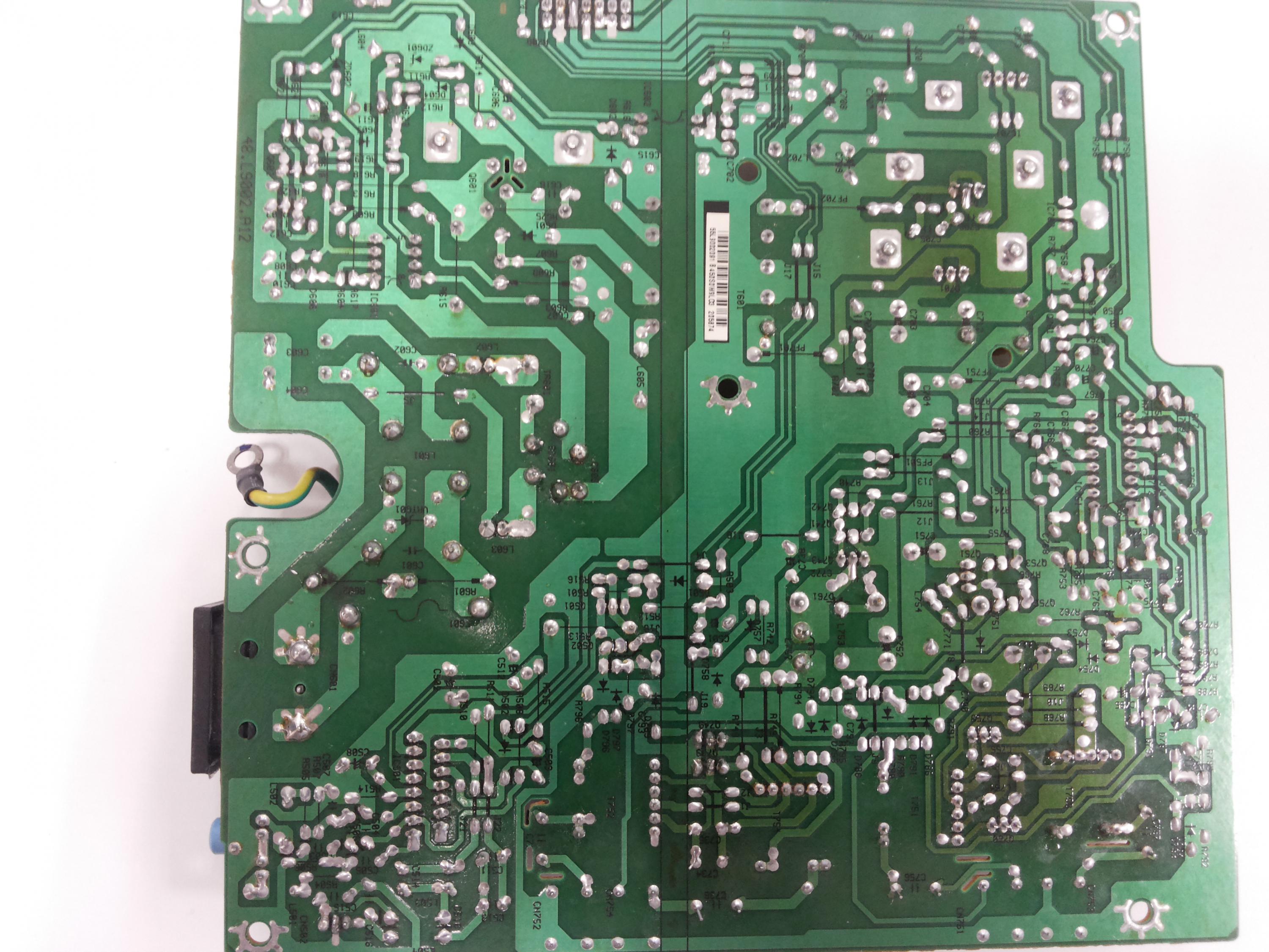

    I have this Benq Q7C3 Monitor that had no power. I replaced the Bridge rectifier and also the fuse and it turned on.
    To my surprise it still didn't work, it started with a faded black display which started to turn into a white screen until it was completely white.
    Every time that I turn it on the same thing happens.
    I checked the C5707 transistors but none of them had a reading less than 50 ohms.
    Can someone please help me out?

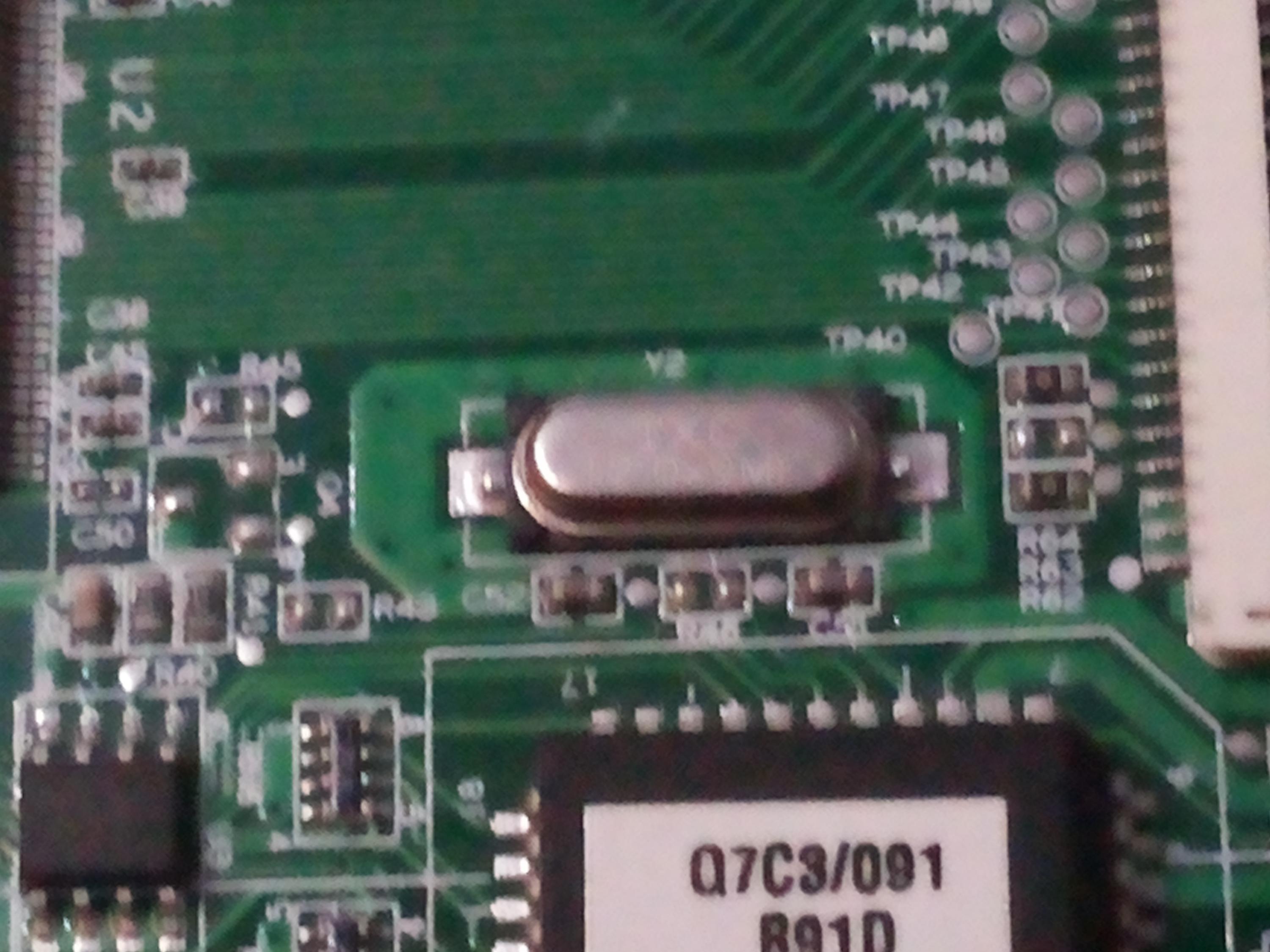

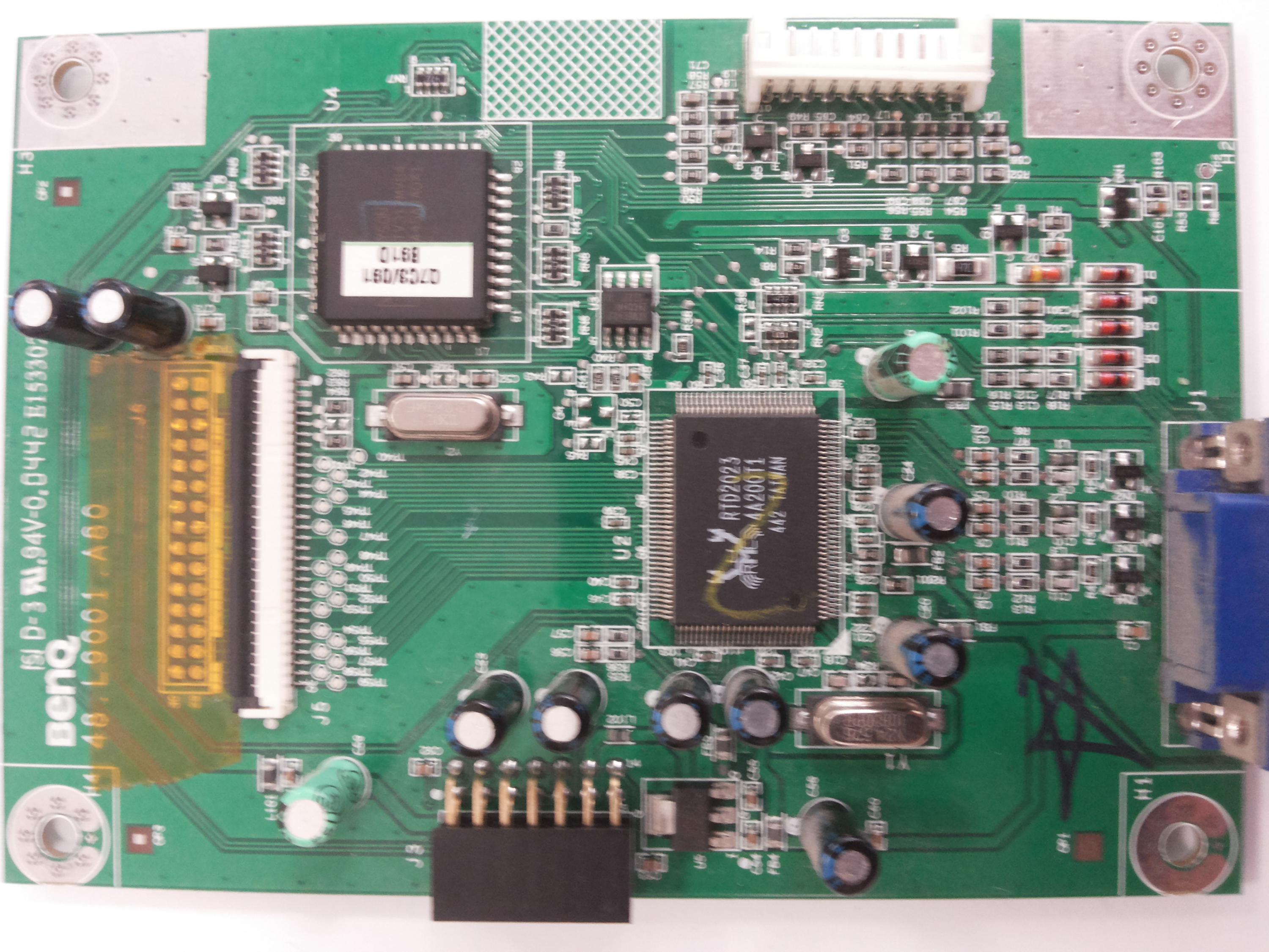

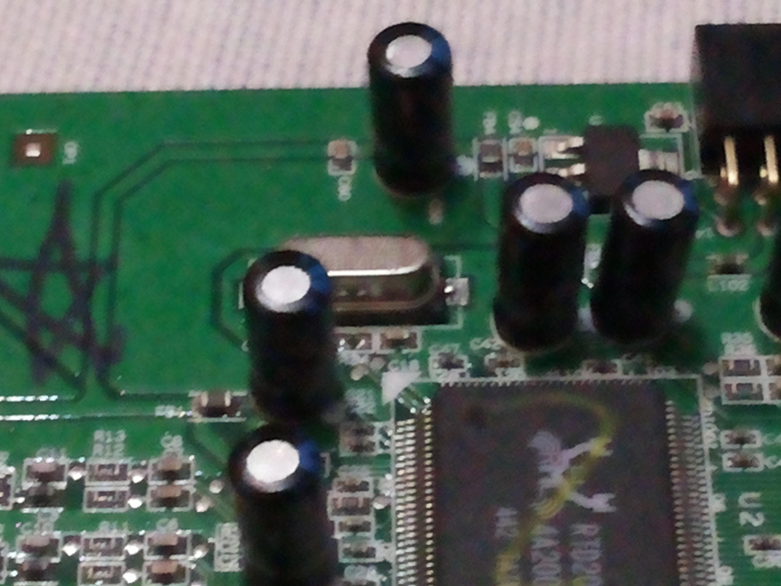

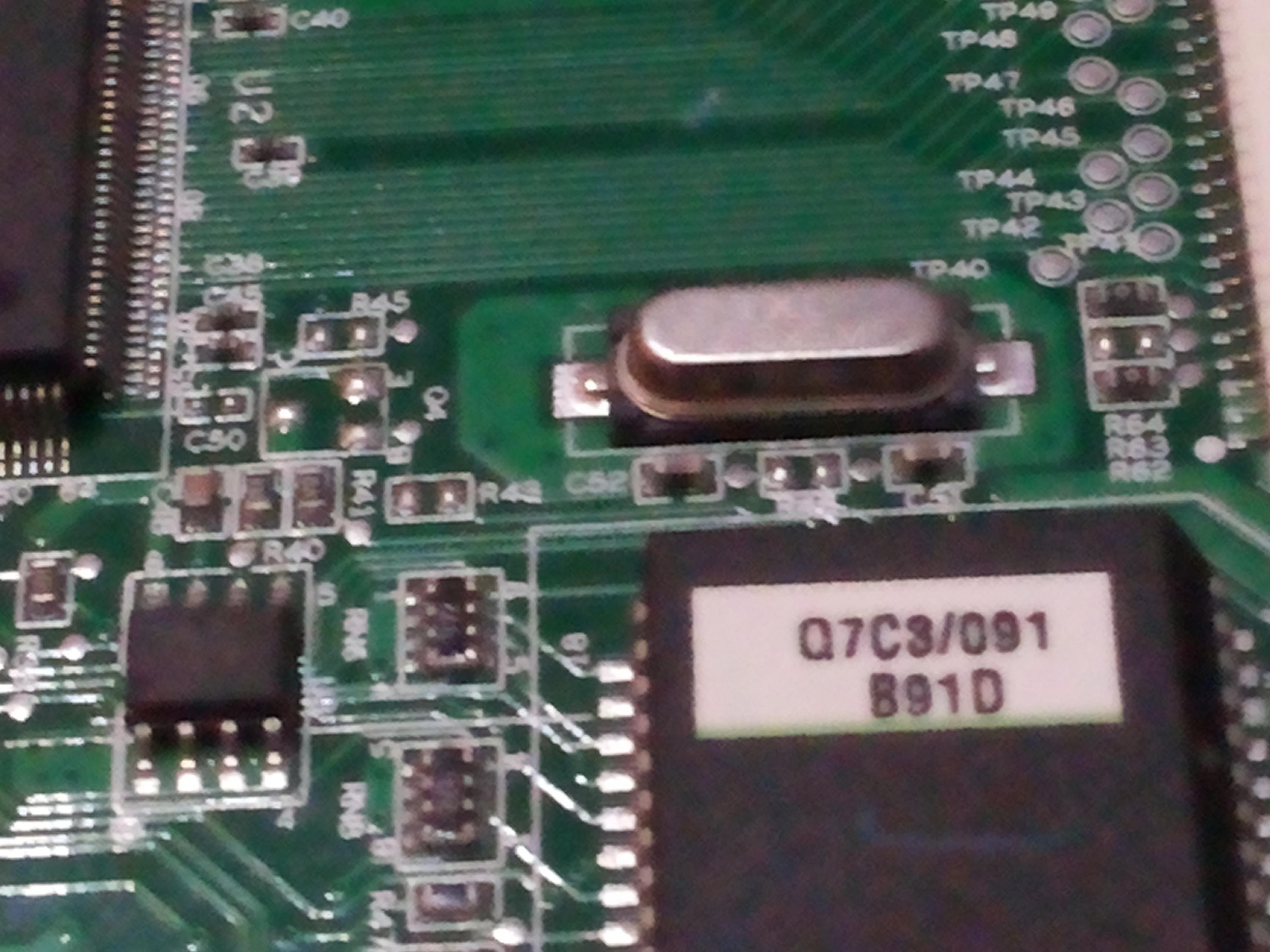

                    Perhaps you can post a photo of the tcon board?
                      Re: Benq Q7C3
                      Sorry, I must have forgot to post the photos. Attached I am posting also zoomed photos.
                      Any comments?
                        Re: Benq Q7C3
                        Ah, a picture says a thousand words. What you're looking at is not the tcon board, but the main/logic board. The tcon board should be located at the top of the panel and span almost the width of the panel.
                          Re: Benq Q7C3
                          Scroll through the pictures in the link on post 5.

                              Re: Benq Q7C3
                              I only have two boards, the power board and the video board (T-Con Board).

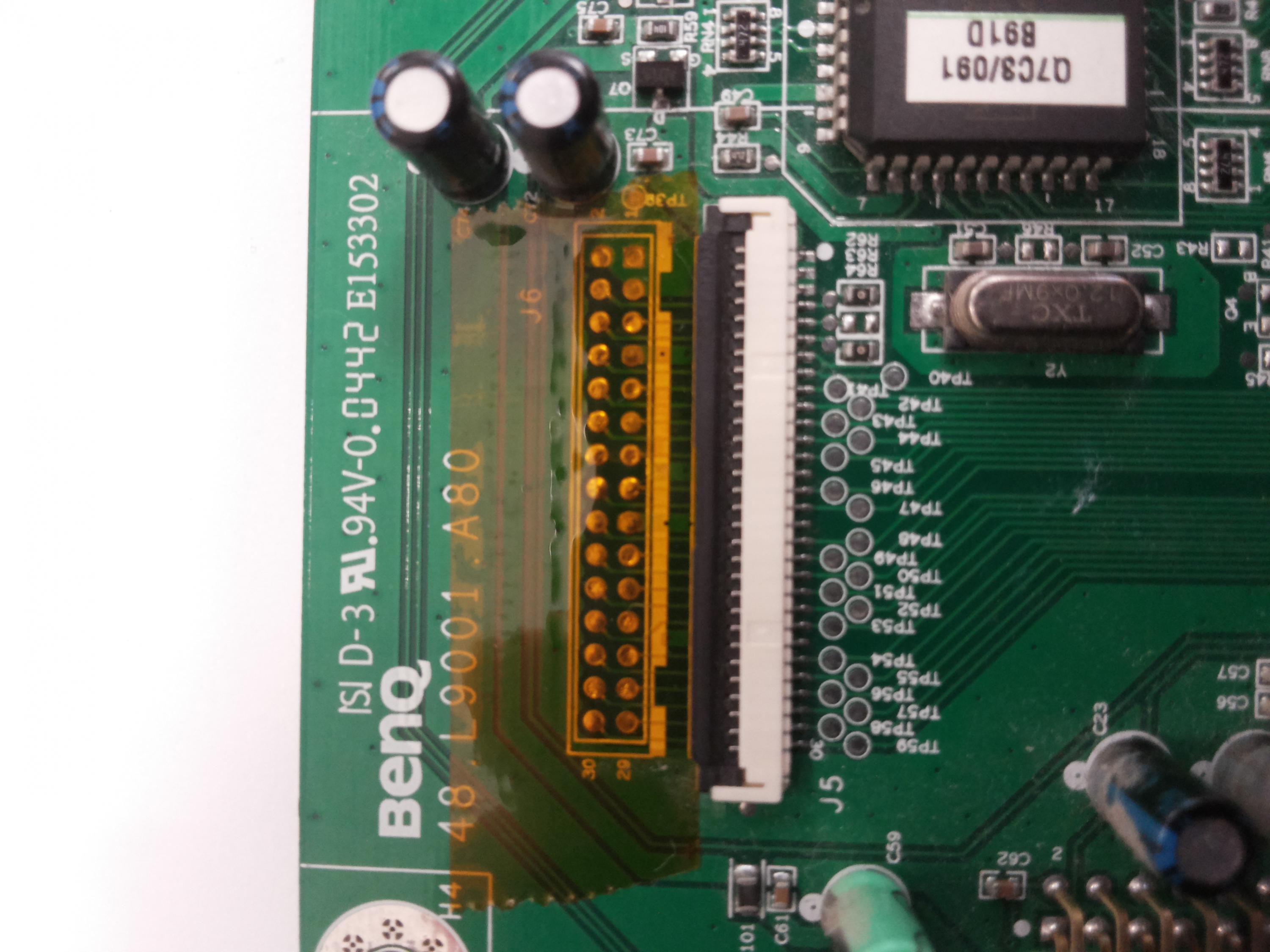

                                  Re: Benq Q7C3
                                  In post #11, first photo, I believe the leftmost connector should have a flat ribbon cable connected to it. Correct? At the other end of that cable should be the tcon board.

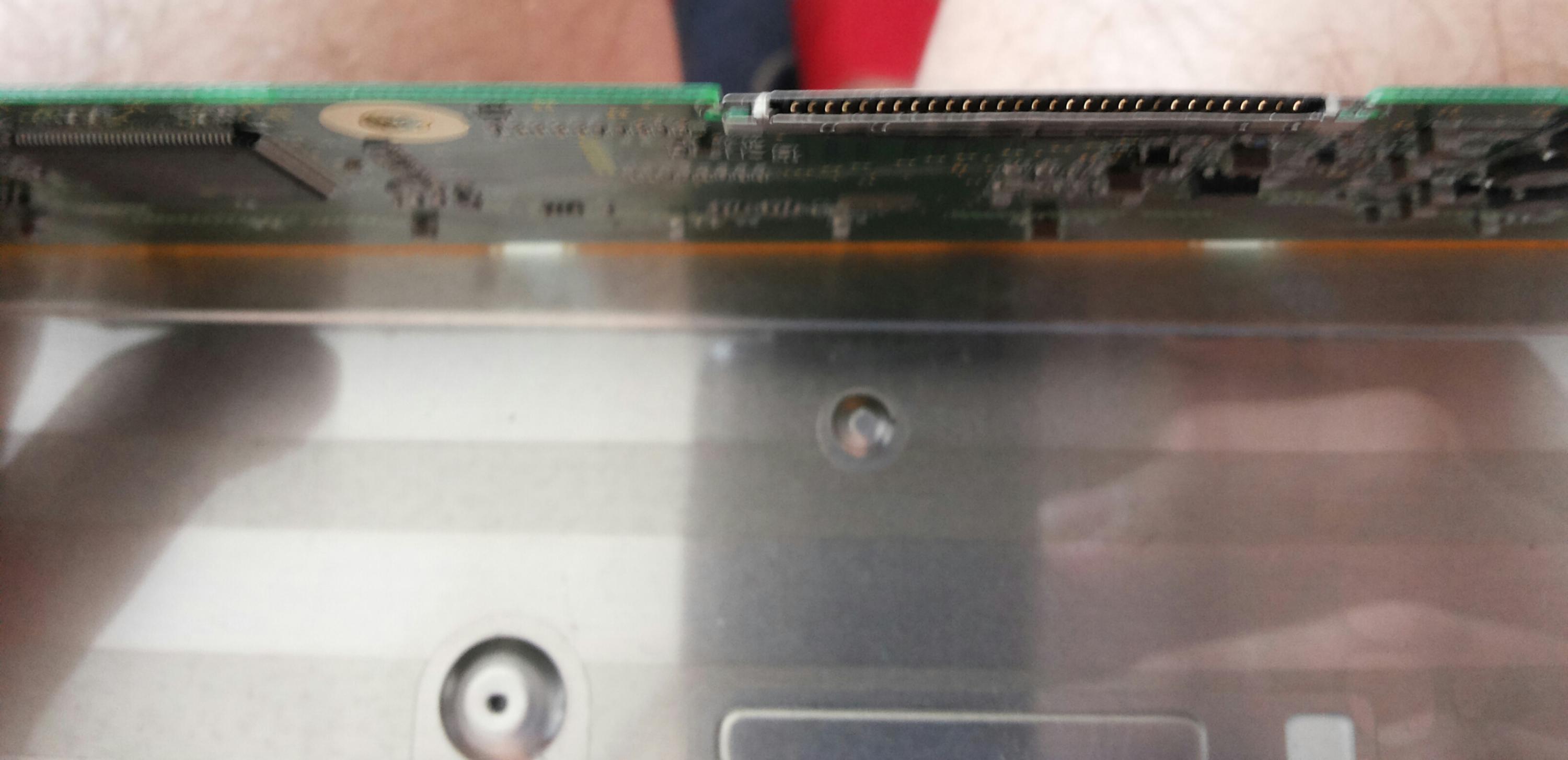

                                    Re: Benq Q7C3

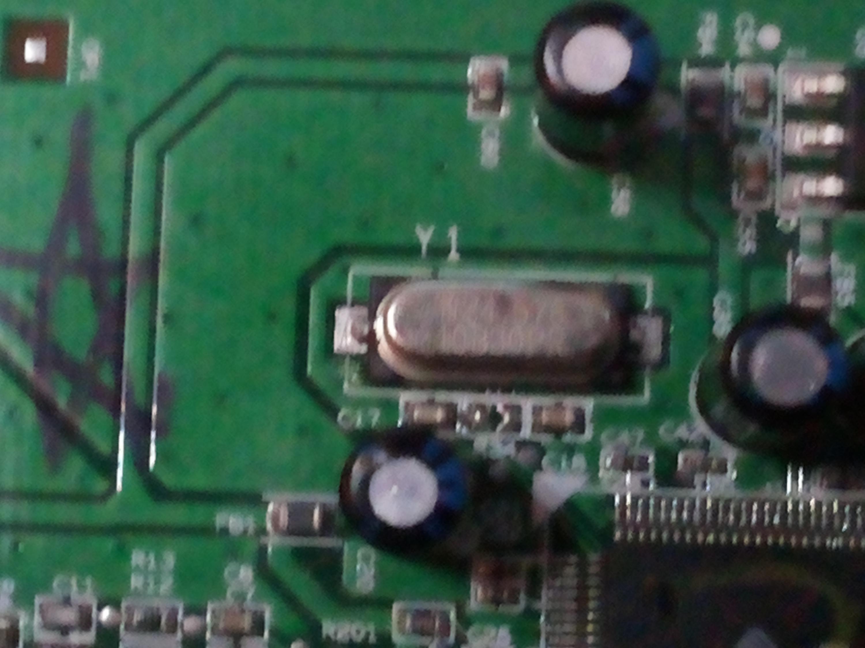

                                    Thank you bud, I figured out that that is the T-CON board. I found out what the problem is.... the fuses are fine but the connector where the ribbon cable fits in is damaged. When I press it with my finger the picture will come up.
                                    I attached some pictures for everyone's reference.
                                    Any clue where I can buy one?

                                        Re: Benq Q7C3
                                        Guys,
                                        Thanks for all those who have helped me, the monitor is now fixed.
                                        I did put a piece of plastic to make pressure on the connector. I then used duct tape to make it hold still.
