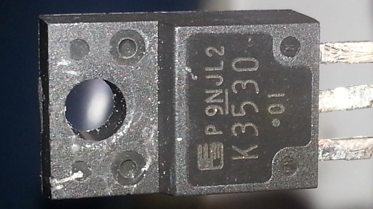

        But still unable to find the MOSFET by its part numbers and I dont know how to find the specs of it to know what to replace it with. I'm posting a pic of each if it helps.

          Part code 2SK3530

            Thanks I found it,
            http://www.mouser.com/ProductDetail/...%2fShmbA%3d%3d
            But if I can ask how did you come up with that part number? I tried searching K3530 and could find anything.

              2SK is very common,and lots of manufacturers now omit the 2S..so if you see a transistor etc starting with K always try 2SK..

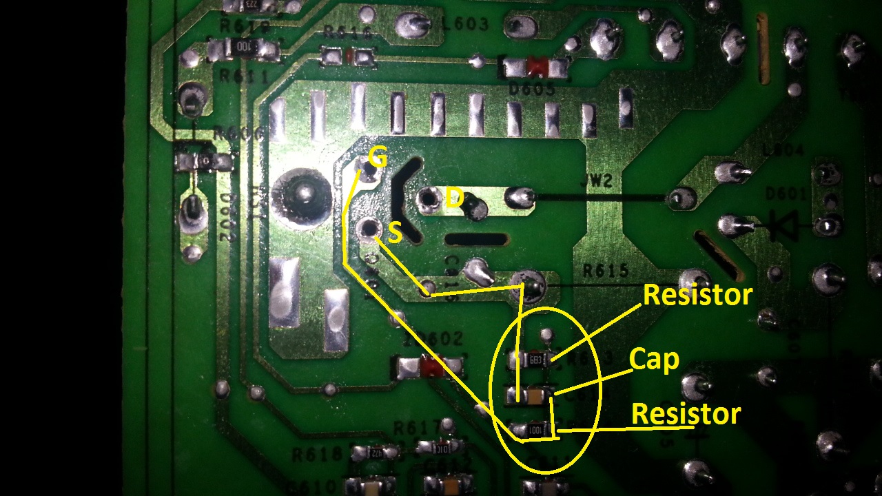

                  I assume that a fuse also needs replacing ?//alsoif you look at the 2SK mosfet the right hand pin is the Source,and normally there would be a very small value resistor connected to that pin,the other ens of the resistor going to Ground..the value will probably be somewhere in the region of less than 1Ω.When Mosfets fail by going short circuit, this normally burns out as well.

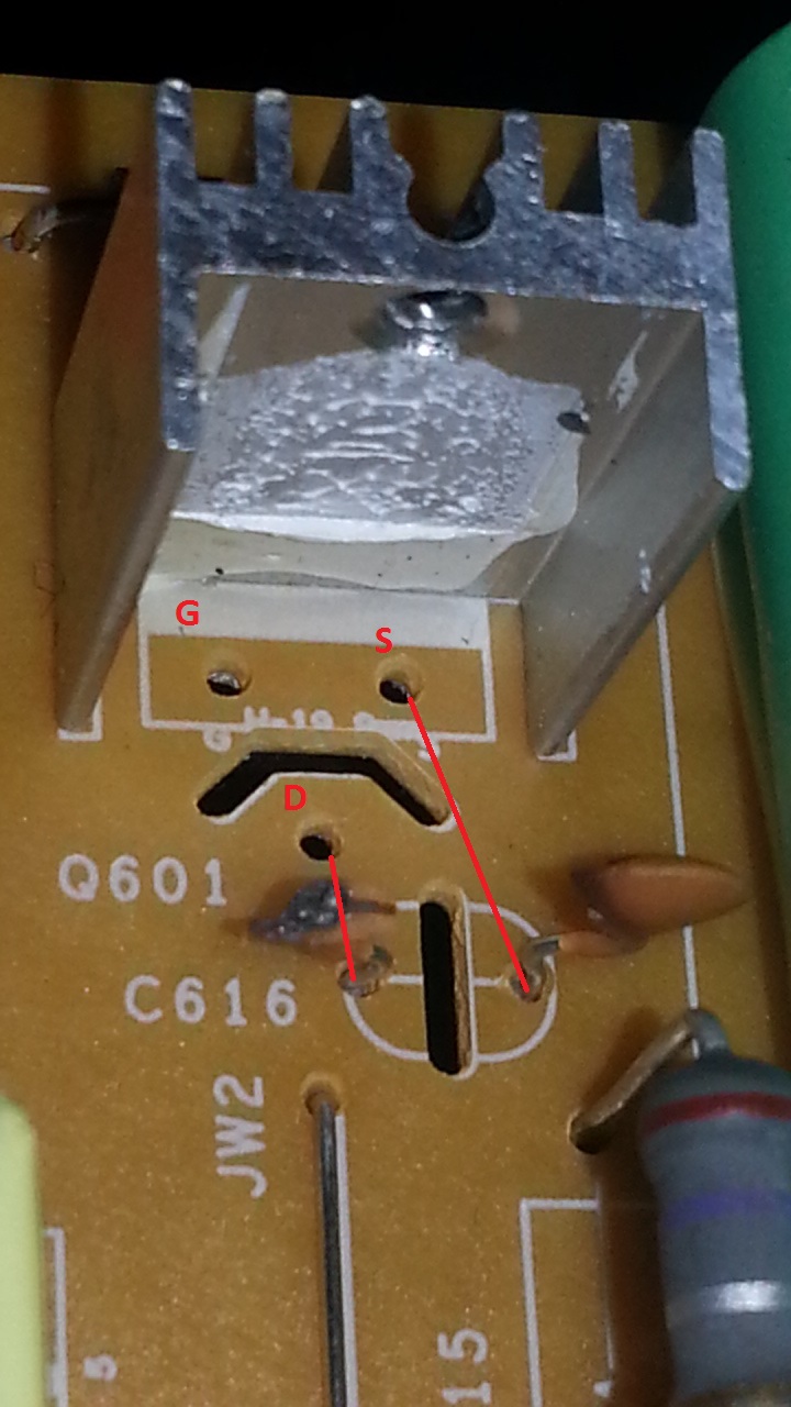

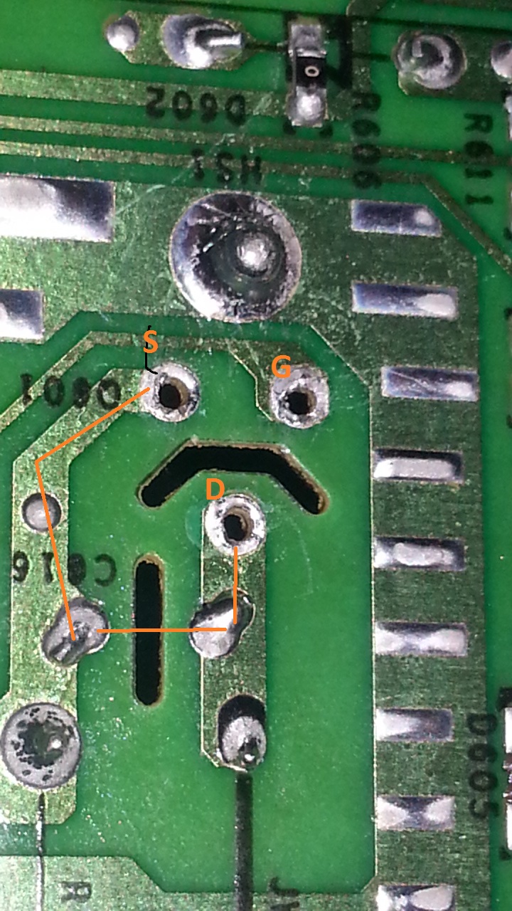

                    I've already got the fuse on my list to order. I've looked over the board both sides and and I dont see any resistor attached to the source and ground pins. There is a disk cap connected to the source and drain pins as posted in the pictures attached. The cap had burned out and I have that on my order list as well. I labeled the source ground and drain along with the links in between them.
                    If you look post #7 or #9 pictures there is a resistor (Next to the DC Filter Cap) its on the source line but doesnt connect with the ground.
                    I hope I explained this well enough if not I will try again to explain it better.
                    *** I added another pic that links both source and ground with 2 resistors and cap in the middle,maybe this is that you mean.

                      By any chance, that snubber cap (connected to Source and Drain) tested shorted? That is the Source resistor, one end should be connected to the negative leg of the main DC filter, the is the Ground point of the Primary (hot side) of the circuit.

                        Yes that cap between the source and drain shorted/burned out and the resistor (grey next to the main DC filter cap) is connected to the neg lead and the other to the Primary pos
                        pin 1 SO I will check that resistor and make sure it is with in spec. According to an app i found a while ago you can input the color of the bands on a resistor and it will tell you the resistance this one says .27 ohms +/- 5%
                          #32
                          Re: Asus VE205
                          That is about the right value for Source resistor.
