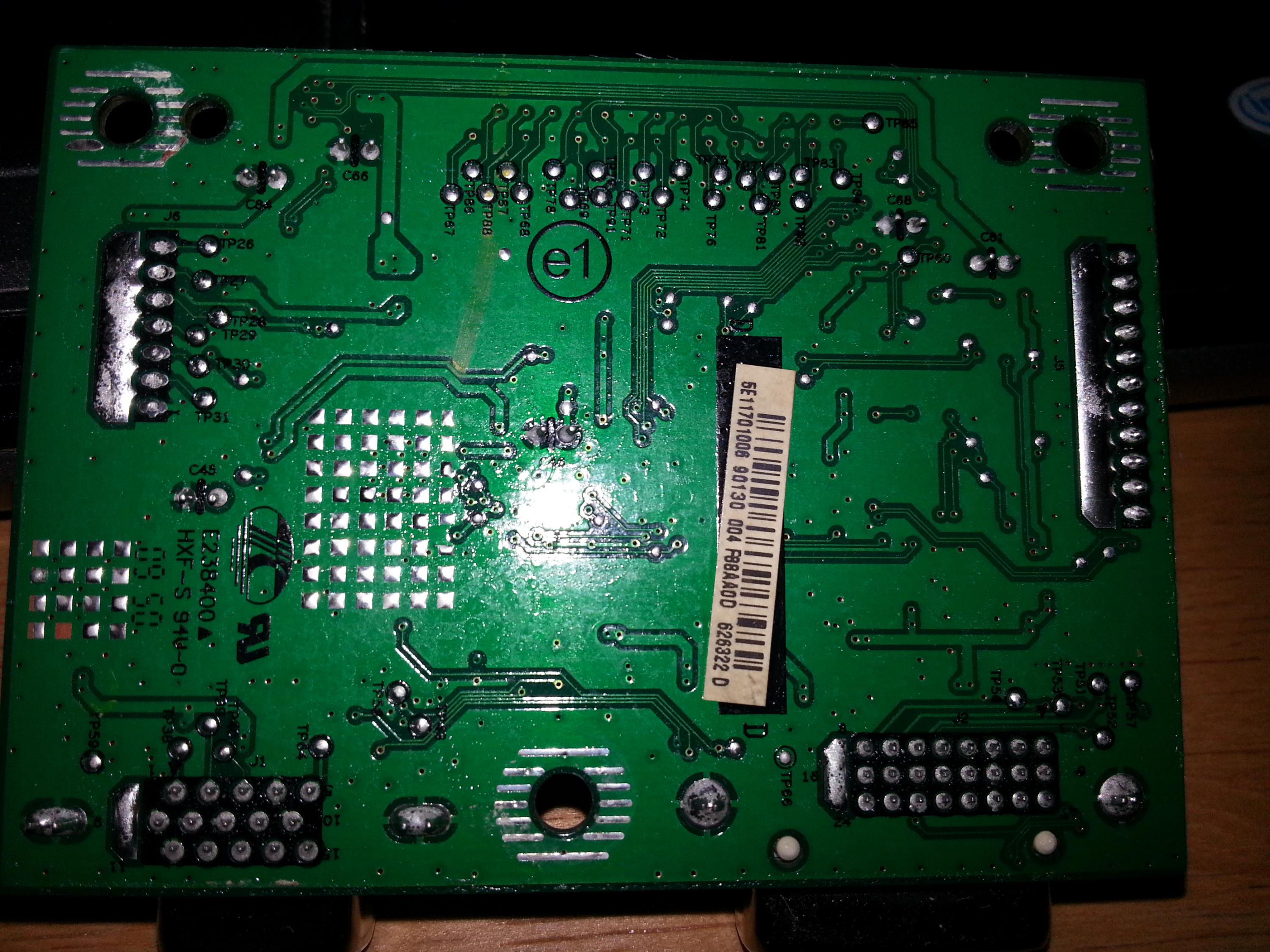

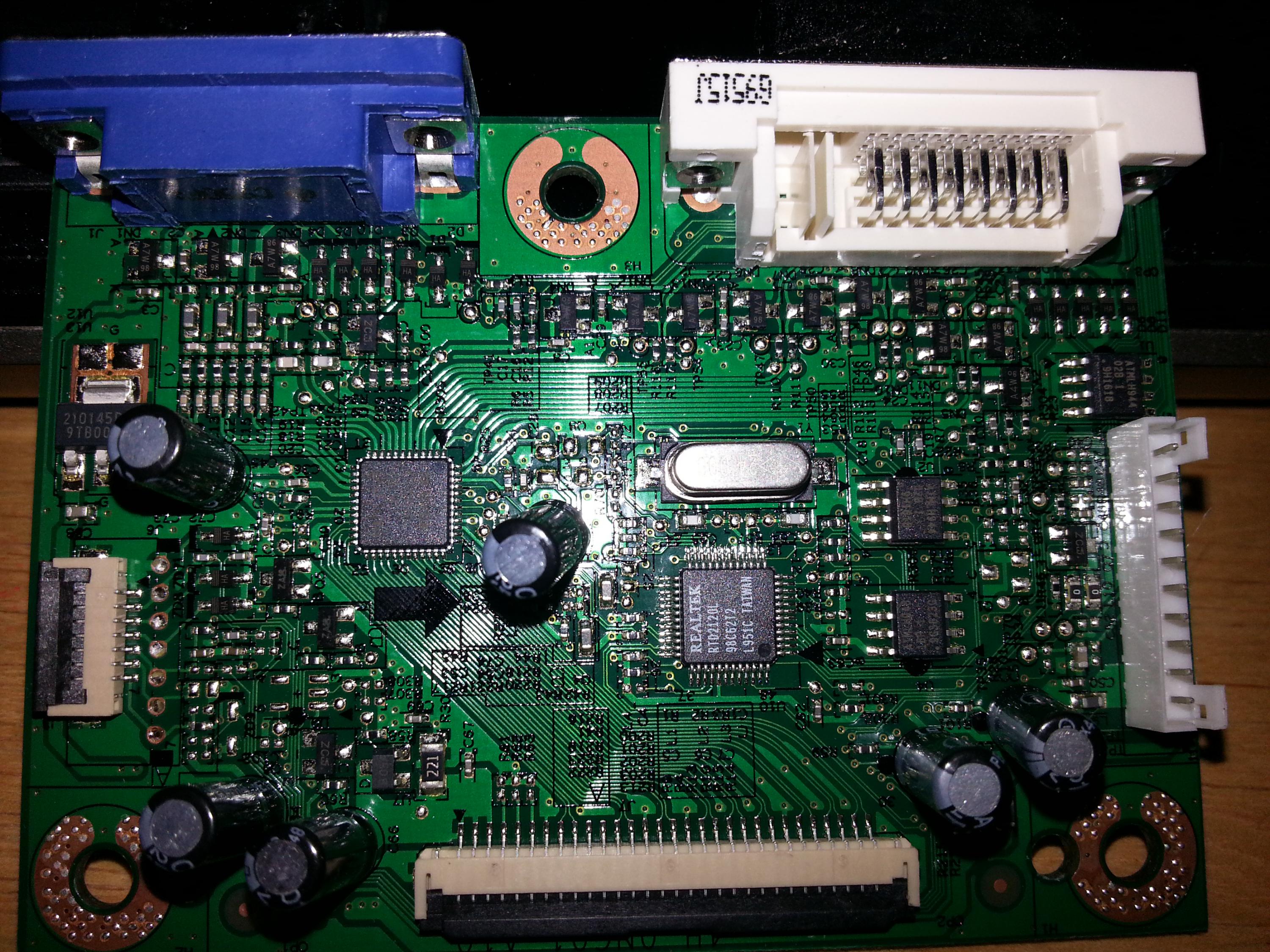

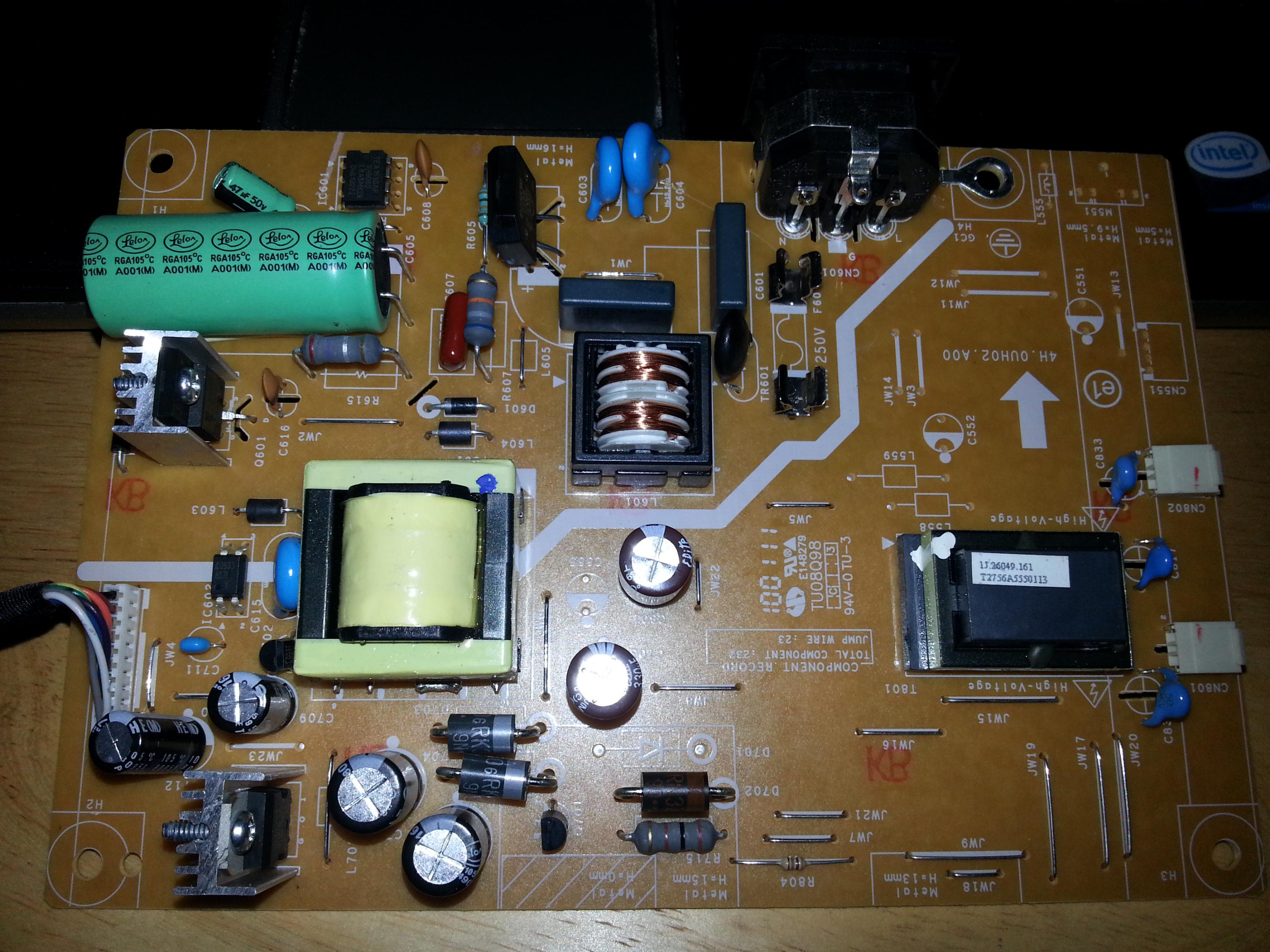

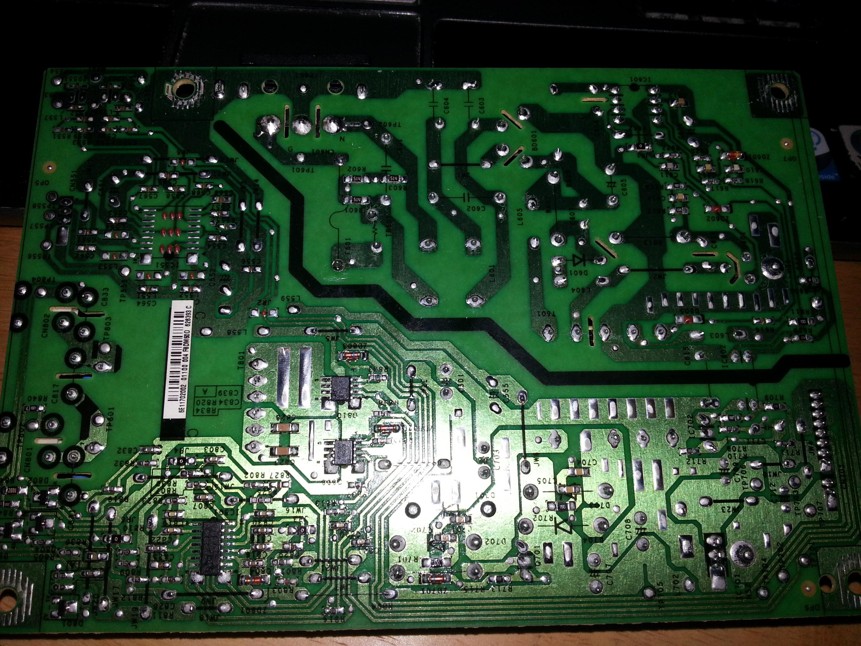

              Ok I pulled the monitor back apart to get a live reading and take pictures. Plugged the board in and tested the 2 legs of the big cap with DMM and shows 0
              No power.... unplugged it and tested the fuse again... Blown (although it doesnt look blown, not black marks)......DMM reads 1.
              SO first I need to figure out why i keep blowing a fuse?
              I've added pic of both the power and signal board fronts and backs.
                Re: Asus VE205

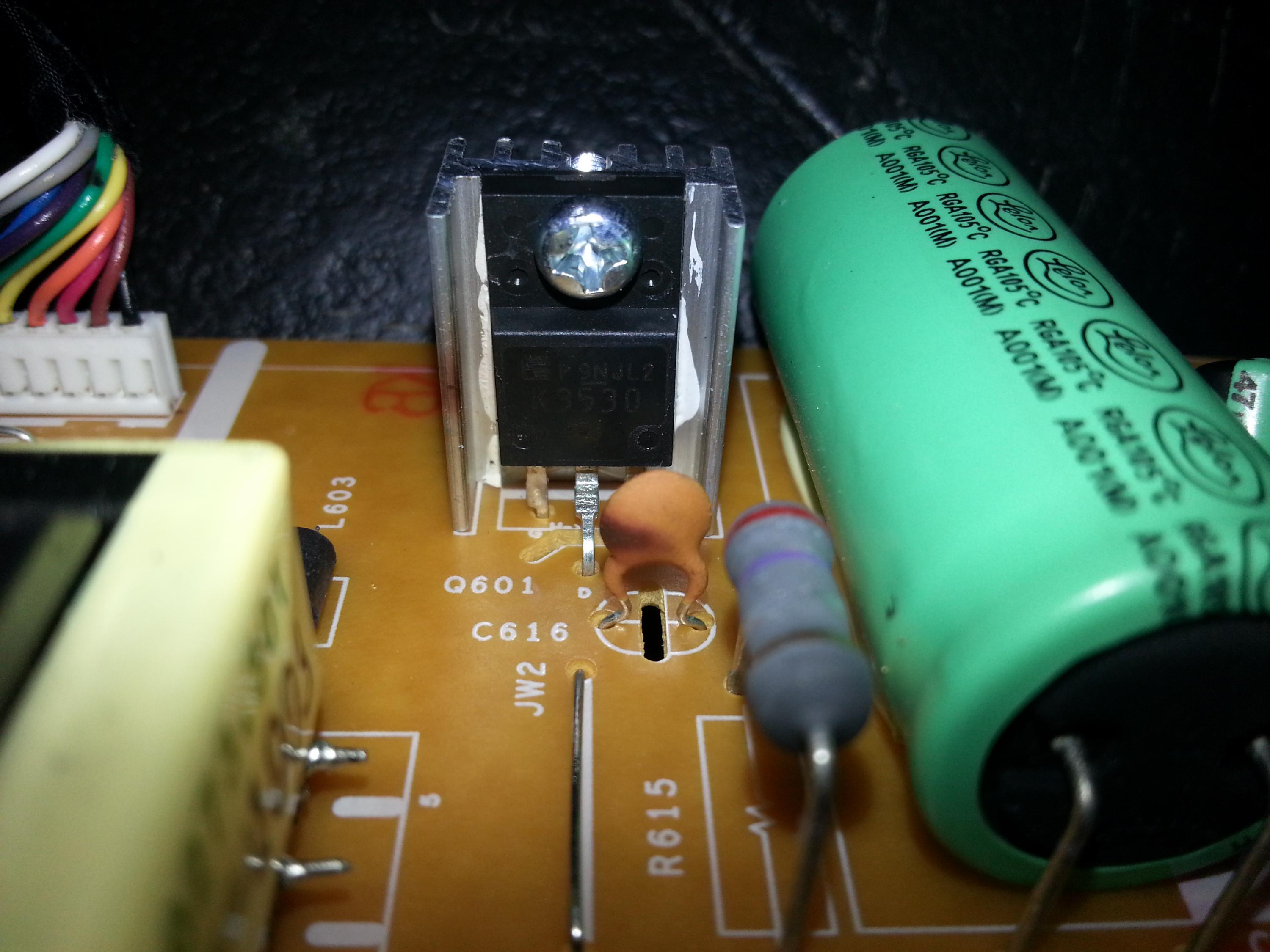

                That means it may have shorted bridge rectifier, shorted out Power MOSFET (the one next to that big green main DC filter cap).
                  Re: Asus VE205
                  Is there a test to confirm that?
                  the numbers on that bridge rectifier are
                  first line: p9njl2
                  Second line: k3530
                  While trying to read the numbers I noticed the Orange Cap (just in front) has a brown burn mark and a hair line crack.
                    Re: Asus VE205
                    You can Google how to test bridge rectifier with meter, the MOSFET on that heat sink, just measure the combination of the 3 pin, as you look at the MOSFET facing you, make left pin as pin 1 then proceed to test using your Ohm meter.

                        Re: Asus VE205
                        The bridge rectifier that needs to be checked is in the primary side and it has 4 legs. It is sitting next to the small blue cap.
                        The reading that you reported on post 11, what rectifier is that one? Not the MOSFET mounted on the heat sink next to that large blue (light green?) DC filter cap? That reading you post is for the MOSFET per your picture on post 9. If pin 2 and 3 shows 004 Ohms, that is bad but can be due to that burnt cap since that cap is connected in parallel with pin 2 and 3 of that MOSFET, so take out that cap and see if the pin 2 and 3 will show higher Ohm reading with the cap removed.
                        By the way, based on the picture of the MOSFET: Left pin is Gate, Middle pin is Drain, right pin is Source. Common failure is shorted Source and Drain.
