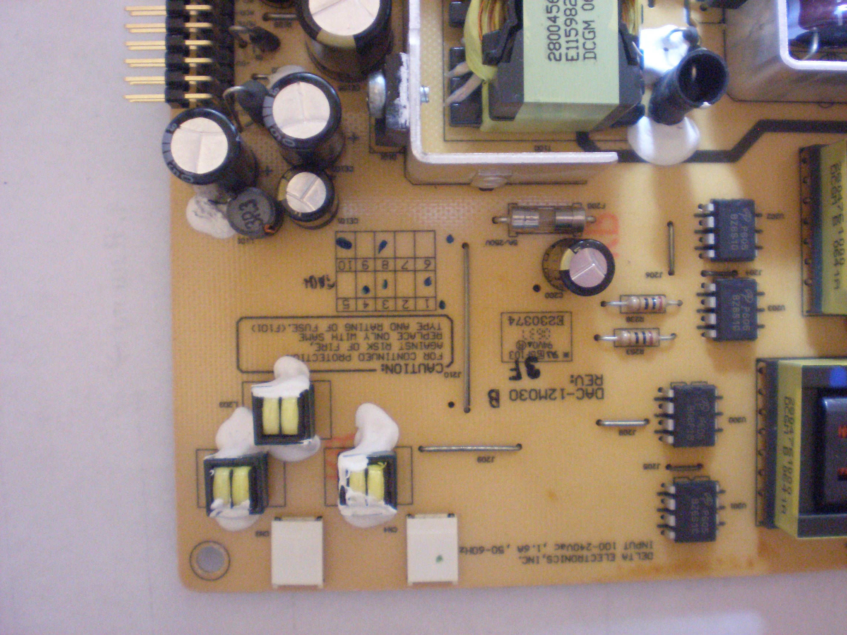

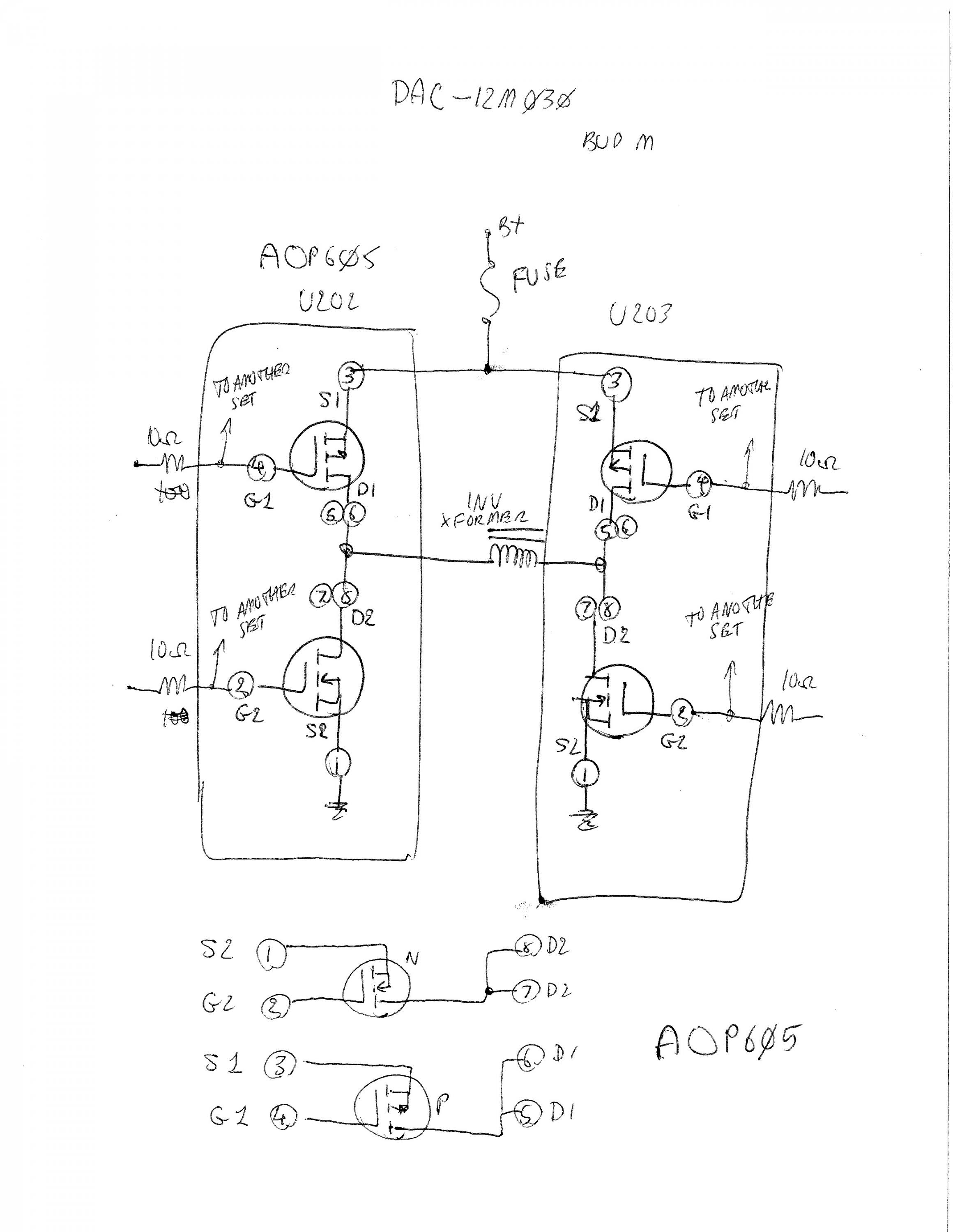

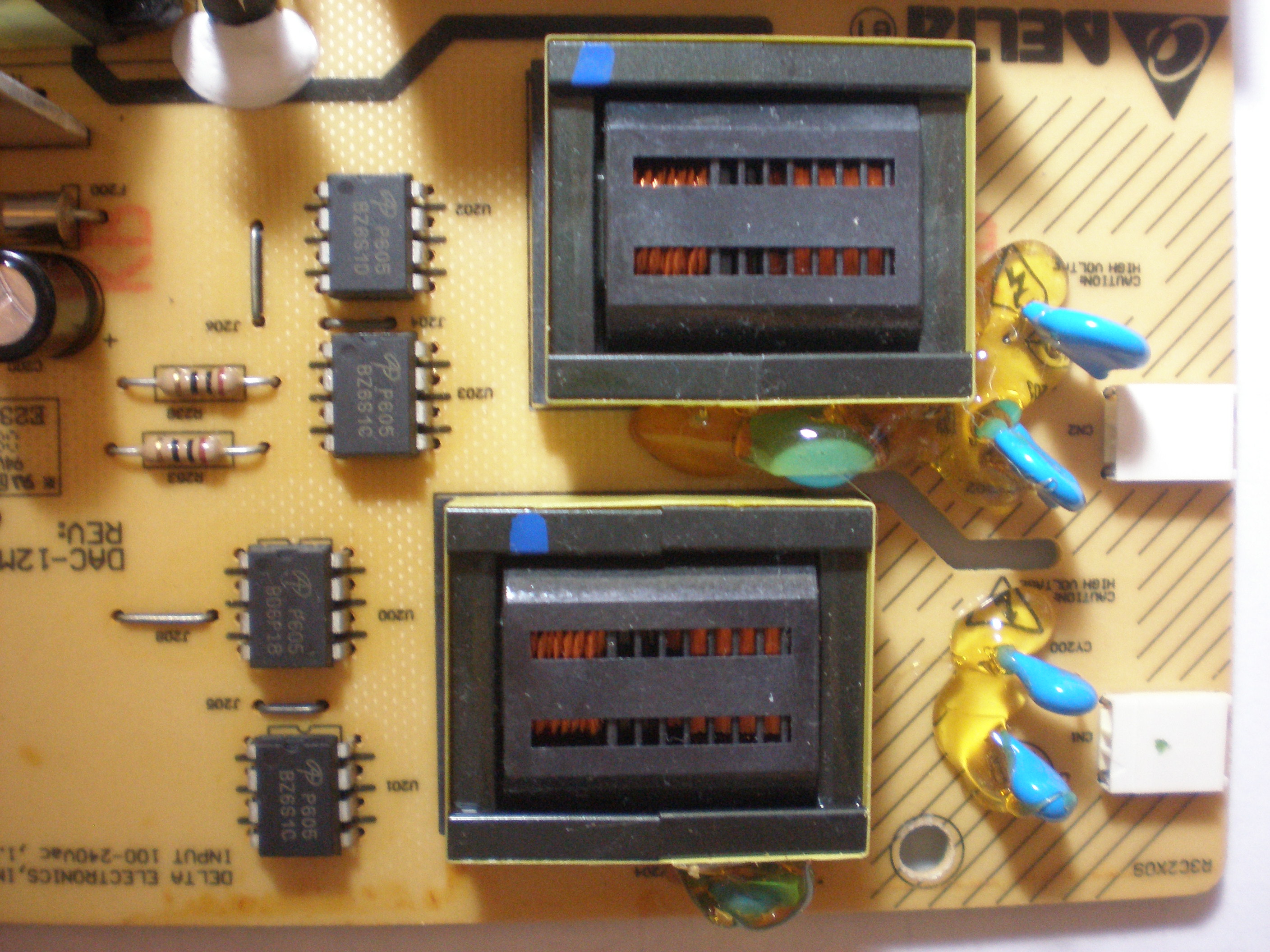

    They are connected together because it is setup as the bridge drive.
    Your Ohm reading does not make sense, for example: S1 -D1 (1) = 2.8K, S1-D1 (2) = 0.6k, that cannot be since D1(1) and D1(2) are connected together inside the IC, so the reading should be the same. The P-CHANELL MOSFET Drain is connected to pin5 (D1), and pin6 (D1) as you can see from the spec sheet.
    Did you lift one end of the fuse as suggested to see if the power supply will work?

      Here is the simplified diagram.

        I did try lifting the fuse (glass tube), but I'm going to assume I did it wrong because it didn't do anything and I didn't "lift" it completely up. I guess you meant to nudge it off the PCB correct?
        I'll be honest, that's the reading my multimeter gave me. So, either I measured it wrong or something...I'll reread it tonight and report back.
        Much better diagram and makes sense.

          Yes, lift one end off the fuse off the board completely, so if there is the short after the fuse that causes the power supply to shutdown, the power supply then should work since we isolate the inverter section from the power supply by lifting the fuse.

            Is there a particular side to lift? Also I'm going to assume to lift the part that is soldered down which "caps" in the tube. < fear of breaking it lolol.
              Re: WestingHouse 19" 19w4 LCD monitor- DAC-12M030
              Okay, I lifted the fuse whilst having the power on using a plastic pick and it did nothing.

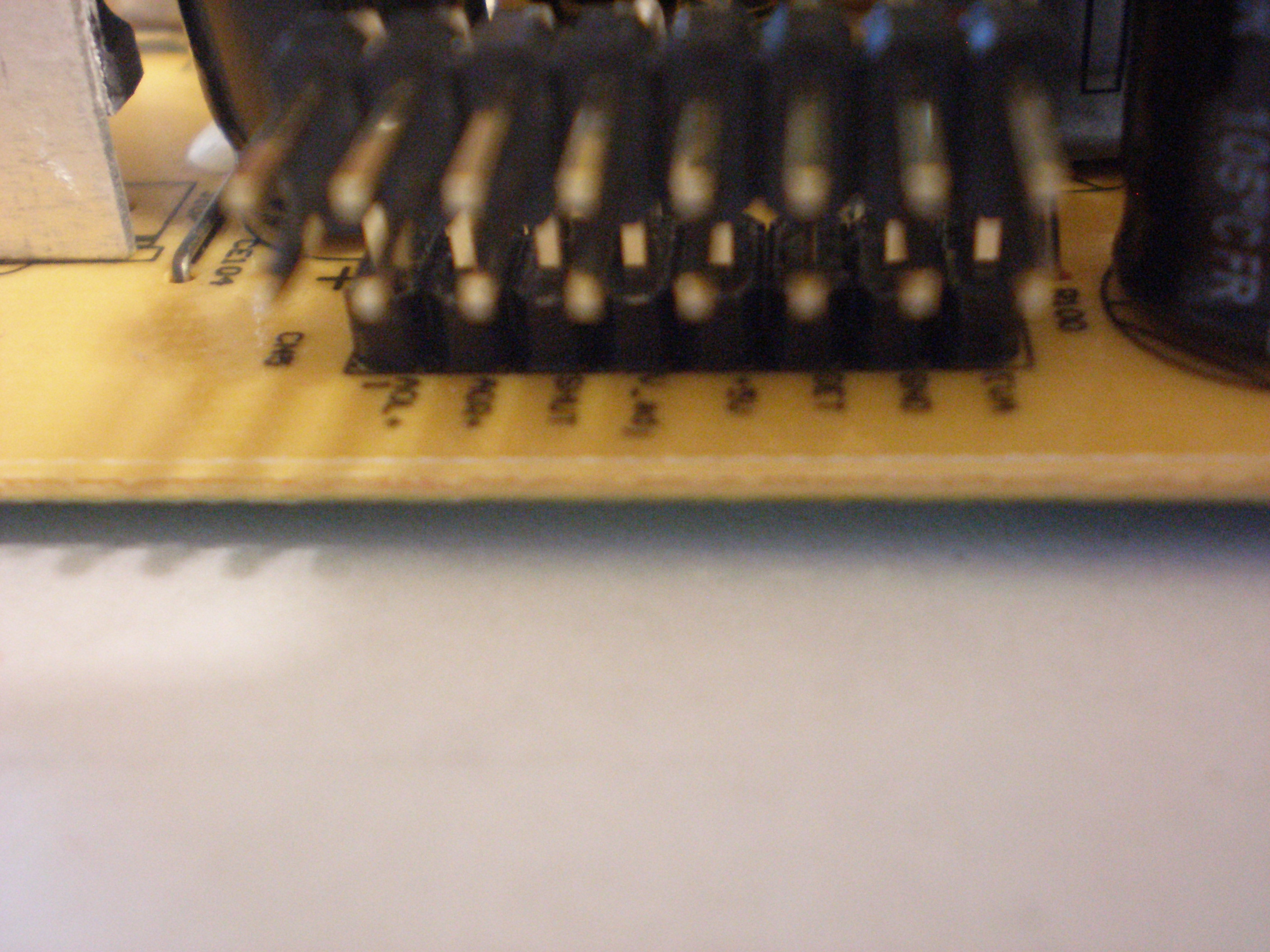

                So do you still hear the ticking noise? Any indicator or voltages on the main board at all? The power supply is an always on power supply to supply 5V for the main board and 16~20V for the inverter circuits. If you still hear ticking sound, then unplug the main board from the power supply board to see if ticking stops and the 5V and 16~20v are present. You may still have something that drawing too much current, such as shorted secondary side rectifier diodes. It is the process of elimination right now. Do you know how to test rectifier diode?

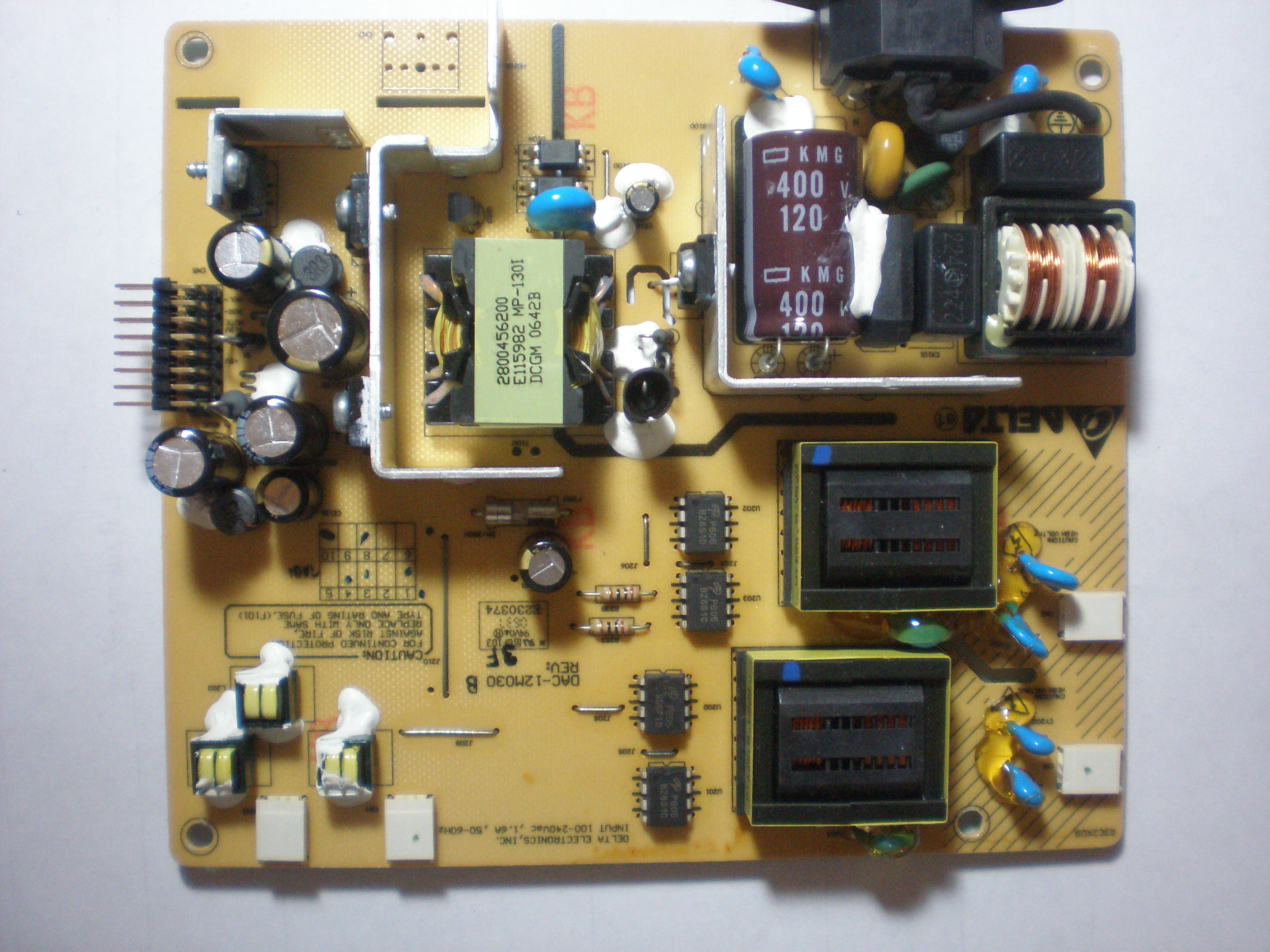

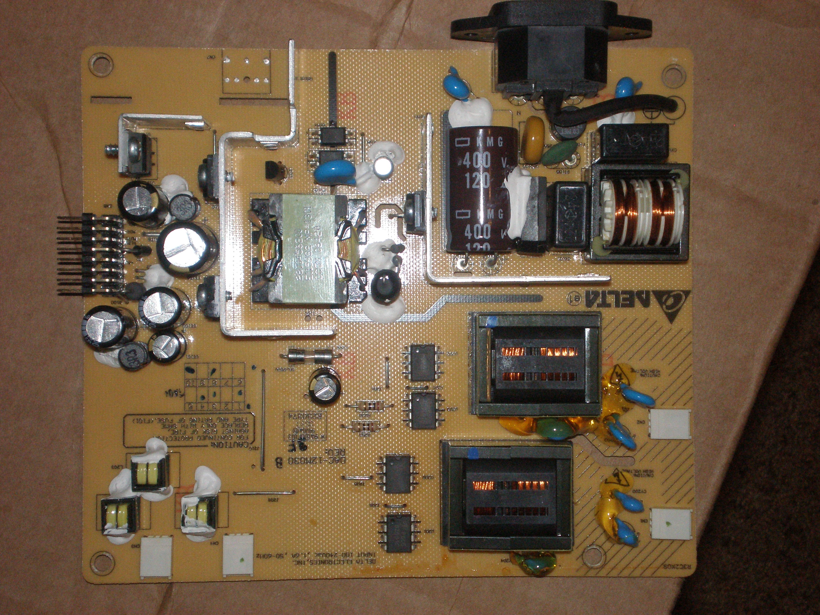

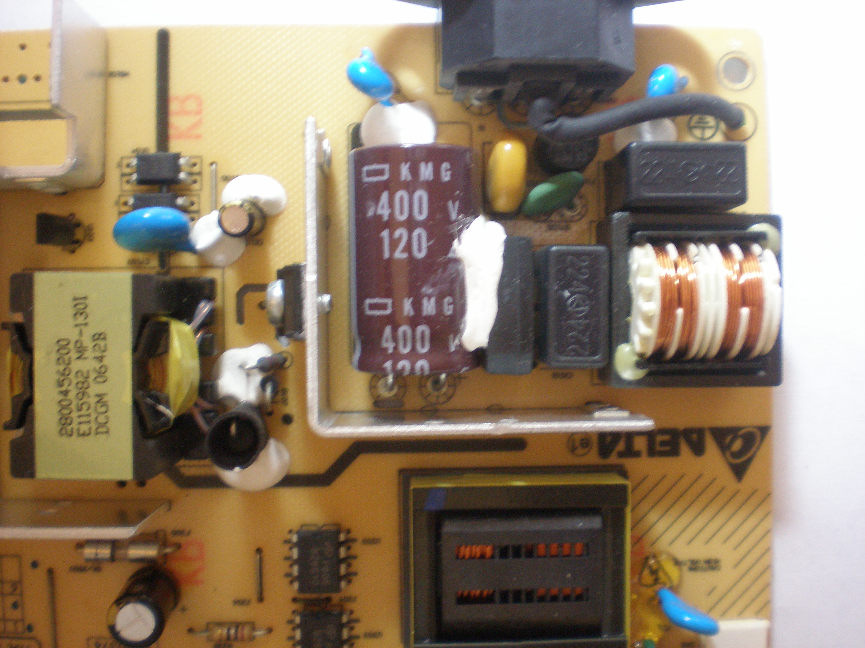

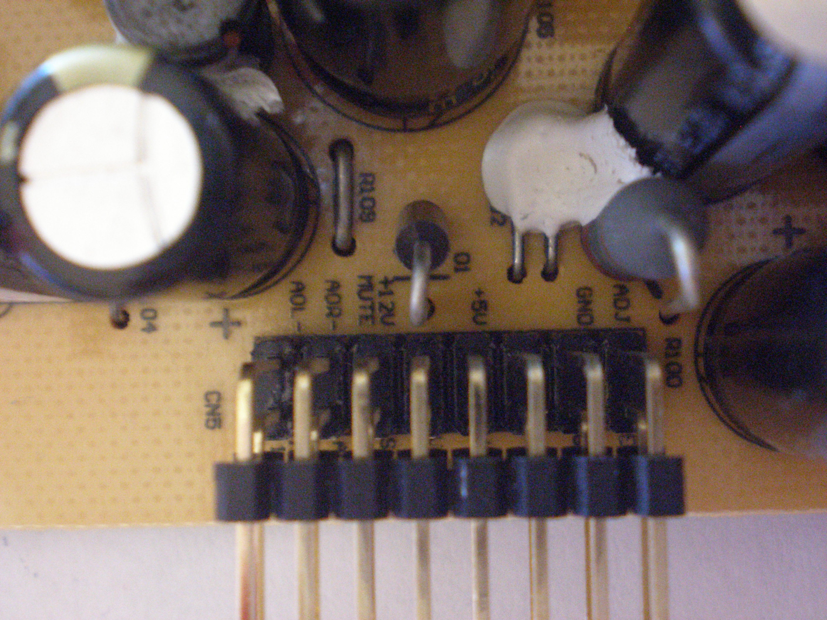

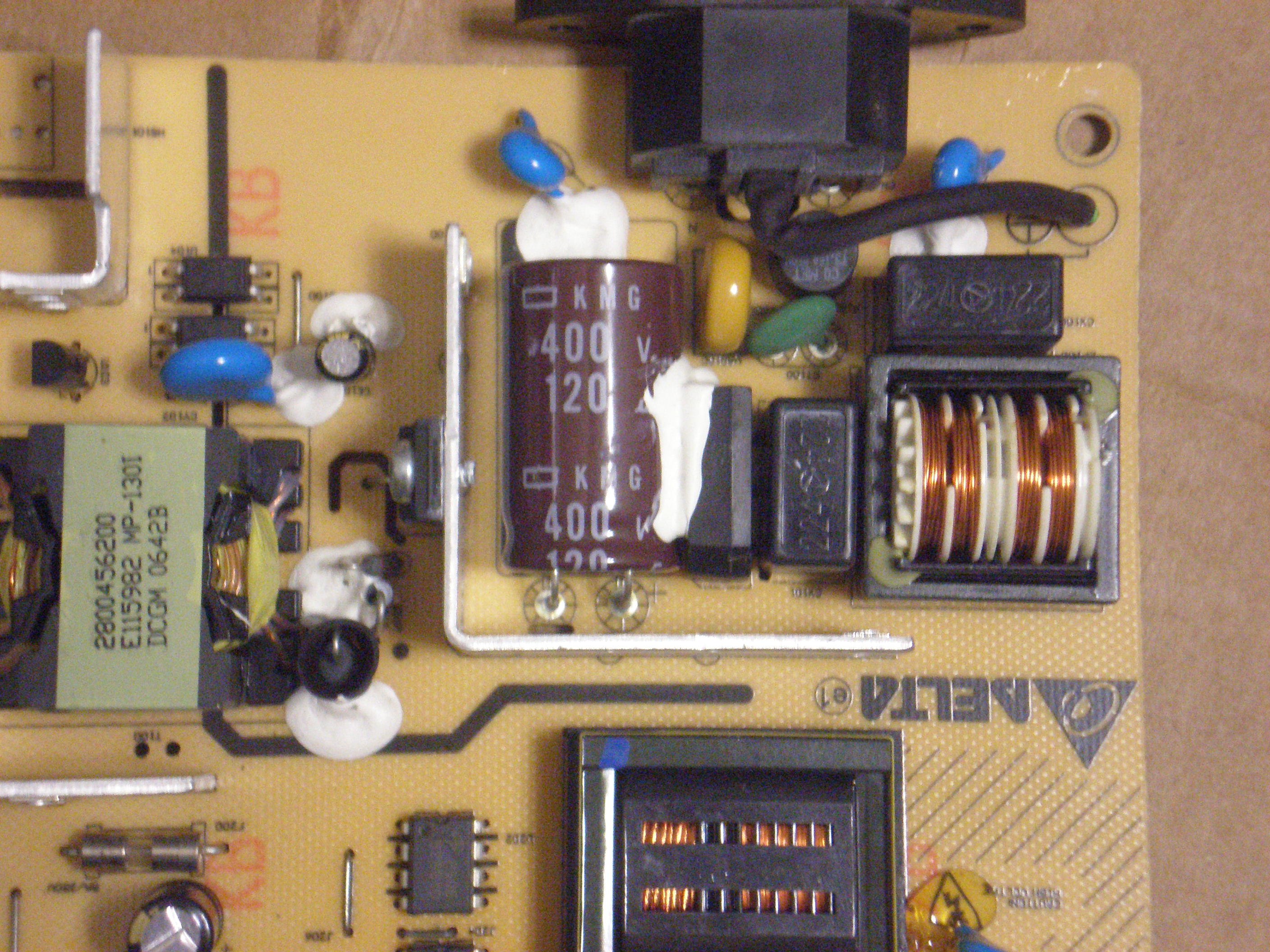

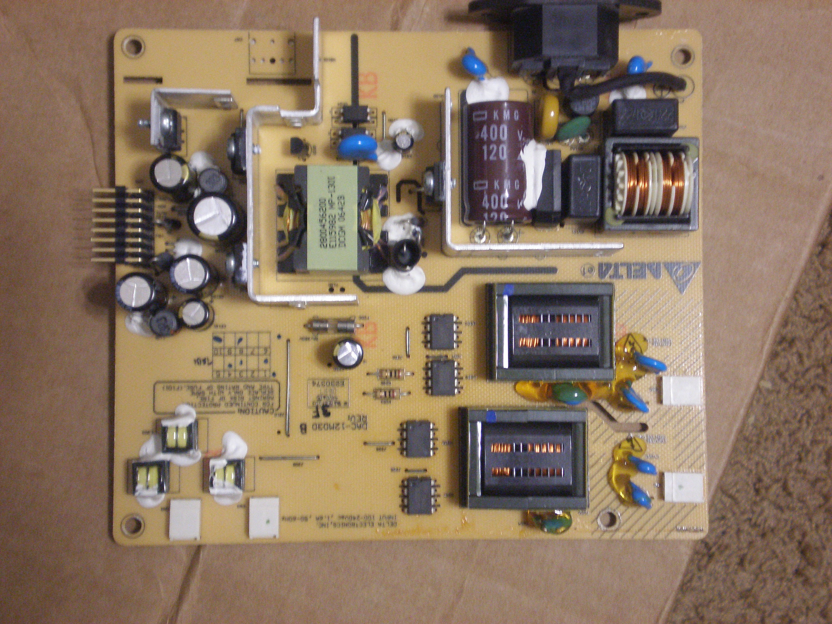

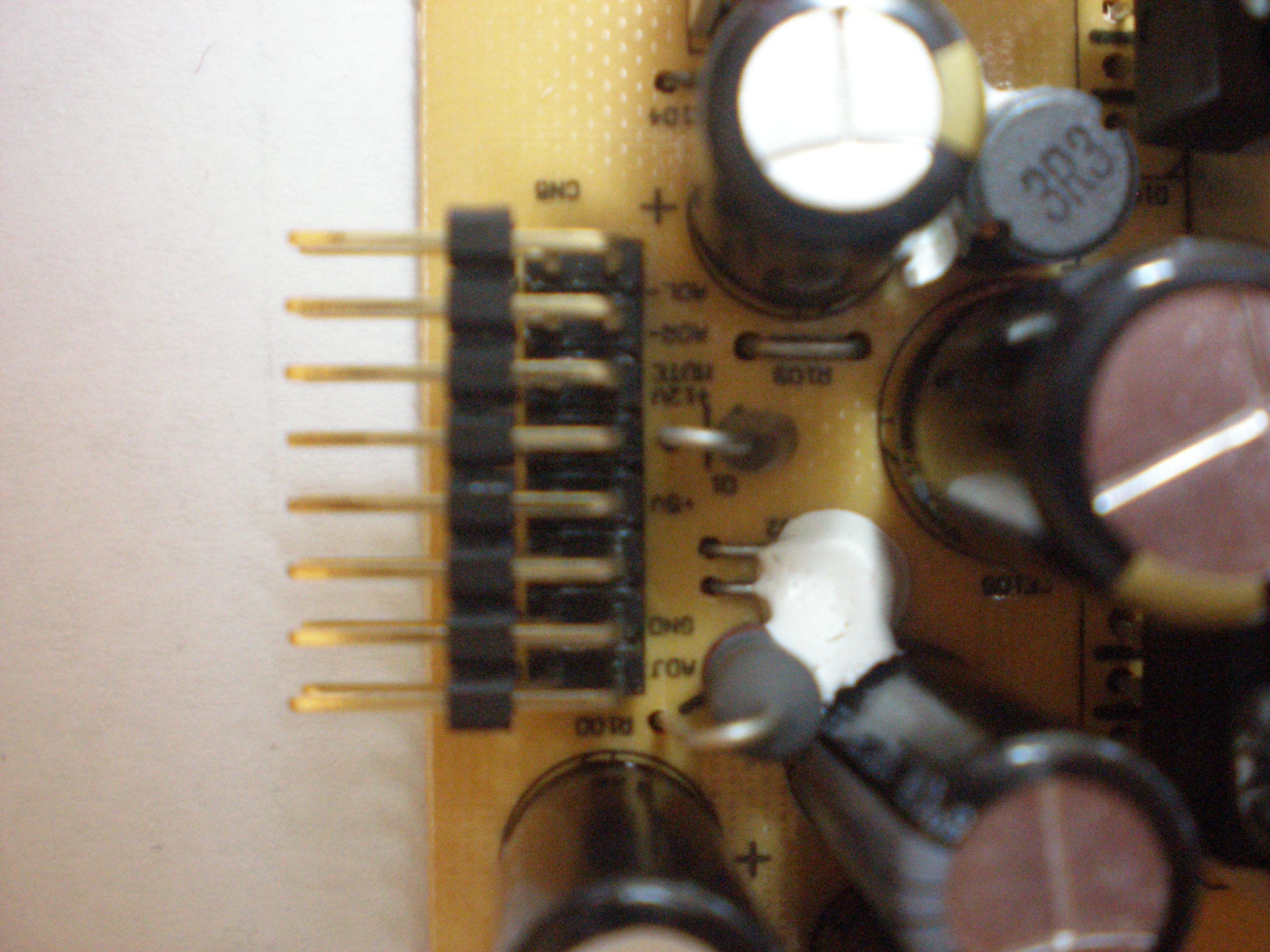

                    I edited my last post, so try disconnecting the main board from the power supply board next. Also take the straight shot picture of the power supply board for me, the one you posted is tilted, I need to give you the test points to check.

                      I am going to take some Macro pics of connectors and will be posting them shortly.
                        How do I do this? Wouldn't removing the main board prevent me from using the power button to turn it on? I don't quite follow there....

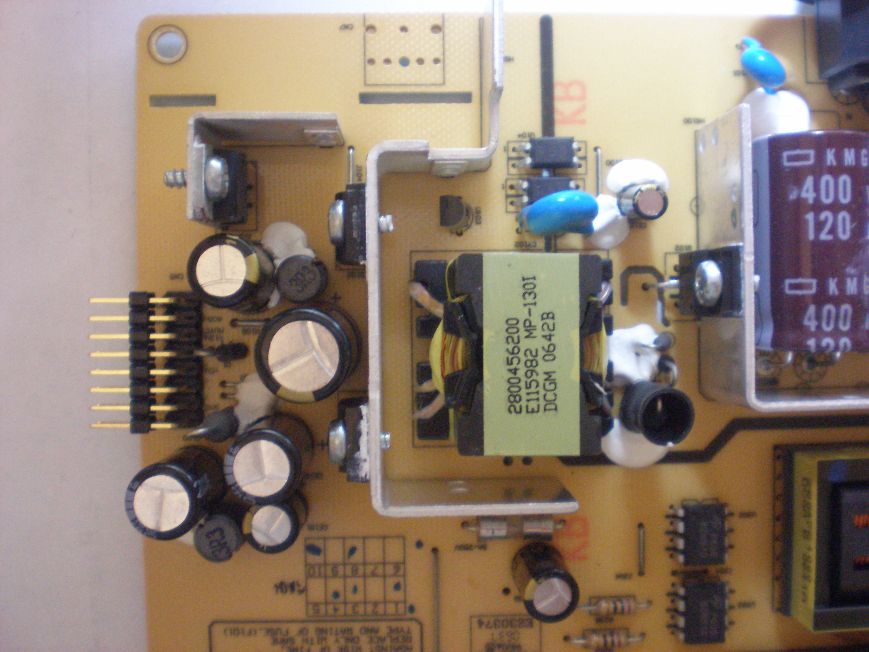

                          Okay, I've messed with several different lighting because my digital camera is old (2005) so yea...

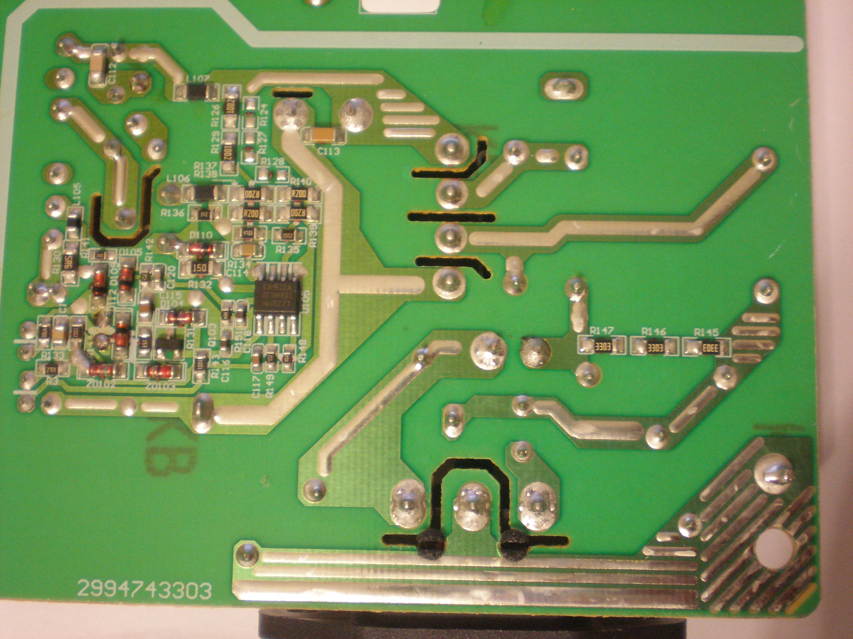

                              There are two legs on the fuse that are soldered to the copper pad on the circuit board, you need to un-solder one leg of the fuse so it will no longer attached to the copper pad.

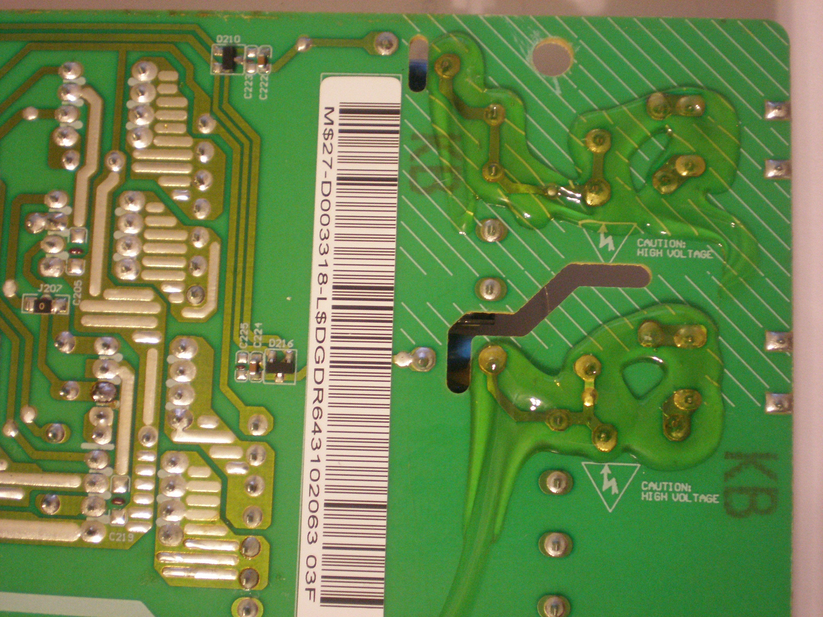

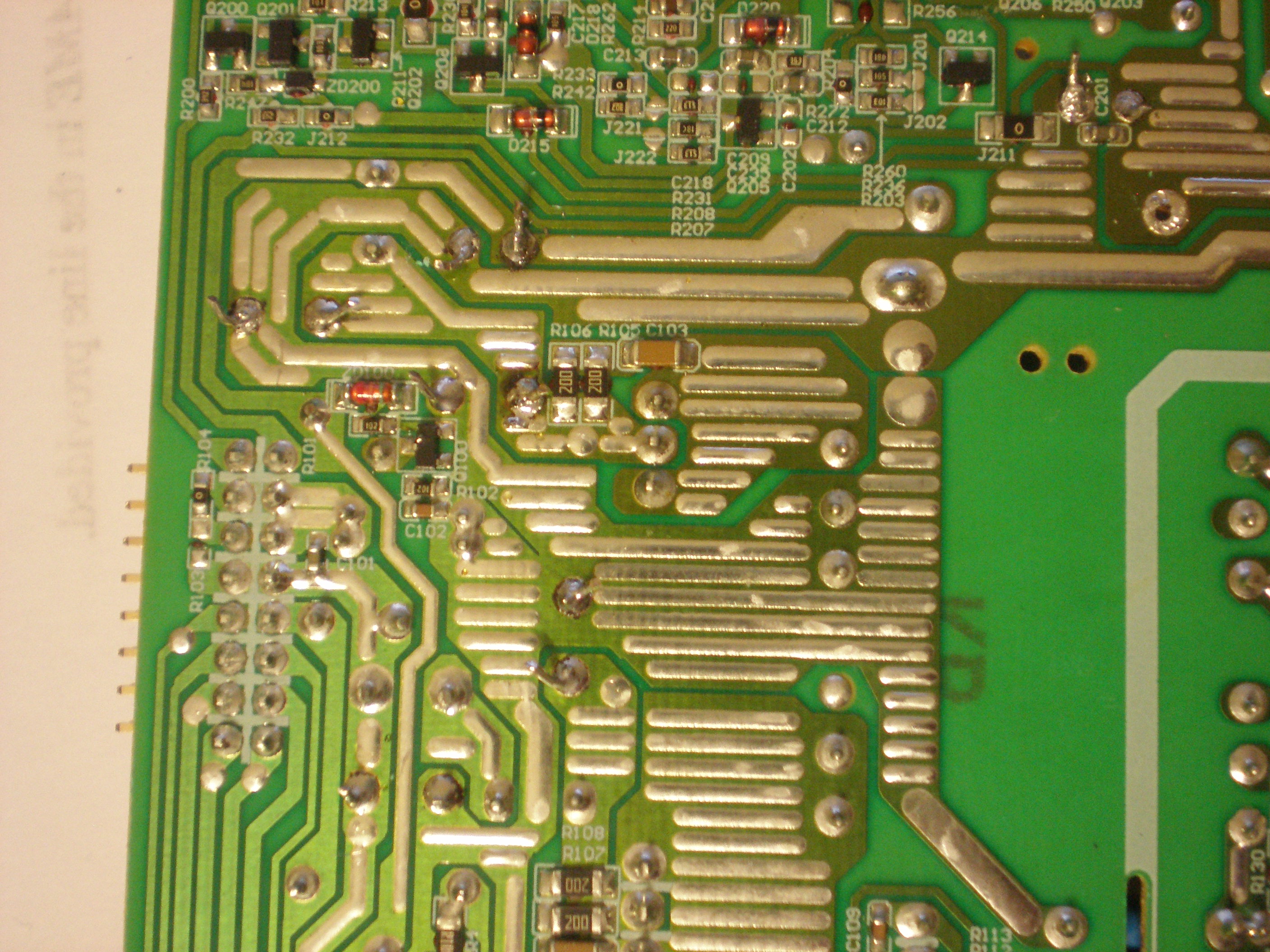

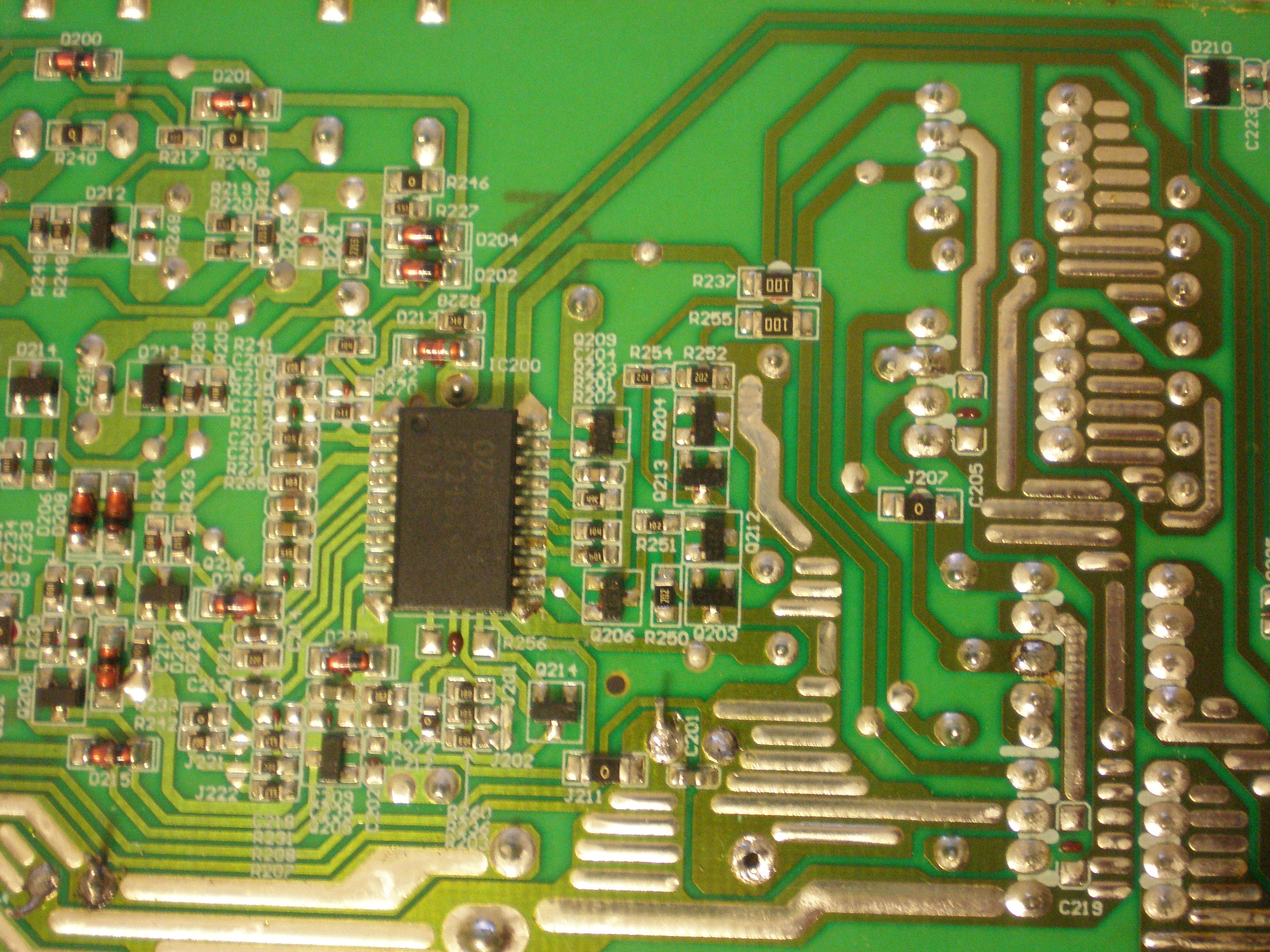

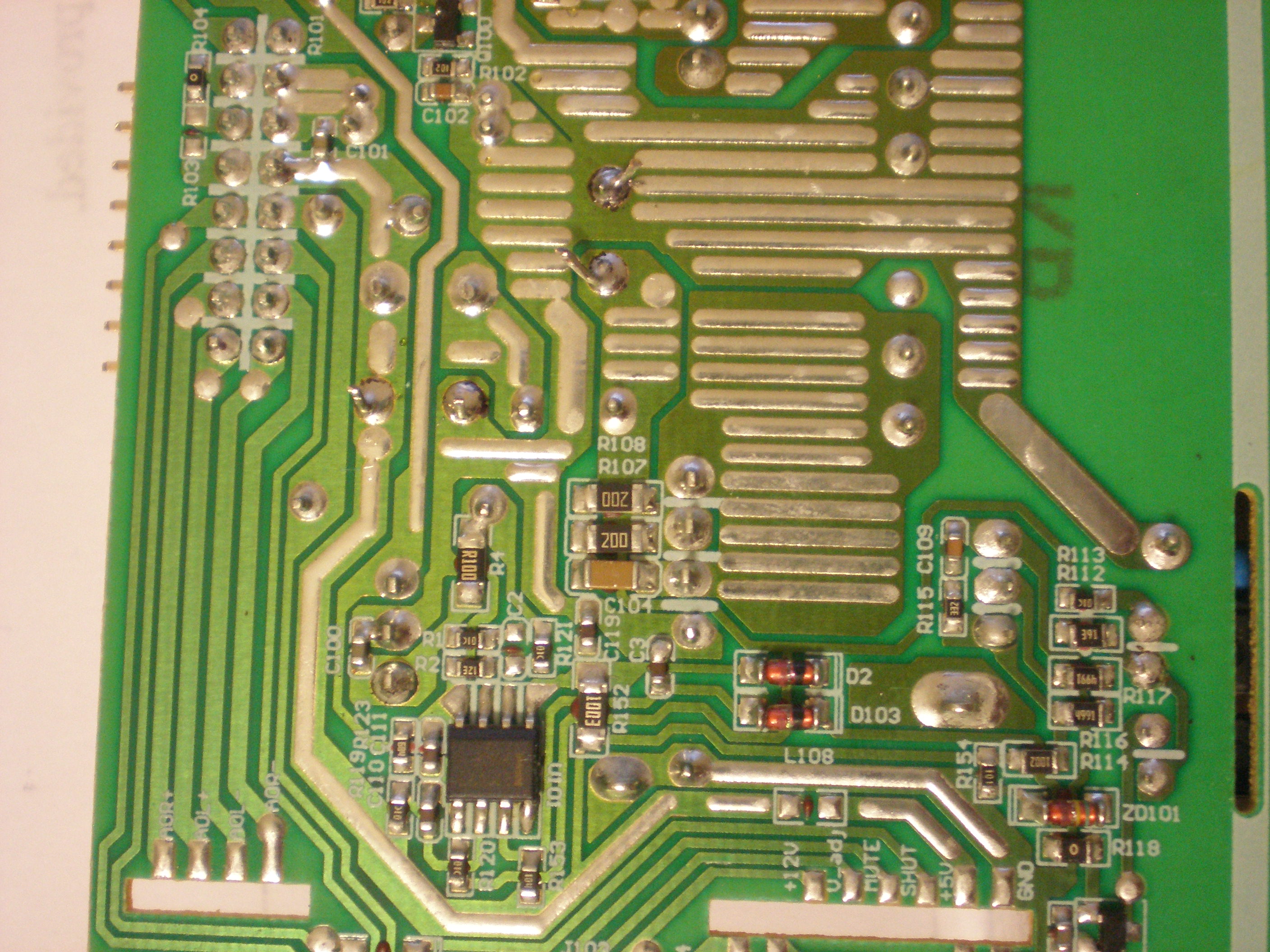

                              I need the pictures of bottom side of the board as well.
                              My Sony camera is almost 10 years old, but it takes real good MACRO closed up pictures.
                                  Here's the back board.
                                  Sony typically is better than olympus....lololol
                                          OK, that means the problem is in the inverter circuit that we isolate by lifitng the fuse. More likely to have the shorted out MOSFET which is very common problem as the other had suggested.
                                          So you need to take good resistance reading again using the pin out of the MOSFET spec and my drawing as the guide.
