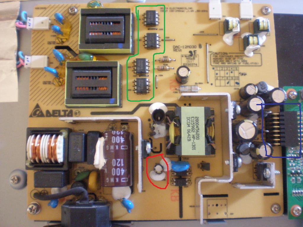

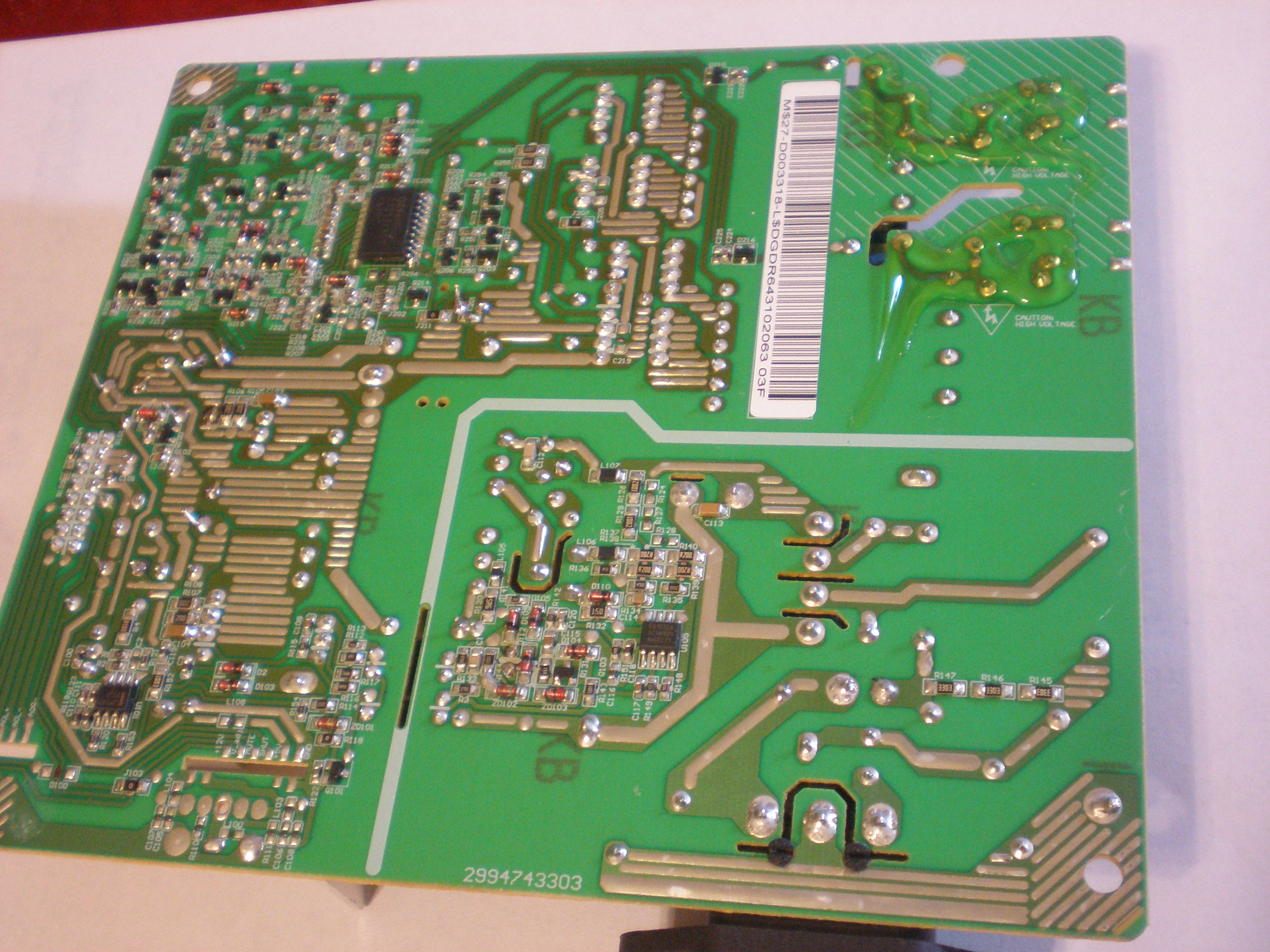

    So recently my Westinghouse 19" LCD went out (Model: 19w4) without any warning. Rather than throw it away, I decided to crack it open and see if I can revive it once again. After snooping around the internet for possible clauses and answer, the most apparent and easy to troubleshoot solution was to check the capacitors.
    So I cracked open the casing (Albeit, broke a few tabs > ) and viola! the powerboard (DAC-12M030) contained two bulged capacitors. So, I went ahead an ordered a repair kit that was offered by LCDalternatives on ebay and replaced all caps (7 of them). I was expecting everything to be fine, but alas, it was not.
    The LCD monitor did not even light up! Upon further analysis on the monitor with a flashlight shined into the panel, I do not even see images other than lines.
    With the power plugged in and the monitor on, all I can hear is sporadic ticking noise (kinda sounds like a laser beam from a sci-fi show) every time the monitor cycles. The power LED light just blinks and every blink yields the ticking noise.
    I honestly do not know what else could be wrong. All "proposed" caps were replaced and I still cannot get a picture or even light.
    Help!!

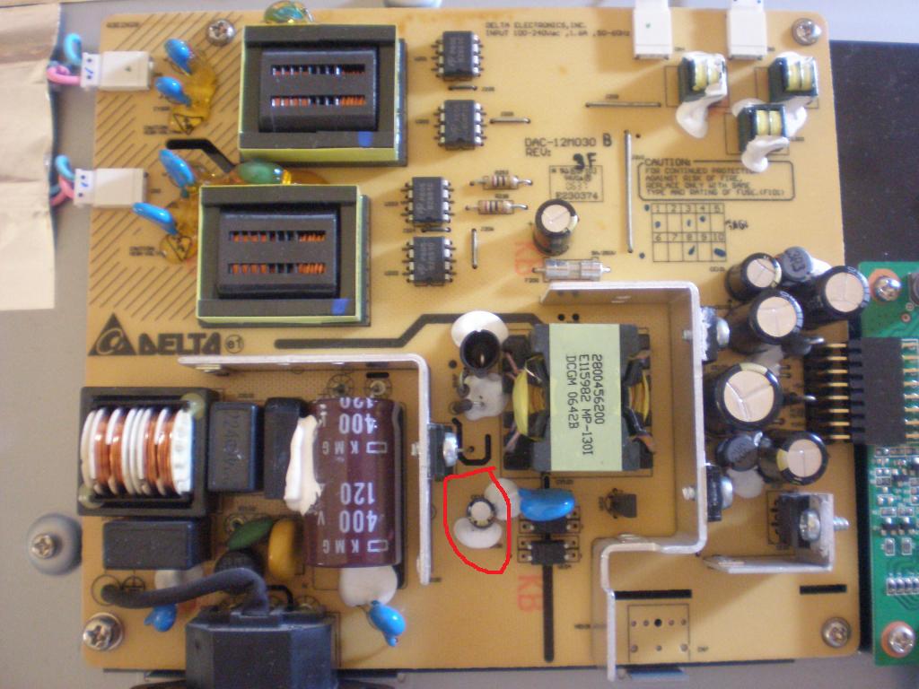

    Picture below:
    All replaced caps can be identified by the "curved T" shaped top compared to the "crosshair" shaped top.
    I will try to get pictures of the back soon.

      Before you do anything else
      Did the small cap i have ringed on the picture come in the kit as it looks to have not been changed ?
      If not then try replacing it first ,it has most likely dried out as well
        Re: WestingHouse 19" 19w4 LCD monitor- DAC-12M030
        If that cap,as pointed out by Sabre is Ok, then theother very common fault on these DAC boards is usually a pair of the AP605 Mosfet drivers(in front of the Inverter Transformers) which regularly fail
          Yes, that one was replaced as well.

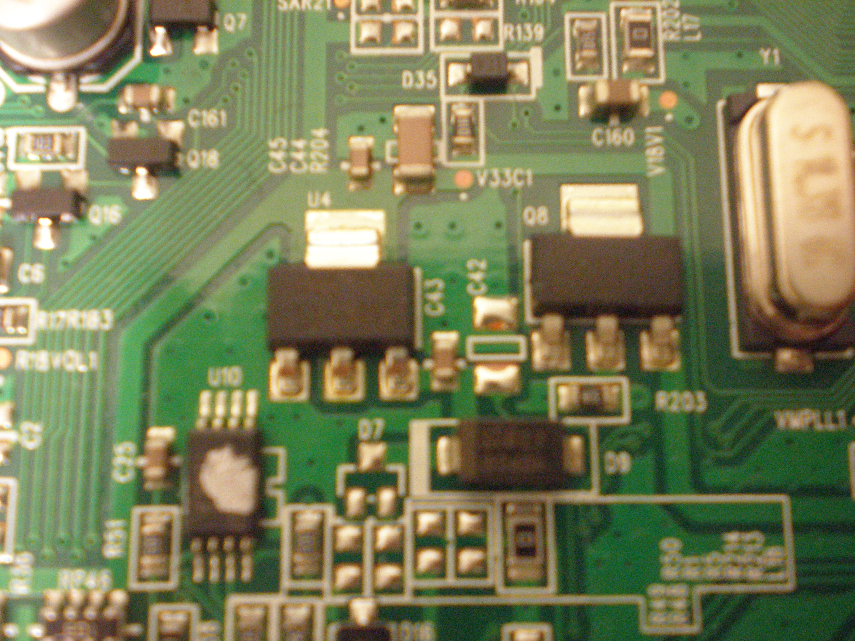

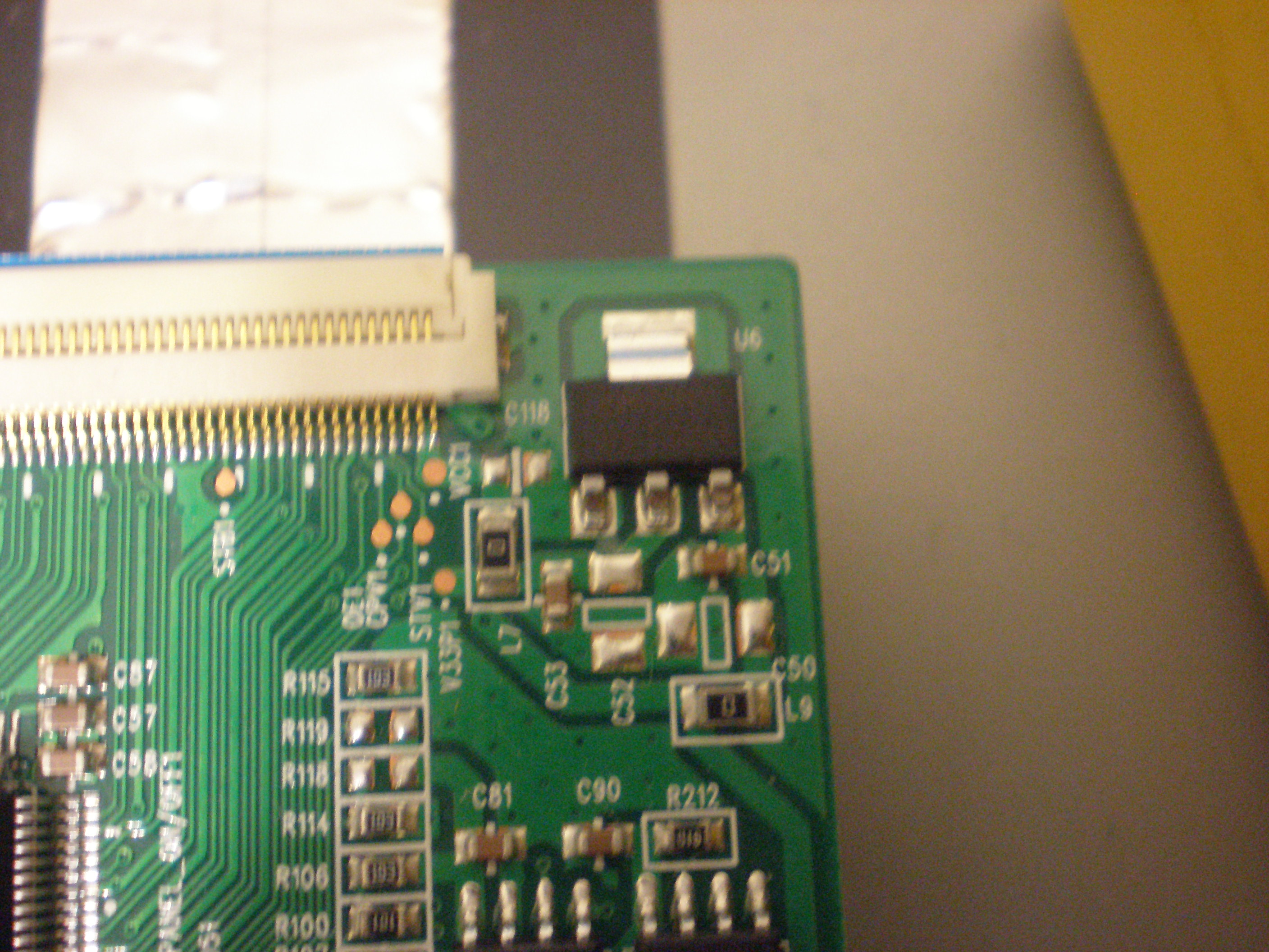

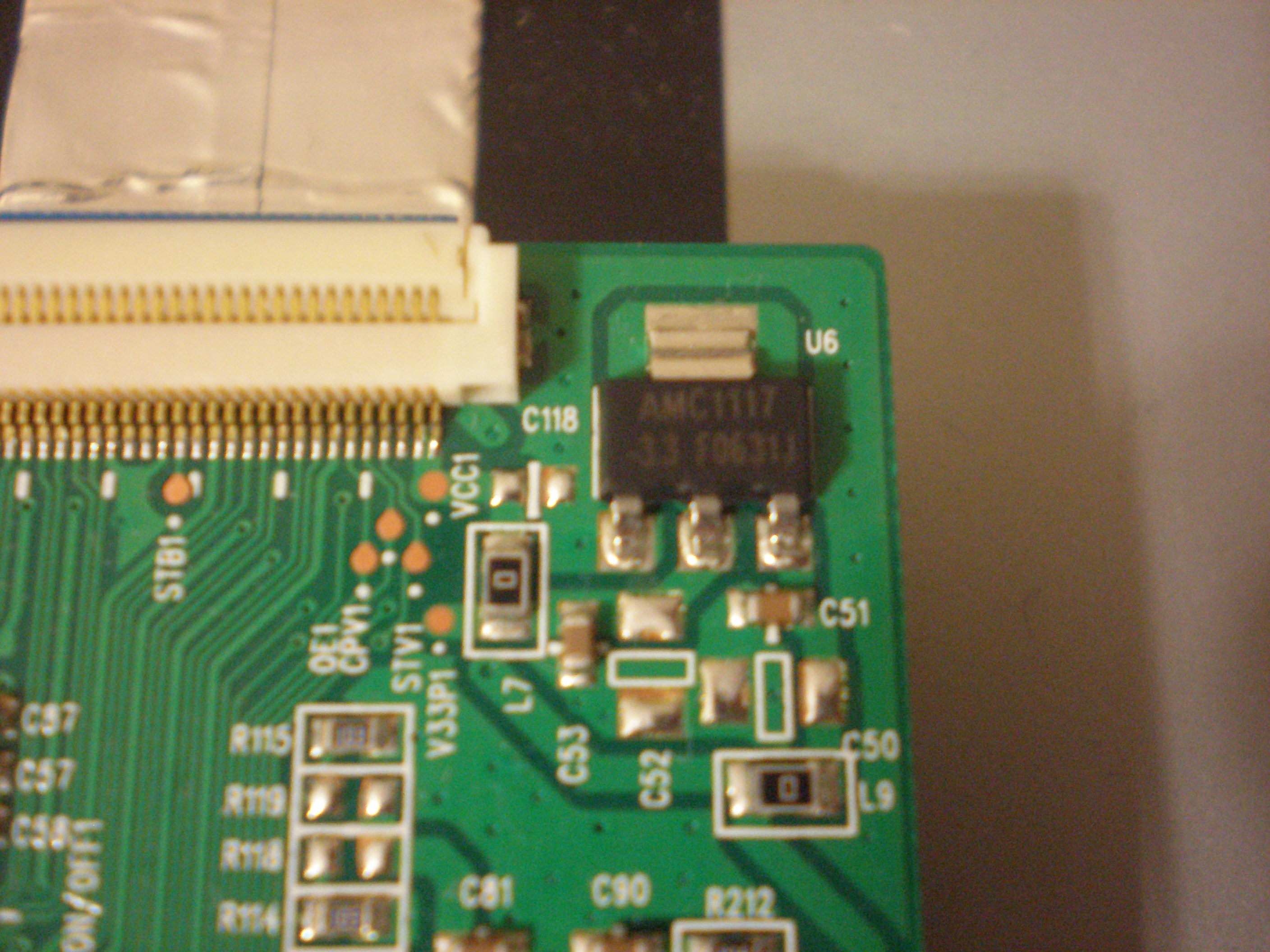

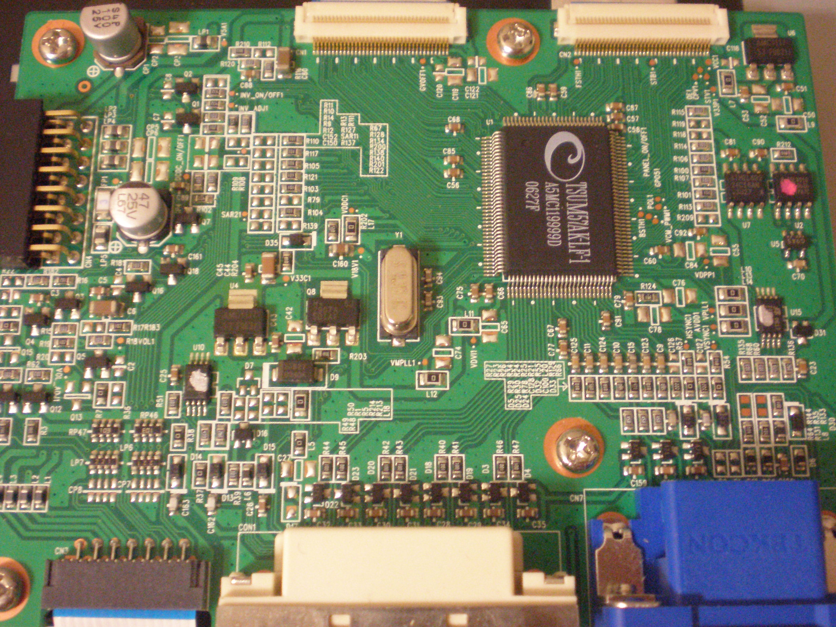

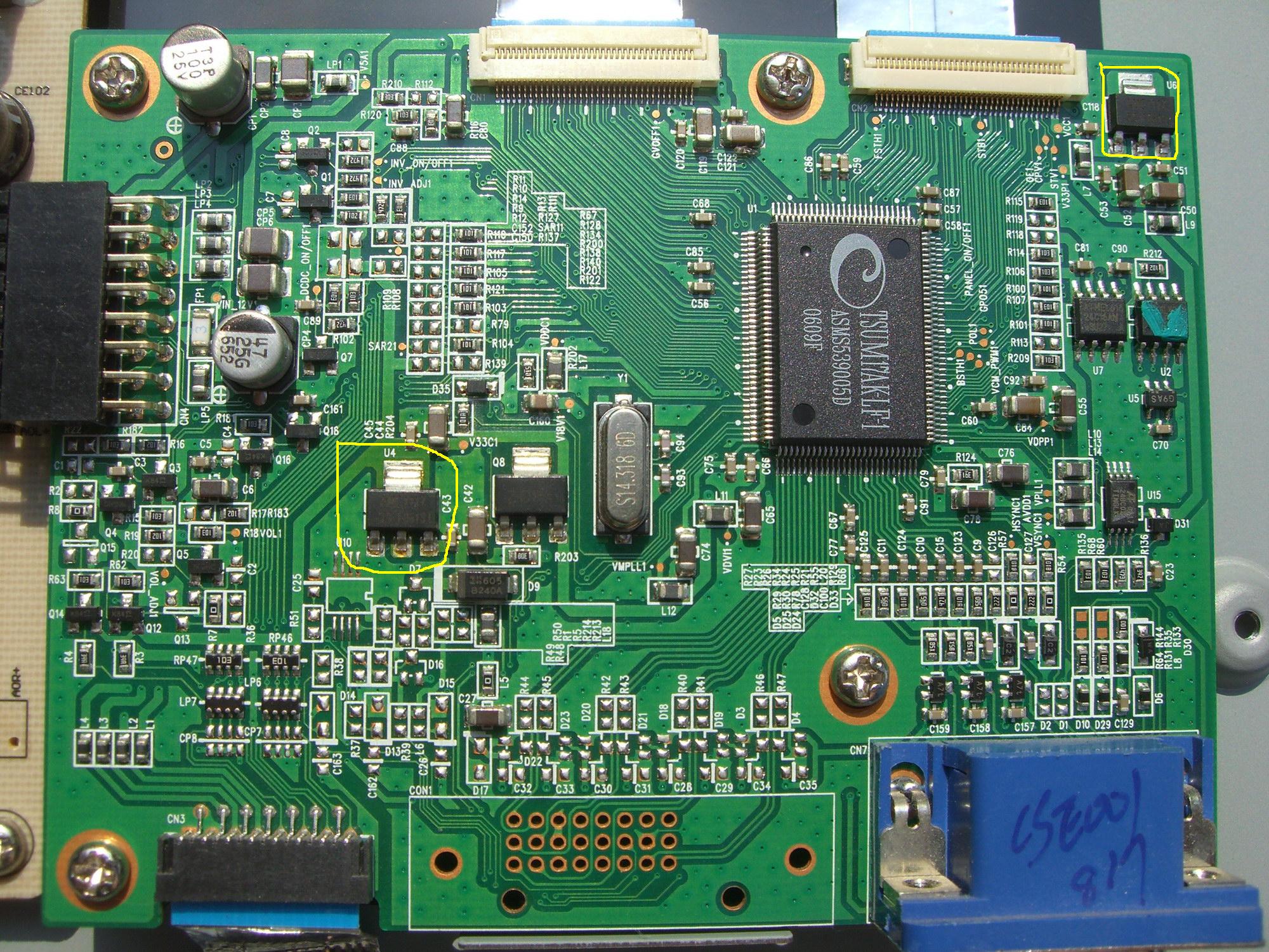

                Daft as this may sound this problem can also be caused by a voltage regulator on the video board (notes from an Acer i worked on before same board setup)
                Worth a check if mosfets check out ok

                  That is suggesting that the image or picture is still visible without the backlight. Mine does not show any pictures or backlight. I'm assuming it can be attributed to not necessarily to have an image?
                  I'll attempt to run the diagnostic per instruction and report back. Would you be able to point out exactly which mosfet I should be testing?
                  ^ that chip, is that user replaceable? how do I test if it's viable?

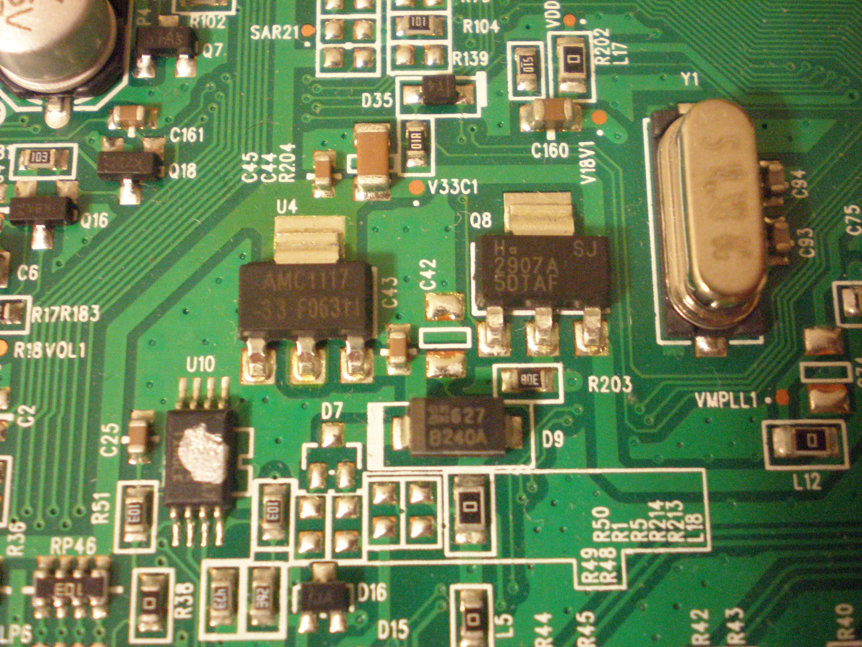

                    Okay, so I've tested the voltage on those two chips respectively, albeit, blindly because I have no clue of the value lol.

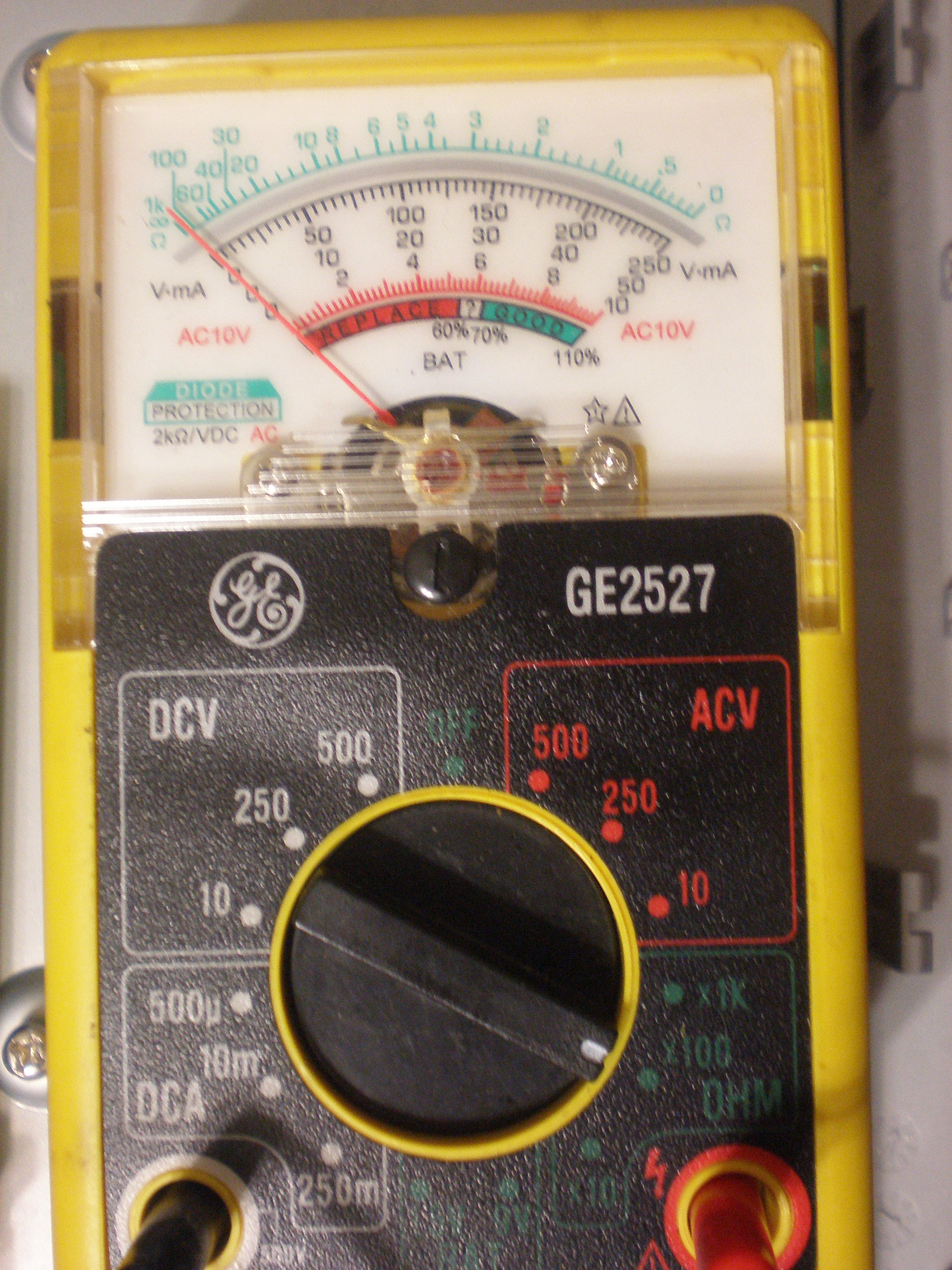

                    The multimeter I am using is GE Model 2527 and I've included a picture of it (for value referencing).
                    The image that has two of the chips in the pic has this value (should be picture one) from the one you have circled, sabre, the values are from left to right --> 2.8 / .7 / 6
                    The image that has one chip, values are, from left to right : ---> 4.5 / .65 / 6
                    Each of the numbers represent each pin (3 pin per chip) with the wide pin as constant.
                    These values are read from the multimeter at the very top (the green numbers). Multimeter were set to X100 OHM, since the options were X10, X100 and X1K.
                    I'll be honest, I have no idea what those numbers above mean since everyone is saying above 30 OHM is good and those numbers do not represent what is being said, unless I'm reading my multimeter COMPLETELY wrong.....ollol

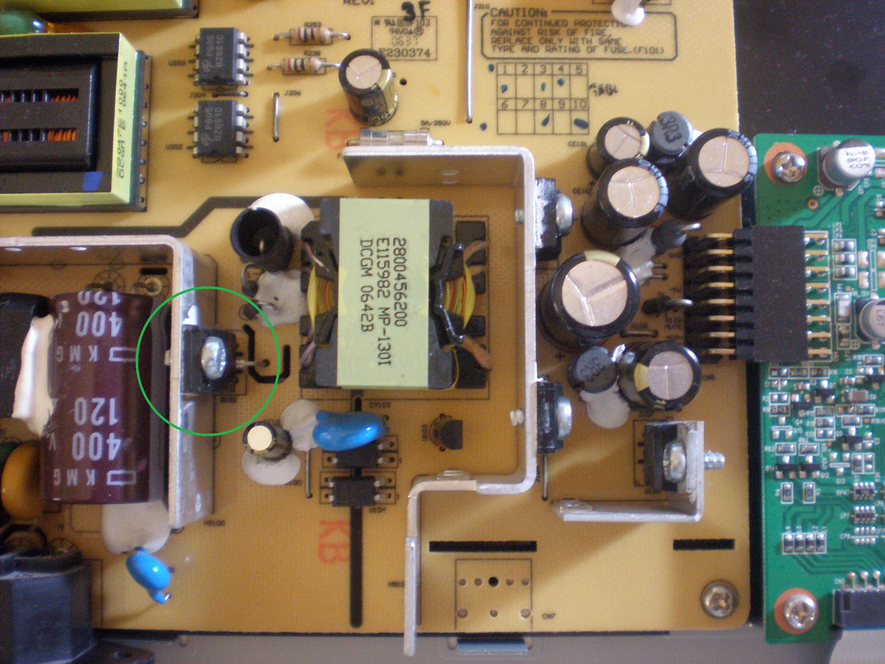

                      Ok, using the same multimeter and following the instruction per (https://www.badcaps.net/forum/showthread.php?t=10419) post # 19, this is what I did.
                      The attached image with the green circle is what I believe to be the mosfet I should be testing (I think? )
                      Okay, so looking at the picture this was how I set up the measurements.
                      1. Black pin was on the bottom and red was in the middle and the value was --> 22.5
                      2. Black pin on the bottom and red on the top, value was --> 8.5
                      3. Black pin in the middle and red pin on the top and the value was --> no reading
                      The multimeter was set to X100 as I do not have 200. Once again, those value no definition in my vocabulary bank.

                          Can you take the photo of power board's other side? since there are 2 s1 and d1 so it is a dual mosfet. So you should test both. Did you measure second side voltages good ?

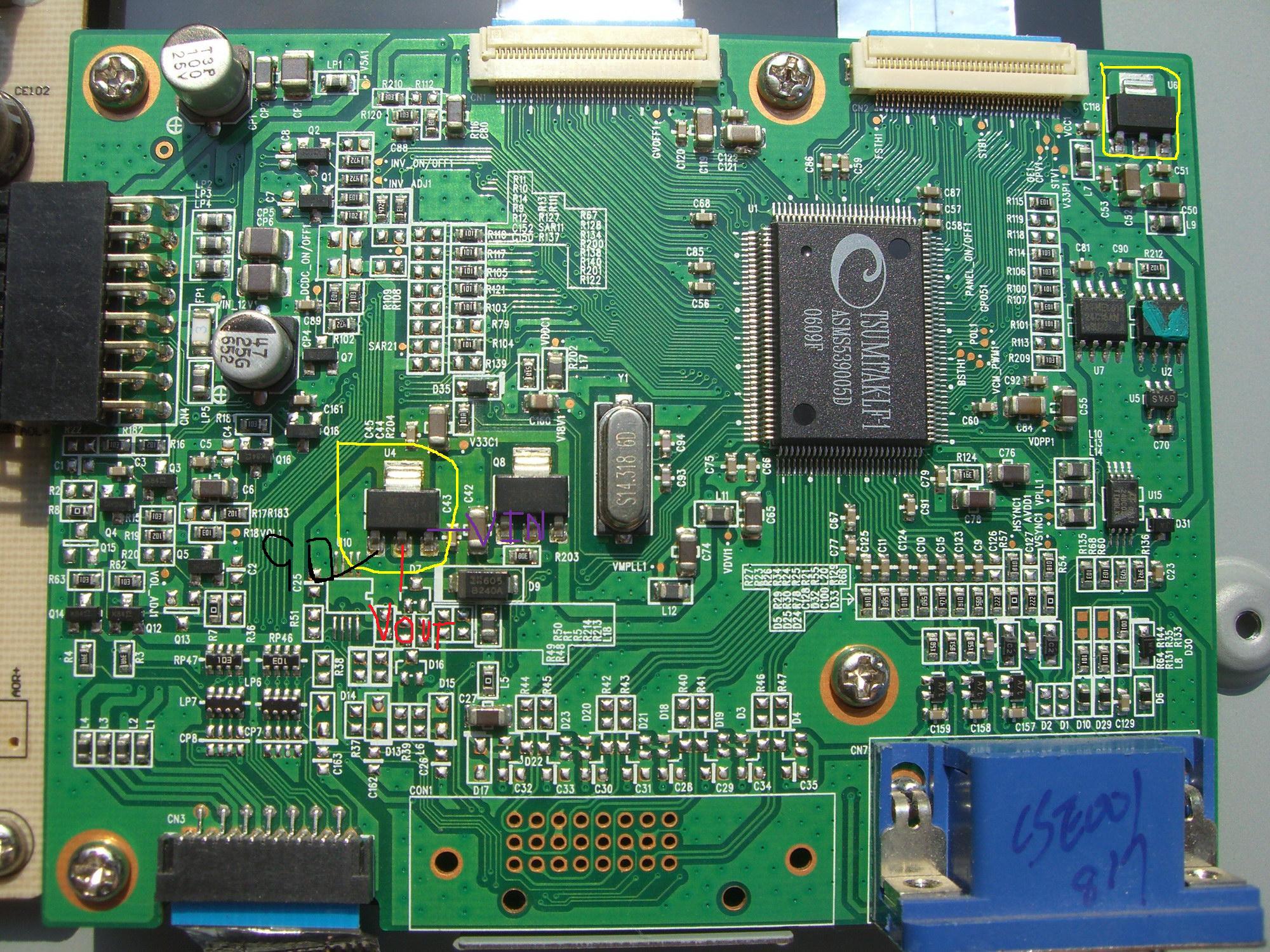

                            Ok try this first
                            Caps you have already done assuming they are back in the right way round we can leave them alone for now .
                            Mosfets that need testing are circled in green .
                            Also check secondary output voltages ,circled in blue voltages should be marked on board .
                            Take a picture of your video board and post it , also the numbers that are stamped on the regulators post those too
                            Regulators should be tested with your meter set to dc mode 10v
                            Black probe on ground pin (See pic) Check Voltage in (purple ) Voltage out (Red) with red probe

                                  Okay, here is what I've done so far.
                                  I've compiled all of my readings into a word doc and have attached it. There's two images within the file for referencing. The numbers in the document refers the to green labeled numbers on the meter.
                                  I cannot measure the video board chips that Sabre circled because it did not give me anything when measured with DCV 10 setting (like the needle didn't even move) (Awaiting further instructions) not sure if the system power had to be on to measure or not. Also, i did not measure the secondary because I did not know how..... :/

                                    On each of them,The 2 pins for D1 are in fact connected to the 2 pins for D2,ie they are shorted together ?????? at a quick look # 2 is wrong,and faulty.

                                      That's a great question, I really do not know. #2 definitely look odd when I did the readings. So a good chance that has to be replaced. What are the values I should be looking at?
                                      For reference, I am attaching the "Manufacturers MSDS" of the mosfet.
                                      1-4 all have varying values. #2 is definitely faulty as the S1's all read .6
