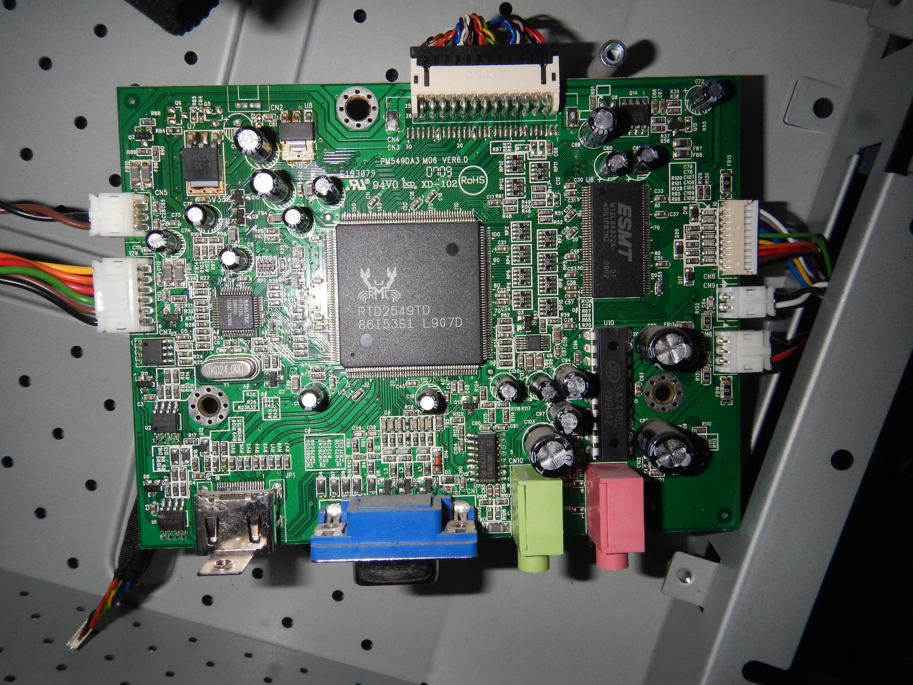

    My HG281D flickers on startup and, although there are numerous posts on the subject here, I am having trouble identifying my main board revision so I can buy a cap kit for it.
    Could someone help me identify which cap kit I need to purchase to fix my monitor?
    Re: Hanns G HG281D 28 inch display flickering on startup
    For the main board: C80, C83: 100UF 16V Low ESR type 105C.
    https://www.badcaps.net/forum/showth...ghlight=HG281D
      Thank you sir, I'll give it a go
          Caps are in and all seems well.
          You guys just saved me a couple hundred bucks. Thanks!
              @shelet, thanks for the repair feedback. You should get the set of caps for the power supply also.
                  For the main board i changed: C80, C83: 100UF 16V Low ESR type 105C.
                  With 470uF 25V, with some Chinese Caps... Running perfectly fine now.
                  I had vertical weak lines, flickering, blackout... black or dark content would run better/longer than white..
                  The two 1000uF 25V on the powerboard and the regulator were hot when disassembling the HG281D.. Did nothing with that ... Would that be a problem later?
                  Thanks a lot for this forum .. Saved me a 28" secondary monitor :-)
