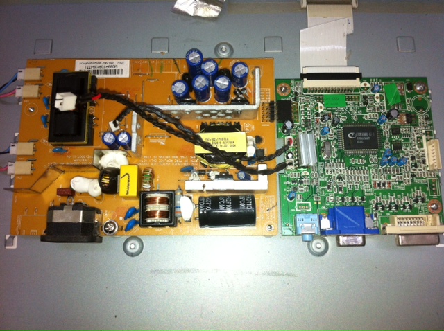

      Re: proview pv190wlcm
      her it is

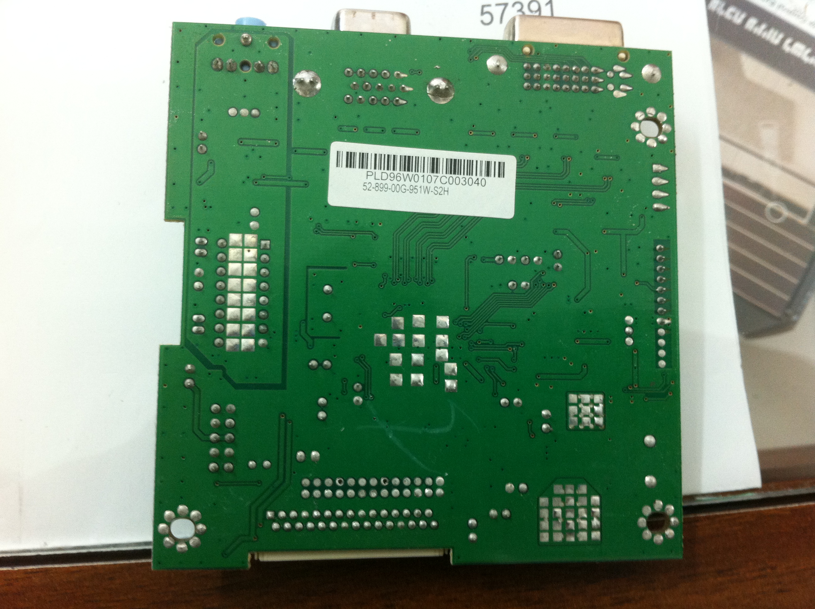

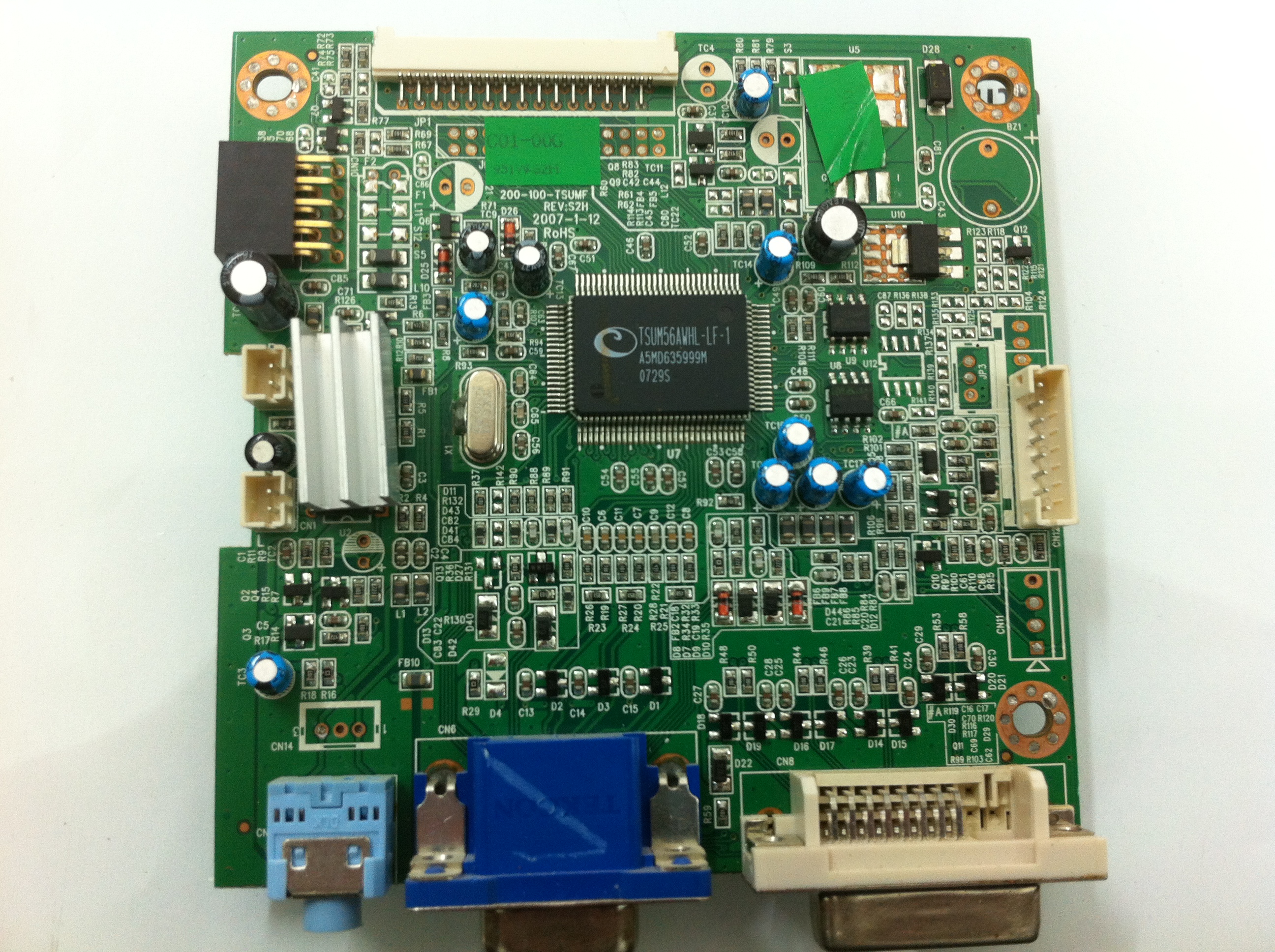

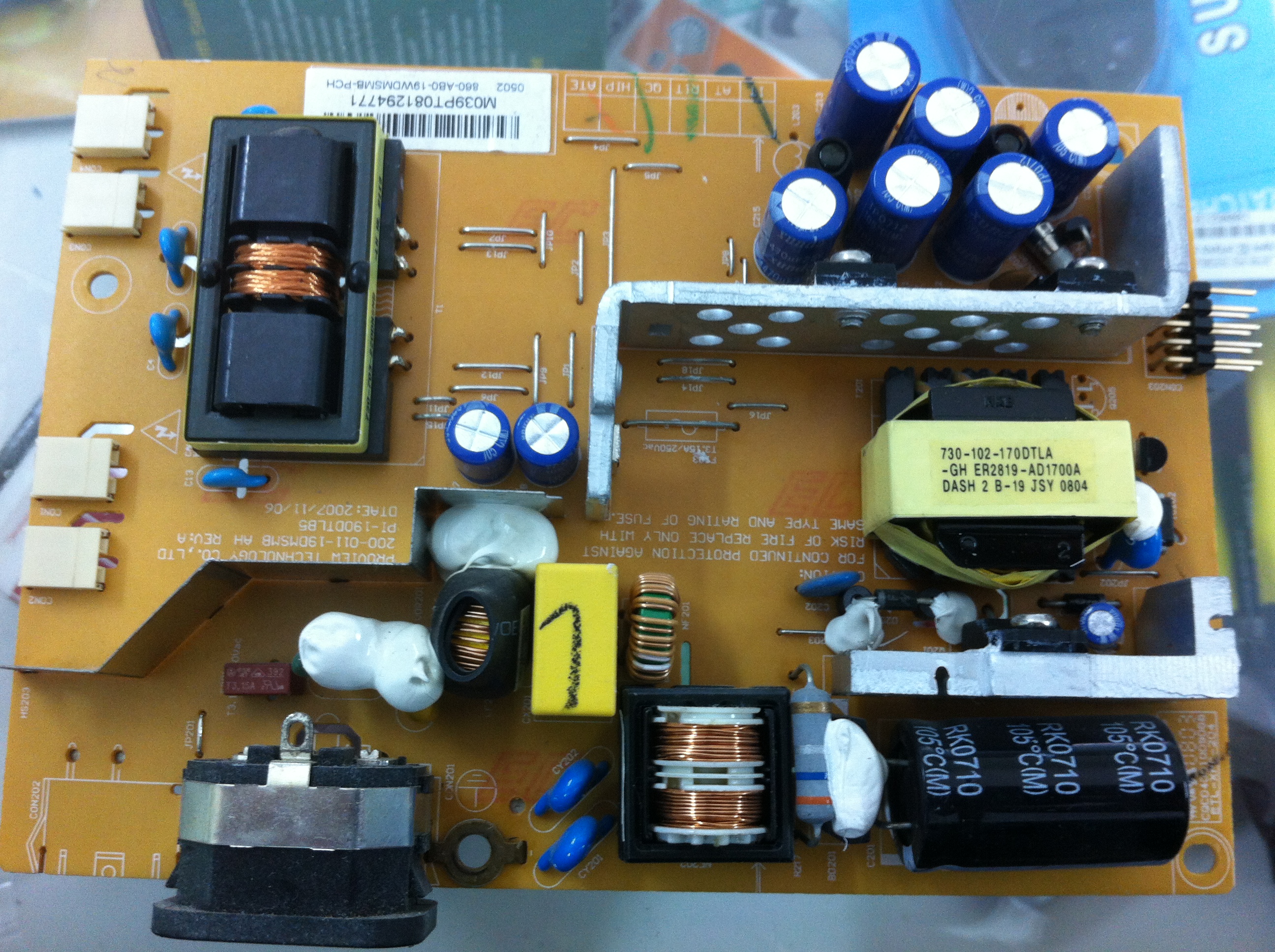

          OK - Need bigger pictures of each board front and back and also the one attached to the panel.
          While you do that try taking off the LVDS cable (from the main( green) board to the panel clean and replace.

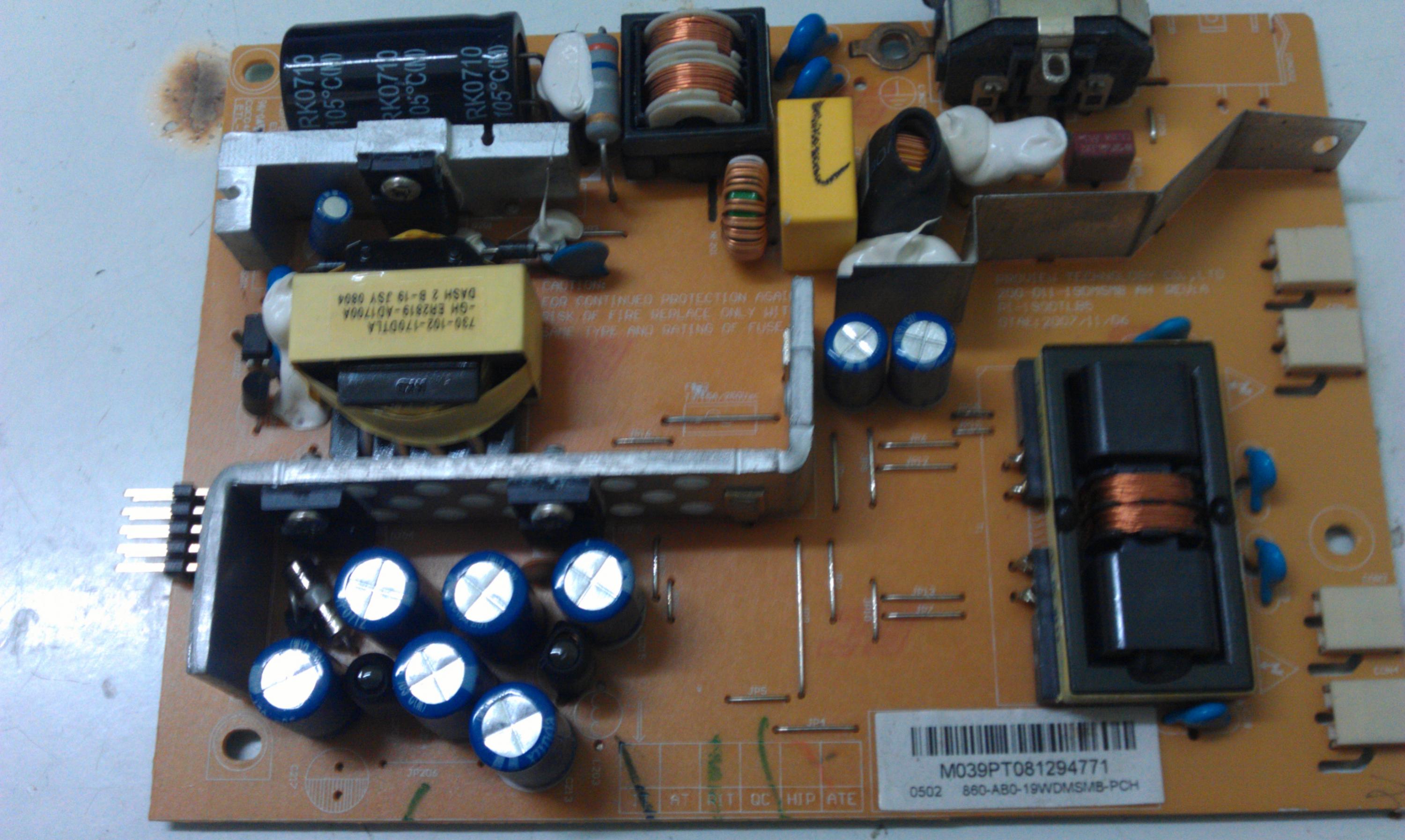

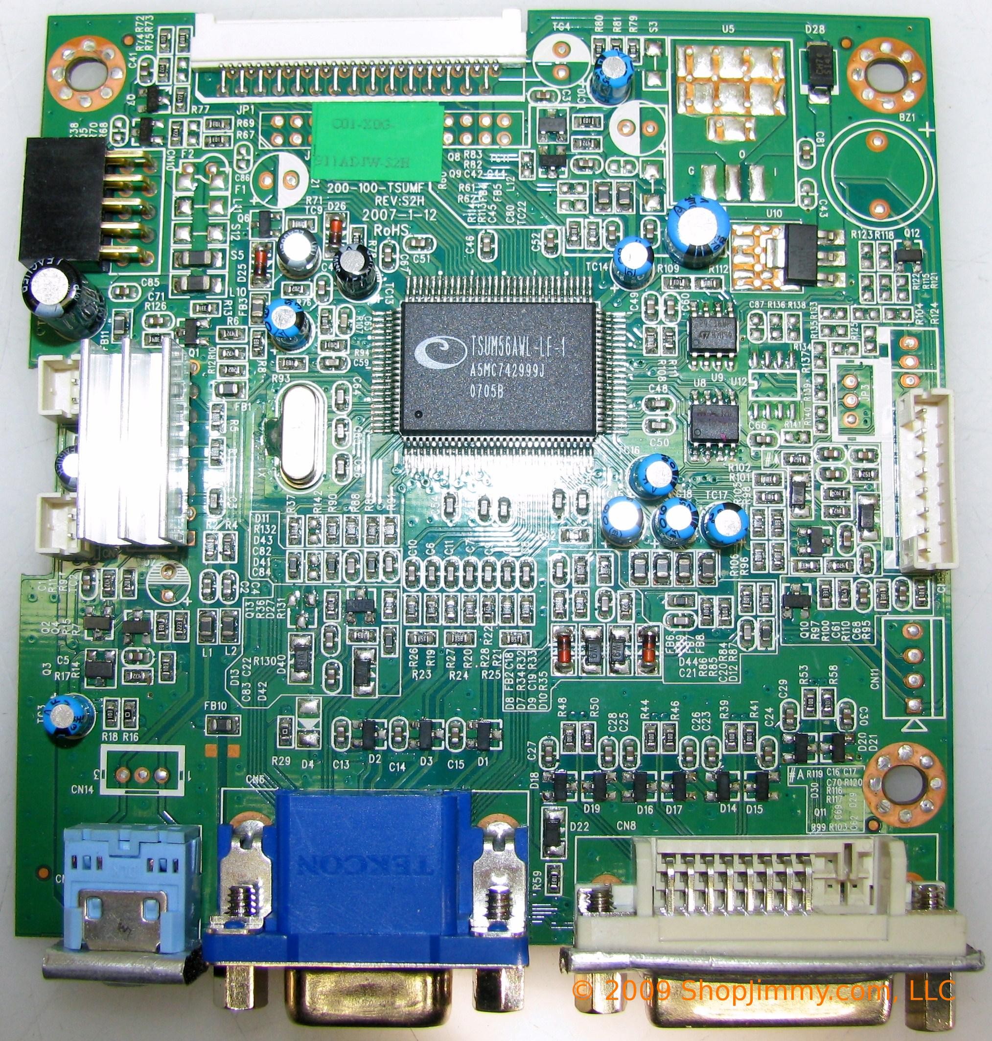

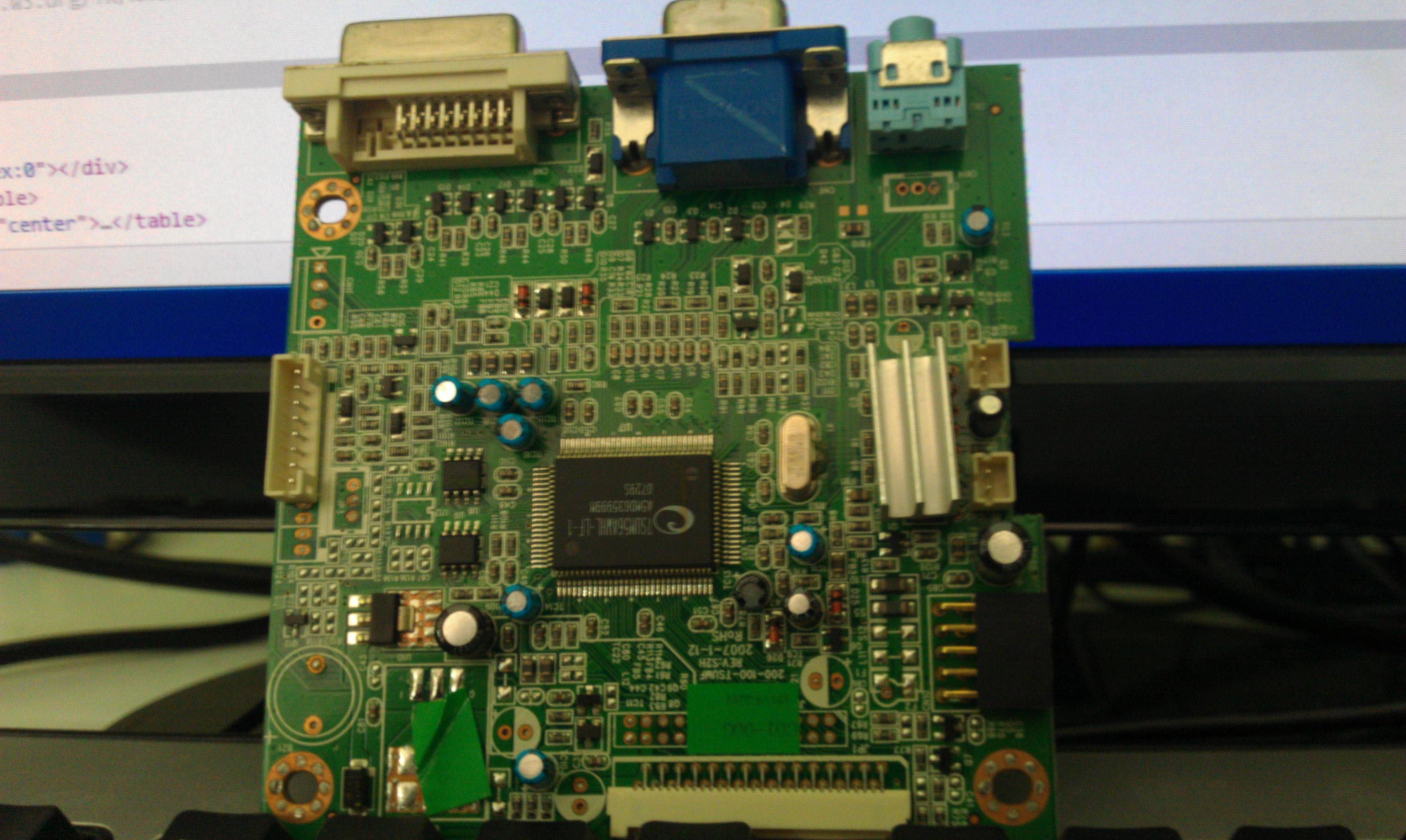

            here are the pictures

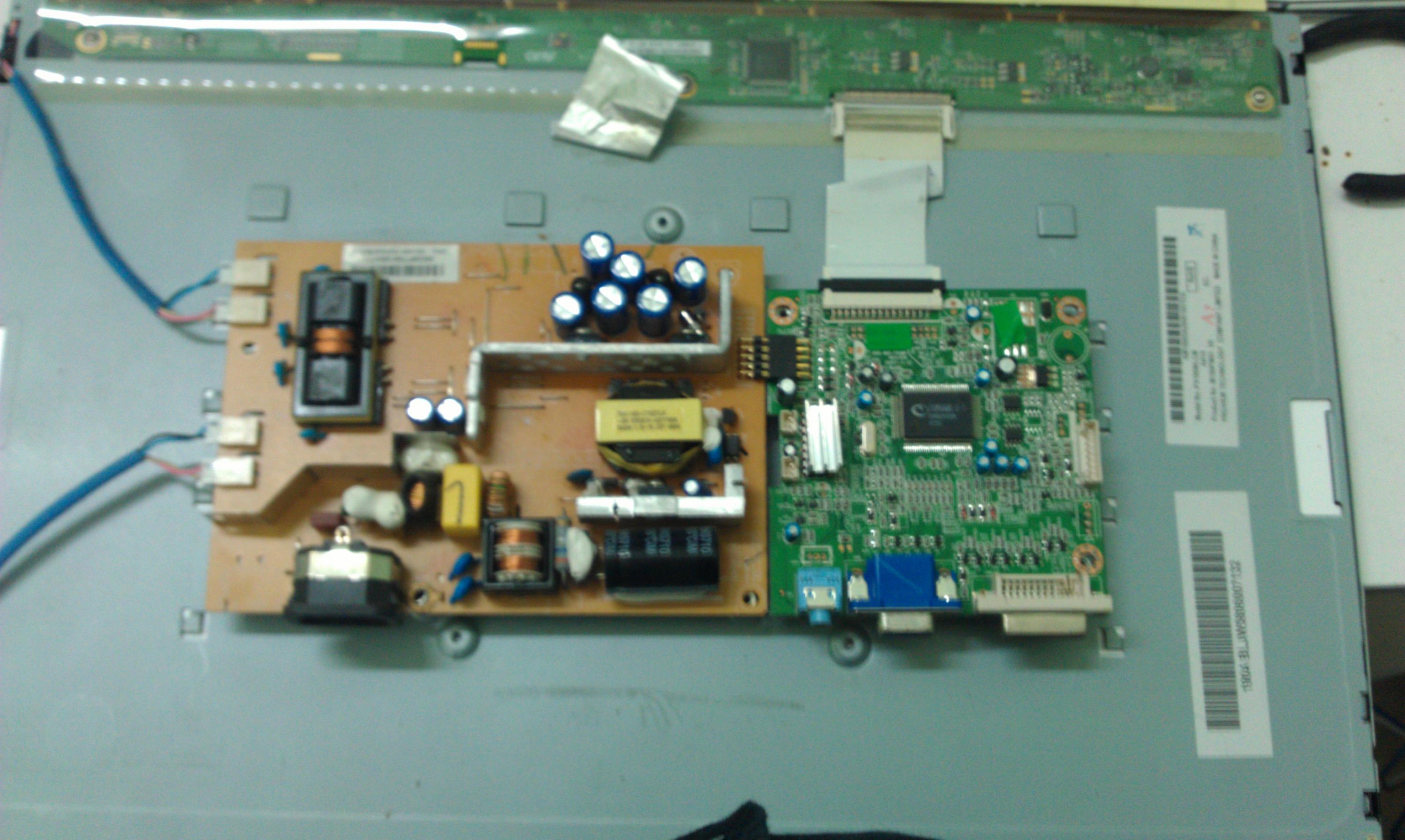

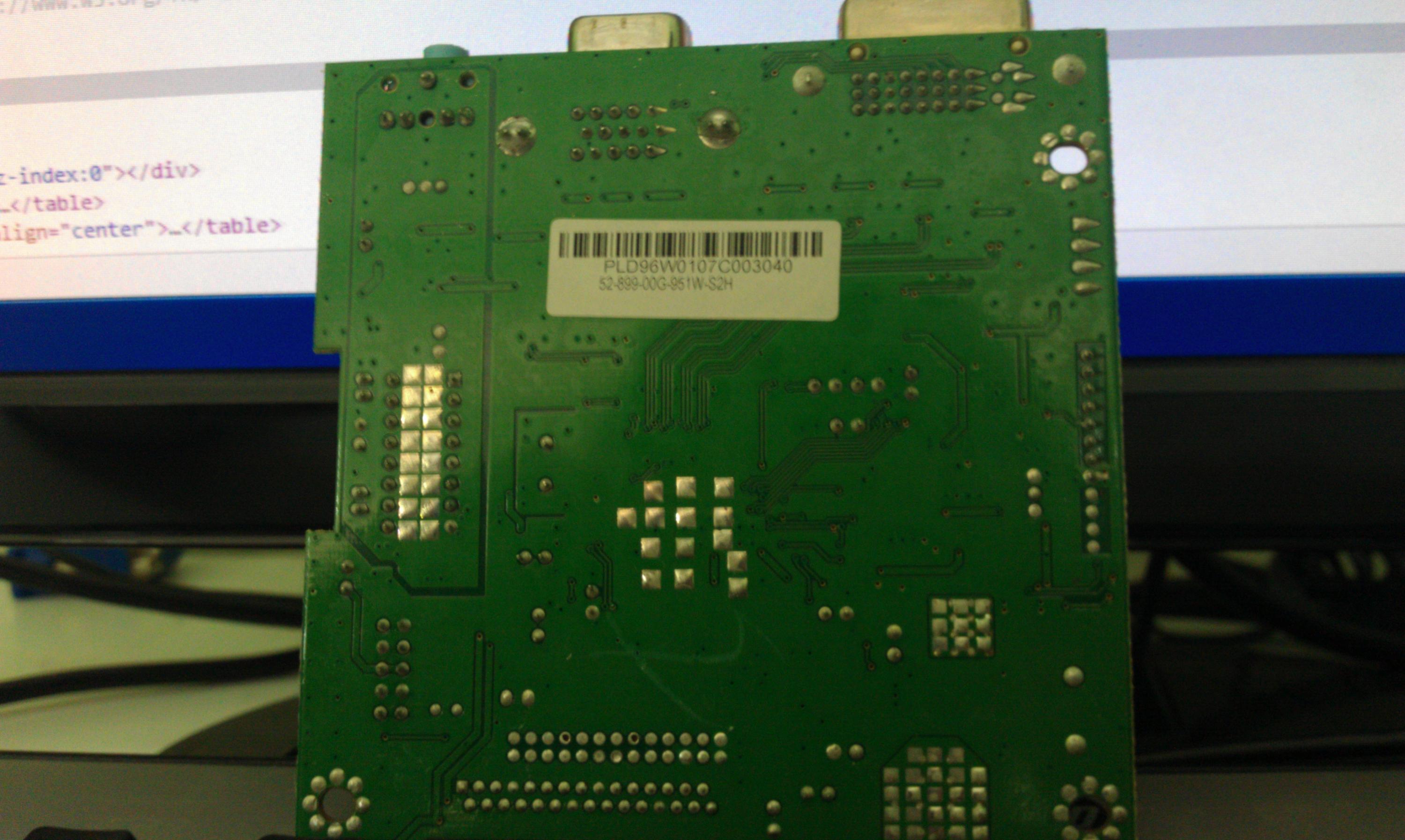

              Main board pic front is not really clear enough - you need better light - near a window or outside? In the last picture you show the board fixed to the panel. I need a clear picture
              of that board - take it in 3 sections to get it bigger.

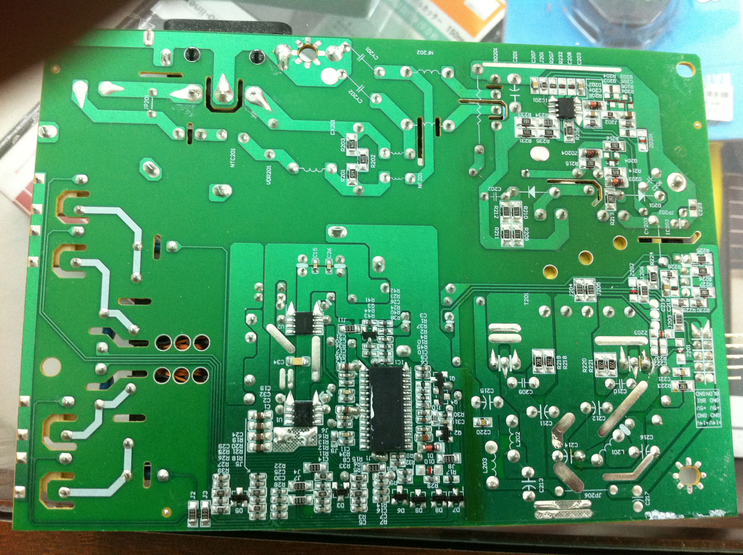

                pics

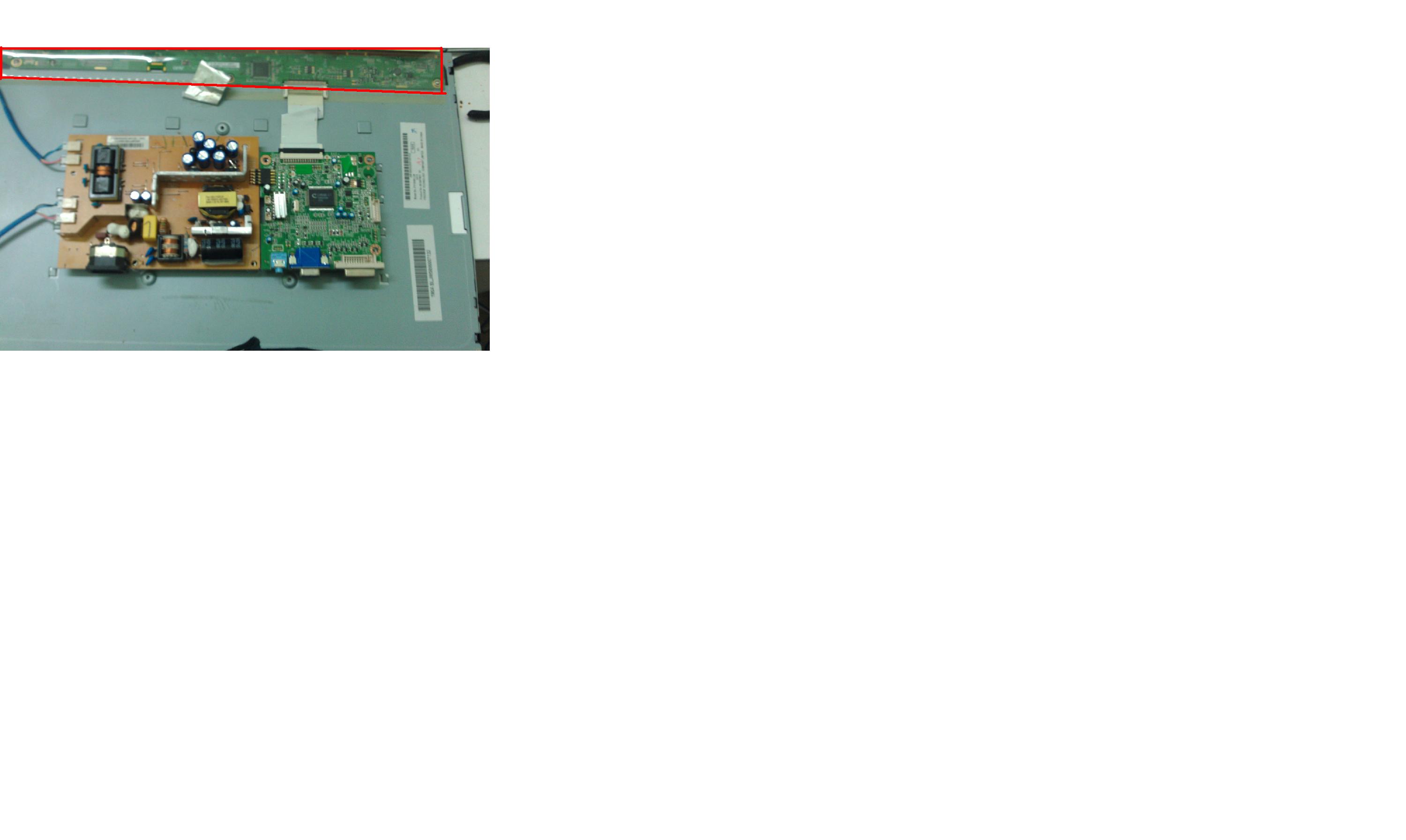

                  Golly this is hard work! On the up side the pics are much better.- Thanks
                  When a screen is all white it is often due to a problem on the long thin board attached to the panel. The best way to get a picture is to take 3 - left centre right. You may need to fold the plastic back and sellotape it.

                            • selldoor
                              Slow Learner
                              • Dec 2010
                              • 7870
                              The long thin board outlined in red in post 9

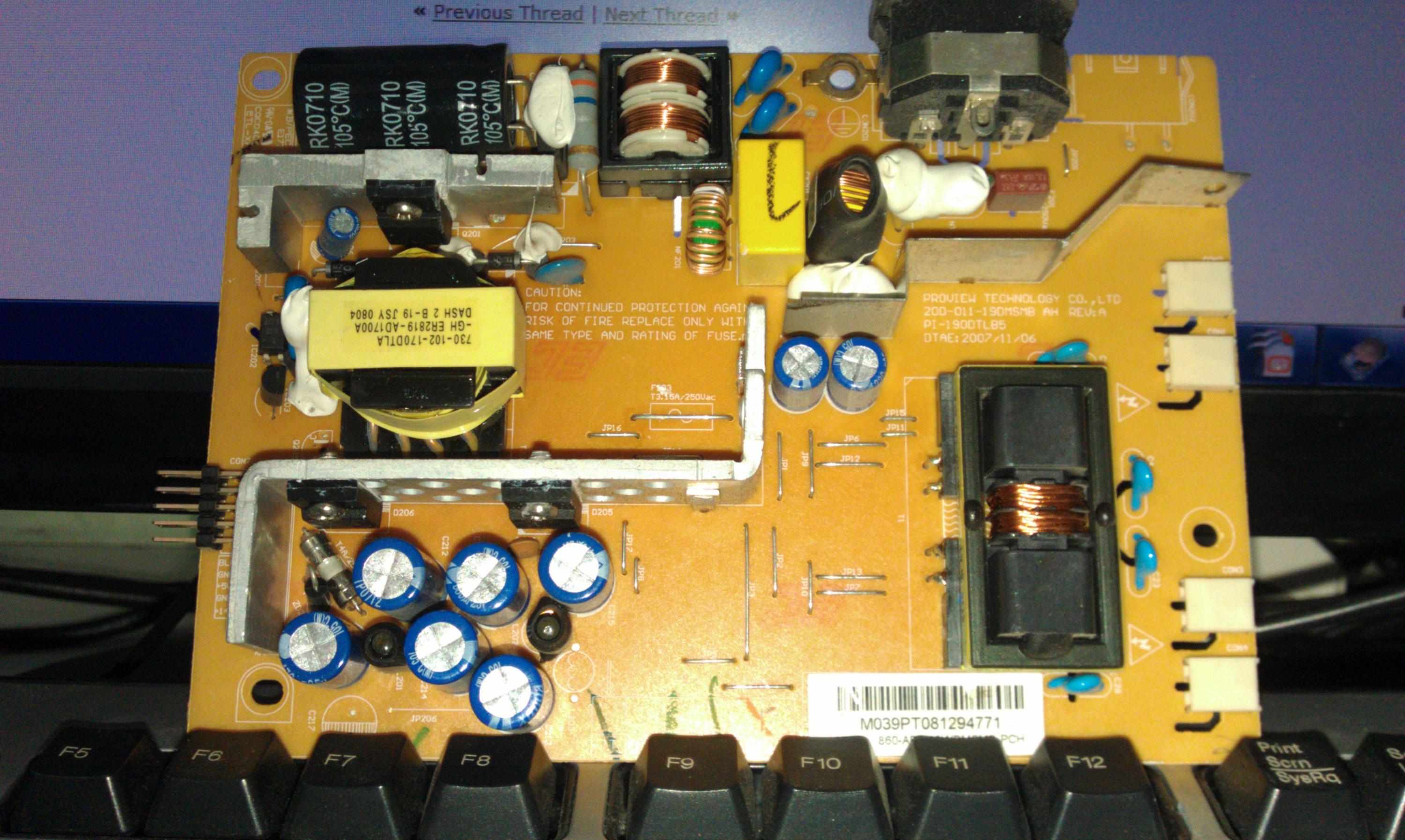

                                okay know iam understand , do you think that's the problem ?
                                look from what iam thinking the problem is from the powersupply because when i mesure 13 v pin, it will show on the multimeter 0 volt

                                  You DO measure the voltage against ground, right? I don't think PSU is bad anyway, you won't get anything without it. Obviously backlight works otherwise it would be black so problem is either logic board or the display's board.
                                    Instead of making pictures you can first search for a little white smd fuse on the panel's board (the long one), it is often marked as F1 or F2 and test it, the reason that you doesn't measure those 14v (not 13) is that there isn't the jumper jp206 and is normal by the factory, the panels runs at 5v usually, somethimes at 12v, maybe in other sub models there's the need of the 14v line to the main board (for the panel probably)
