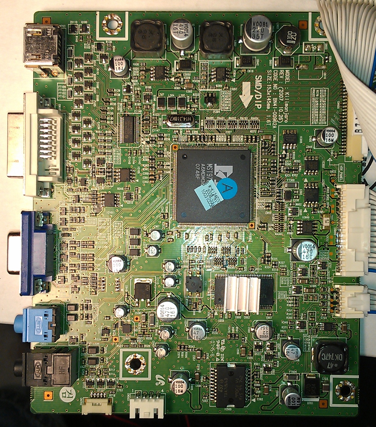

      There is a rattling noise (sounds exactly like a baby rattle, except softer) coming from logic board when it is tapped or shaken.
      I didn't see any obviously blown caps/resistors/fuses.
      There is some glue on the board but it doesn't look bad/brown like in other threads.

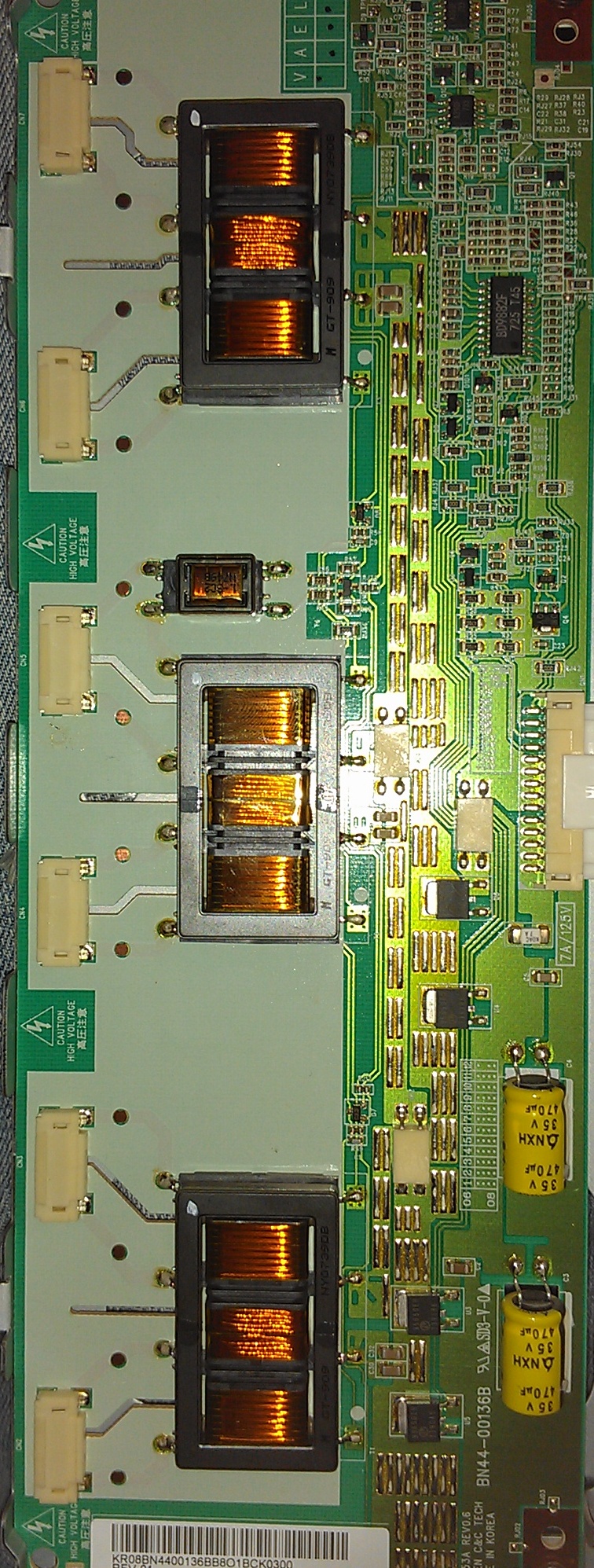

      When I took voltage readings the 6 CFLs were not plugged into the inverter (because I could not get to the boards without unplugging them.)

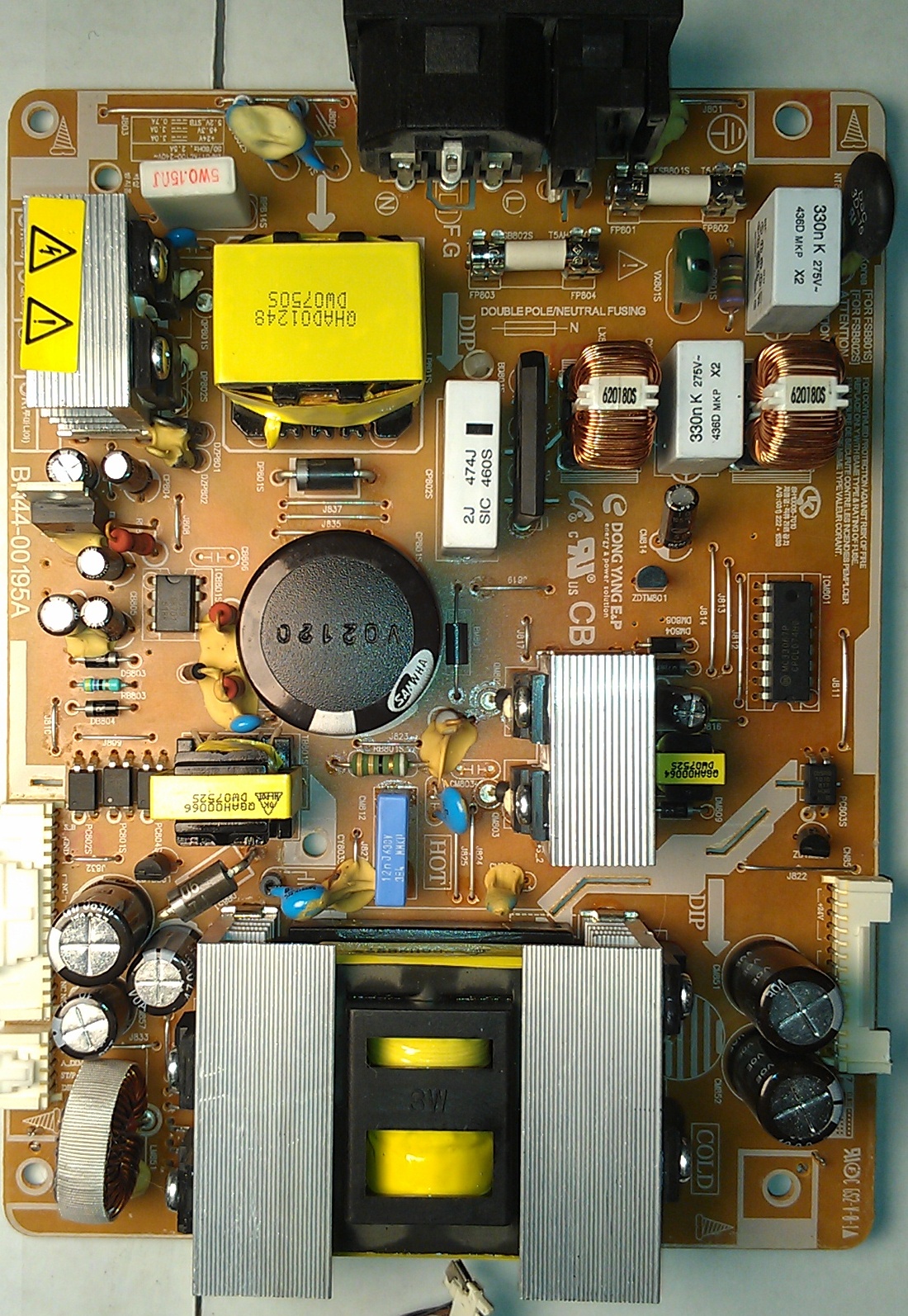

        The 24V will not be working until the PFC Voltage booster circuits work first.
        When work in the Primary side (hot side) you will use the negative leg of the large cap as the primary circuits Ground ref. for all the voltage measurement in the Primary side.
        The chassis ground is for the secondary (cold side) circuits ground ref point.
        I would remove all those yellow glues first (the glue become conductive and turn brown in color, it is also corrosive), you can soften them up with alcohol first before removing them.

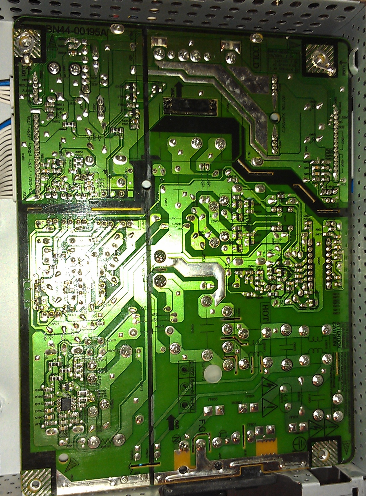

        Can you please take the straight shot pictures of the bottom side of the power supply board, also closed up in 1/4 section so we can easily see the SMD components and traces?
        Check the DC voltage between jumper J808 (next the 8-PIN IC: ICB801S?) and the Negative leg of the large cap, it should have about 15VDC.

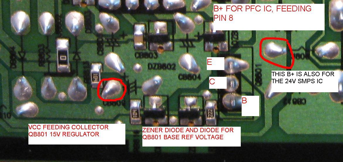

          Pin8 of the SMD PFC IC (ICP801S) gets the power through linear regulator transistor (TO-220, QB801) sitting next to the 5.2V SMPS IC. You should see about 25VDC between the metal tab (Collector of QB801) and the Negative leg of the main large DC filter cap. The voltage between the Base pin of the transistor and the negative leg of the main filter cap should have about 16VDC.
          By the way, check resistance reading between the VCC PIN 8 and the Ground pin6 of that PFC IC.

                solved case that worked for me after all procedures above failed in my case:
                my psu is a BN44-00195A model 245B2 (slightly different part numberingfrom schematics above)
                symptom was:
                a black screen with blue power light steady on.
                5,2V standby power was ok, primary PFC voltage was ok (380V for my european 220V input monitor). but the backlight 24V was not there ...(5.3V was not their either since it is a byproduct of the main 24V output...).
                what I did:
                A) replaced most polarized cap though all my caps looked ok (no bulging top)---> still black screen
                B) checked for the yellow glue becoming conductive, clean up a couple of components ---> still black screen (no 24V out)
                C) checked the operation of the MC33067P ICM801
                pin 14 was always high and pin 12 alway low...check the oscillator (pin 2 ) and their was no oscillations there, so I started looking at reasons for not startup of the IC in the datasheet...
                pin15 12V was ok (power supply)
                pin 8 non inverting output of error was 5.1V =(ref voltage of the IC) --> force max oscillator frequency in principle...
                pin 10 fault input was low when I mesured it...so in principle all was ok , no fault detected ...
                By reading the datasheet of the IC , I noticed that if there was a pulse greater than 1v on the fault pin the IC would lock itself to prevent serious damage and remain in that state until power is removed...
                It was a long shot but I decided to connect my DSO (! use double 12V-220V AC 3A transformers back to back on the 220V ac input to allow the whole supply to float and prevent to blast my scope inputs!!!! Ov of the scope is connected to earth in principle...)
                So, i measured (captured) the Pin 10 level as I flipped on the power switch of the PSU and I noticed a tiny 10ms 1.1V pulse on the fault line after 200ms then the line was perfectly below the 1V threshold of the fault input pin (pin10)...I was nearing the solution.
                There are two separate circuits tha can trigger a fault condition on pin 10:
                1)- the overvoltage monitoring circuit via opto PC802S on the schematics(PC804S on my PSU model)
                2) the "feedback/monitoring circuit" from the primary of the TM801S transformer (DM805-CM809-RM815 on the scematics)
                on the overvoltage monitoring circuit, I disconnected the 0 ohm resistor (it not on the schematics, but on the PCB is is easy to find by following the tracks)
                between the PC802S opto led cathode and the LMBT2222 transistor to desactivate that circuit and measured again the power up sequence on pin 10 ---> the 10ms pulse high was still there....
                Then,
                I checked carefully feedback components from the the primary of TM801S transformer and noticed nothing abnormal at first, then I notice some of that yellow hardened glue on the 47pF 1KV capacitor (CM809 on the schematics) in the feedback circuit. That glue was covering both legs of the capa!!! It was a long shot but I decided to desolder the capa and clean it up as nice as possible without breaking it...soldered it back...and it WORKED! The MC3306P was oscillating nicely and the 24V was back, I reconnected the 0 ohm resistor of the other monitoring circuit and all was OK.
                My 2493HM monitor is back to life and so far it as been working perfectly again...
                So my advice is CHECK the Yellow glue on all critical components and remove it if you can!!!
