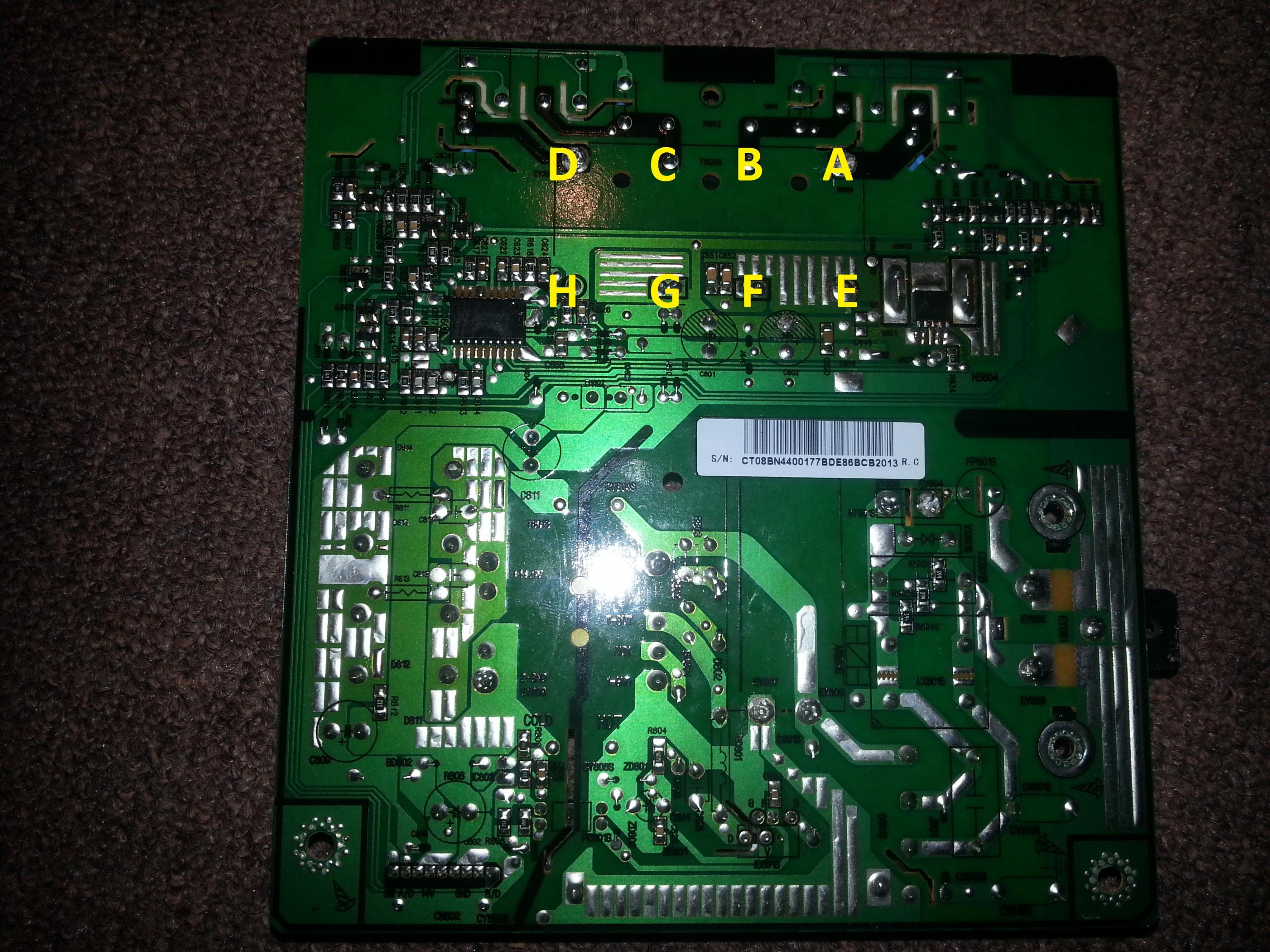

    I have another monitor which is a 19" HDTV / Monitor that has the fade to black after 2 seconds symptoms.
    Caps all look fine, but can someone tell me if my inverter readings are ok?
    D - C = 1198 ohm
    B - A = 956 ohm
    H - G = 0 ohm
    F - E = 618 ohm
    I'm not 100% sure I know which is primary or secondary.
    Is this enough info to determine if the transformer is working correctly?

    Re: Samsung 932MW - Fades to black
    Secondary are A to B and C to D
    so they do not look good - Some of the solder doesnt look great
    and it will need reflowing. Fortunately these are available
    so I suggest you remove carefully from the board and re- test.
    EDIT -- should be approx 1.2kohms on both so they are well outside the 3% rule but worth testing off board in case of outside influences.
      Thanks, I will re-flow the solder now and test again.
      Found replacement inverter for £4.90 on eBay with free shipping so hopefully an easy fix!
            I removed the inverter, and have retested. I didn't have a solder sucker neither any solder wick, I removed it by slowly prying it off while heating up the terminals.
            A - B = 1145ohm
            C - D = 1247ohm
            E - F = Nothing (just said 1 on the meter)
            G - H = Nothing
              When you solder that part back (or replacement), change also those smaller electrolyte capacitors. It is not a big cost. Lack of visible failure signs (leaks) is not guarantee. Huge cap is probably okay, but at some point that can be also checked/changed (it's more costly).
                I dont think there is much point soldering it back its around 8-9% adrift.
                  I will replace both the transformer and the electrolyte caps. Thanks for your help.
