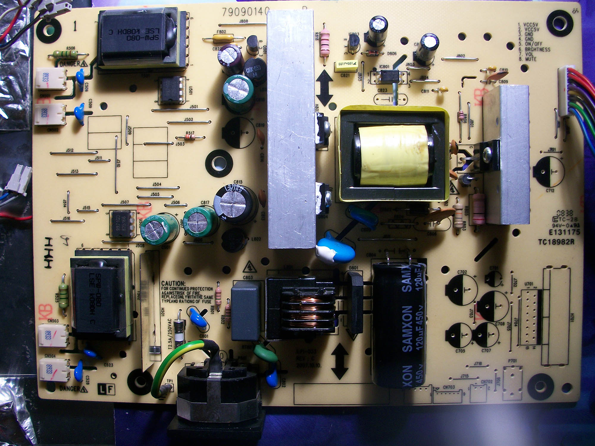

    I opened the screen to study the problem (cf picture)
    All fuses are OK
    All capacitors are OK
    On CN801
    While off
    1) 5.05v (VCC 5V)
    2) 5.05v (VCC 5V)
    3) 0V (GND)
    4) 0V (GND)
    5) 0.03V (on/off)
    While on
    1) 5.05v (VCC 5V)
    2) 5.05v (VCC 5V)
    3) 0V (GND)
    4) 0V (GND)
    5) 0,03V (on/off)
    I think the problem is there, the pin on/off is always near 0V, even if I push on the ON/OFF button.
    On the logic board, regulator at U106
    Pin 1 reads 0 volts
    Pin 2 reads 3.29 volts
    Pin 3 reads 5 volts
    On U501 and U502 (two n channel mosfets) there is always 17.8V
    On the 16 pin IC, IC501 (OZ9938), pin2 (VDD) is correct (5V)
    Pin 10 (ENAble) is always 0,05V, it's not correct
    Have you any idea of the source of my problem?

        I connected a 3 volts batterie between the pin5 on/off and pin3 (0V) of CN801. Only the ground is welded and I establish the contact with the other side of the battery on pin 5 of CN801. The results are the following
        Note : CCFL are removed
        On IC501 (OZ9938):
        Pin1: 0V (OFF) then 2,38V during ~3s (ON) then 0V (DRV1)
        Pin2: 5V (OFF) (VDDA)
        Pin3: 0V (OFF) then ~2,87V during ~3s (ON) then 0V (TIMER)
        Pin4: 1,128V (OFF) then 1,131V during ~3s (ON) then 1,128V (DIM)
        Pin5: 0V (OFF) then 0,01V during ~3s (ON) then 0V (ISEN)
        Pin6: 0V (OFF) then 1,90V during ~3s (ON) then 0V (VSEN)
        Pin7: 0,32V (OFF) then 0,43V during ~3s (ON) then 0,32V (OVPT)
        Pin8: 0V (NC)
        Pin9: 0V (NC)
        Pin10: 0,04V (OFF) then 3,16V during ~3s (ON) then 0,04V (ENA) ON/OFF
        Pin11: 0,76V (OFF) then 0,77V during ~3s (ON) then 0,76V (LCT)
        Pin12: 5V (OFF) then 0V during ~3s (ON) then 0V (SSTCMP)
        Pin13: 5,1V (OFF) then 1,15V during ~3s (ON) then 5,1V (CT)
        Pin14: 5,1V (OFF) then 1,15V during ~3s (ON) then 5,1V (GNDA)
        Pin15: 0V (OFF) then 2,35V during ~3s (ON) then 2,35V (DRV2)
        Pin16: 0V (PGND)
        I think the operation is normal now. According the datasheet of OZ9938
        if a CCFL is removed or damaged during normal operation (this is my case, CCFL are removed), the voltage at SSTCMP (pin 12) rises
        rapidly. When the voltage at SSTCMP reaches a threshold of approximately 2.5V, a current source charges the capacitor connected to TIMER
        (pin 3). Once the voltage level at the TIMER pin reaches a threshold of approximately 3V, the drive outputs shut down and latch.
        Next step : trying to connect lamps

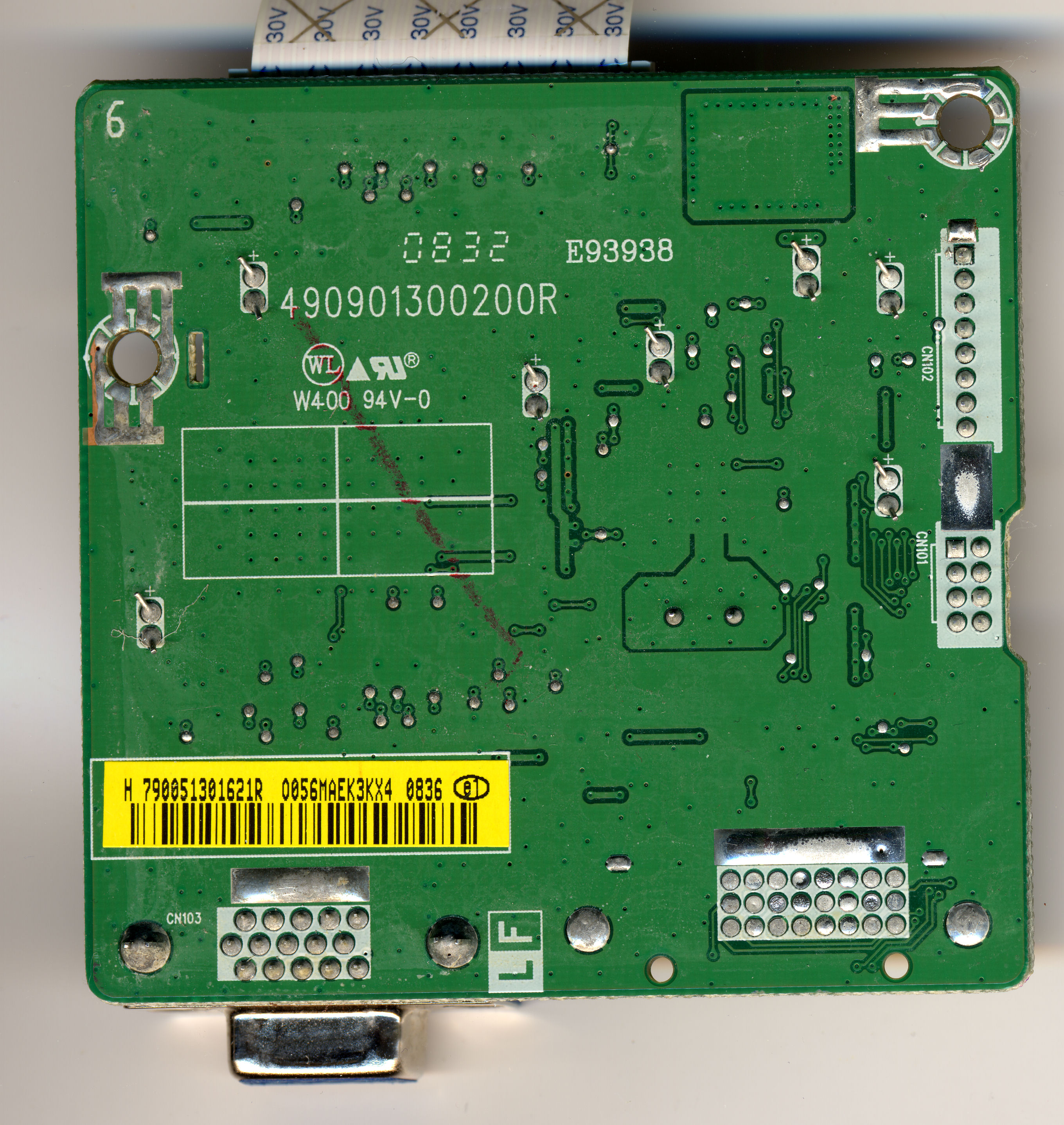

                      I checked my I/F board with the service manual file. Unfortunetly the card described in this document is not the same as mine. So I have some difficulties to understand how the voltage comes on CN801, from ON/OFF button.
                      Could you help me please ?
                      • selldoor
                        Slow Learner
                        • Dec 2010
                        • 7870
                        Re: Acer X223W is black without led
                        Yes I looked at that decided might need to check Q102&Q105 then when I looked for them on your board they were not where they should have been.
                        What is the part number of your board?
                        Perhaps do a close up picture of the top left corner of the board not shadowed by the caps so we can see the traces. so we can trace back
                        from the pin.
                          LF board 490901300200R
