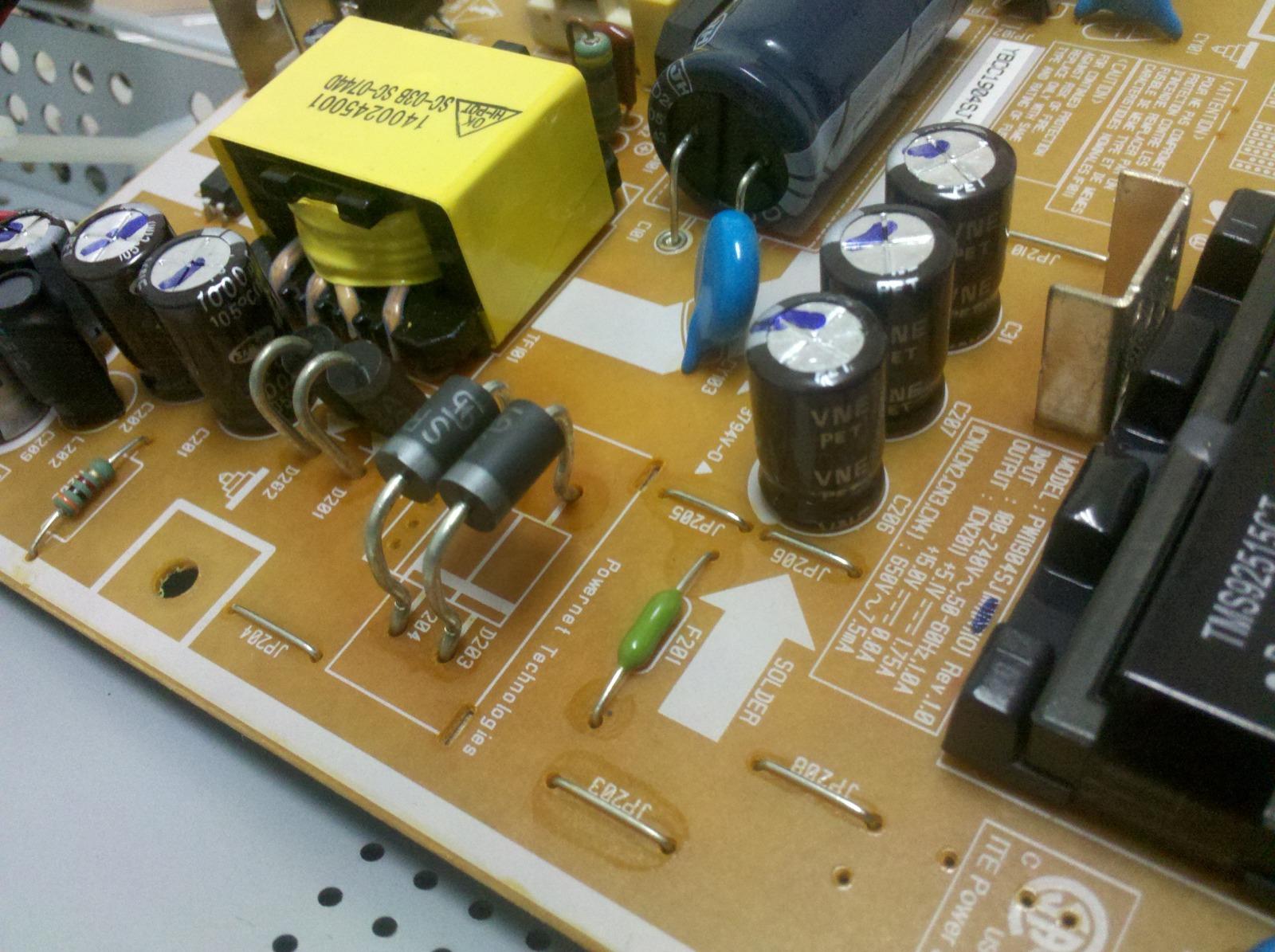

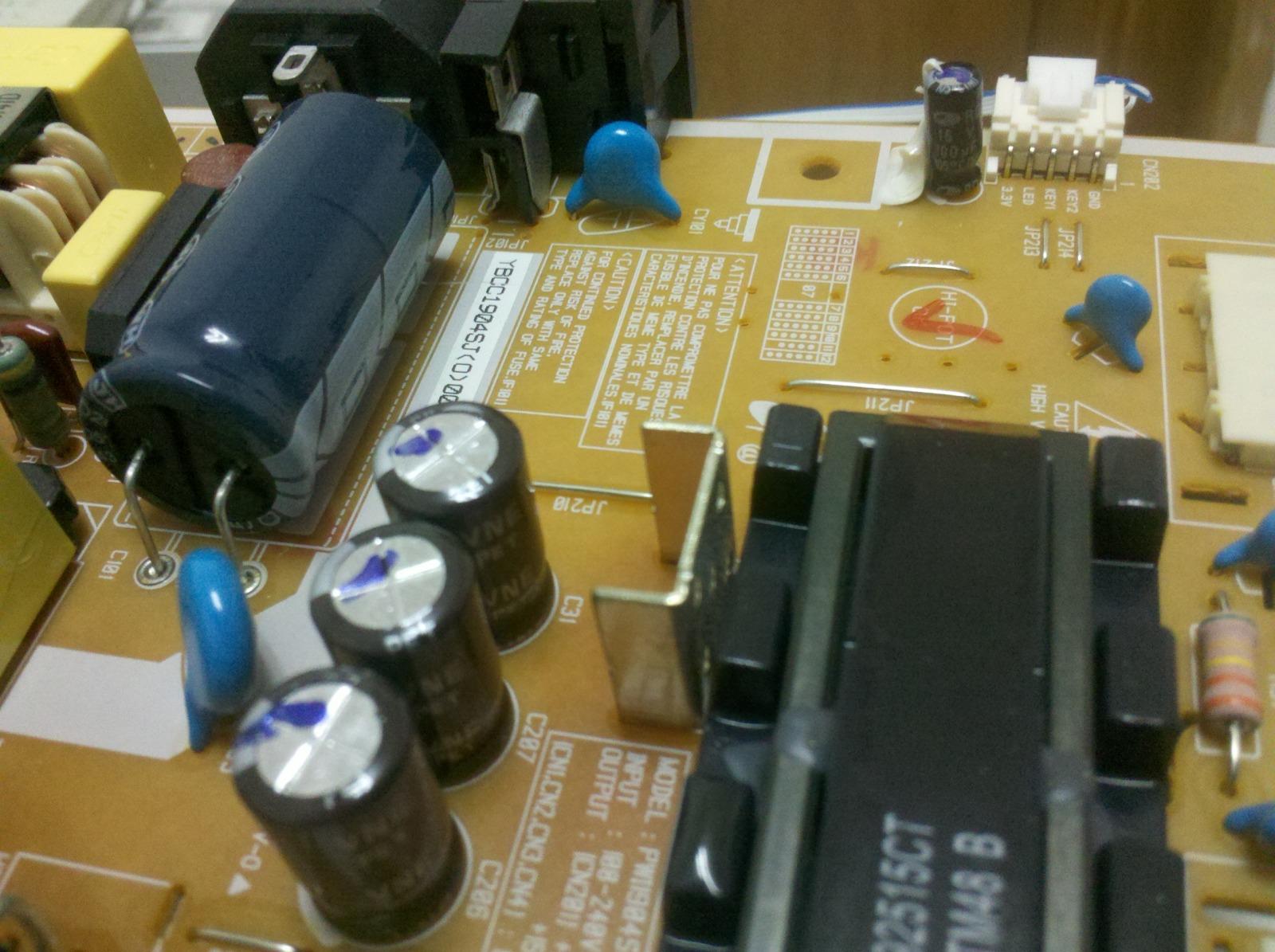

    can anyone detect if there is any bad cap because my monitor turns off every 2 seconds and I was thinking if there is any bad cap?

            I always replace C201 C202 1000uF 16V caps, and C209 470uF 25V
            C203 is 330uF 25V cap
              Re: Samsung Monitor
              I cant see any bulged or leaking caps but that doesnt mean they are still good.
              You mayhave 2 seconds to Black which could be for many reasons.
              Here is a guide written by retired caps - start at post 19 https://www.badcaps.net/forum/showthread.php?t=10419
              When the monitor "goes off" does the power led stay lit?
              Can you see a very dark image on the screen - may help if you have a vivid picture on the PC and shine a flashlight at different angles.

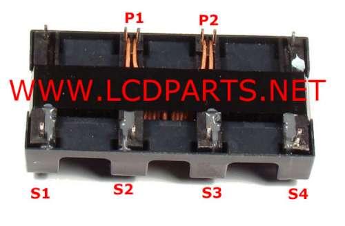

              One thing to test is the Inverter transformer/s
              Set meter to 2000 ohms and measure S1>S2 and S3>S4 as on the attached pic and post results.
