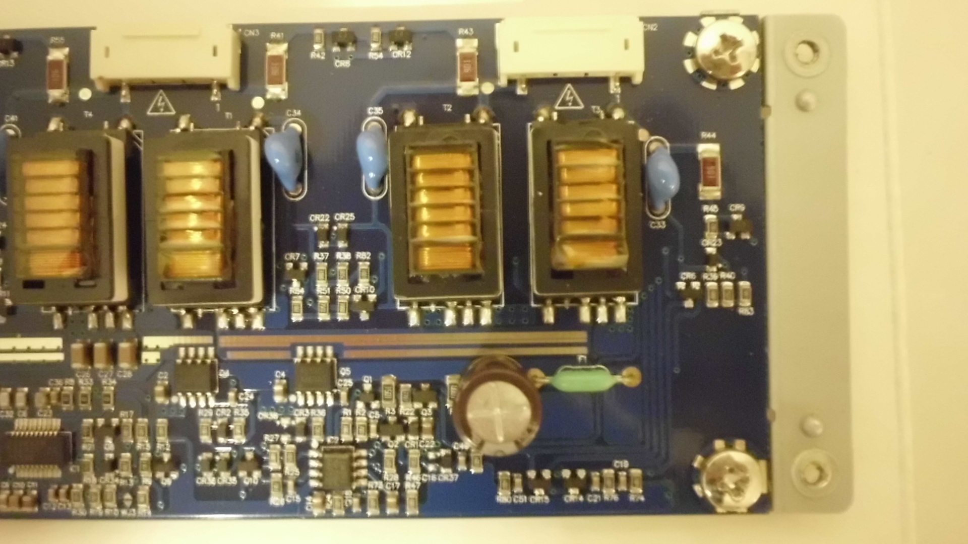

    Symptoms:
    When power is switched on the power led blinks green once (signal color). I'm not sure it should behave like that under normal conditions.
    During the 1st cold boot the monitor works fine after recapping, however after you turn it off it no longer shows anything. It starts to show the acer logo for 0.5 s and blinks once with lamps. After that the screen stays black, no indication of backlight and the signal led stays green (signal detected).
    Done so far:
    changed all bad caps (already leaking caps on inverter board)
    checked pico fuses ~1 Ohm, however my current multimeter isn't very accurate at such low resitance
    monitor works every cold boot (no power for some hours)
    Any ideas based on symptoms what to check to at least narrow it to one of the pcbs ? I've only got very basic experience with electronics, so please be precise.
    I'll get some images once I find my camera power cable.

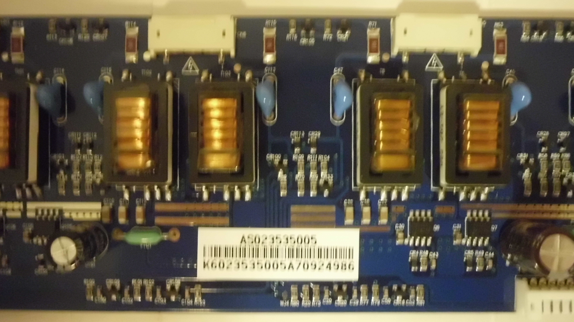

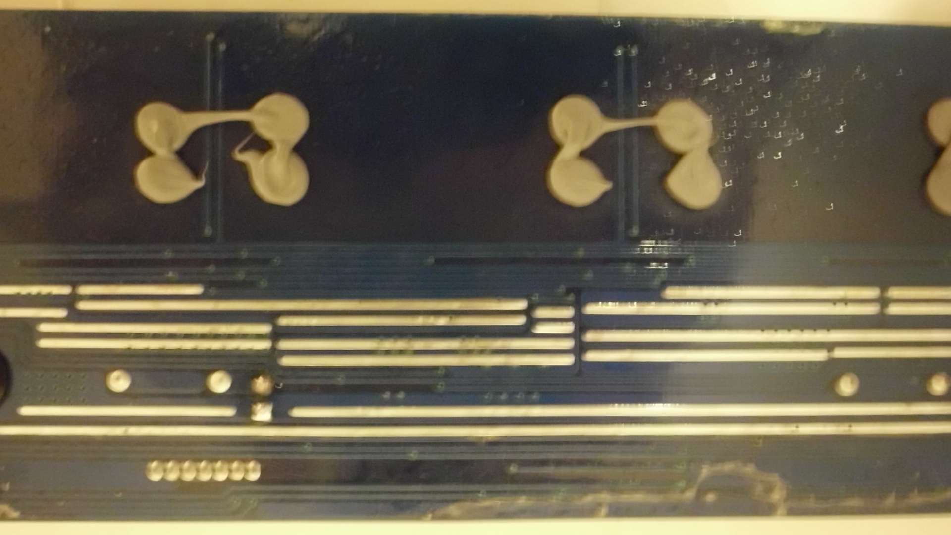

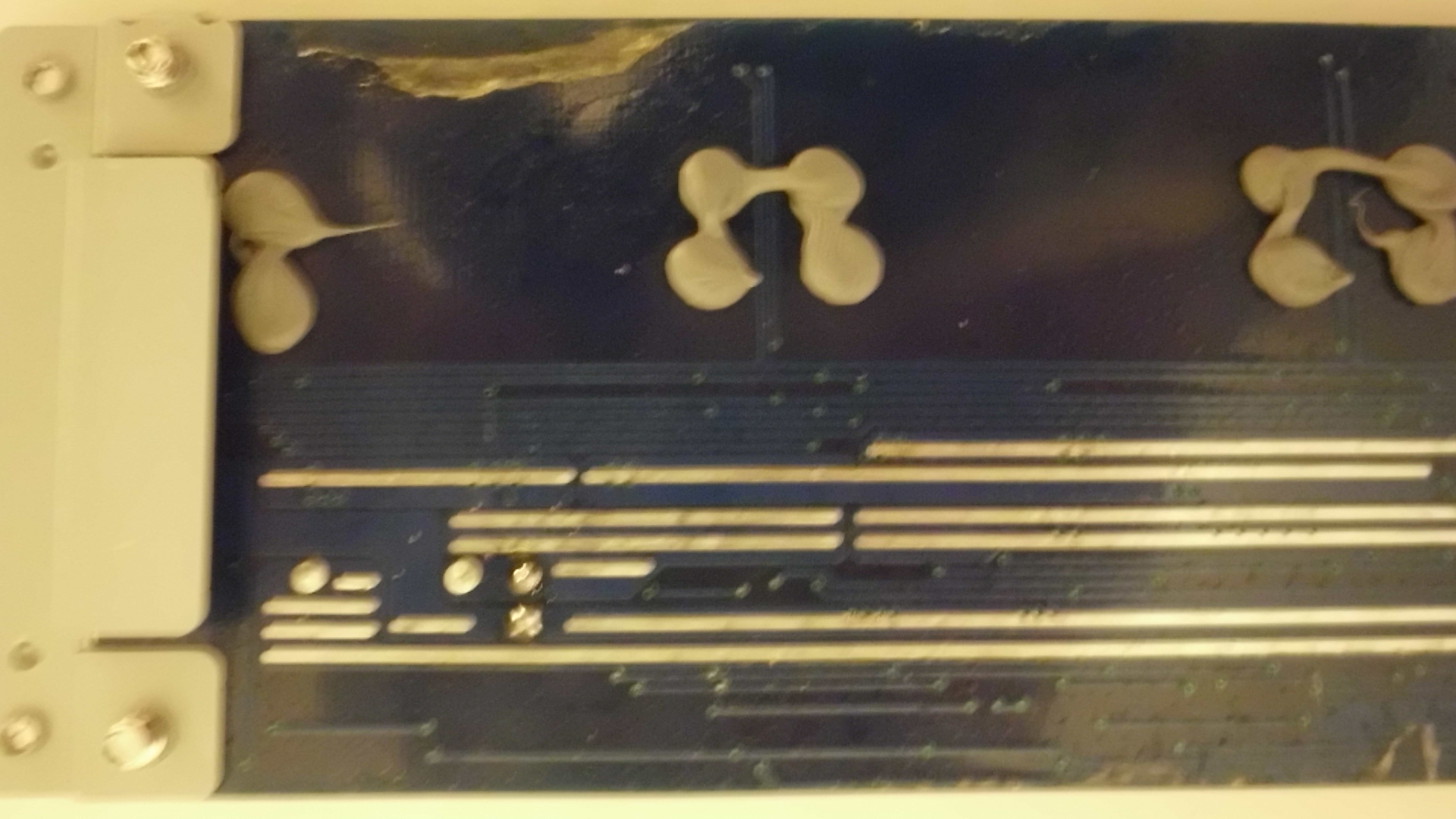

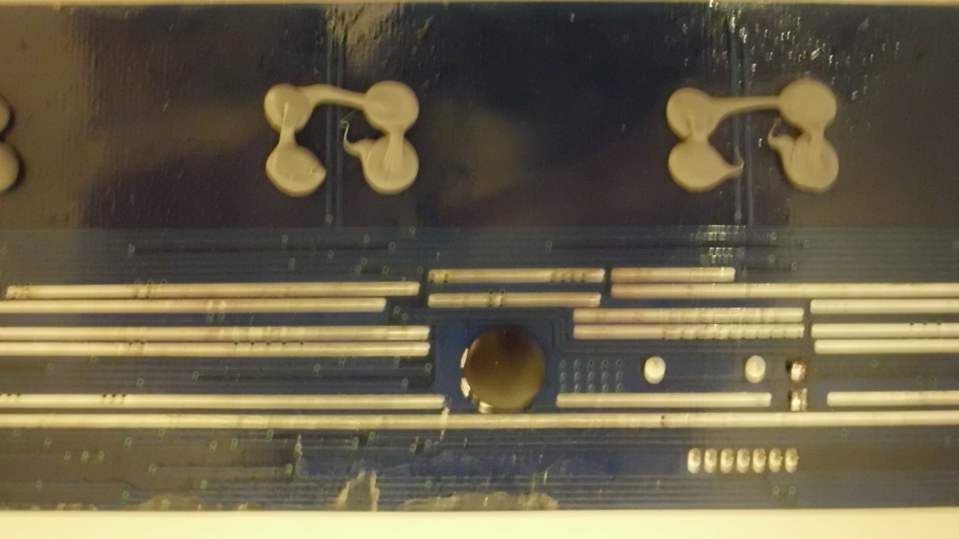

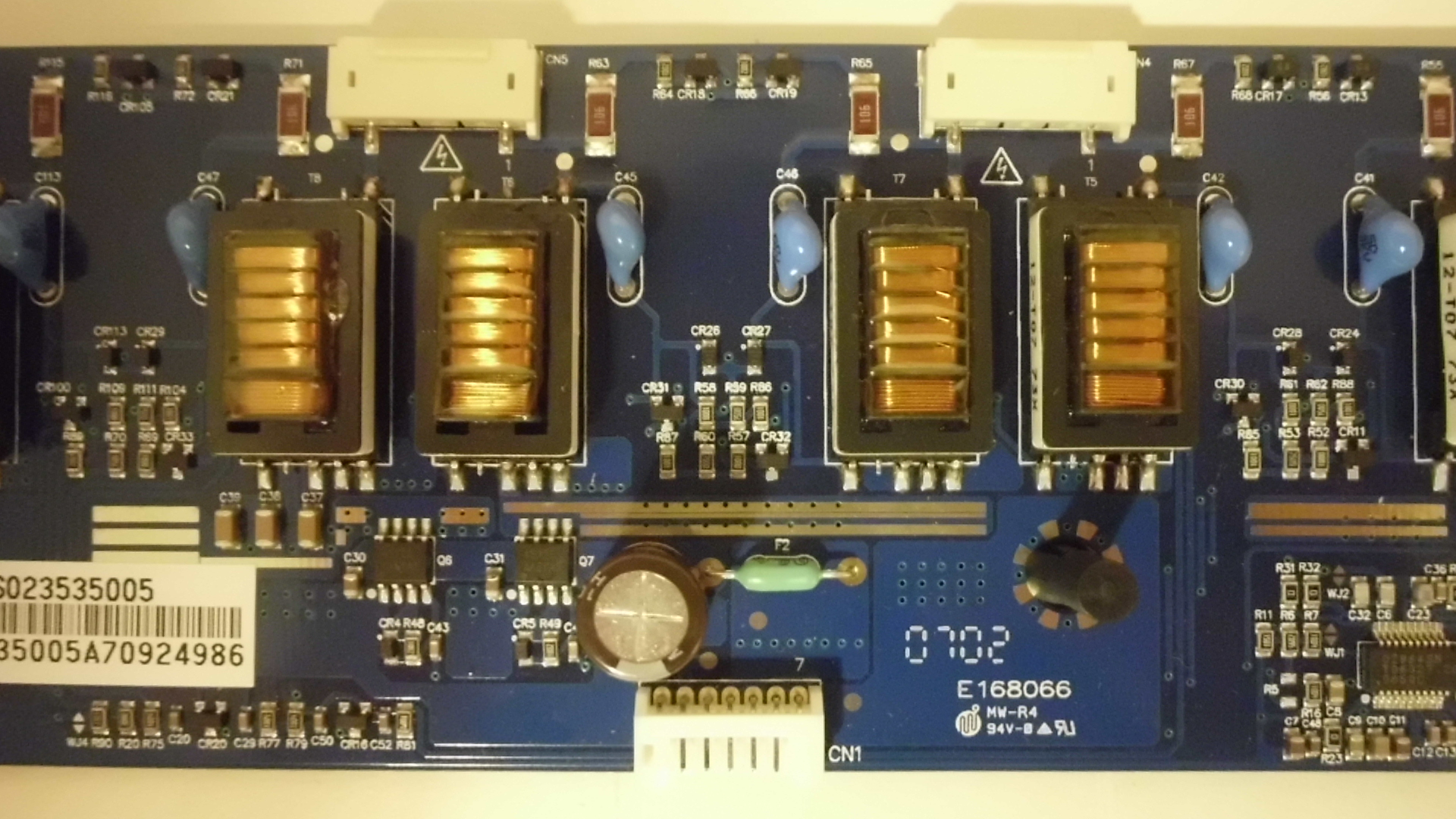

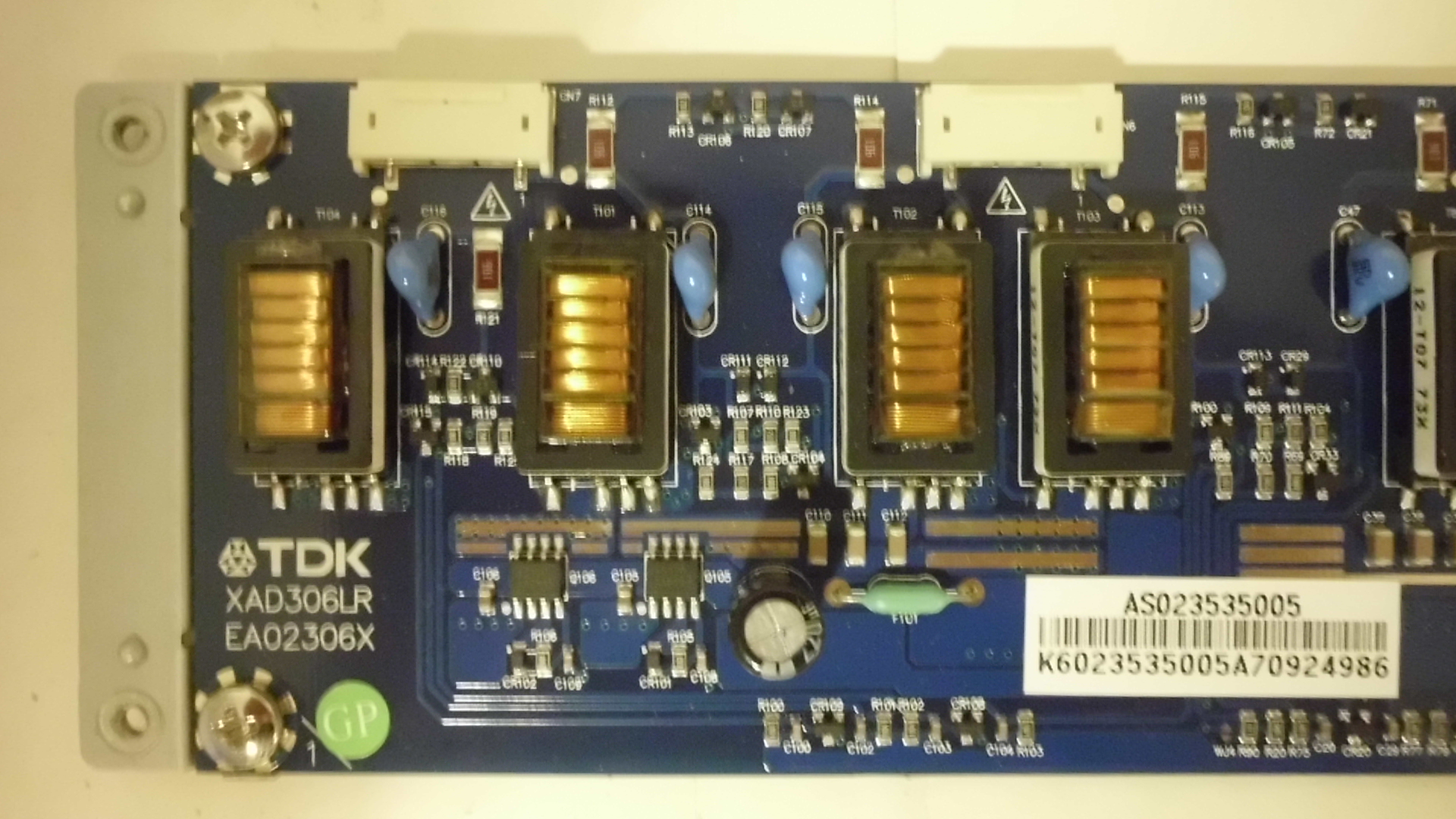

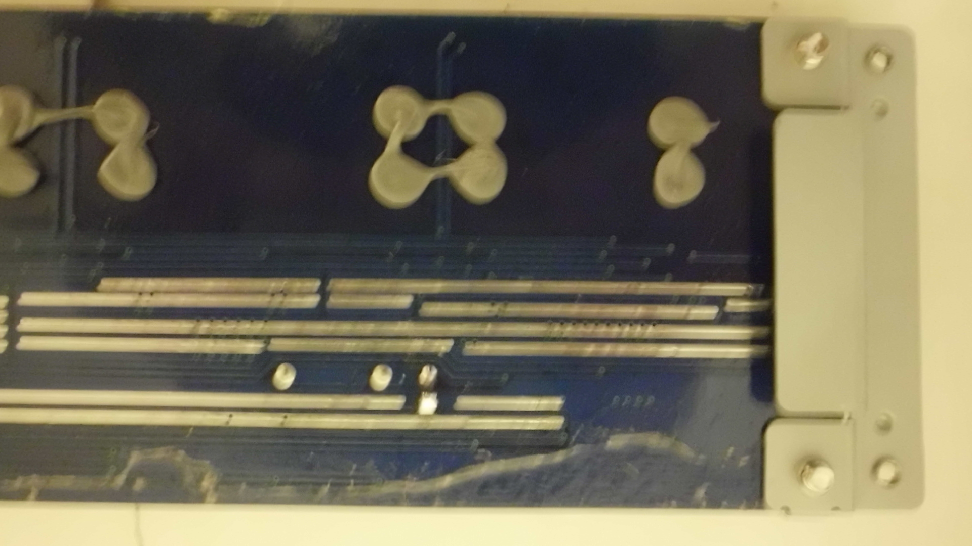

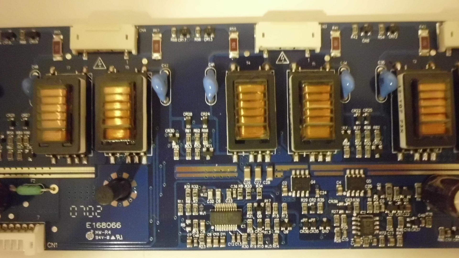

        Re: Acer AL2423W
        After the exchange of capacitors on the inverter board and 1 on logic board it's working for very long time with source, so normal operation with image showing and backlight working. I've only tested for ~2h, but I suppose it could work till I switch it off.
        I'm sorry for the quality and cutting of the images , but as I took those photos I learned my camera doesn't support macro mode very well and the whole images were too blurry.
        I can try to retake them at better lighting during the day.
        I'll get to unscrewing the power and logic board again to get more pictures if those are acceptable.

              Re: Acer AL2423W
              OK, so when it goes dark, do you still get 24vdv on those green PICO fuses on the inverter board. We need to find out what signals you lost when it goes dark: the 24v power from the power supply, or the bl_on signal from the main board.
              • Gilfar
                • Dec 2012
                • 4
                • Poland
                Re: Acer AL2423W
                I checked them and there's no power 0 VDC on any of those PICO fuses on the inverter board.

                  Re: Acer AL2423W
                  We are going to need pictures of the front and back of both boards.
                  Good light but no flash is needed.
