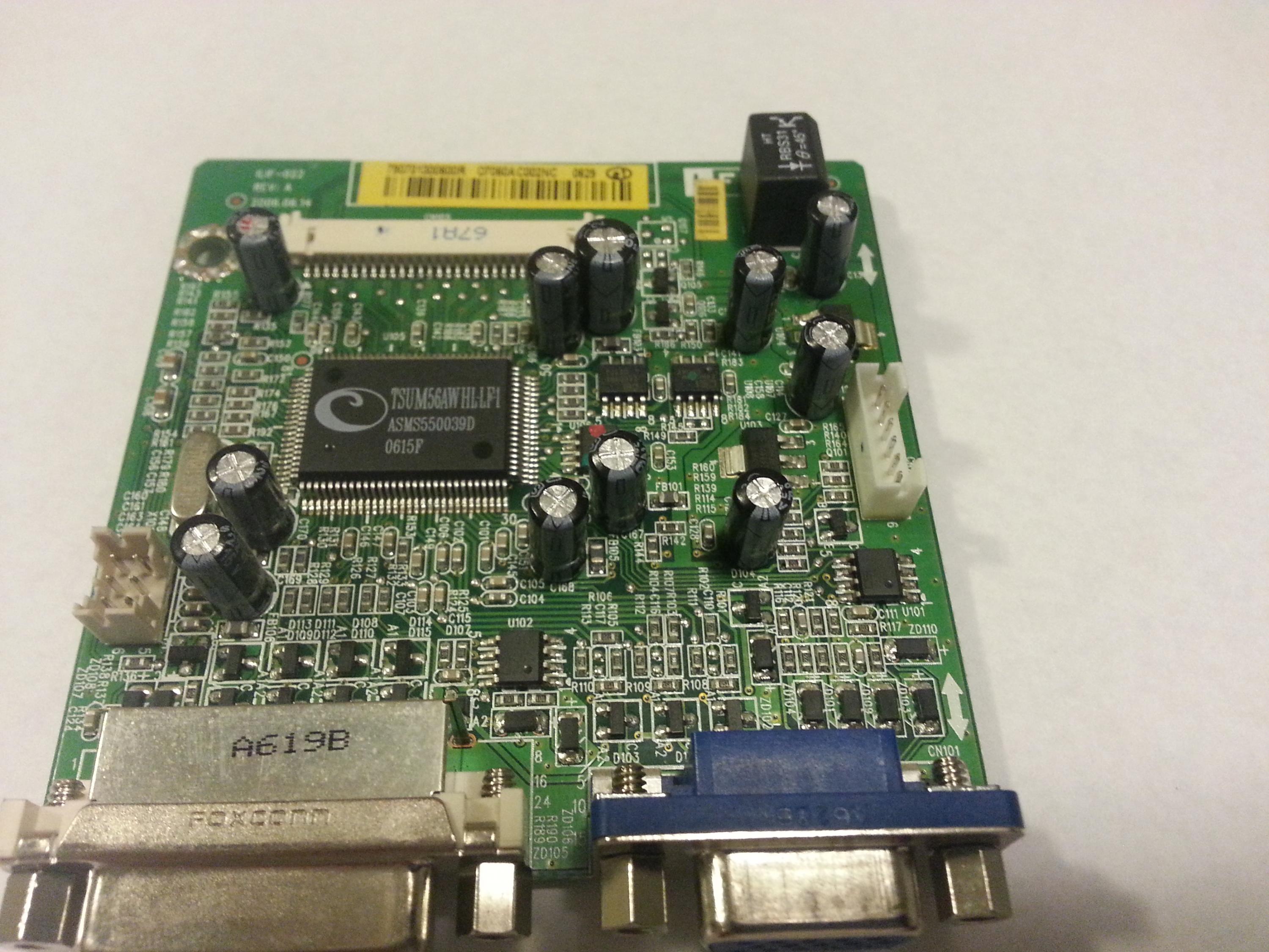

    Newbie warning!!
    Power on the display, shows the screen for about 2 seconds then goes dark. With a flashlight you can see that it is still on. The blue led power button remains on.
    1st thing I did was replace the power board capacitors even the looked fine. No change, but it was my 1st experience de-soldering as well as 1st circuit board soldering so just that fact this it wasn't broken worse was a small victory.
    Sounds I replace the logic board capacitors?

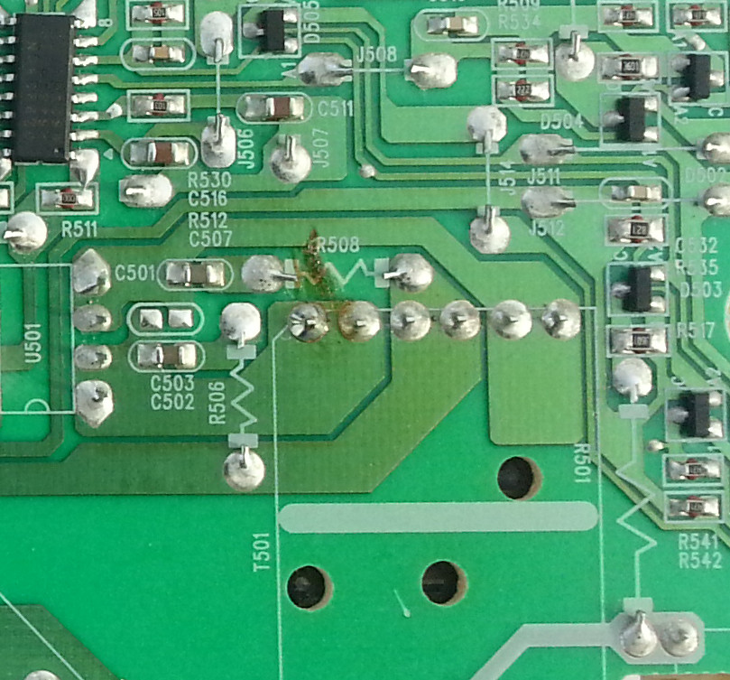

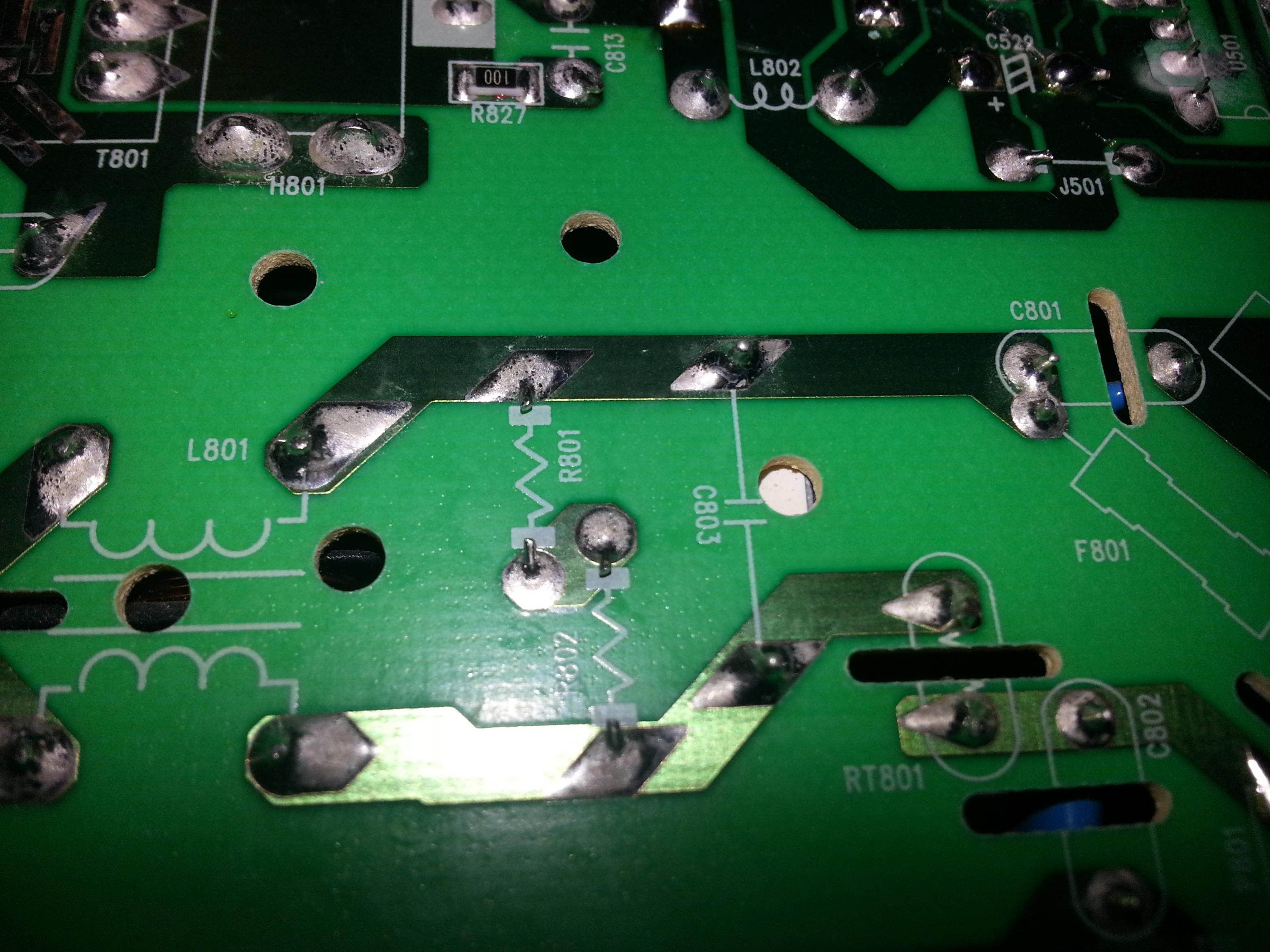

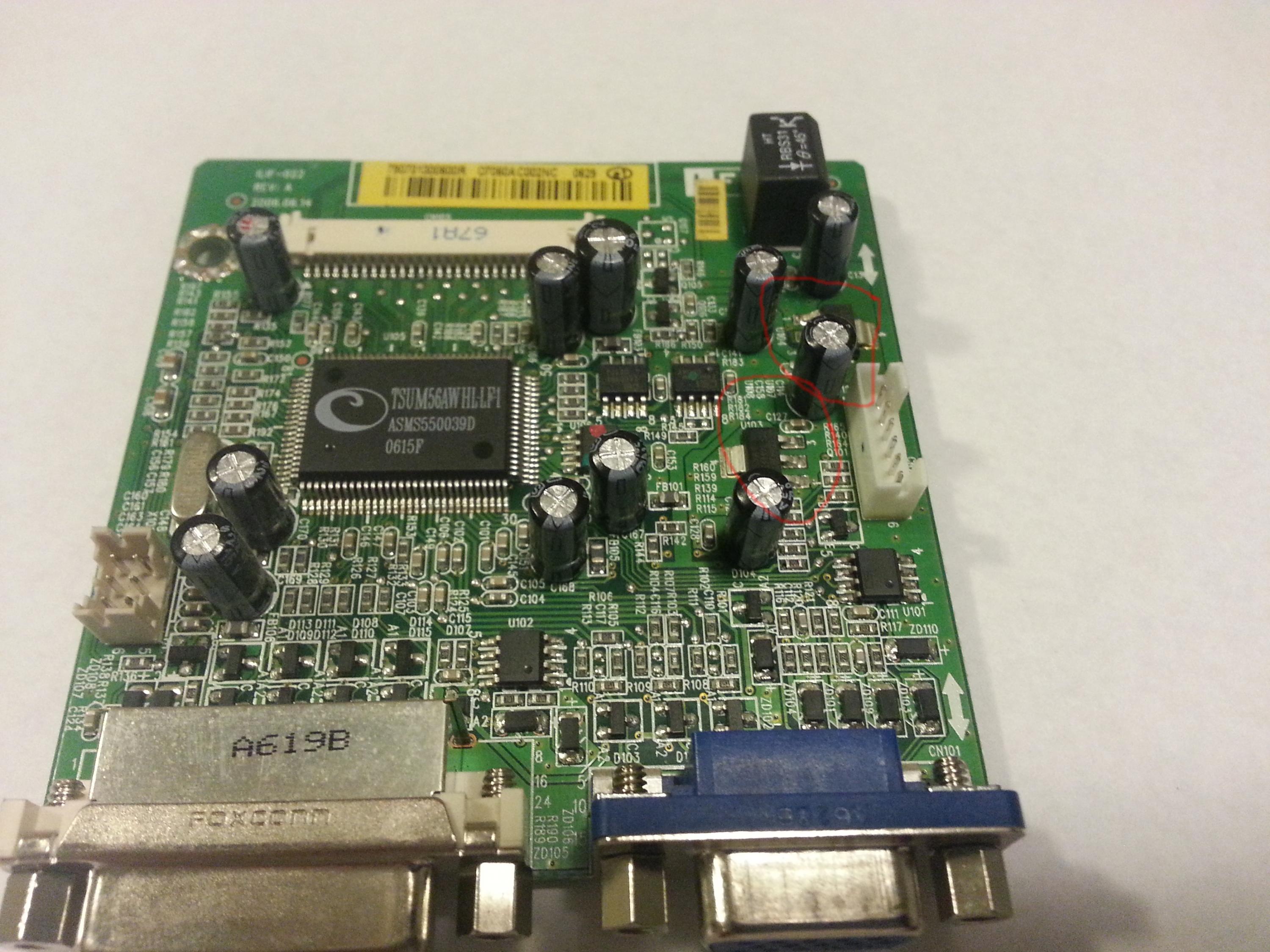

    Next I moved on to Step 2 - Shorted Transistors. I tested what I *think* are the transistors.
    In the picture the top most one circled was:
    1 - 2 = 1.0
    1 - 3 = 29.7
    2 - 3 = 30.9
    Other circled:
    1 - 2 = 0.8
    1 - 3 = 29.8
    2 - 3 = 30.7
    Questions:
    1) Did I test the right things?
    2) Did I miss any?
    3) The instructions say anything below 20 Ohms is a bad transistor so are both of mine bad?

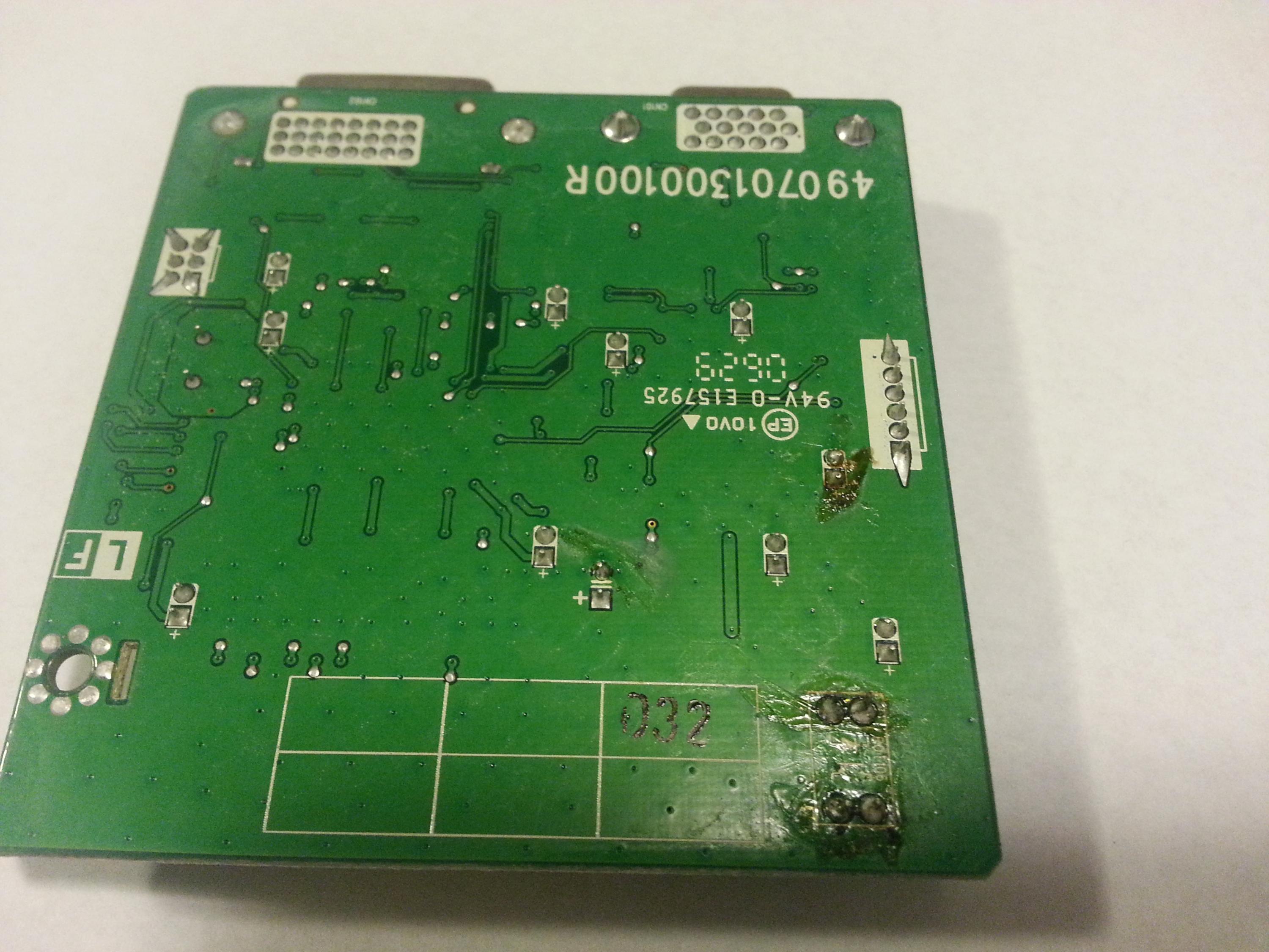

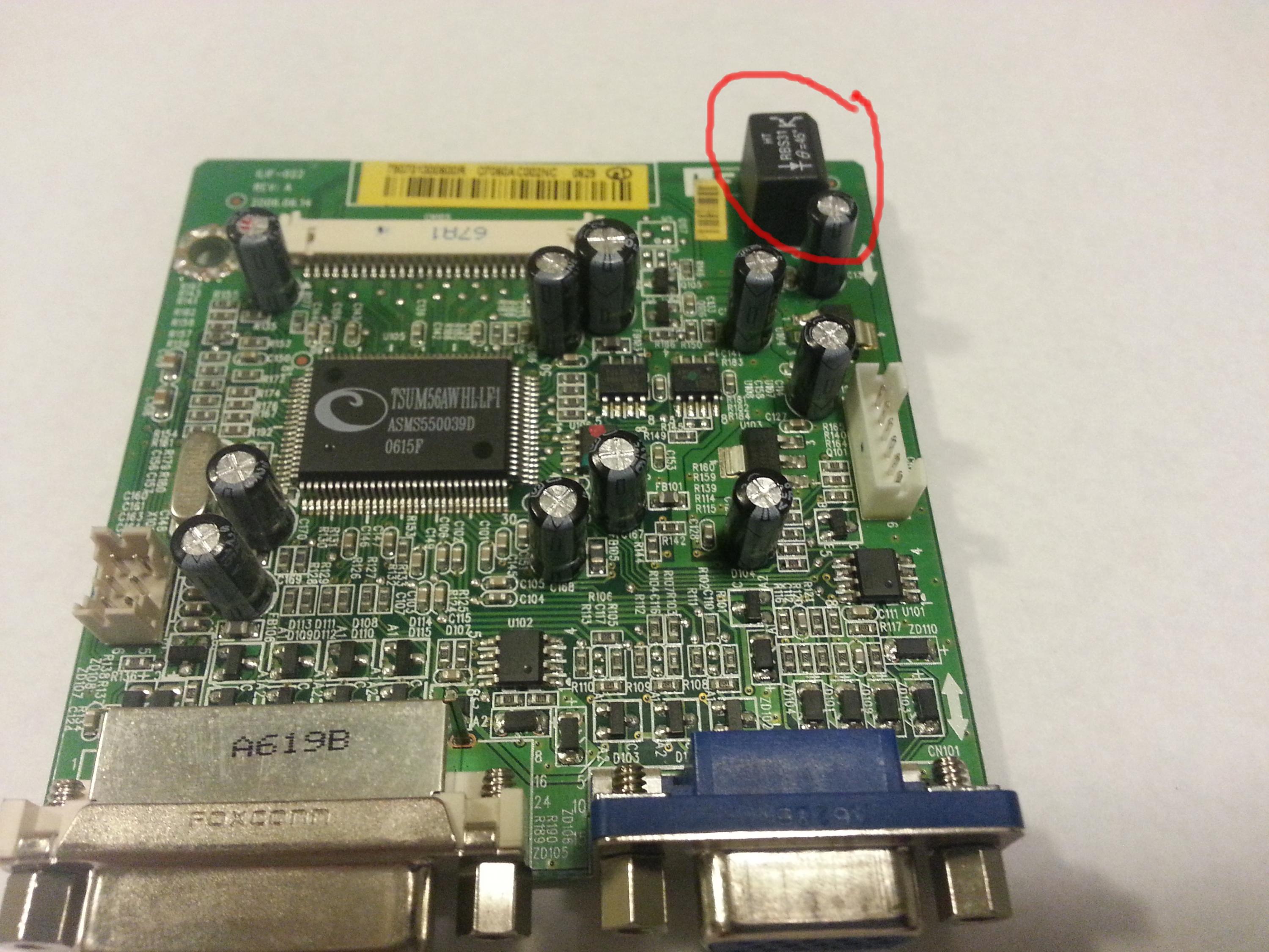

      Not sure what that is circled, but should it rattle? Also, the bottom side if it looks a bit fried. In fact so does the bottom of the capacitor a little higher up on the board.
        Re: 2 Seconds to Black - Gateway LE1936
        What Ohm scale are you using? Ohm, K Ohms, M Ohms?
        That part is for rotation sensing when you rotate the screen 90 Degree into portrait position. It has a little ball inside that block/unblock the optical sensor.

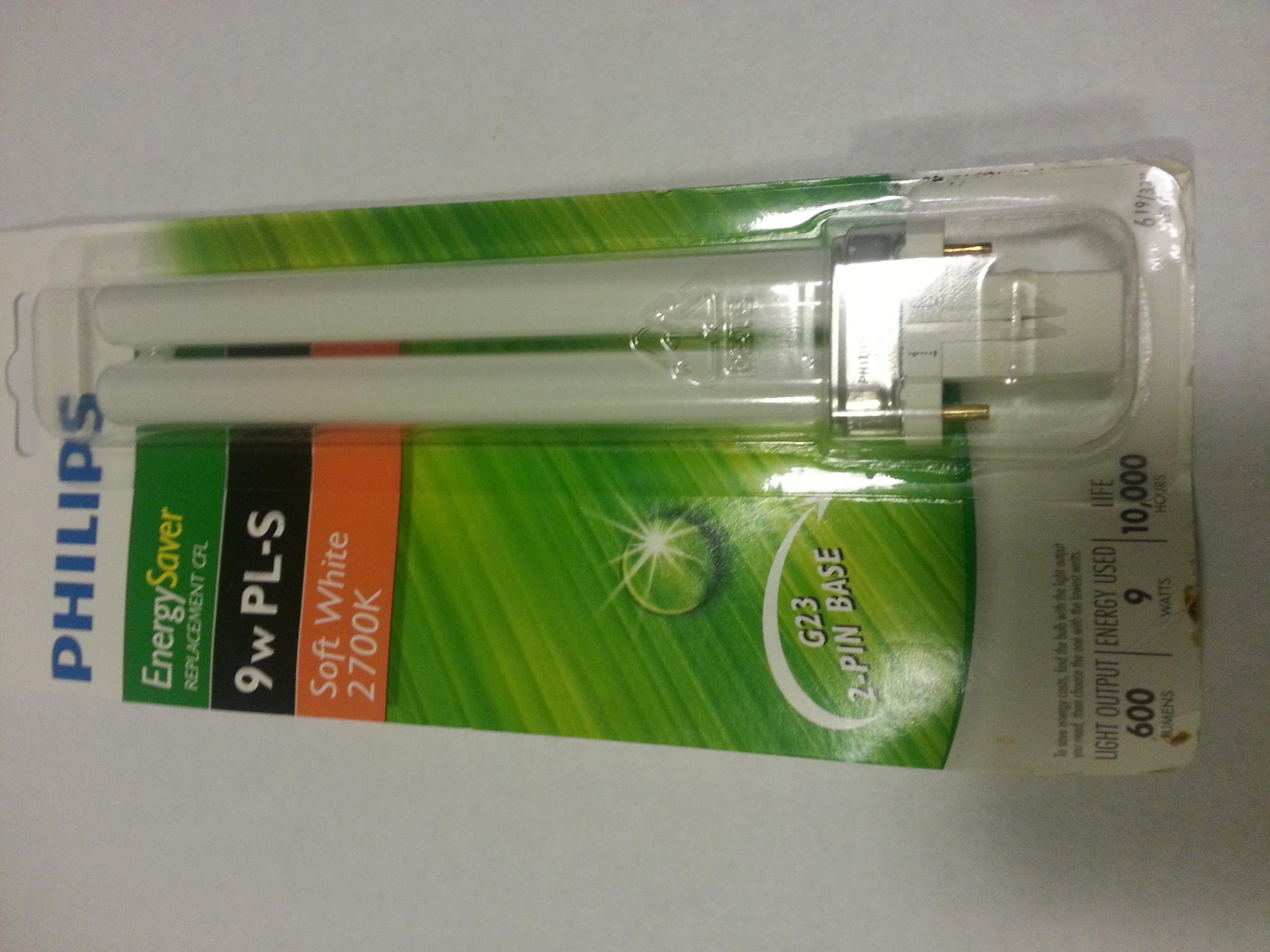

              Originally posted by budm
              You may want to make test lamps so you will not spend lots of time try to figure out if it is lamps or power supply-inverter board problem.
              Test lamps:
              https://www.badcaps.net/forum/showthread.php?t=19987
              http://s807.photobucket.com/albums/y...g%20old%20CFL/
              Would this work?

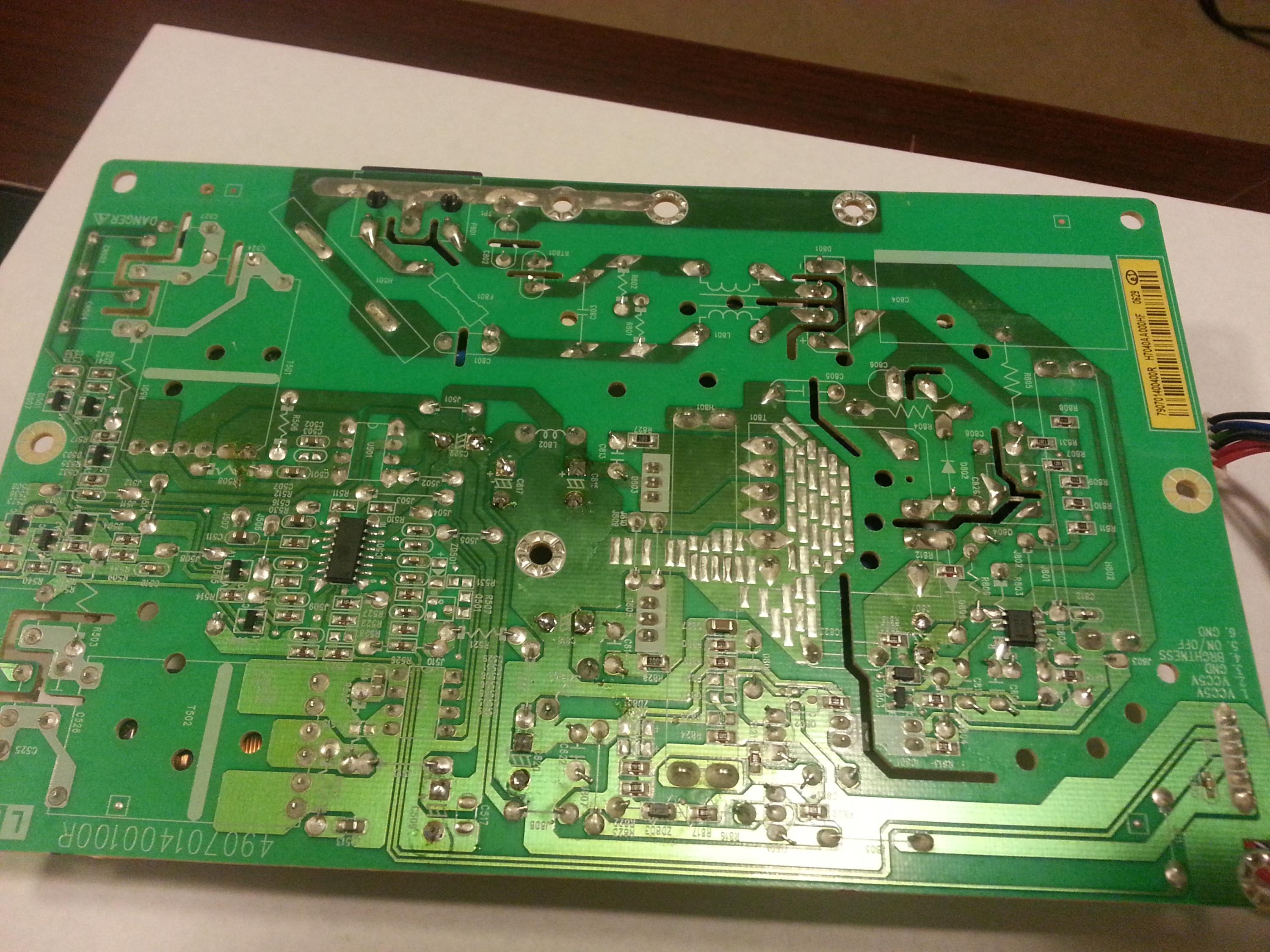

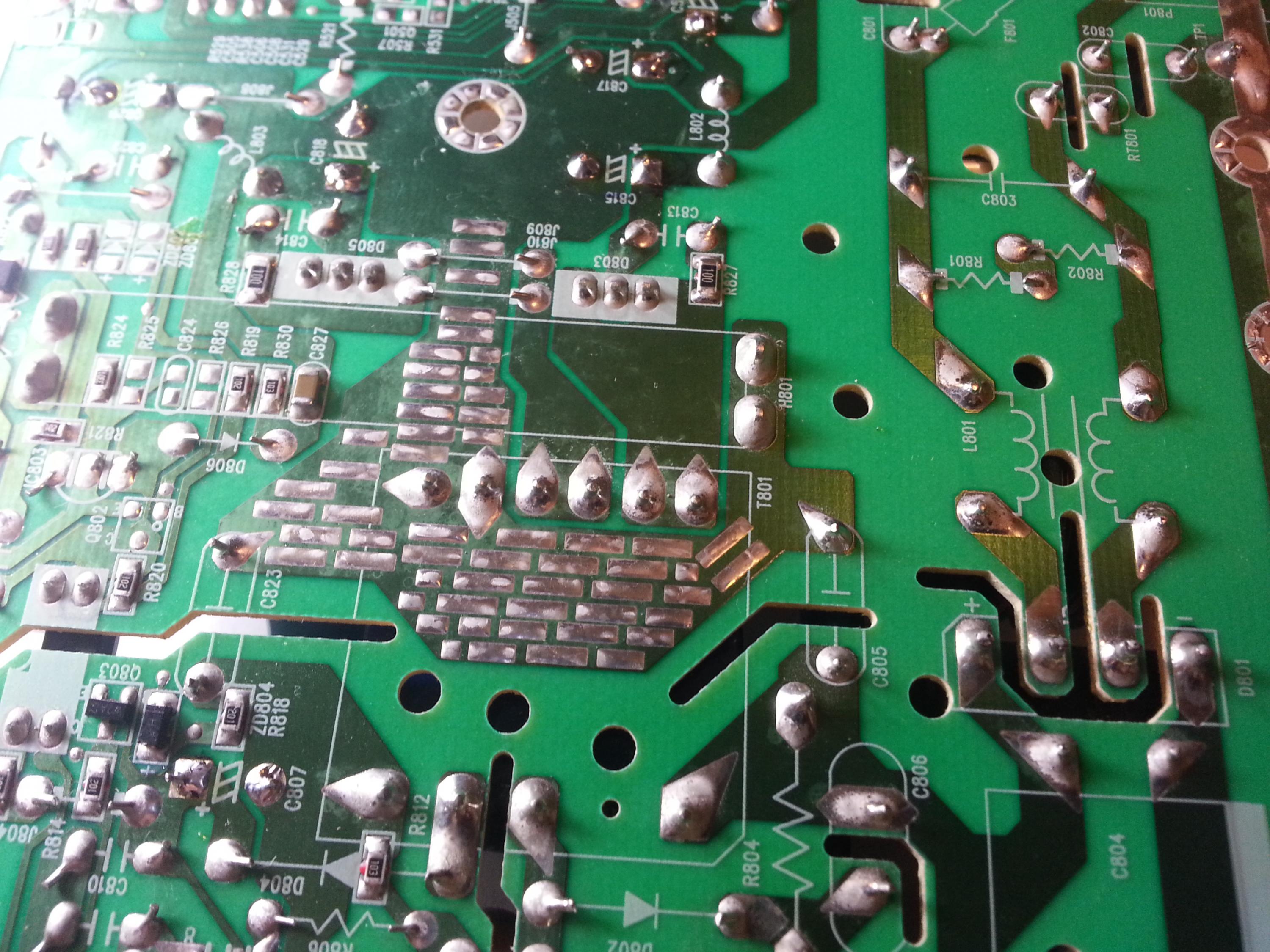

                Try that form factor lamp, it does not work. I tried many form of lamps, the two that worked so far are the one shown in my pictures.
                Can I see the good straight front shot of the power supply-inverter and also the bottom side?
                By the way, those two components on the logic board are Low Drop Out (LDO) voltage regulator ICs.
                Here is the thread on how to test them:
                https://www.badcaps.net/forum/showthread.php?t=22231

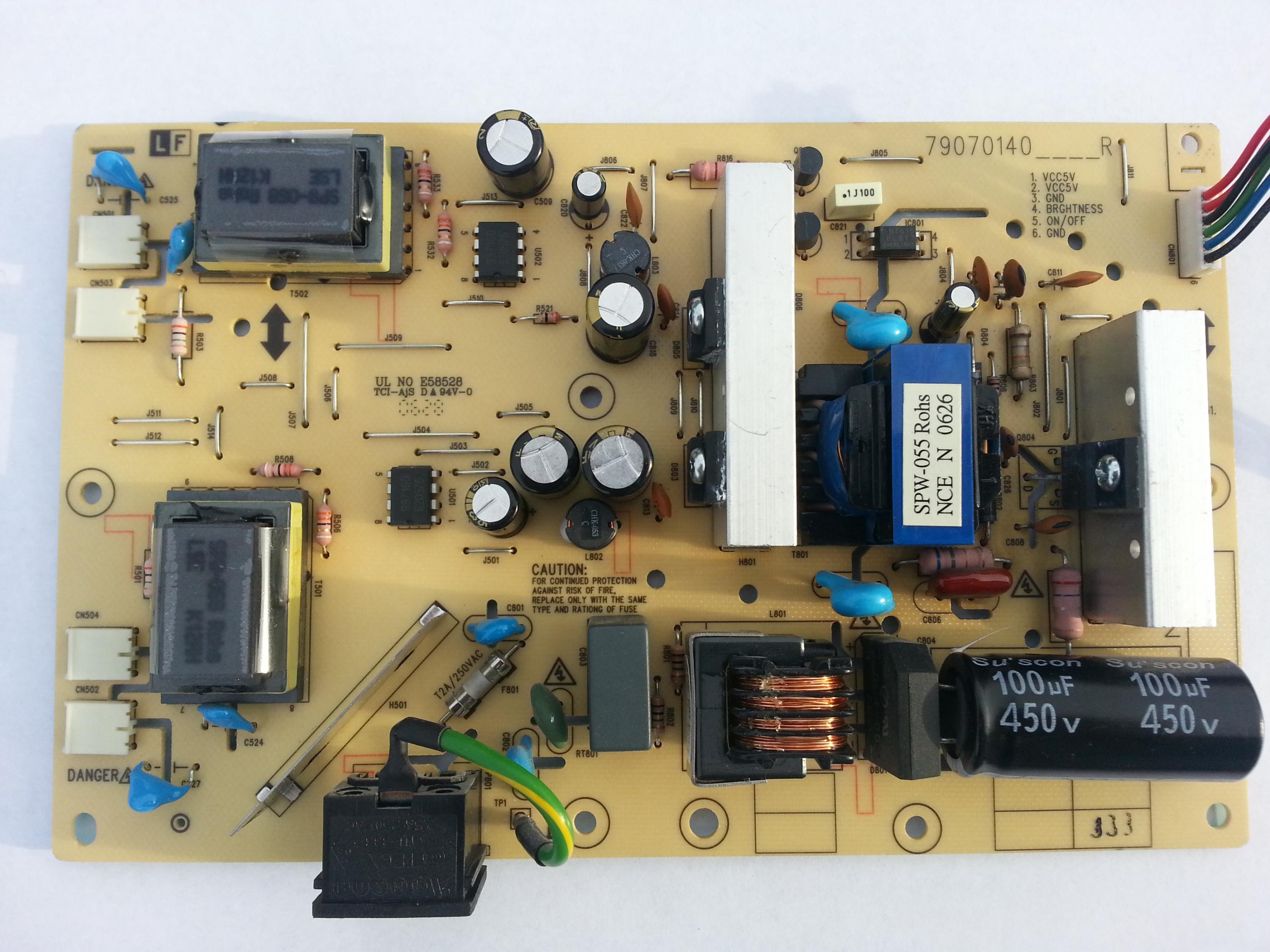

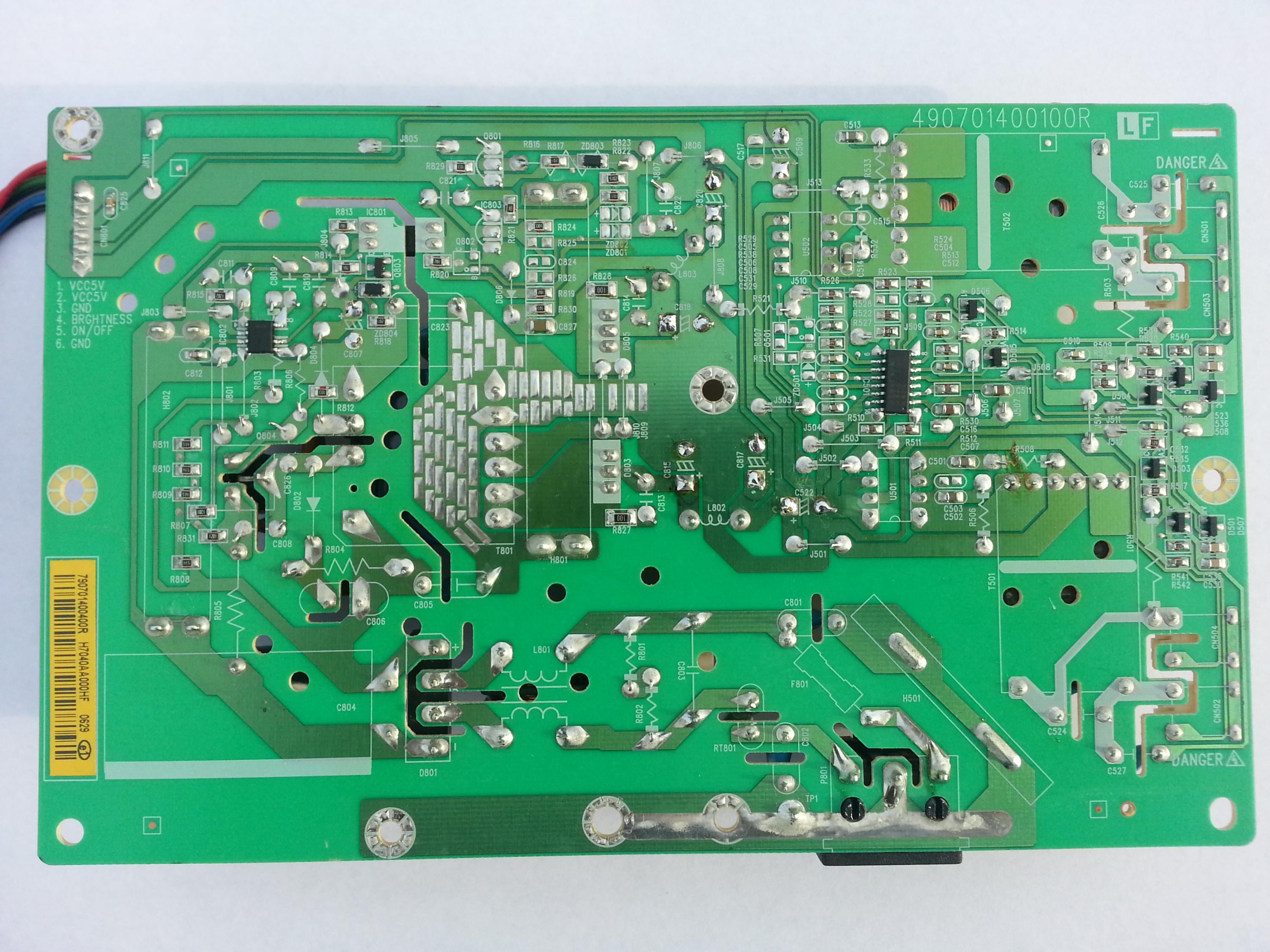

                  Attached are what I *think* is the power supply-inverted frond and bottom.
                  Thanks for all the help!
                    Top Voltage regulator from previous picture:
                    LD117A
                    L18ATC
                    {no 3rd line}
                    Pin 1 - 0
                    Pin 2 - 1.78
                    Pin 3 - 5.09
                    2nd Voltage regulator
                    A1
                    AS117L-33
                    B0512
                    Pin 1 - 0
                    Pin 2 - 3.25
                    Pin 3 - 5.09
                    • tpearsall

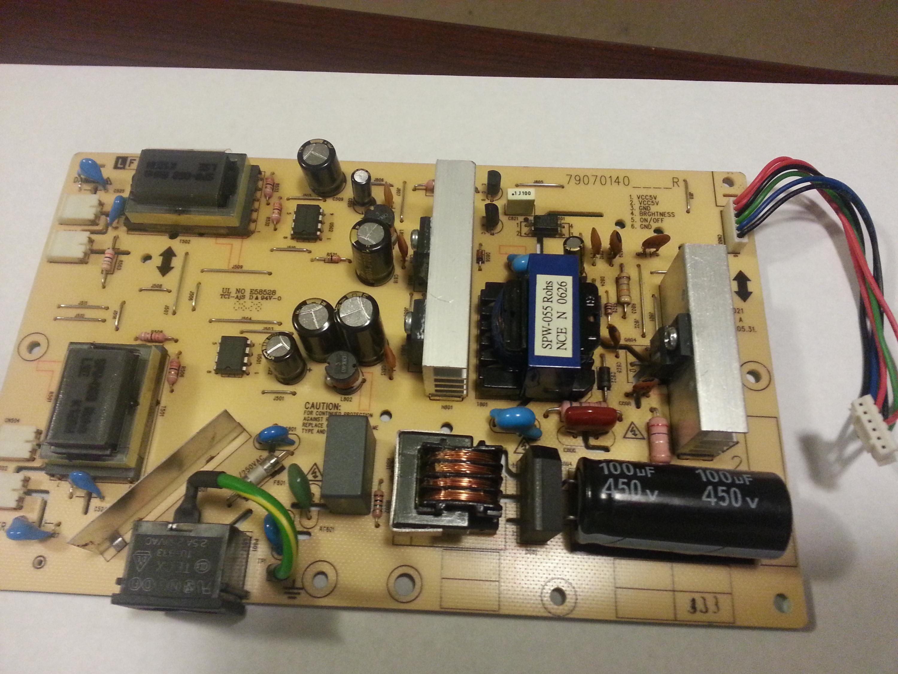

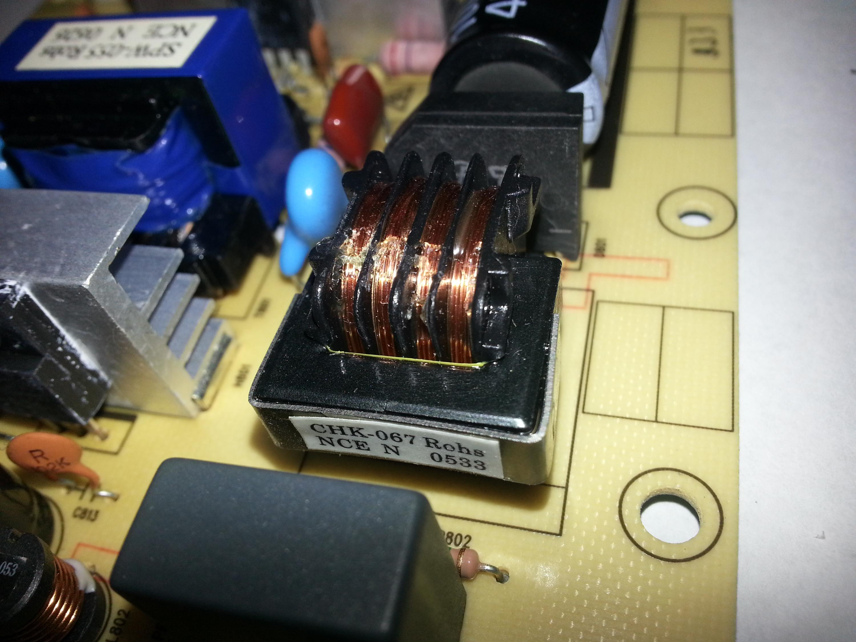

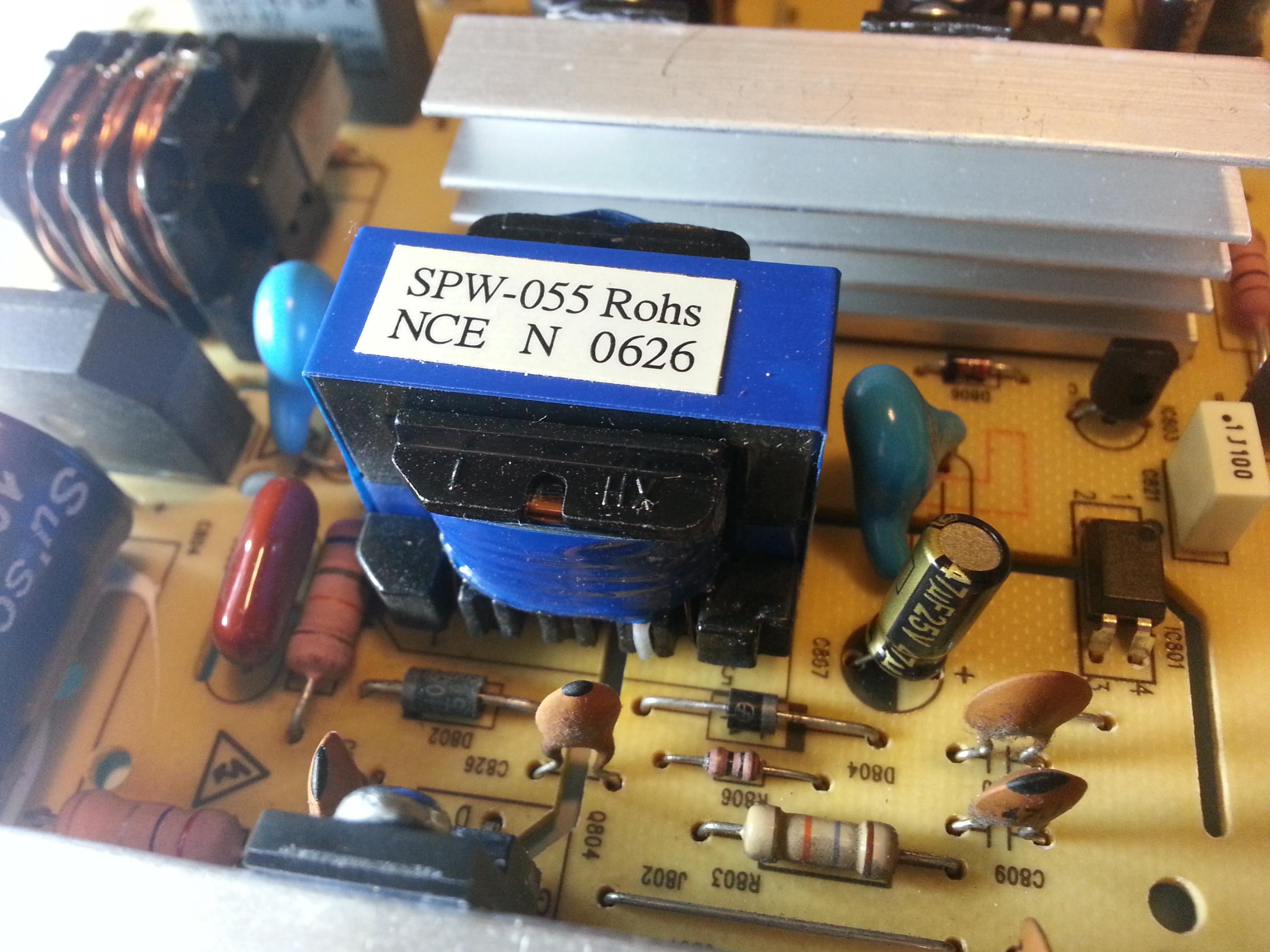

                      I think this is the transformer, but in case I am wrong and it's the power supply inverter...
                        In post1 you have the pictures of the power supply/inverter board kind of side way, not straight shot. I need to be able to see the whole (both sides) so I can trace out the connections on the board.
                        The inverter high voltage transformers are close to where the lamps are plugged into.
                        The regulators on the main board are OK. You do not have the main board problem, the problem is either the inverter circuits or the lamp problem. The replacement caps you use for the power supply are low ESR type?

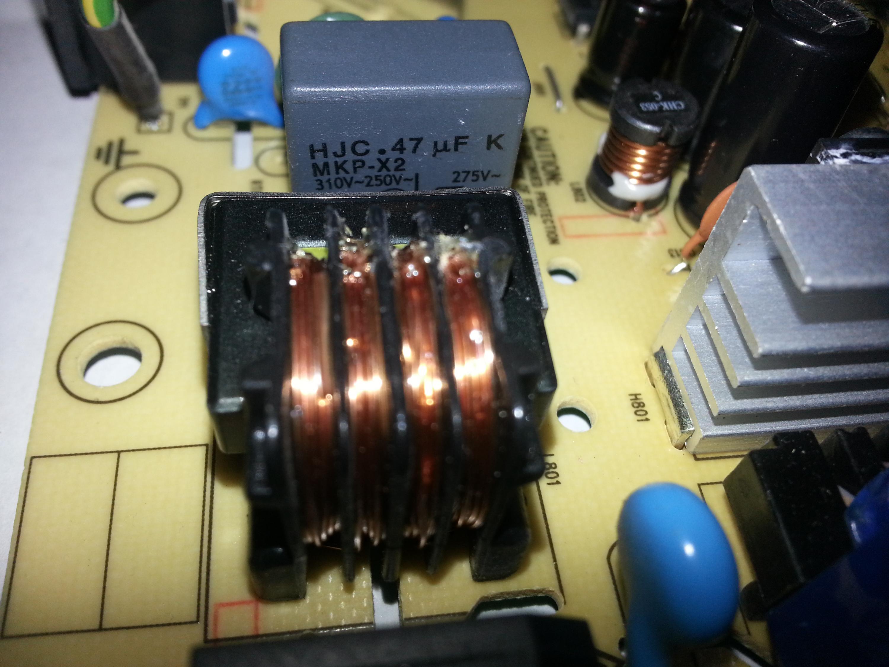

                              These should be better. The 3rd image is a close up of a mark near one of the transformers.
                              Thanks!

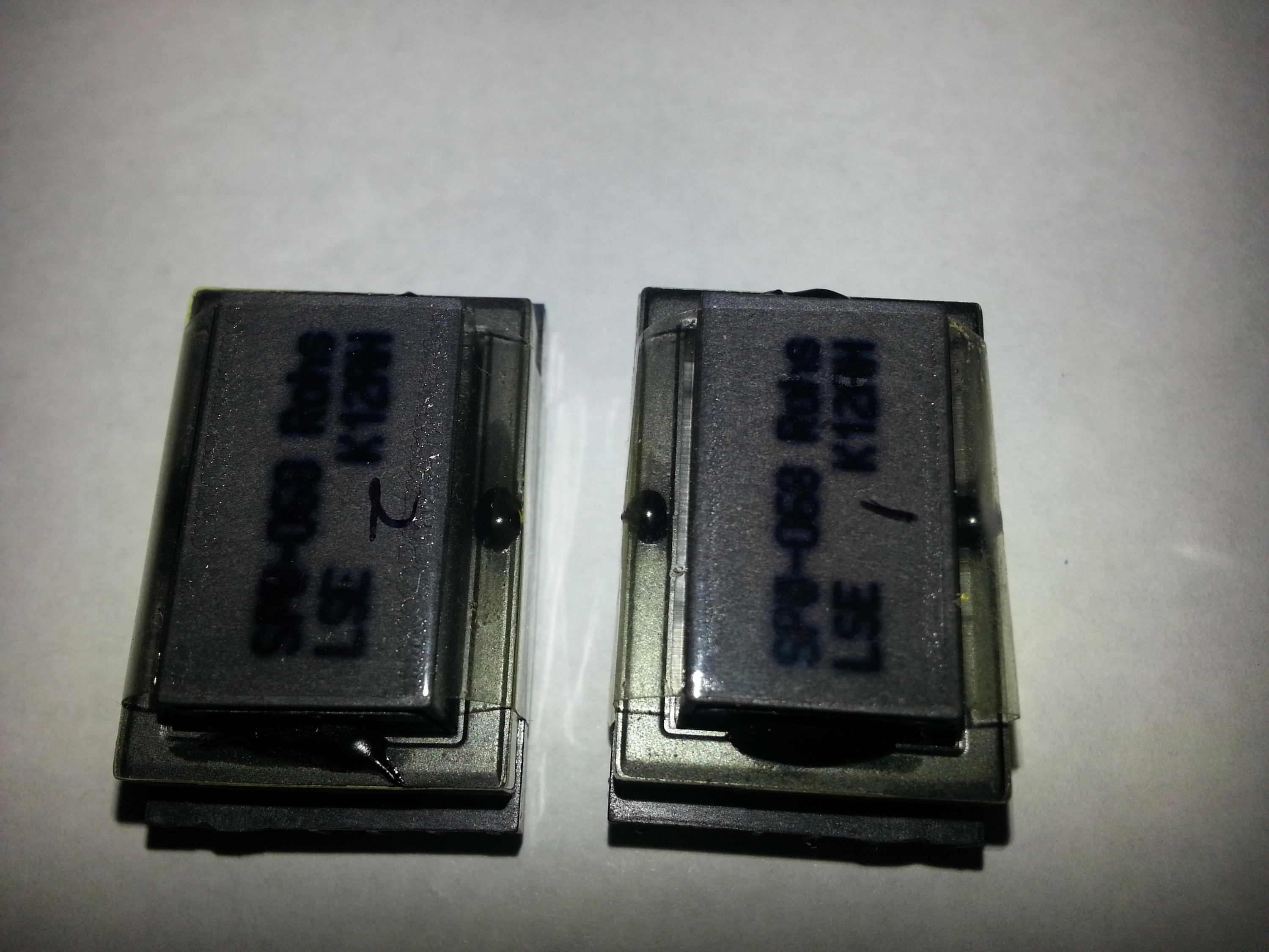

                              • tpearsall
                                • Nov 2012
                                • 25

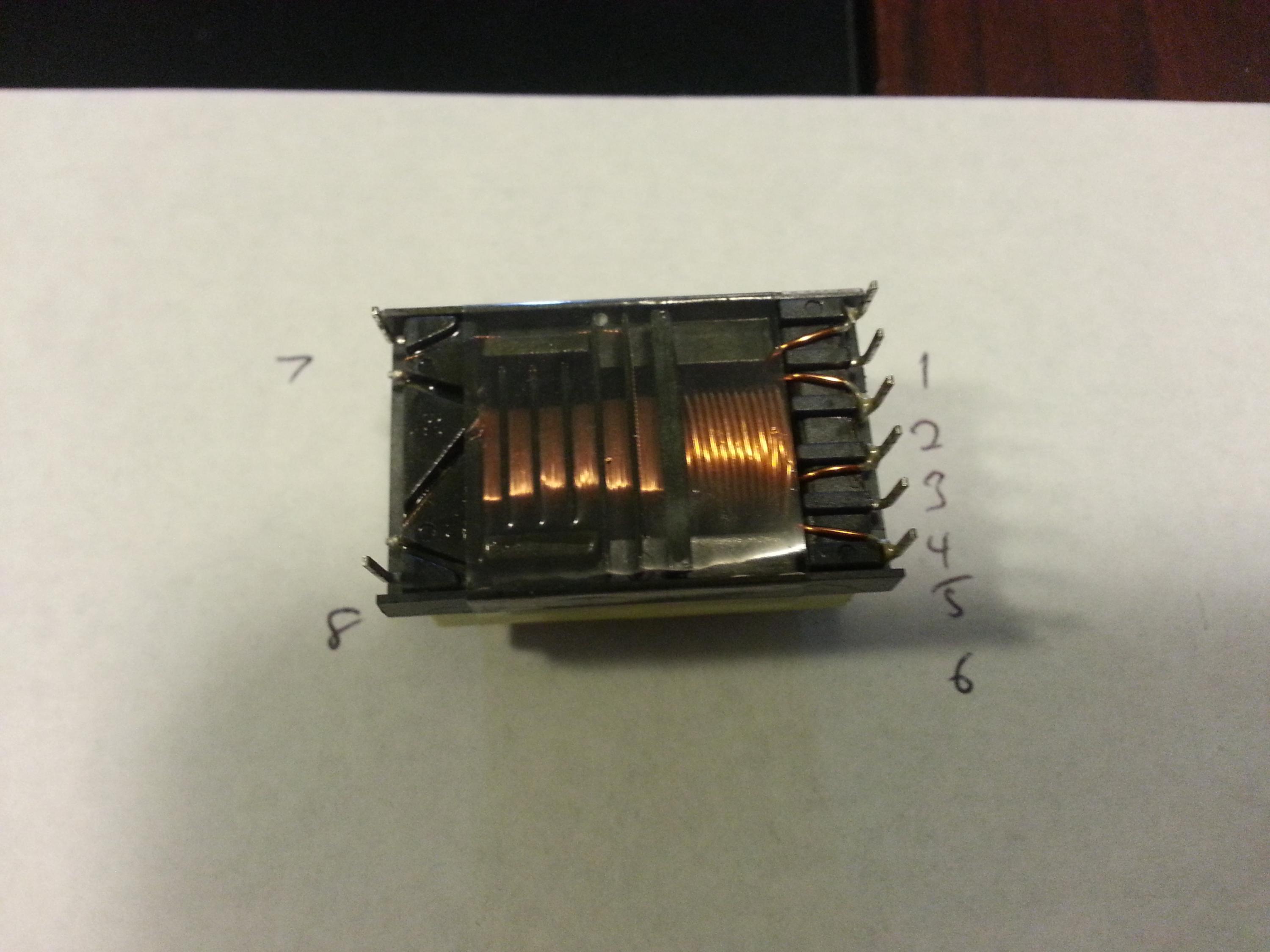

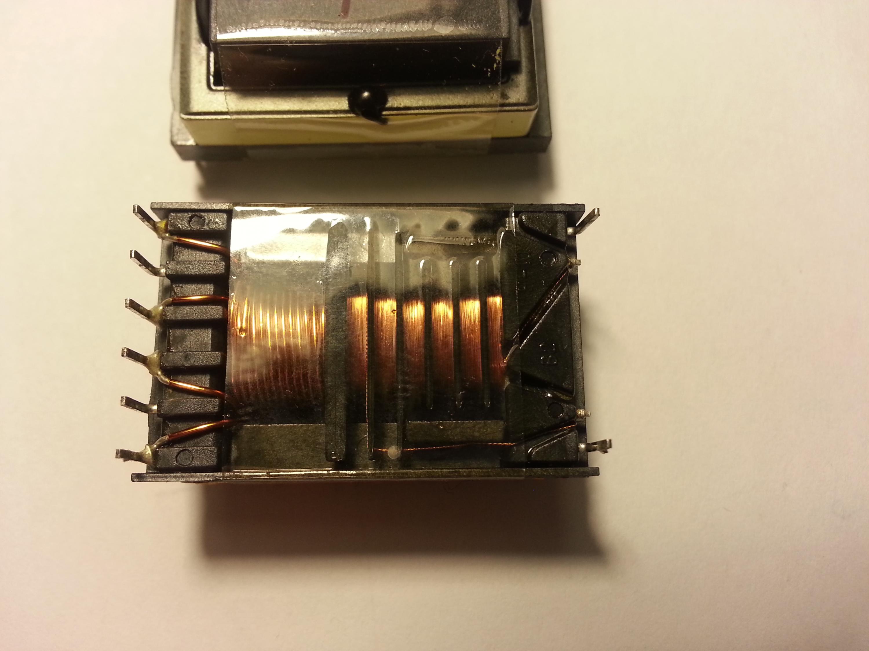

                                I would check the transformer high voltage winding resistance.
                                I desoldered the transformers and they bot tested as follows;
                                T501
                                1 to 5: .5ohms
                                3 to 6: .5ohms
                                7 to 8: 679ohms
                                Rest were open
                                T502
                                1 to 5: .5ohms
                                3 to 6: .5ohms
                                7 to 8: 623ohms
                                Rest were open
                                Are one or both bad since the difference is > 3%
                                Thanks,
                                Todd
                                • tpearsall
                                  • Nov 2012
                                  • 25

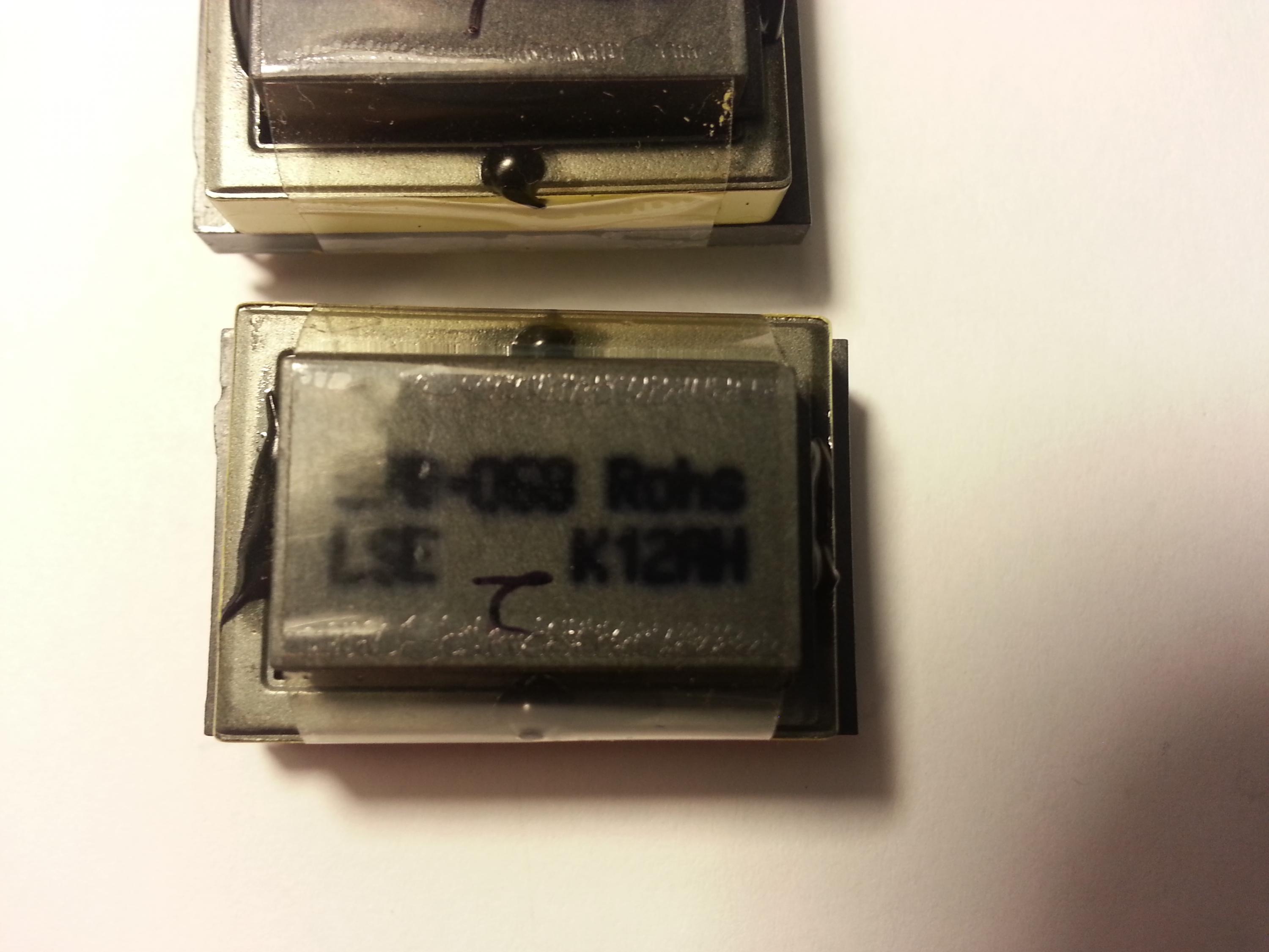

                                  T501
                                  1 to 5: .5ohms
                                  3 to 6: .5ohms
                                  7 to 8: 679ohms
                                  Rest were open
                                  T502
                                  1 to 5: .5ohms
                                  3 to 6: .5ohms
                                  7 to 8: 623ohms
                                  Rest were open
                                  Are one or both bad since the difference is > 3%.

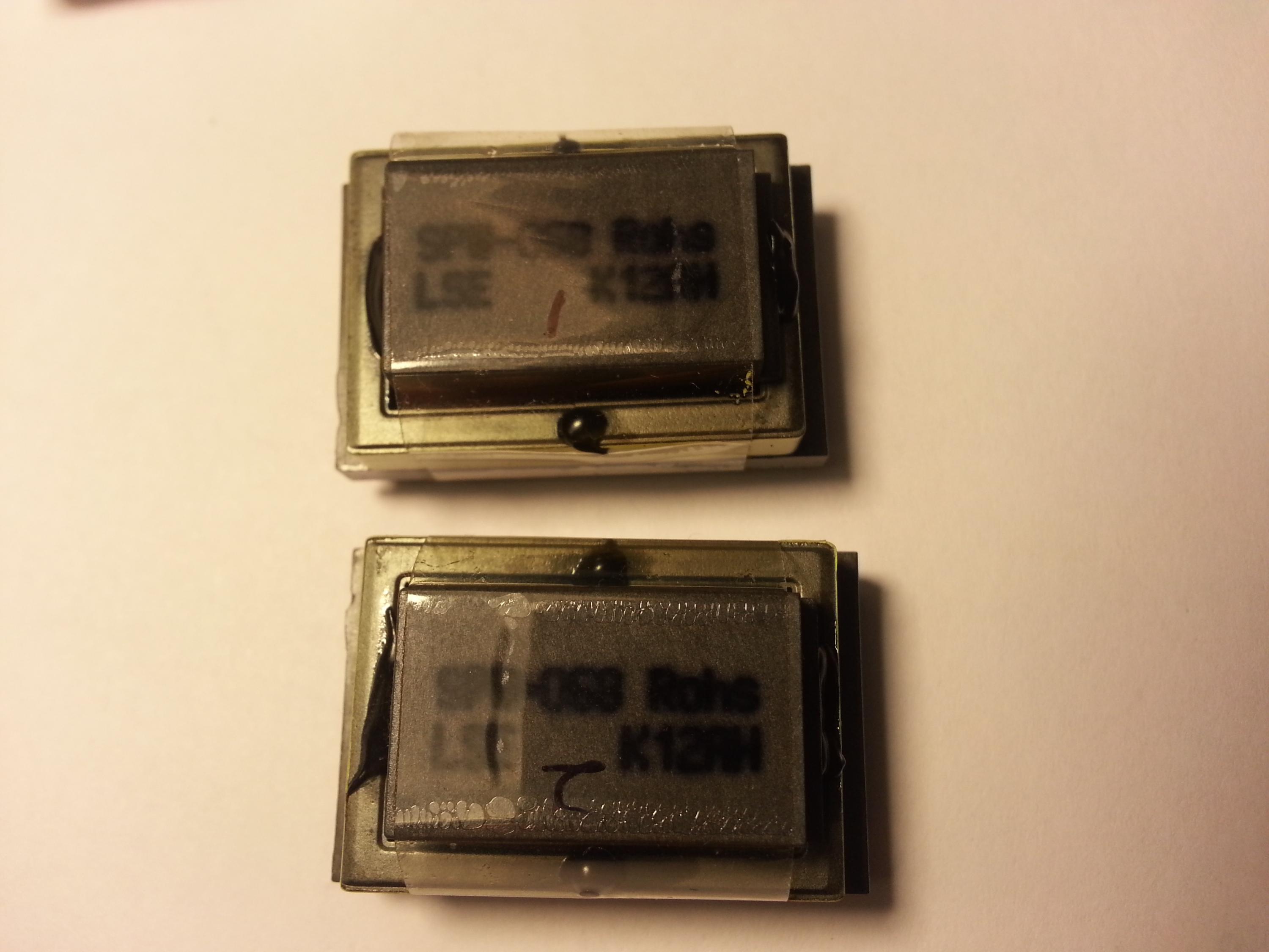

                                  I'm been searching and can't find this transformer and don't know how to determine an equivalent.
                                  It's a bit blurred, but the tops appear to say:
                                  SP?-068 Rohs
                                  LSE K12AH
                                  Any ideas?
                                  Thanks.
                                    That is quite big difference between the two transformer. I would do the lamp test next.
                                    Can you take the pictures of the transformer where the P/N is?

                                      • tpearsall
                                        • Nov 2012
                                        • 25
                                        I had a tough time getting a decent picture.
                                        Shoot! I only tested one lamp port port and it went on for the same 2 seconds and off as the display. After a closer read of the test instructions I should have tried it in each location. Should I solder the transformers back in and use the test lamp in place of each CCFL?
                                        Thanks!
