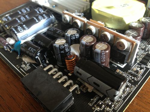

            "I only replaced the green taicon capacitors" what did you replace them with

              Hey!
              I can't remember the manufacturer but tonight I will have some time to put the new PSU-card in there and then I will be able to look it up!
              Stay tuned.

                Re: Apple Cinema Display 27" No TBolt - Buzzing and then dead
                Hello again fine users of this forum.
                I have now ended the weirdly long saga of "the buzzzing LED cinema display". I think. It has so far lasted almost a year.
                I got my new PSU last week and popped it in there. So far, everything works FINE! And I am so happy I am dancing on tables everywhere I go. It is silent and it is bright and beautiful.
                NOW, this doesn't mean that it is guaranteed to stay that way but I am crossing my fingers.
                About your question, selldoor, the caps that I replaced the old Taicon caps with are: KSC coloured black and YAGEO coloured brown. Below I have attached two photos of the new caps and also a photo of the orange film caps that made the buzzing sound.
                How come you ask about the new caps? You have a theory perhaps. I would be happy to hear it!
                Thanks, Jakob
                  Well I was hoping you were going to say Panasonic Nichicon or Rubicon or UCC with low esr and high ripple. The caps you have used are not usually recommended for this type of application.
                  I do not fully understand it but I believe that caps that can handle a higher ripple current
                  allow less AC through - it could be the AC that is causing the buzz. There are many posts regarding this.

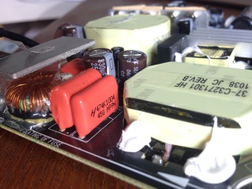

                          #52
                          Hey guys,
                          It looks like Apple kept a good thing going (not) and continued to use the same power supply in the Thunderbolt 27". I'm trying to repair mine now -- have the infamous no backlight, but I can see the digital image on the panel using a flash light.
                          I suspect it's this black part on the board that's faulty, but I am having trouble identifying what it is. Any ideas? I've been scouring the web for answers, and you guys seem to be the most knowledgeable, so I appreciate any assistance!
                          http://bubbaj2k2.imgur.com/all/

                            #53
                            Follow Up: I was able to find this Chinese document from a part supplier for Lite-On, for what I appears to be the power supply:
                            http://wenku.baidu.com/view/a491f5370b4c2e3f5727638a
                            I looked up the part number, 37-C3271301-HF, and found this description:
                            PFC CHOKE A3271-3A DS4014 JPP44A
                            I checked Digi-Key and ebay for PFC Choke, but haven't found much. Does this make any sense to anyone?
                                My Apple Cinema Display 27" No TBolt display completely died a few days ago. For the months leading up to its demise, a buzzing sound emanated from the inside of the monitor.
                                Thinking this buzzing was caused by bad electrolytic caps, I just swapped out all of the Taicon electrolytic caps with Rubycon, Panasonic, and Nichion caps. The board was successfully brought back to life , and it even stopped buzzing for about an hour, but then it started buzzing again.
                                I'm sourcing replacement film capacitors now.
                                Any ideas on how to quell the buzzing if the film capacitors are not the culprit? Could it be the transformer?
