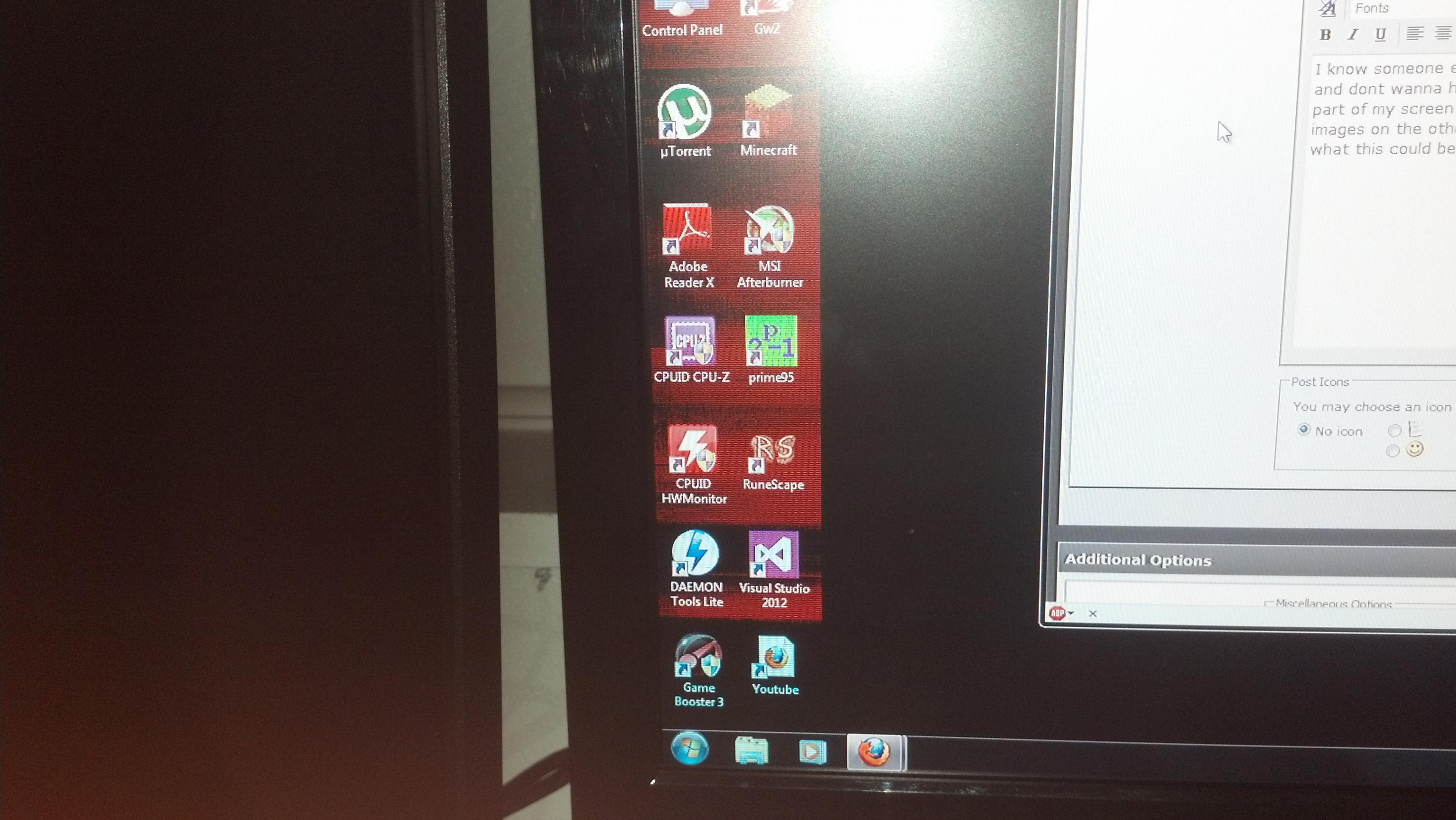

    I know someone else has a thread about this model but I have a different issue and dont wanna highjack someone elses thread. Im having this issue where a part of my screen is showing this red strait lines, which move when I display images on the other side of the screen. I was wondering if anyone knew what this could be. I dont know where to start...
    oh ya this is a westinghouse l2410nm montior. sorry forgot to add that

    That looks like a graphics card rather than a monitor issue. Have you tried it on a different computer, or a different monitor on that computer?
    A working TV? How boring!
      Re: L2410Nm color issues
      bad video card.
        Its not the graphics card. I've hooked it up to my other 2 monitors and my other montiors dont show the issue. I even hooked my laptop to l2410nm and it shows the same red color graphical glitch. the monitor dose it to whatever its hooked up to. and no matter what input. I have a duel graphics set up. I've tried both cards. and when i hooked up one of my 3 monitors. besides the westinghouse one. the color is perfect. Whats strange is that is only a certain sector of the screen.

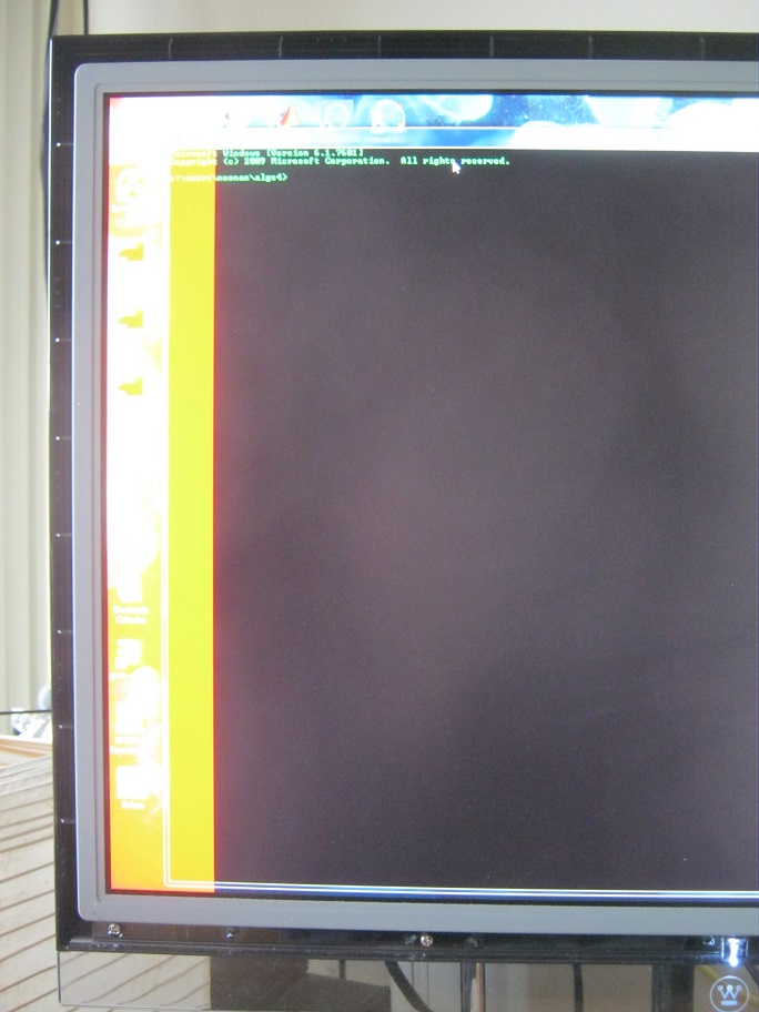

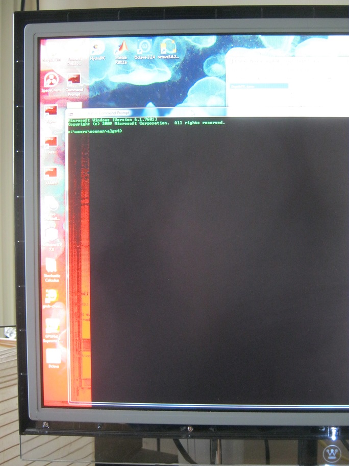

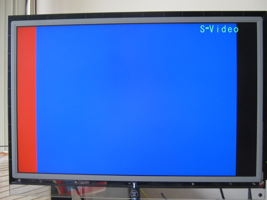

          I seem to have the same problem with the same type of monitor, Westinghouse L2410NM. There is a vertical band on the left of the screen that flickers. Depending on the current color/image on the monitor it might be solid teal (as in the picture) or red (when a dark image like a dark movie scene is displayed). The same thing happens with the xbox which is plugged into a different port. Seems to change a little bit when I tap the monitor.

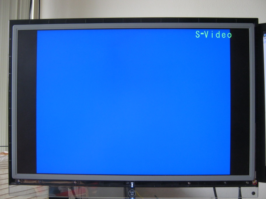

          The boundary of the defect seems to line up with the default image displayed on the "Video" and "S-Video" displays as in the second image.
          I don't see any bad caps on the boards. The monitor seems to work as normal in every other respect.

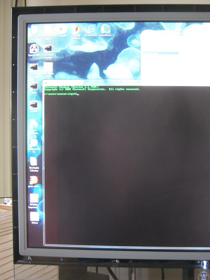

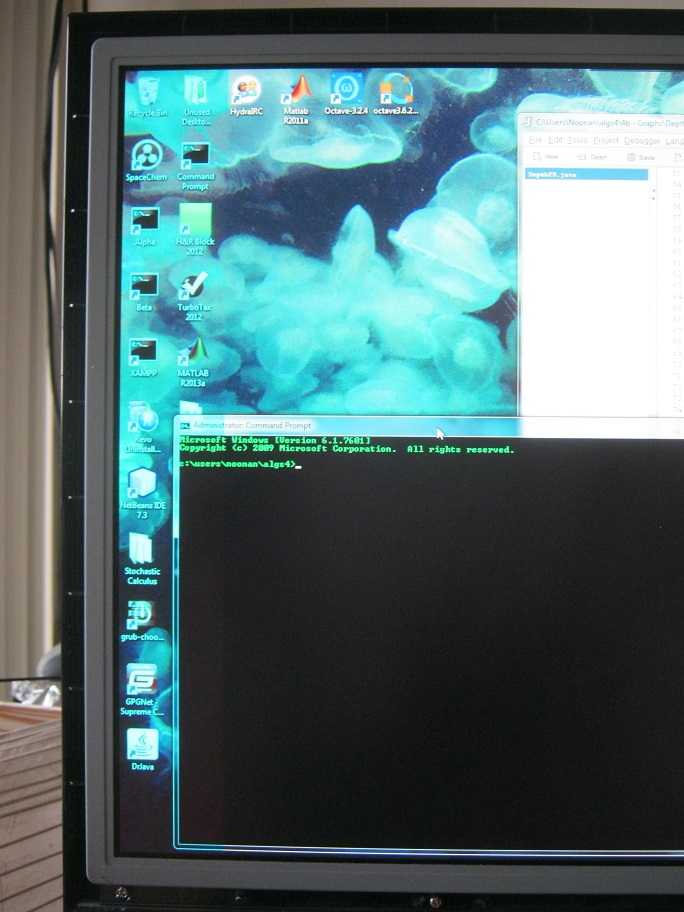

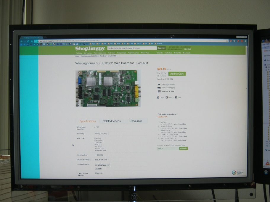

              So, the bad area of the screen changes from teal to red depending on how bright the rest of the screen is. If you look at the pictures, as I raise the black window up the screen the problem with the band on the left changes.
              I replaced the main logic board, and the problem remains. (I HATE it when I do not find root causes to problems and just replace parts. HATE it!! I guess cause it just reinforces my stupidity.) The other things that I figure can fail in the this monitor are the power supply, "inverter" board (I think that provides the back lights) and the screen itself. I guess the power supply could be going, or is it the screen itself?

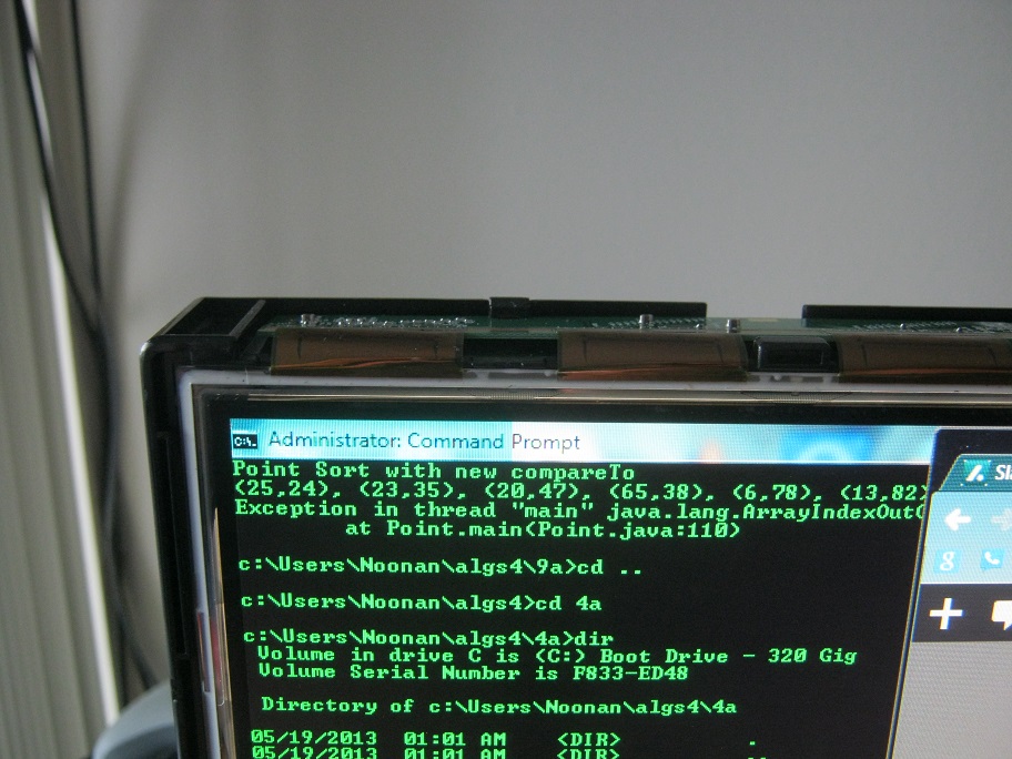

                I'd suspect the screen itself in this case. Time to tear it down and try pressing on the tab bonds on that side to see if the issue goes away.

                  I suspect you're right. i removed the metal case around the screen and see that there are flexible circuits going to the screen. there must be a problem with the connection of the one on the far left. i wiggle it and the error bar on the left changes. it doesn't turn red now, but it still stays teal, which is far less distracting.
                  looks like i should start looking for a new monitor. too bad. i like this one.
