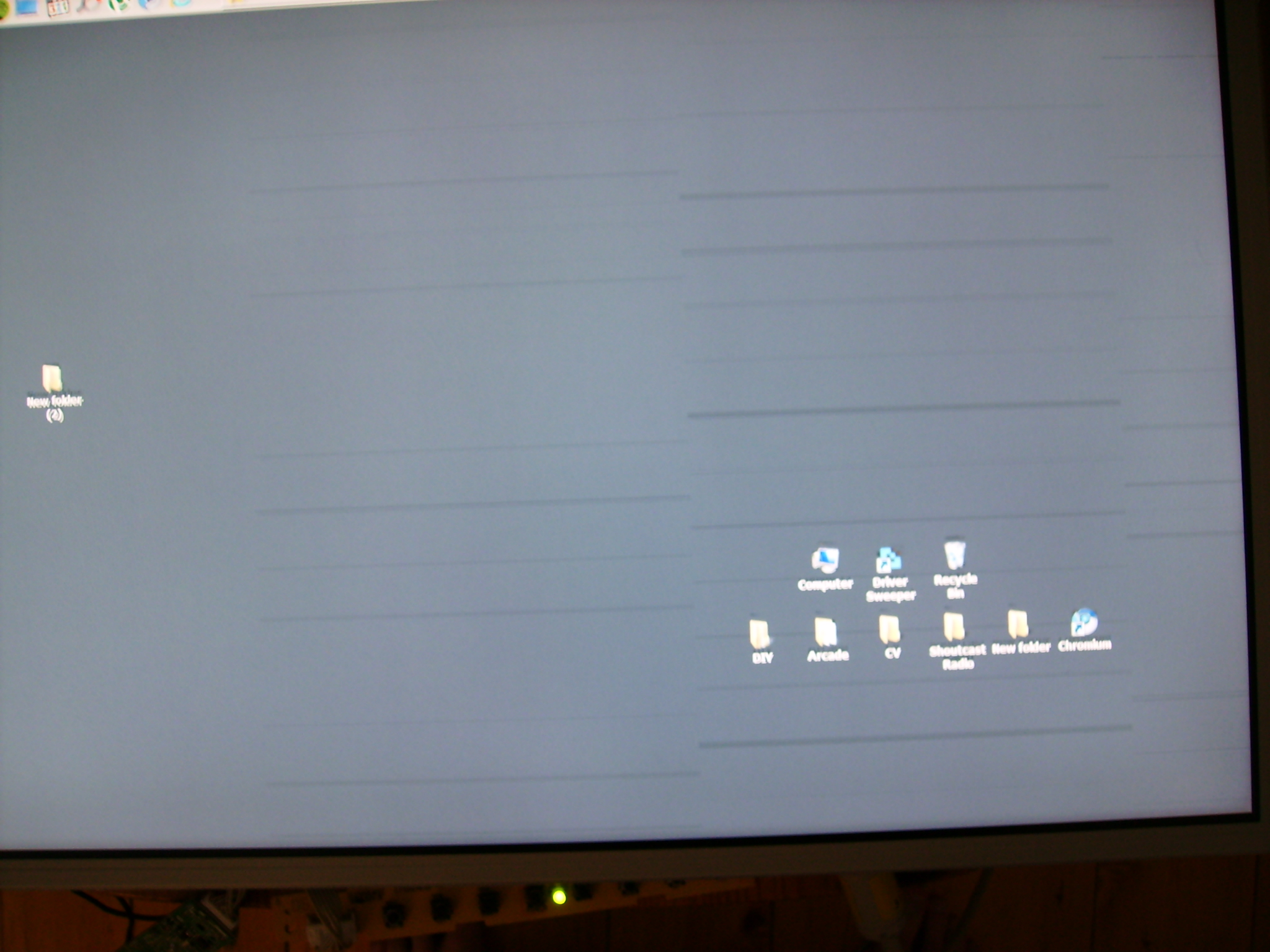

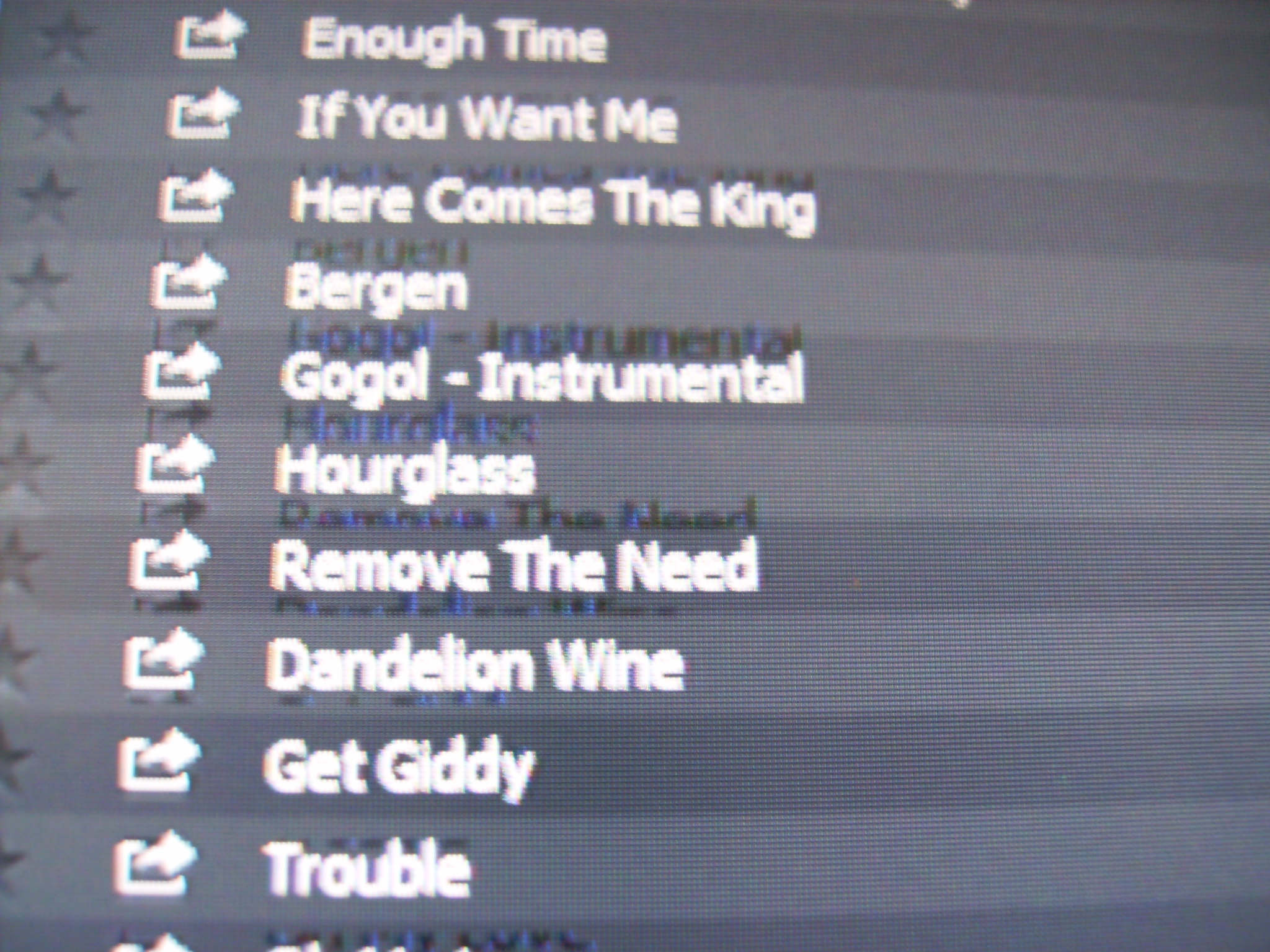

    Philips 200WP7ES - Horizontal lines/ghosting
    Flickering horizontal lines across the screen in different sizes.
    I dont see them in normal webbrowsing. Bad eyes.
    But they are there when I minimize the windows and they slight fades away.
    Right now they appears in a column, middle of the screen. Before all over the screen. Appears very clear in dark/grey areas/background.
    And have some ghosting/dublicate text effect.
    Unplugged/inserted the cables. may have dont some improvement?
    More testing....

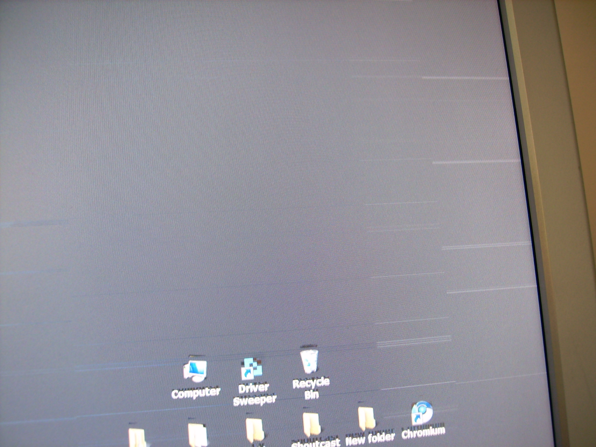

    Re: Philips 200WP7ES - Horizontal lines/ghosting
    Its heat related. The screen working perfect on startup.
    Cause its colder today the defect disappears faster than yesterday.
    The camera is to slow to catch it.

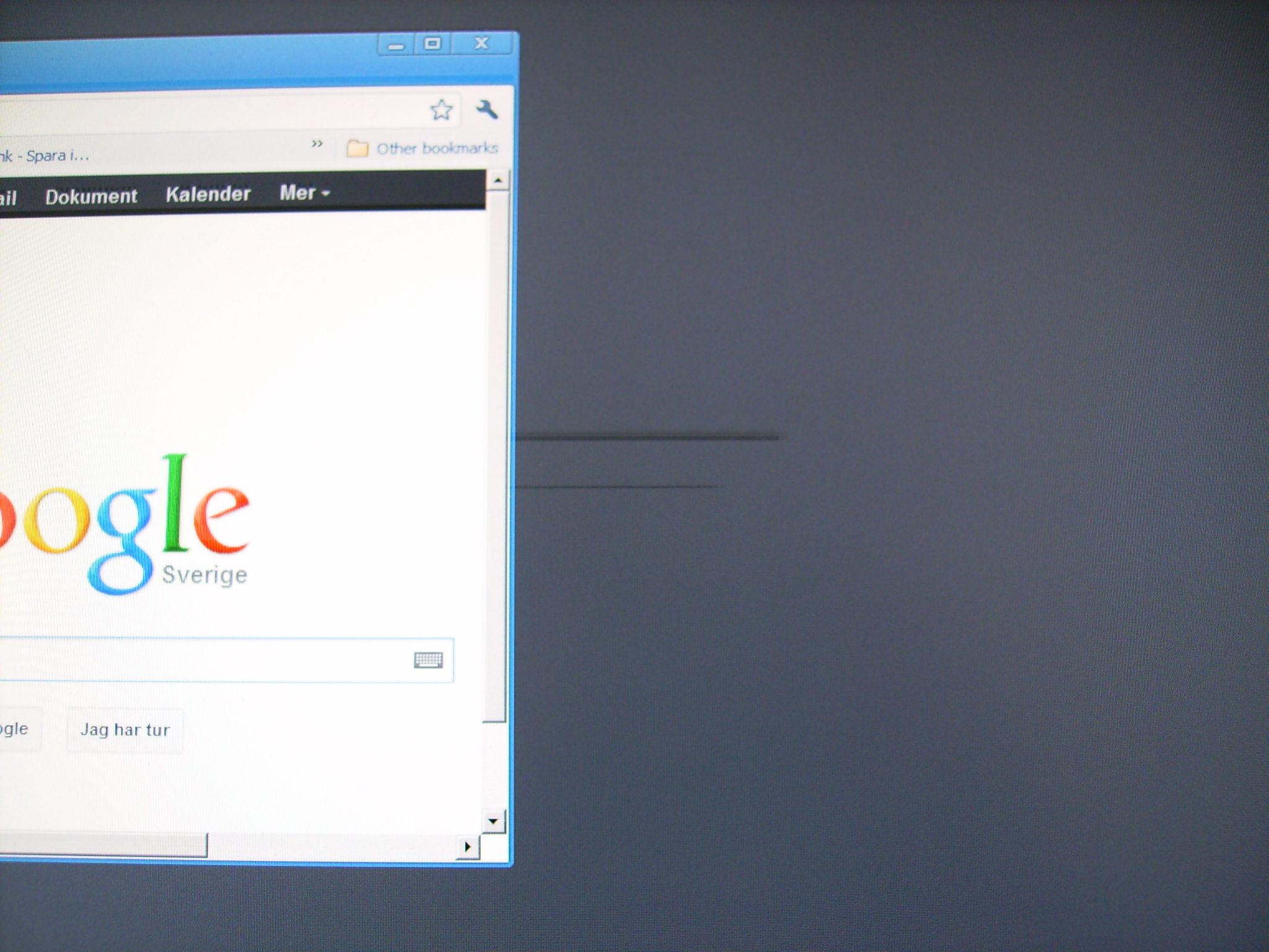

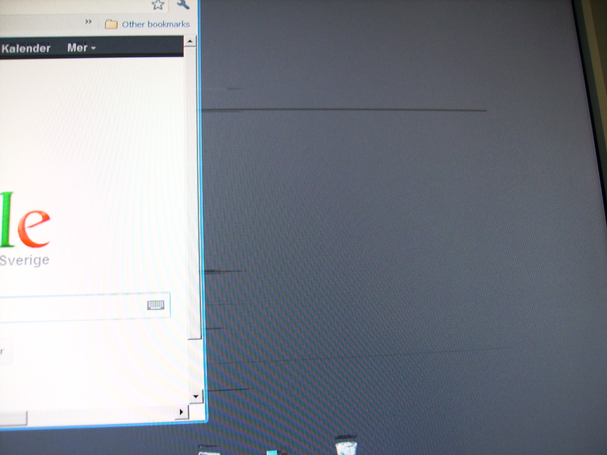

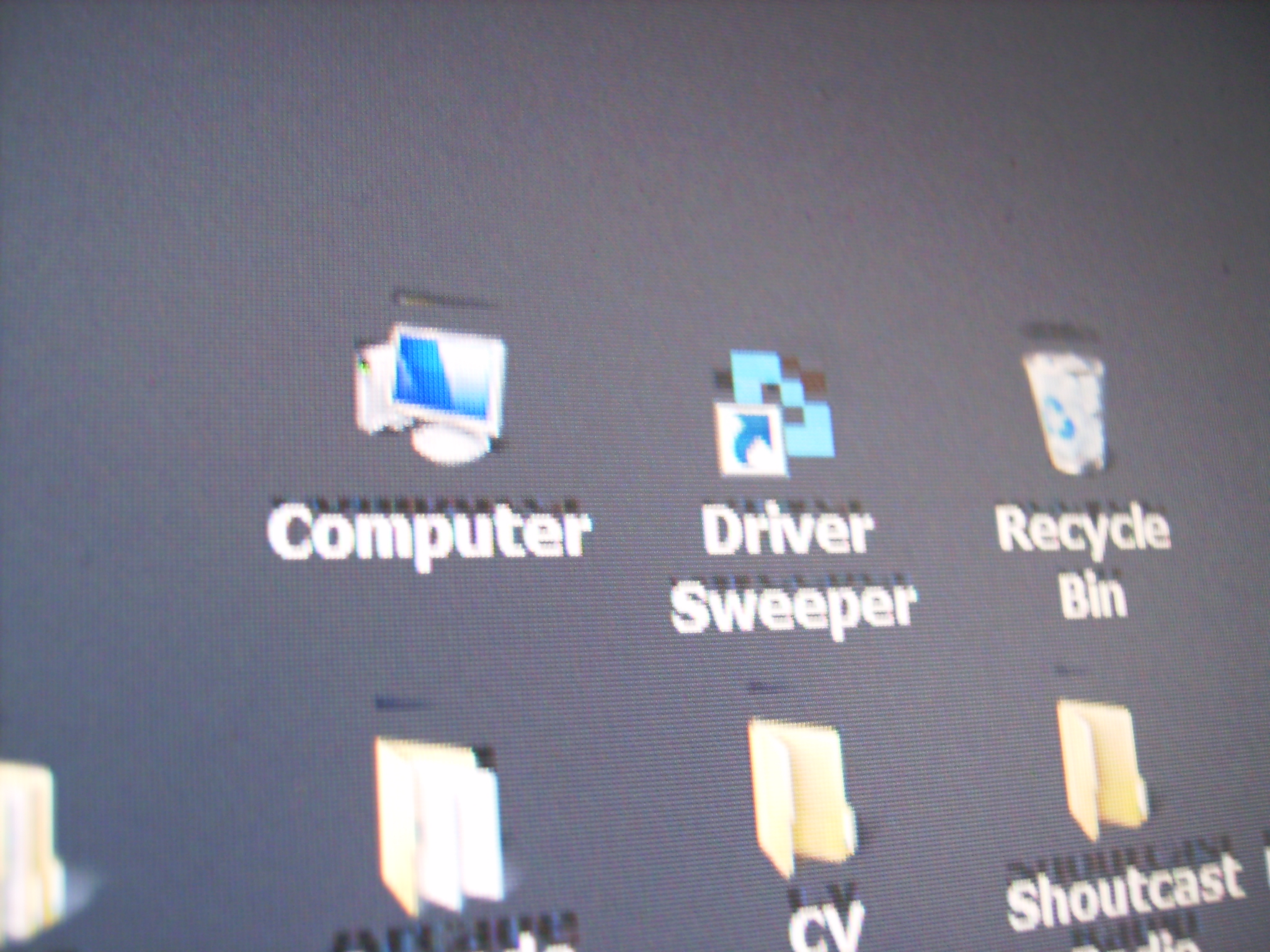

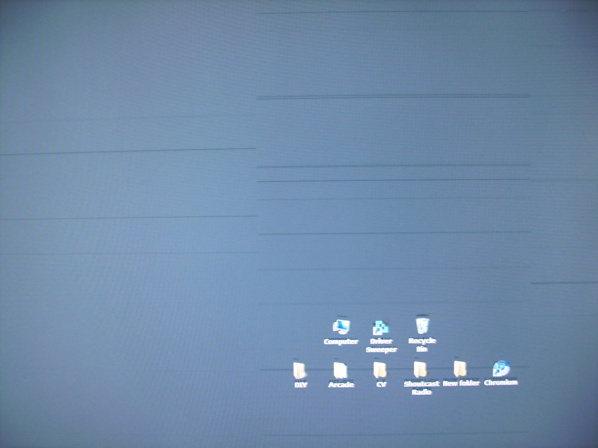

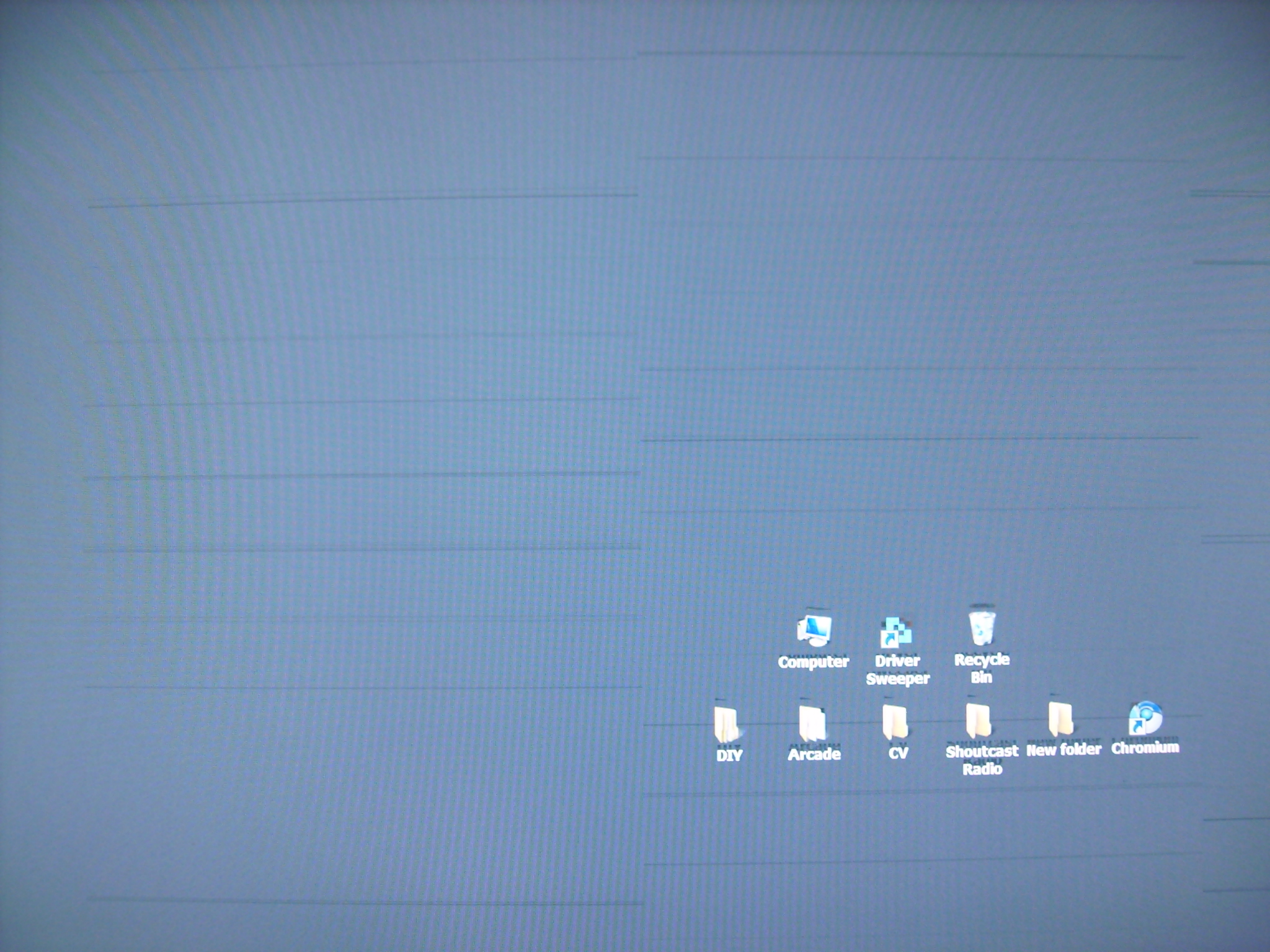

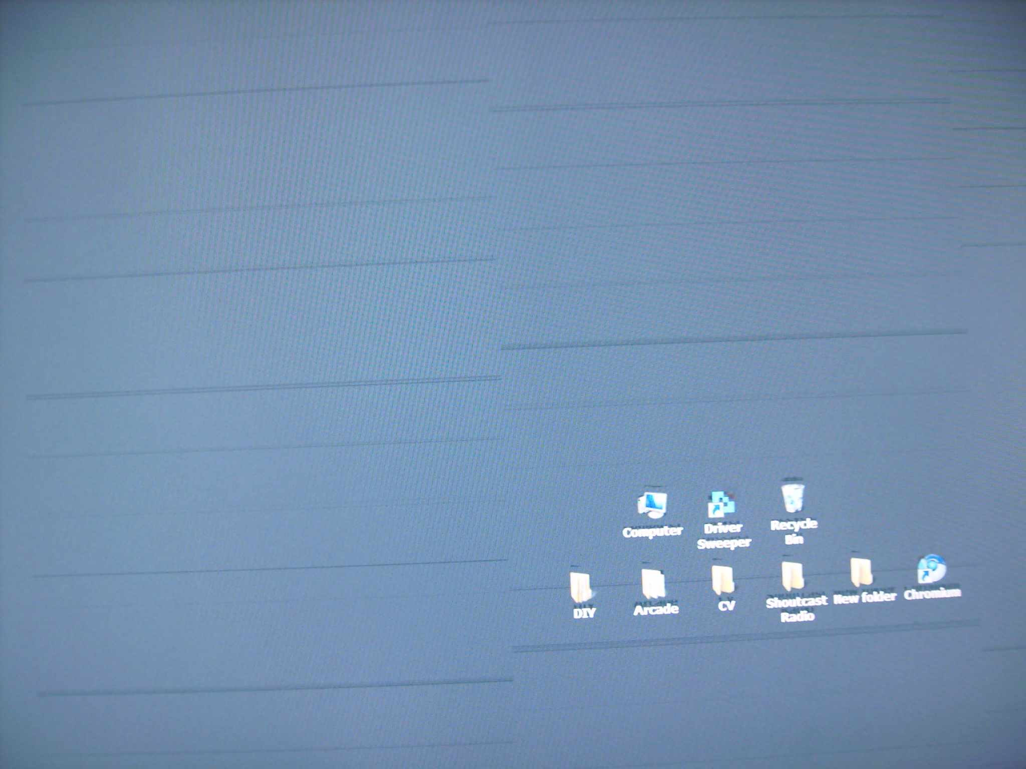

      Pics.
      The lines/stripes flickers, not constant.
      Even made 2 movies cant attach them.
        I manage to strike some important keyword on goggle.
        Tab Bonding problems.
        from wiki:
        tab failure "cold start"
        *"This fault is often seen as a ghosting double, or triple, image on one side of the display, with shadowing or dulling of the other part of the screen"
        *"use a 50% and a 75% grey test signal"
        *"Cold start TAB faults tend to get worse, as the regular heating and cooling of the bond, from powering the display on and off, causes further cracking"
        Not fun at all for this S-IPS 20"screen.
