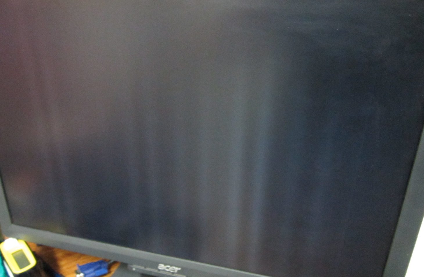

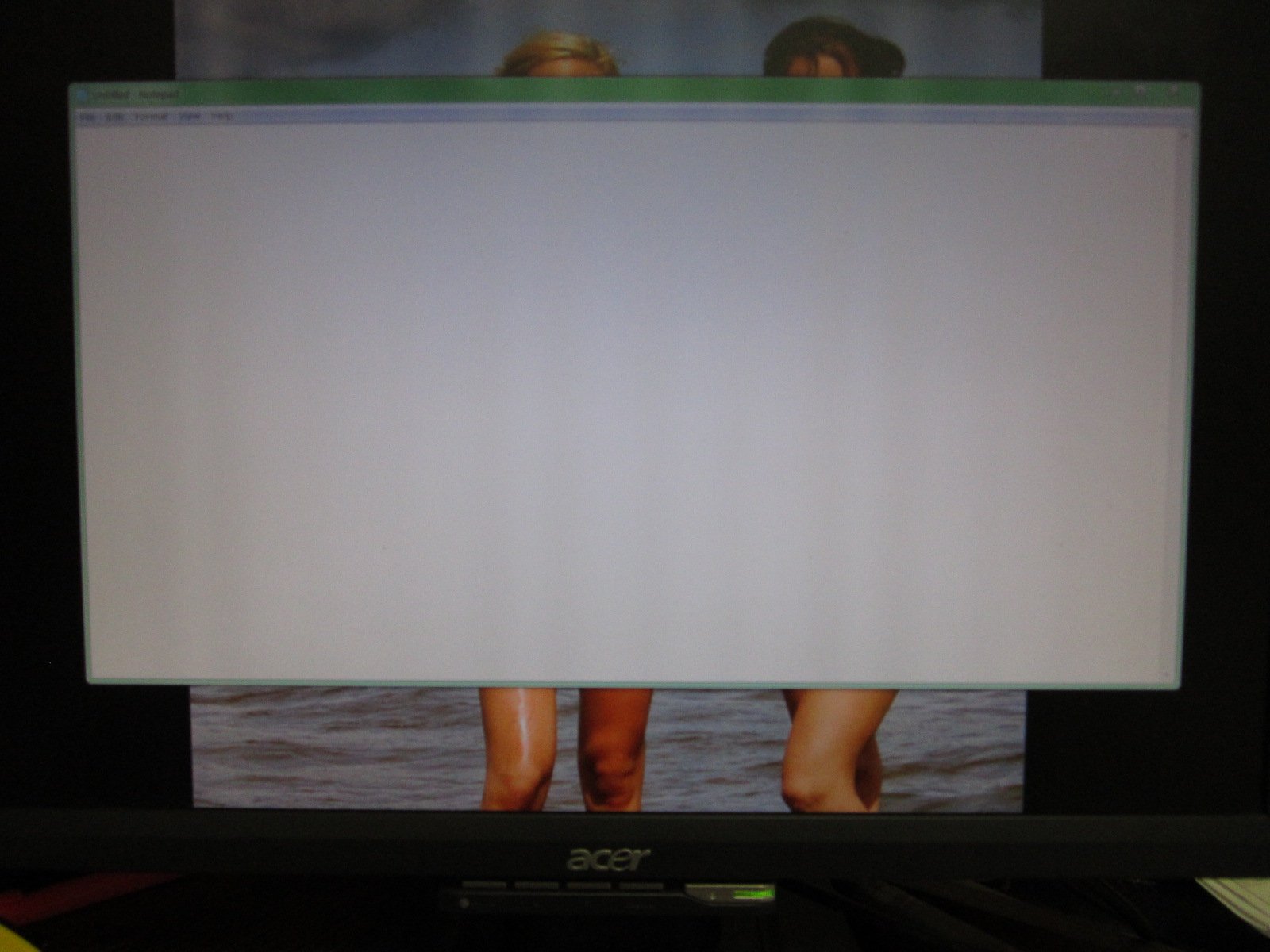

    Is there something specific to test when you get light/dark banding on a monitor? I am posting pics since this does not seem to be the same type of banding that I saw mentioned in other threads.
    My apologies for the quality of the pictures but it was really hard to get them to show up in the pics.
    (edit) I forgot to mention all the caps were already replaced with Panasonic FM series.

    Do you have another lcd panel (screen) that you could substitute for this one and see if it behaves the same way? If not could you post pictures of the rear of the lcd panel. Otherwise I would say that the lcd panel should be replaced.

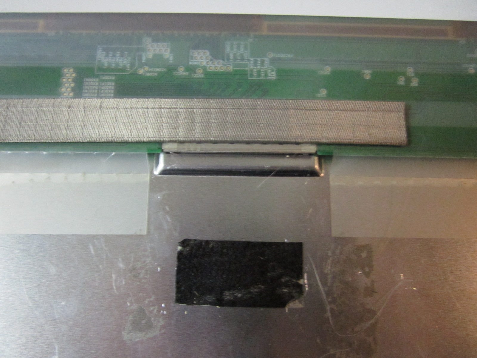

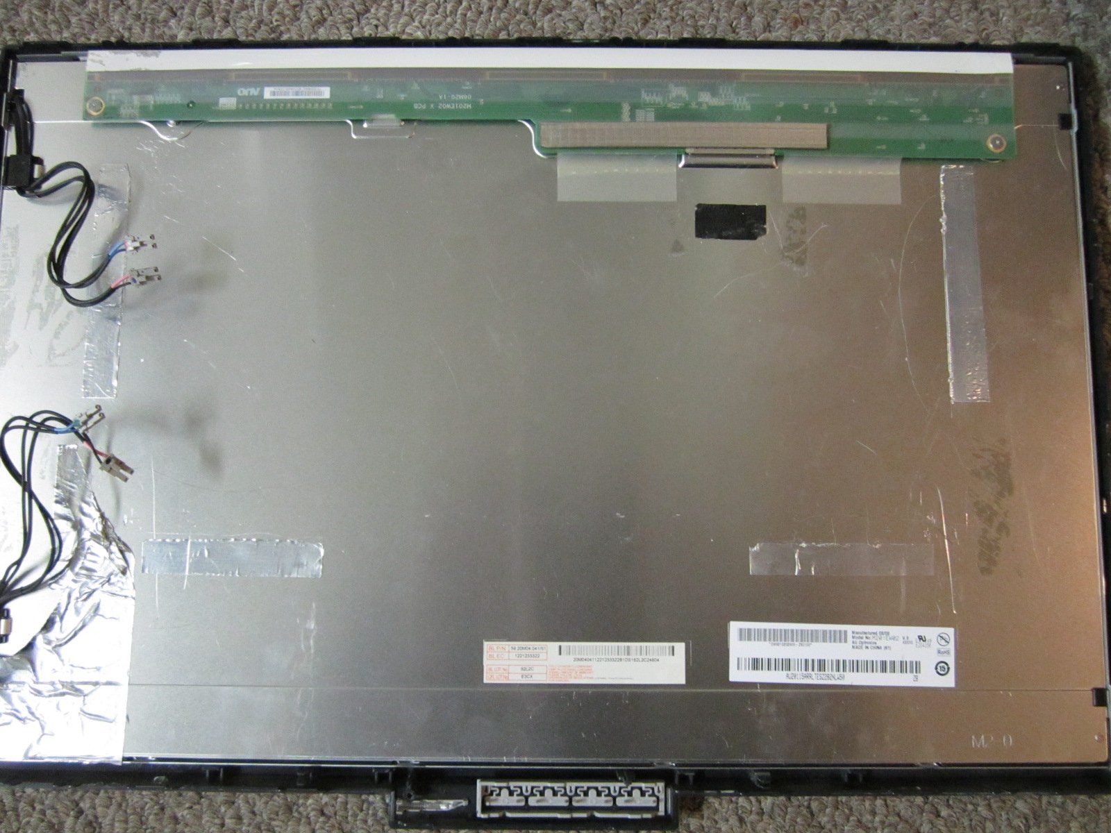

              What pictures would you like lcdman? Just the panel itself with the boards etc removed?

                I think the panel needs replacing !!

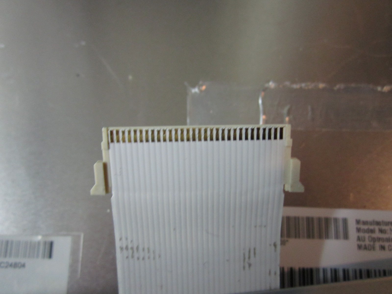

                  I wanted a picture of the back of your screen without the boards,steel cage,etc. And only to see the type of video connection. I had a similar Acer model that had two thin aluminium wrapped wire connections that went from the video/main board straight to the screen. Not the type of video connection used on alot of other lcd monitors that I've worked on before. I should have suggested to try cleaning and re-seating the connection. Kudos to Rtech as always.

                    Dull grey day so not the best light for pics, if they are not clear enough I will take better ones but I think they should show what you wanted to see.

                      I'm no expert on taking photos, but those look good to me. You have a common type connection for the video cable (LDVS). From what I've read on this site and personally learned about lcd screens, is that there is a thin plastic covered membrane with wires in it that connects to that long small circuit board. That membrane some times comes unbonded from the lcd element itself or sustains some damage (broken connection of the wire(s)). Thats what causes display issues like what your experiencing on this monitor. And thats not repairable. And thats why Rtech said to replace the screen.
