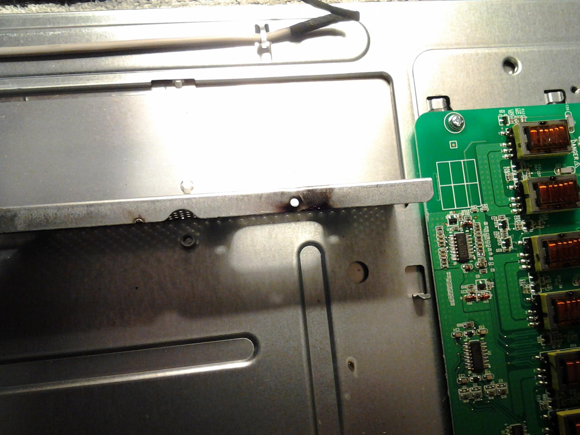

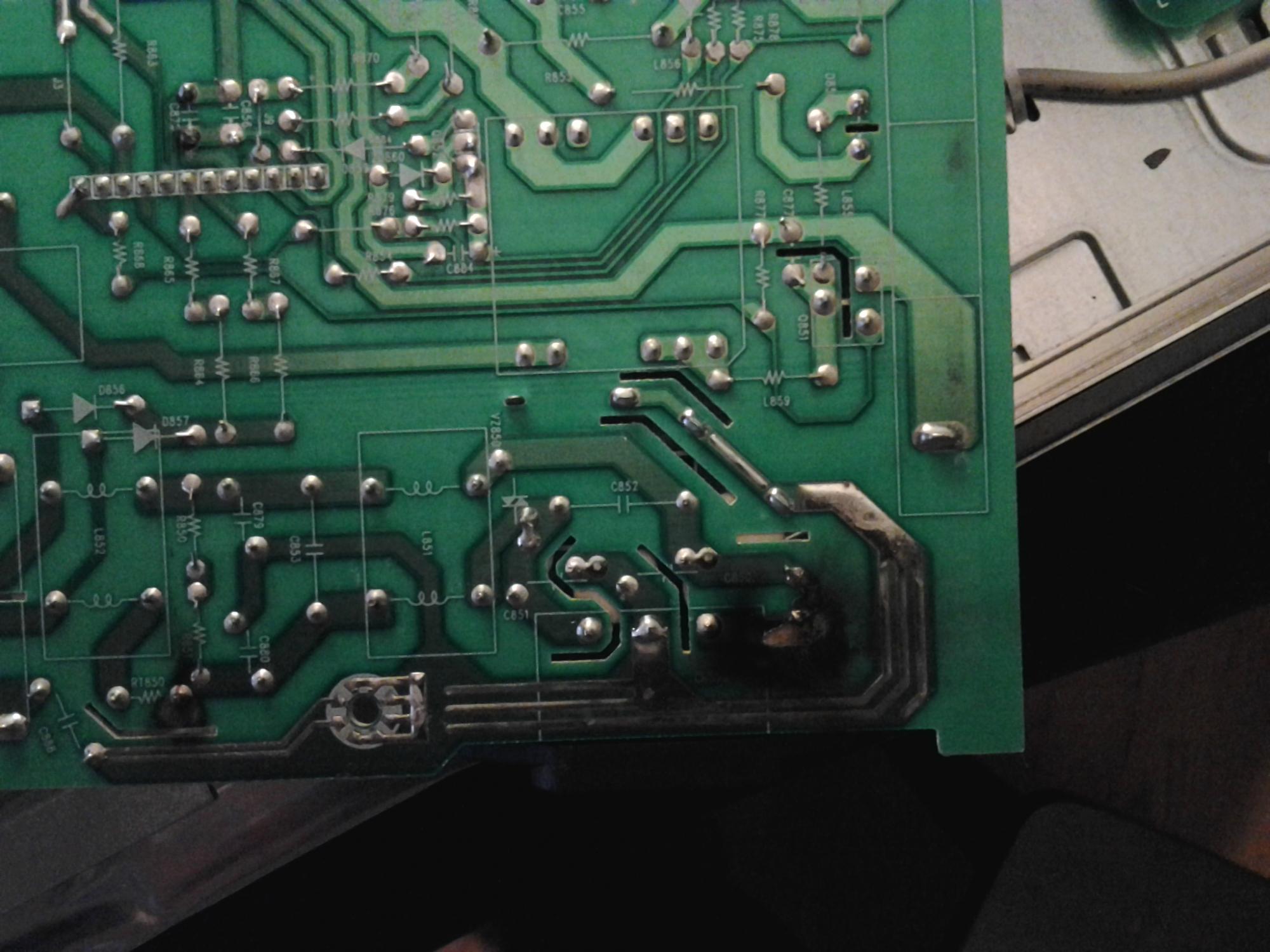

          I replaced C872 and when I gave the board power, it sparked and appears to have blown the fuse. It gave me a pretty good scare. I think I'm in over my head and will likely trash the monitor. Not sure exactly how dangerous this stuff is, but I'm not willing to risk an eyeball or worse over it. Many thanks to those who tried to help me. I might not have fixed it, but I still learned quite a bit just reading your responses and poking my nose around the electronics.
            Did you put in the cap properly observing correct polarity (positive and negative)? If not, the cap will go pop.
            Rather than trash it, give or sell it. Others may be able to repair it?

              Safety glasses are a must when testing electronics. I use them even when testing computers sometimes (if they have their side open, that is).
              Looks more like you shorted the board due to improper placement or perhaps a loose screw or solder shorted the live to neutral.
              Check that you put the cap in the right way, as retiredcaps suggested.
