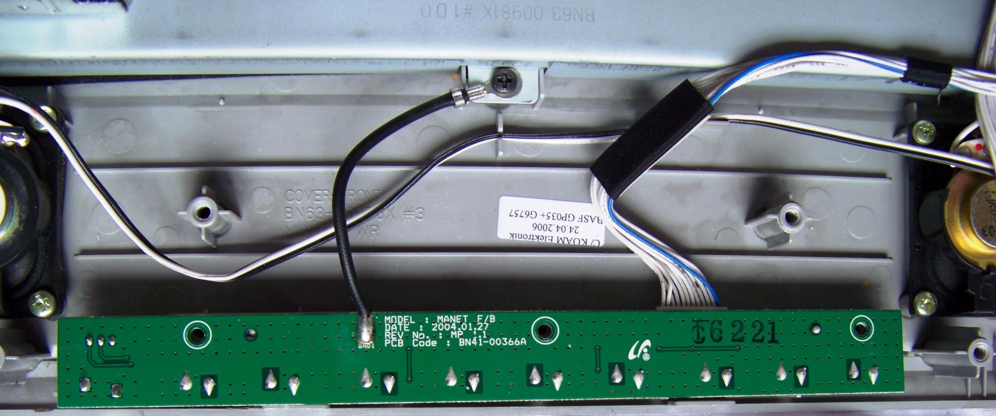

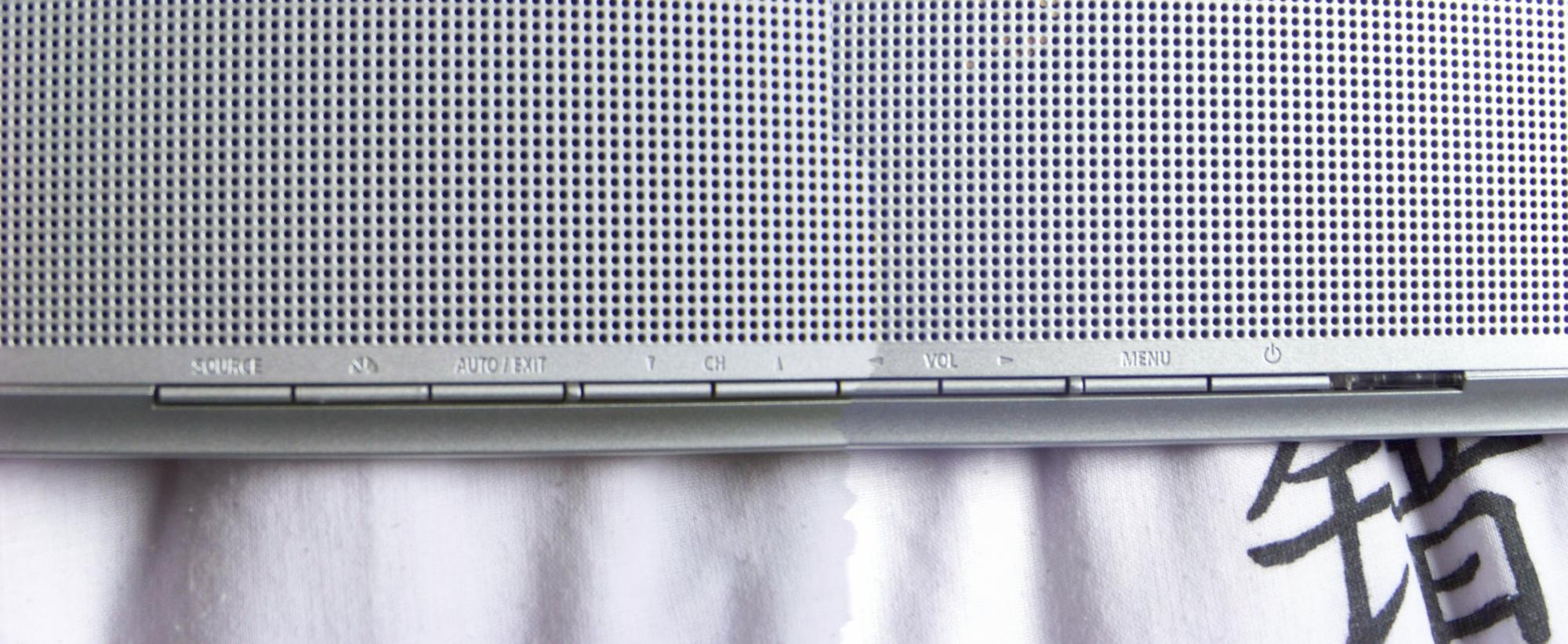

    I've a Samsung Syncmaster 910mp monitor but without what, on some schematic I've found on internet, they called it function pcb, where the front command switches are (like power, menu, enter and so on)
    I've only found schematics of the main pcb ho I can't find any details about the function pcb that I need to make from scratch... the only thing I've found is in the schematic of another Samsung tft monitor (171N) that uses the same chip where the inputs from the front commands end, the NT68F63L.
    However that other monitor uses a reference 5v instead on the 3.3v used in my 910mp, but if I've understand it correctly every switch simply closes the circuit with a different resistance value.
    If I still don't find anything I'll need to make some experiment searching for the right resistors values
    Does anyone have some useful details about that function pcb?
    Thanks in advance

      I received that monitor as not working, I saved it from the trash and repaired it I suppose the previous owner has removed the speakers and the function pcb thinking the latter integrates the amplifier, but it's wrong... the ampli in on the main pcb in that model.
      So actually I haven't any little part of the original function pcb...
      Here is the image of the front panel commands:
      Googling I've found a partial image of what I need the function pcb is the little one on the image bottom.

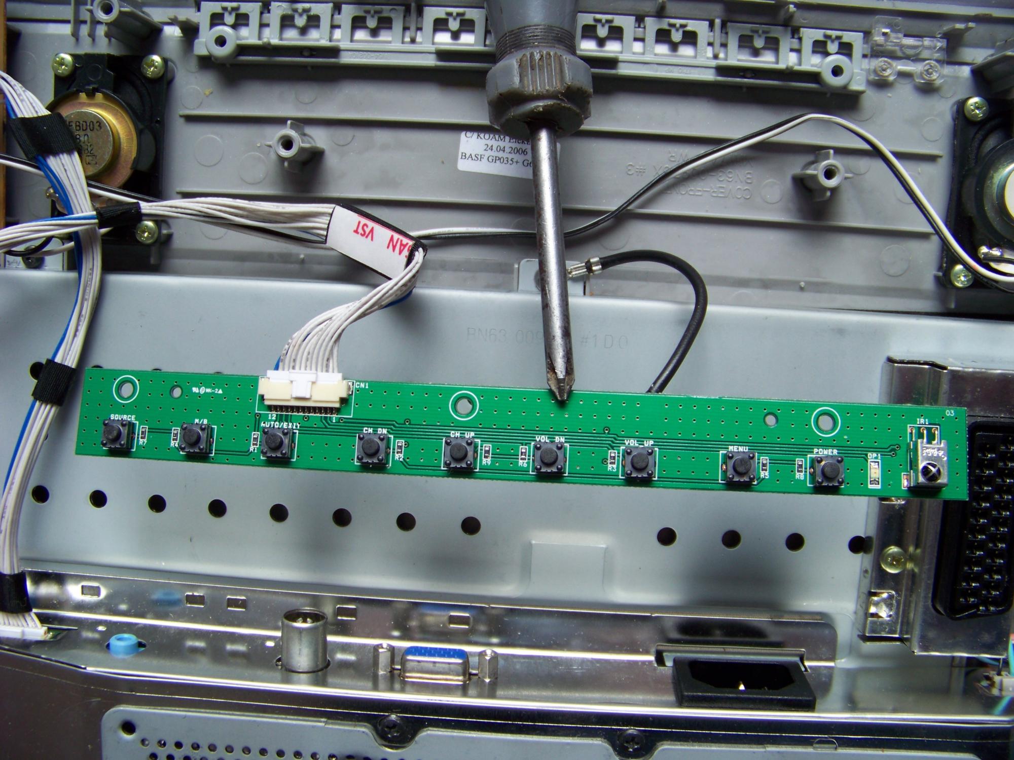

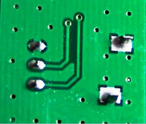

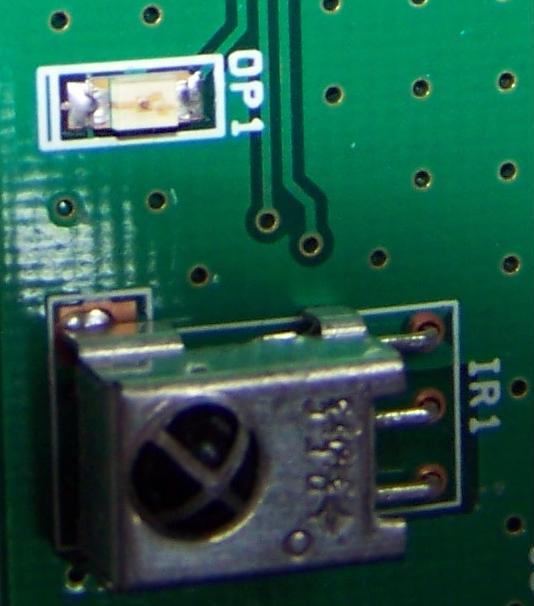

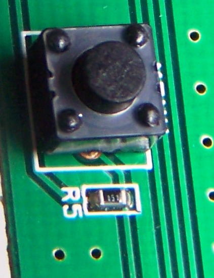

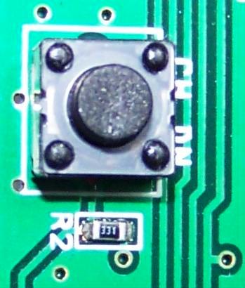

        Hi sorry to get your hopes up I thought I had one of these sets but mine is a 711mp which is a monitor/tv. I see yours has a scart socket which is kind of unusual for a monitor?
        Anyway I have taken it apart in case it is of some use in your project.
        Took ages to do the pics as I often tell people posting here that their pics are no good so I have to get mine fairly clear.

            The function pcb should hosts a ir-receiver too for the remote, but it's the last of my problem actually

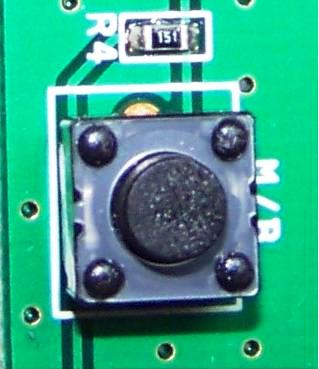

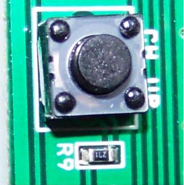

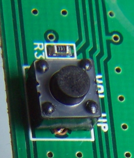

            Let me take a better look at your pics... it's only a pcb with resitors, switches and a ir-receiver, isn't it?
              Re: Need help with Samsung syncmaster 910mp "function pcb"

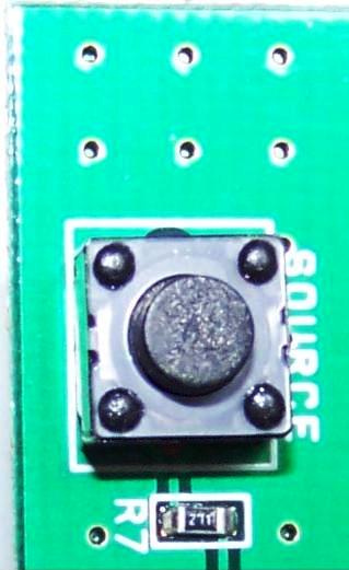

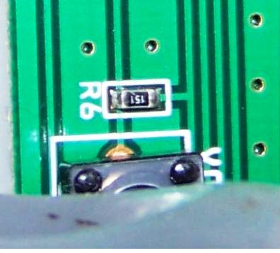

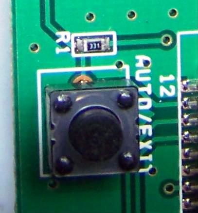

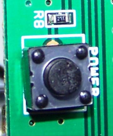

              Hi - yes resistors switches ir and a led (OL) - I will leave it in bits for a day or two in case you need to know anything else.

                Ok many thanks selldoor, I'll try to draw the schematic from your photo on tomorrow...
                  Great pics! I can't only read the IR1 number

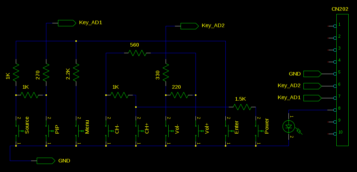

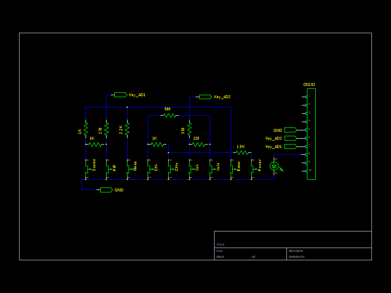

                  I drawed the schematic and found the 711mp schematics, it uses 3 different lines (KEY1, KEY2 and KEY3) for the nine buttons... the 910mp instead only has 2 key lines KEY_AD1 and KEY_AD2 I only made few tests but it doesn't seem to work
                  I think it could uses a different approach but I don't know which one
                  Any idea/suggestion is appreciate
                    Thanks to your info and to my father's patience who has empirically discovered the resistors values I've finally build a working function PCB for my Samsung SyncMaster 910MP
                    Here is the schematic if someone is interested in it...

                        Better resolution... (I'd like to edit the previous post but it seems I can't edit my own posts)
