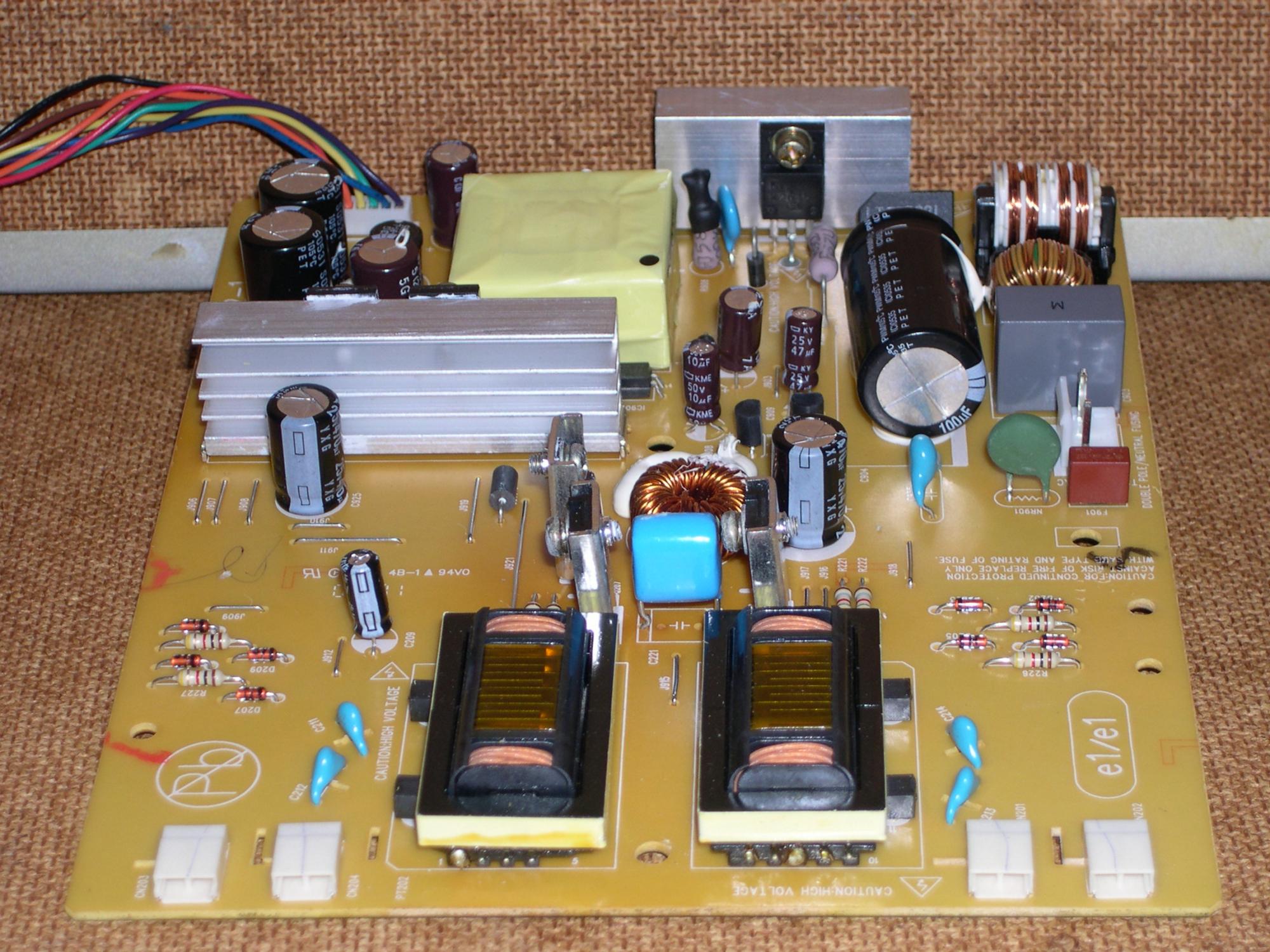

    Viewsonic VG920 No HV for the tubes
    I have a (VS10790) with a PSU (part# 715G1492-1). I scanned the three posts here for this monitor and not much matches my problem. I used the other posts and found voltage info, but still no joy.
    I replaced ten caps on the PSU purchased from LCDAlternatives and still no joy.
    The problem is:
    I have AC power, and a power LED when the switch is pressed. The display fires for a split second and then off. The power LED stay green. It will go to amber when the computer goes to standby. It appears the HV to the tubes is shutting down, but all other power remains.
    Once in a while the display works, the HV stays up and the image is great as long as it is not powered down or goes into standby from the computer. Thanks in advance for any help.

    Re: Viewsonic VG920 No HV for the tubes
    Hi lee welcome to the forum.
    Have you tested your inverter transformer? This can cause the monitor to shut its self off if shorted.
    Can u remember the make of he caps that you put into your monitor? Did you match the values of the ones that you took out exactly?
    Can we have some pics of the top and bottom of both boards so that we can help advise you further?

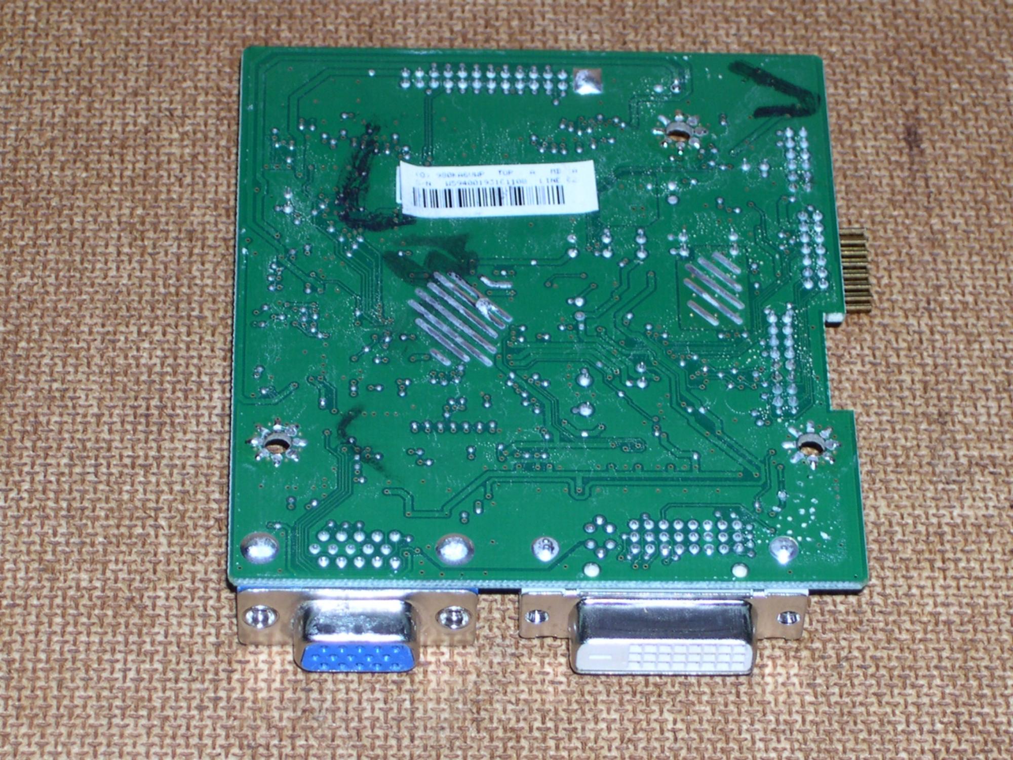

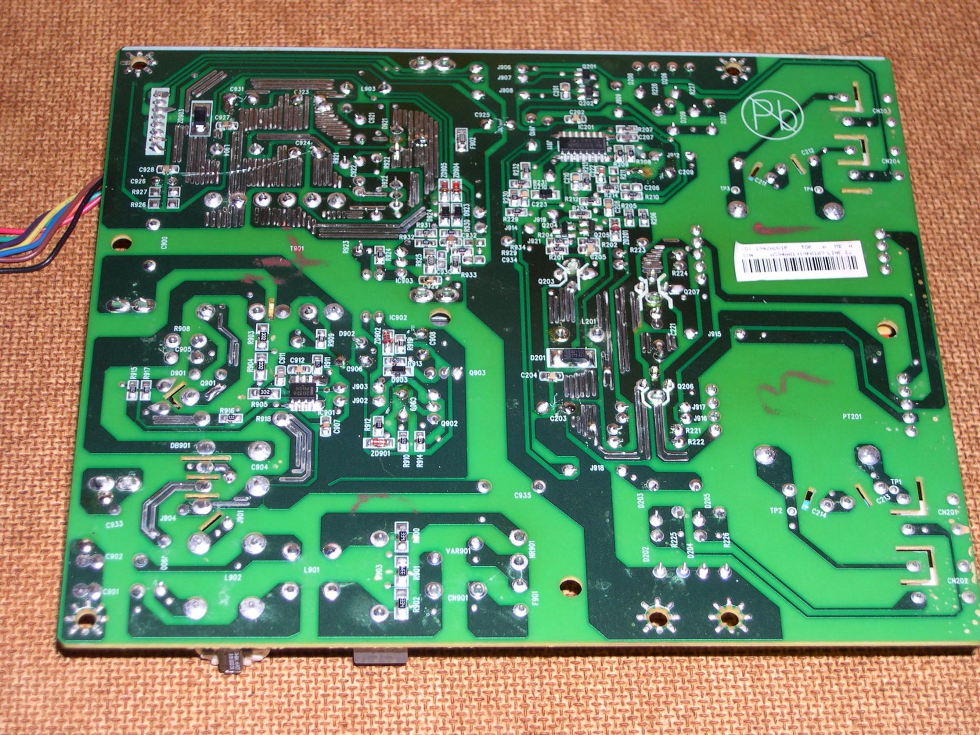

      Thanks for your reply. No I have not tested the transformers, yes there are two. I don't think it's the transformers as all the tubes shut down at the same time. Let me know if my assumption is correct. But please let me know how to test them other than with my ohmmeter.
      The replacement caps, ten of them came from LCDAlternatives and are as good or better than the originals. The new ones are high temp and low tolerance.

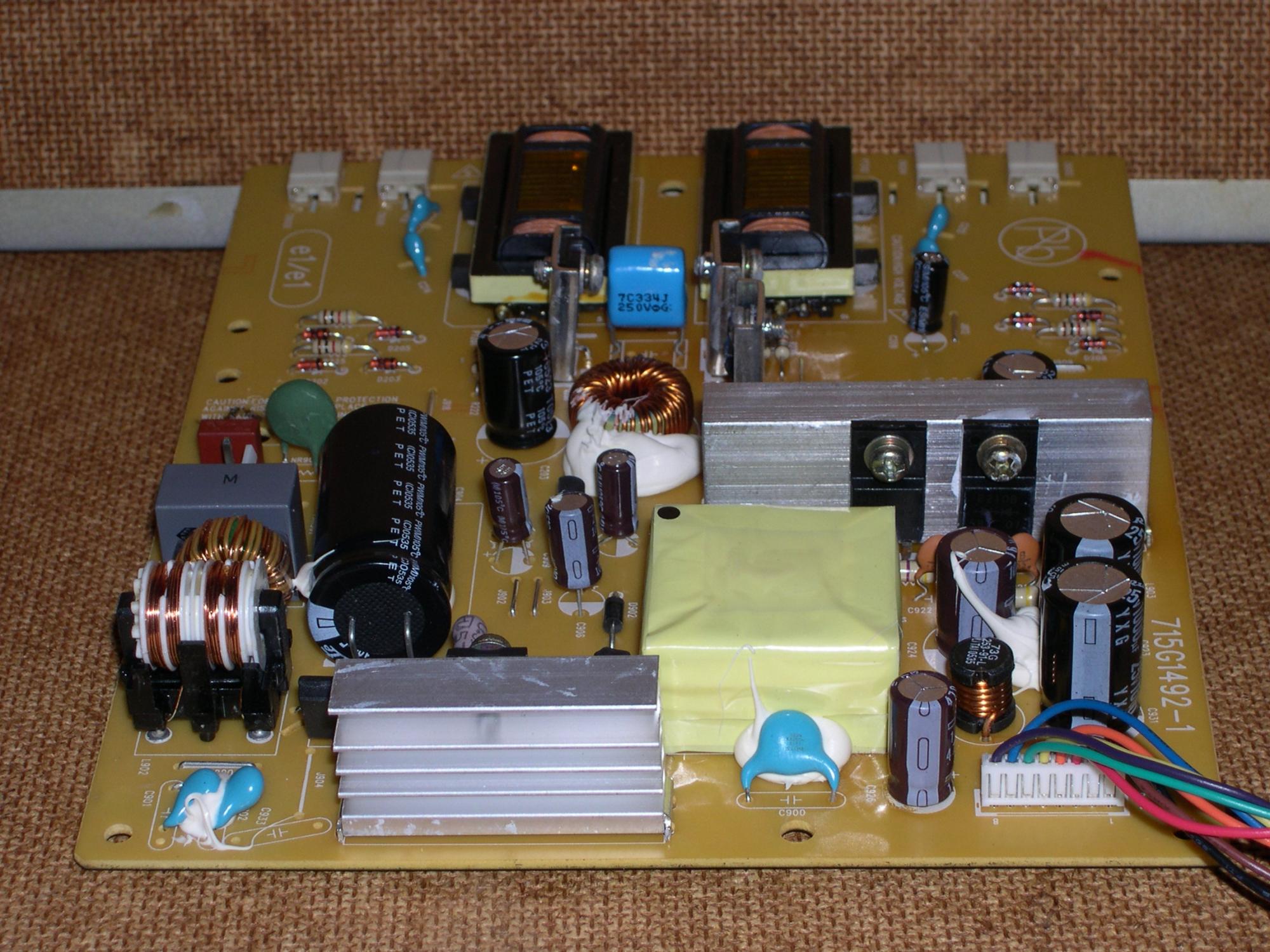

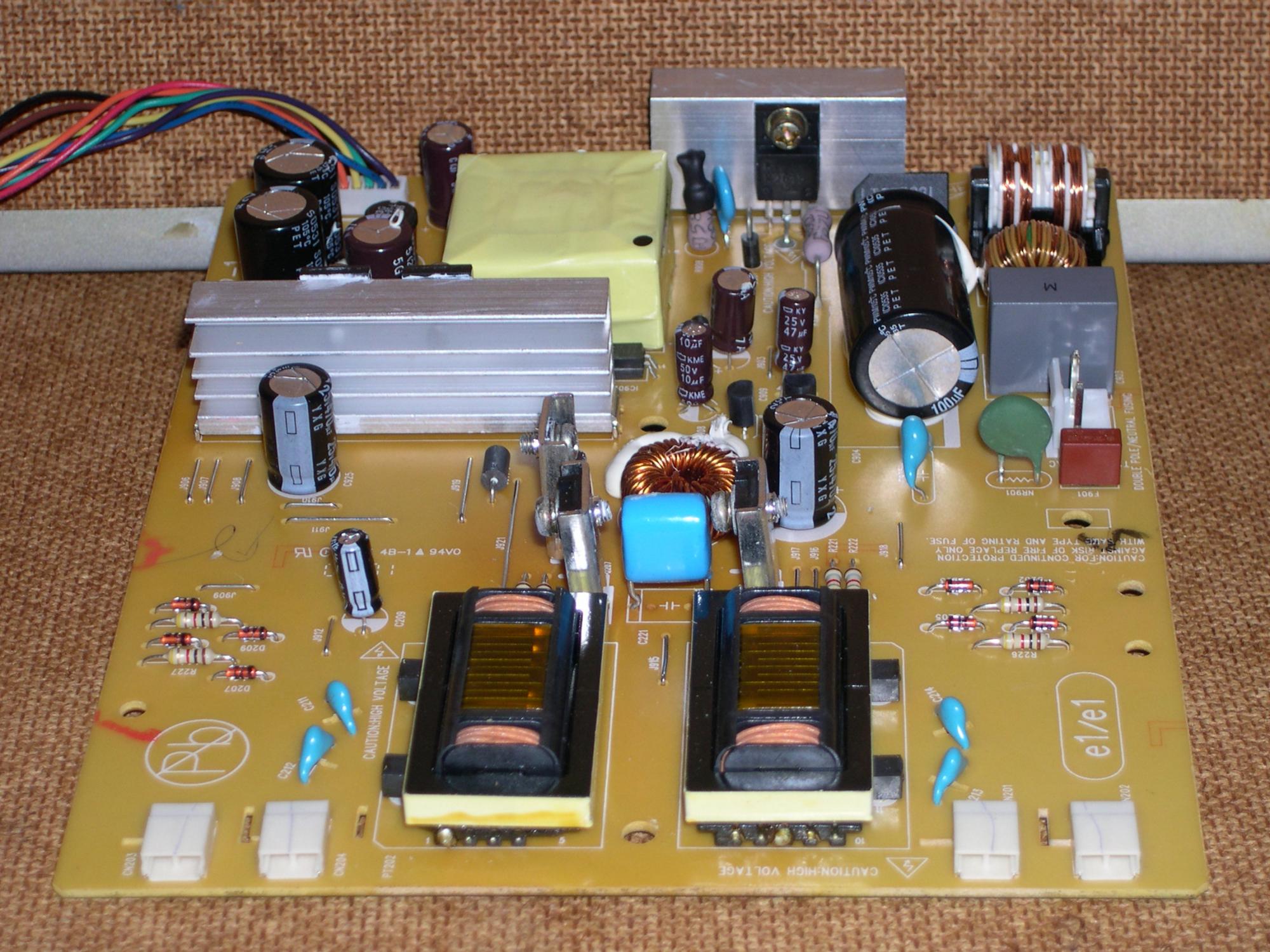

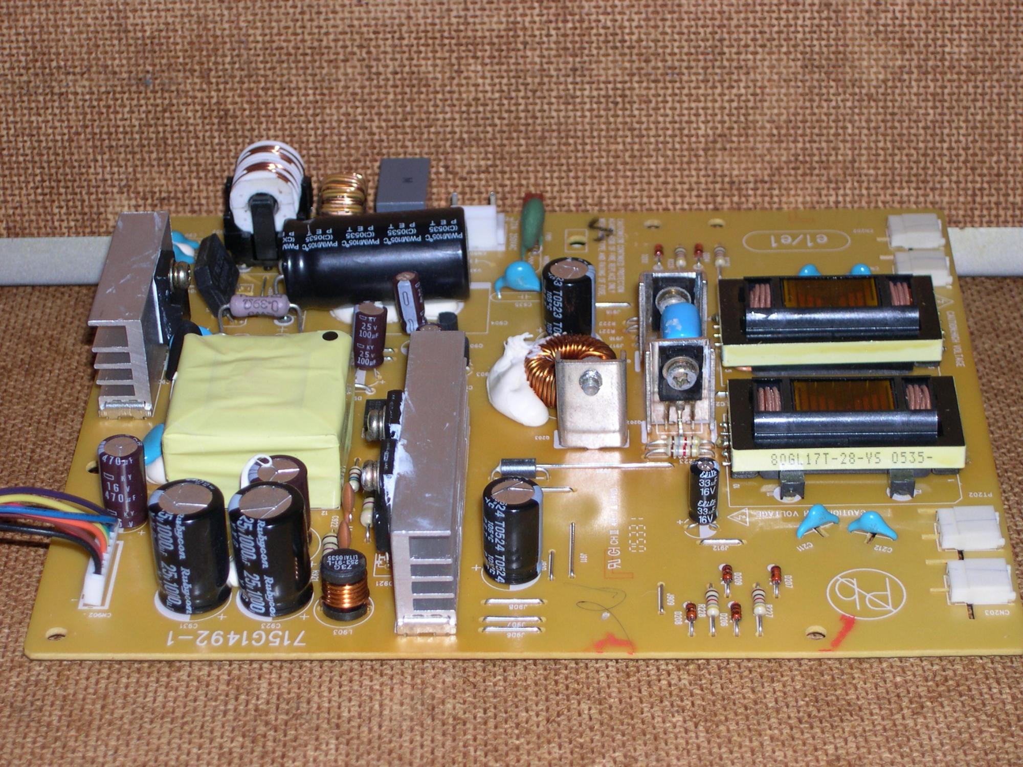

      The photos of the PSU upper sides were take before the caps were replaced. All electrolytic caps except the large 100mf 450v by the FW bridge were replaced. It has nothing to do with the HV.

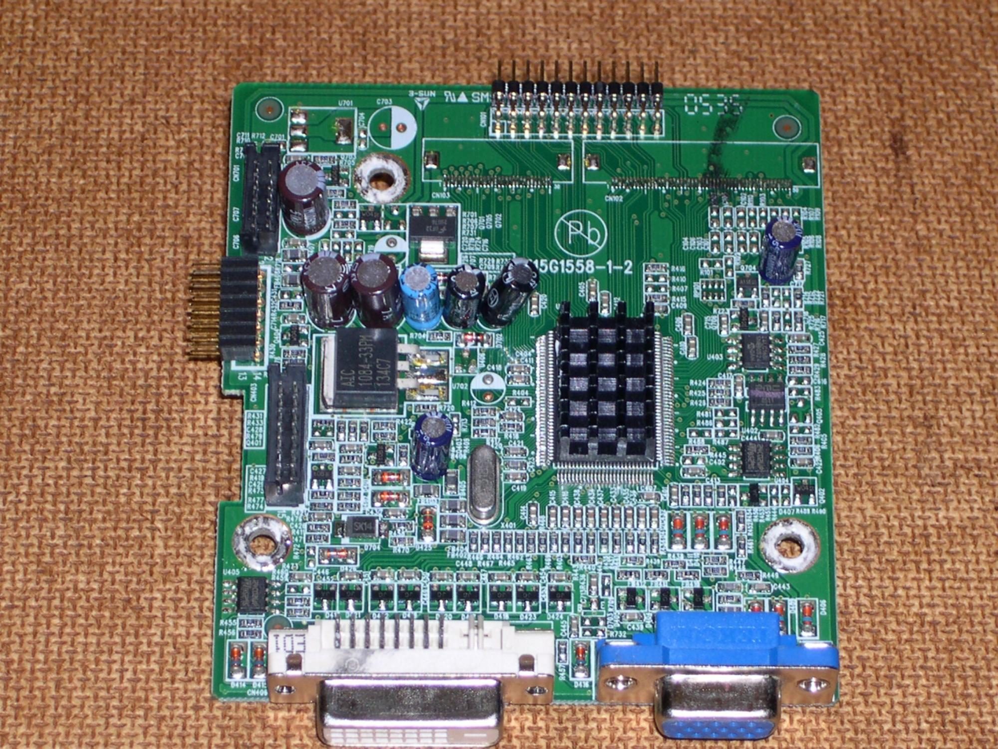

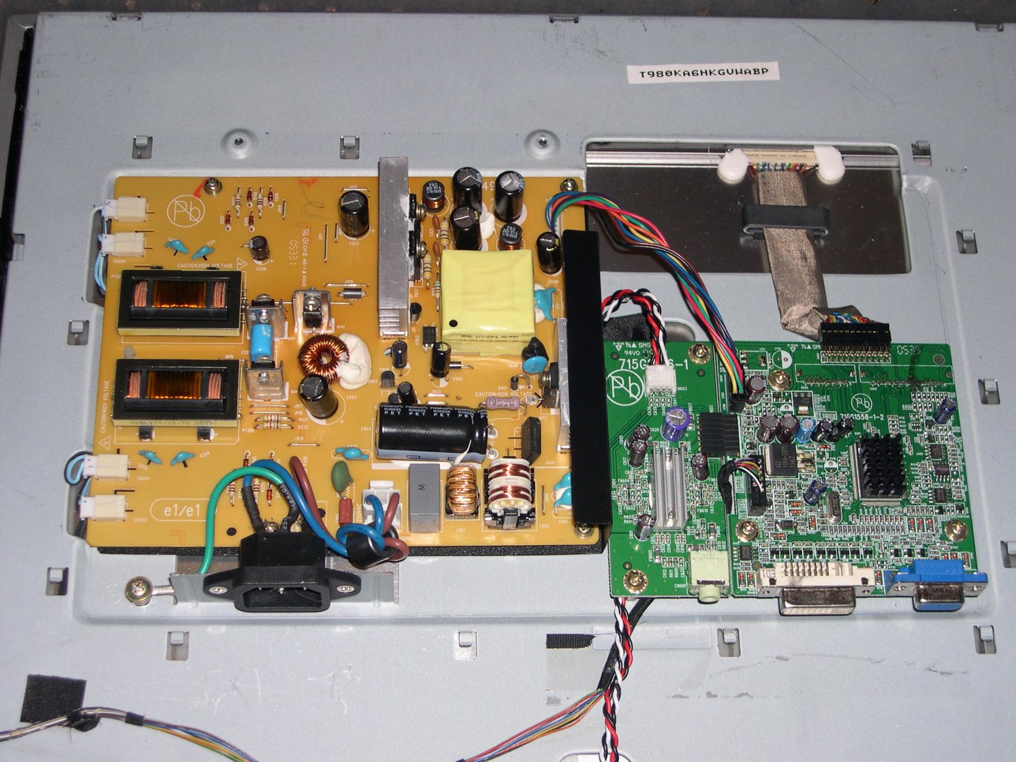

      Photos attached are the PSU and the output/interface board. I did not photo the audio board.
      Thank you in advance for any help.
        Whats written on IC901 on the bottom of the power board?
          IC901 reads:
          203D6
          PGGN
            Please notes that:
            All the lamps and the inverter circuits will be shutdown if the Inverter circuits (control by the inverter driver IC)
            1) Detect open lamp connection (if any one of the lamps does not conduct within about 1.5 seconds after the the strike voltage is applied).
            2) Shorted winding on any one of the transformers.
            3) Too much current draw by the lamp.
            4) Bad MOSFET's transformer drivers.
            5) Bad connections on the lamps, in the inverter circuits.
            So there can be many possibilties that any of the above can cause the lamps to shutdown. Testing the inverter circuits with known good lamp will be one way to narrow down the problem.
            Beside Ohming out the transformers, you should remove that blue cap on the middle of the board (sitting close to the transformers and the two MOSFET's, check the value and the resistance leakage of that cap.

              FYI: IC U406 on the output/interface board had already been removed when I got the monitor. I looked for it as per a post or two in this forum to remove/replace it to solve similar problems. Post #8250 I believe.
