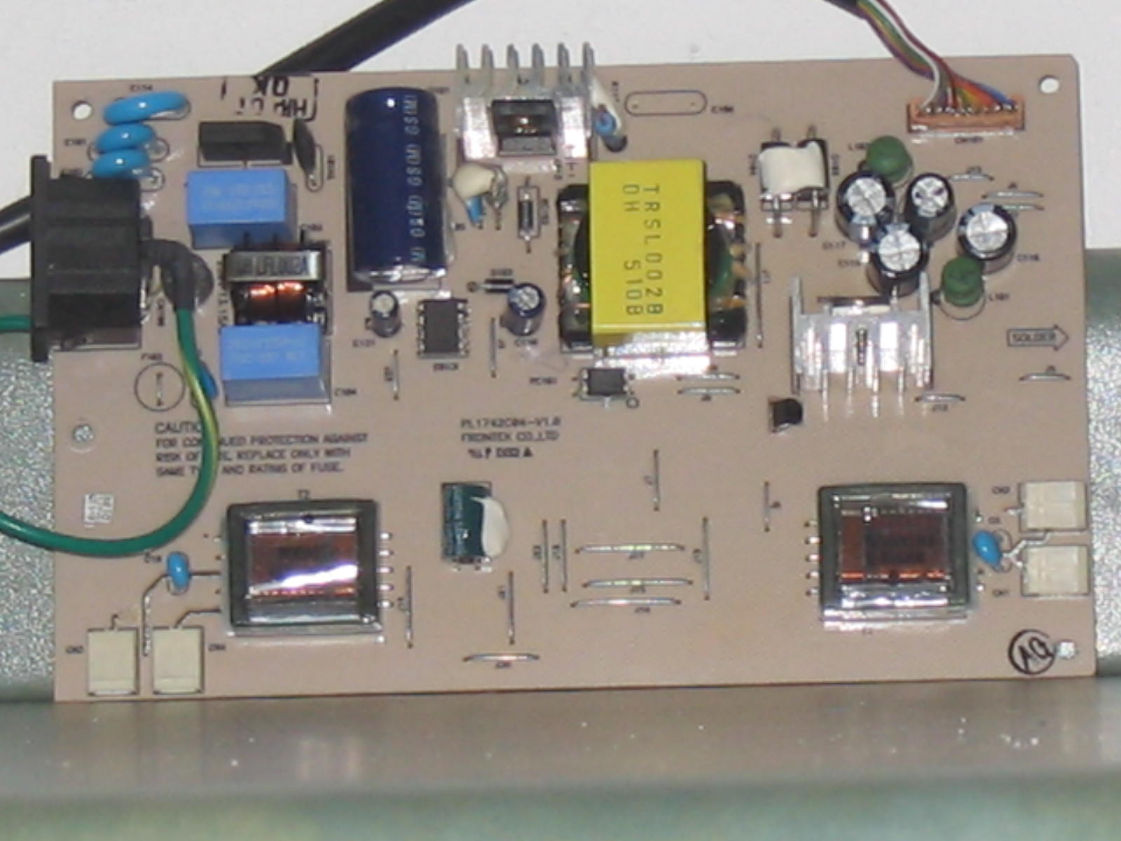

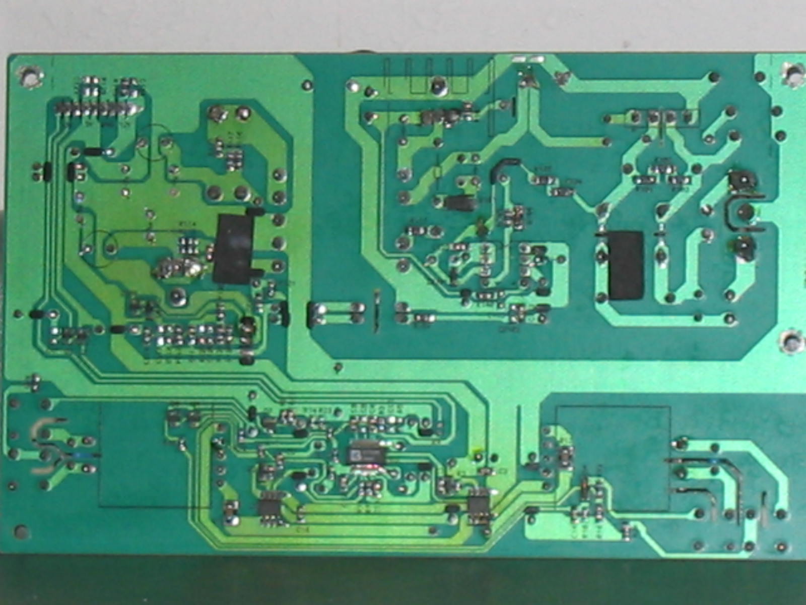

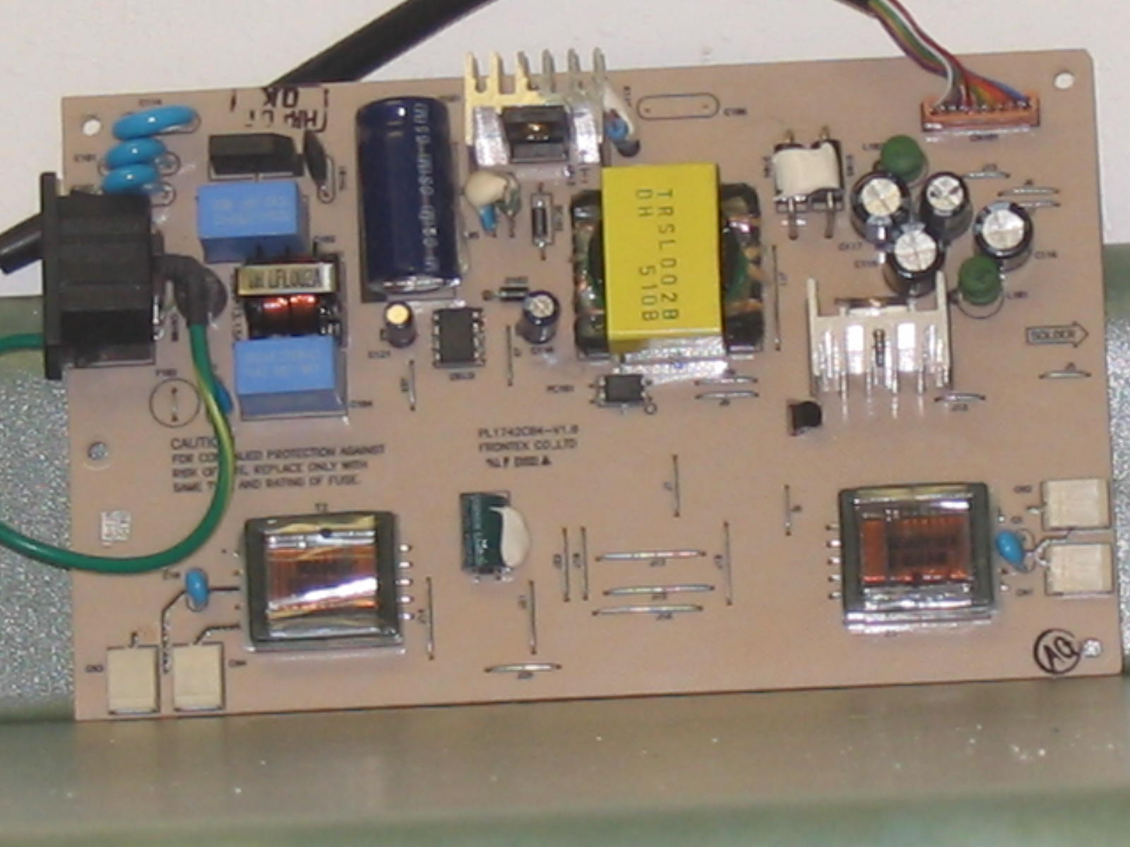

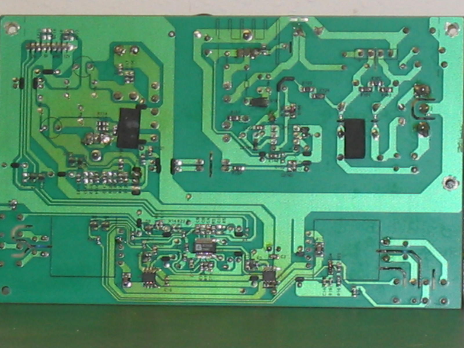

    I have a Daewoo 17" TFT-LCD Model HL710S monitor that is dead I cheacked all the Caps with an ESR tester and they all tested OK. When I put the neg to the big cap I get voltage ot both diods on the secondary section and also on I get voltage on the secondary caps. But their is no voltage at the 5 and 12 volt output pins. What component could be the problem

    2) Post clear focused top down view pictures of all your boards following the instructions in my sig file below EXACTLY.

                Hi - your pictures are still not good enough - im not sure why - they need to be
                retaken so they are not blurred when enlarged. They should be around
                2mb jpgs.
                Did you do the output voltage test with all the boards connected. At very least
                the power supply and the main board need connected. I am trying to check
                if there are any fuses but its so difficult with the pictures being poor.

                  Here are a new set of pictures with a better camera I hope they are clearer for you. Yes I tested the voltage with the the power supply and the main board connected, I also checked for a fuse but couldn't seem to find one. My Country is Canada and I am located in Manitoba.

                            Let's try this again. I asked you to perform the pin 6 to pin 7 test on a resistance setting, not voltage setting. We're trying to determine if there's a short on the vcc pin.
                              Re: Dead, Daewoo 17" TFT-LCD Model HL710S
                              meter set to 200 ohms on pin 6 to pin 7 their shows no or 0 resistance
                                If you're reading 0 ohms, then there is a short, which means one of two things:
                                1) There is an internal short of the ICE2SA01 between pins 6 and 7, which requires you replace the ICE2SA01.
                                2) There is a short to ground of one the components that is connected to the vcc pin 6 of the ICE2AS01. Your photos are not clear enough to read, but there should be a resistor, diode and cap(s) connected to pin 6. Check these for shorts.
