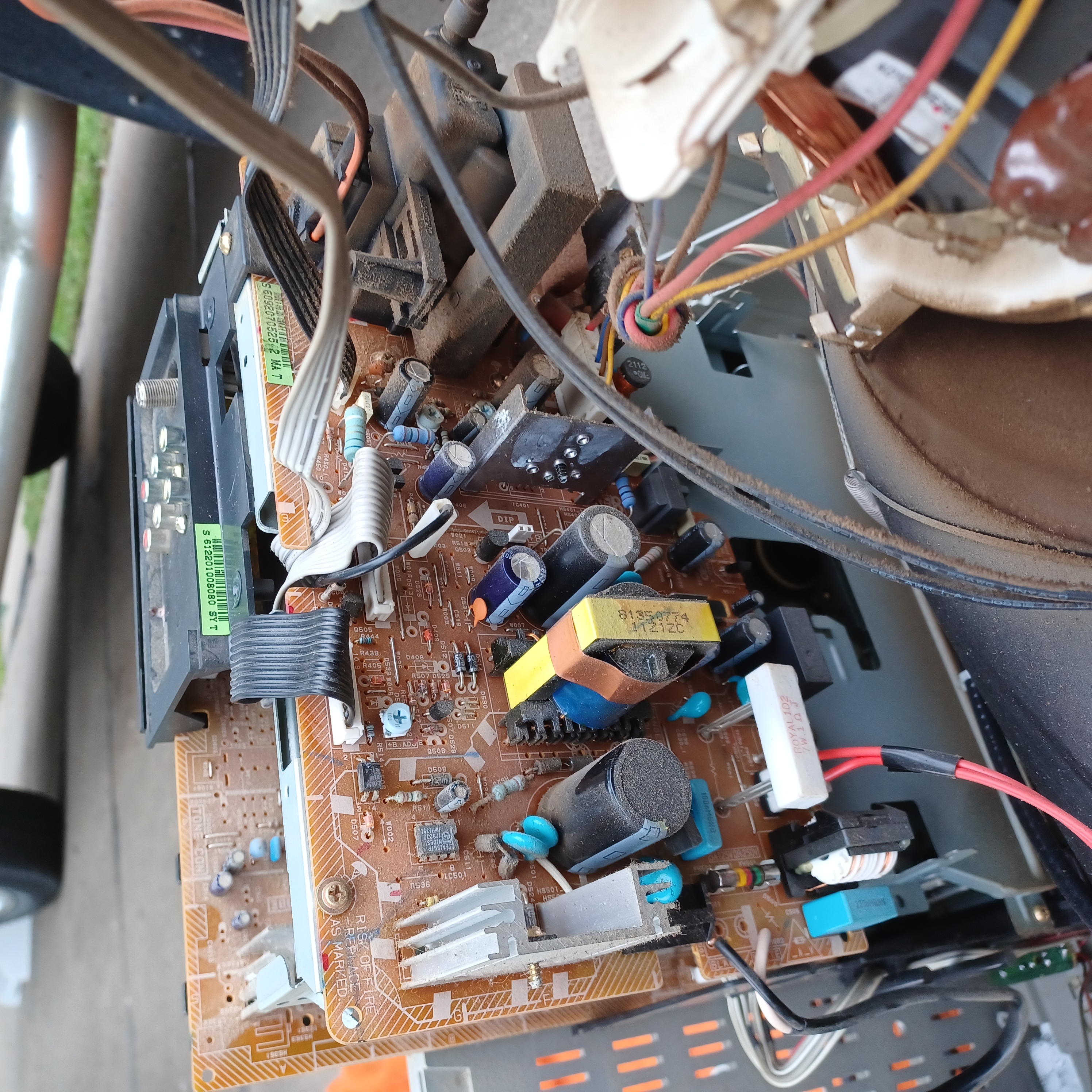

    hi
    ive got an old 2002 toshiba crt tv
    its 100% dead
    no power on
    no standby light
    no click sounds
    nothing
    ps main fuse checks ok
    caps not bulged
    what would be most common failure to cause this?

        hrre pic of ps board
        ii saw a repair on diff crt and it was simply a cap that was bad
        from the photos which cap should i test..

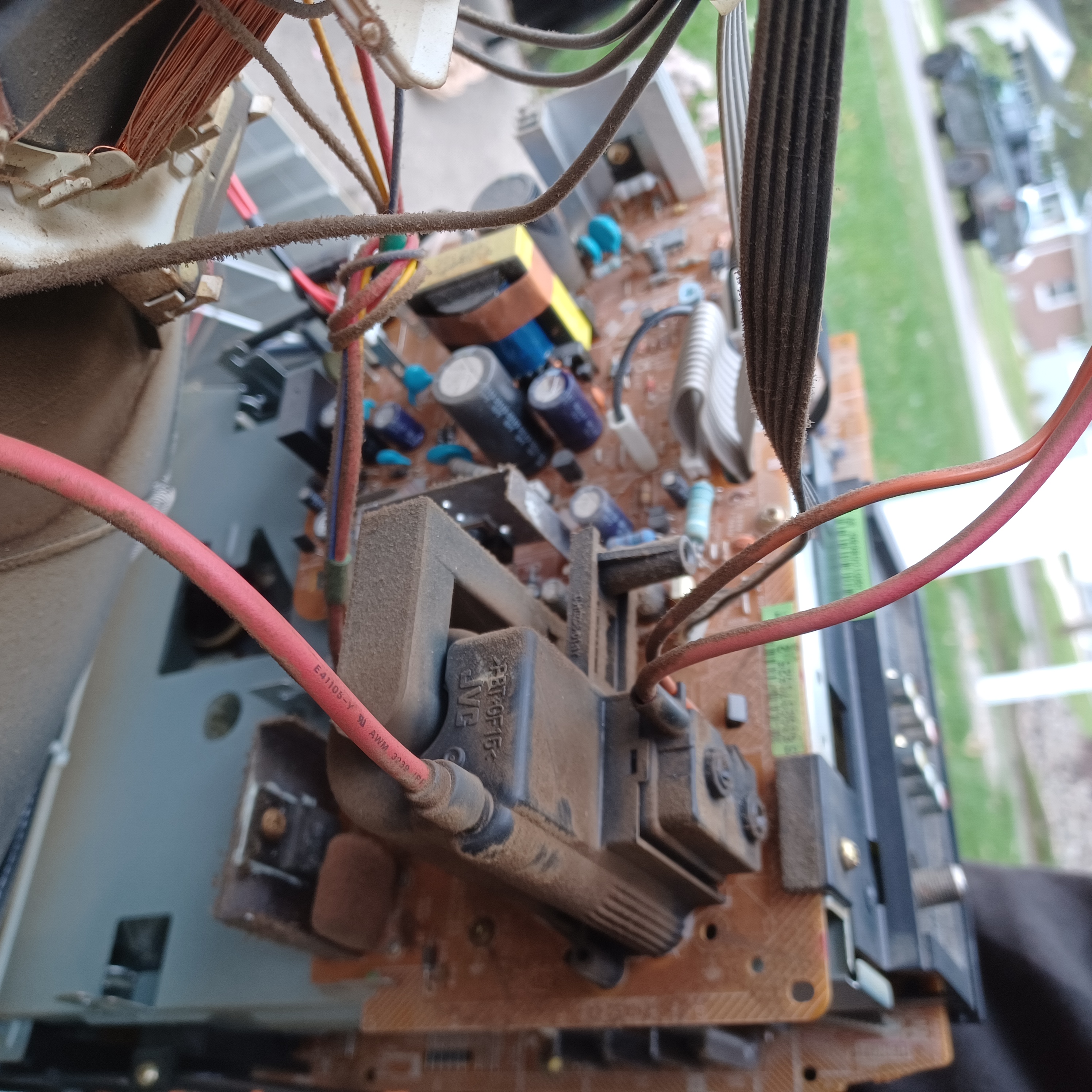

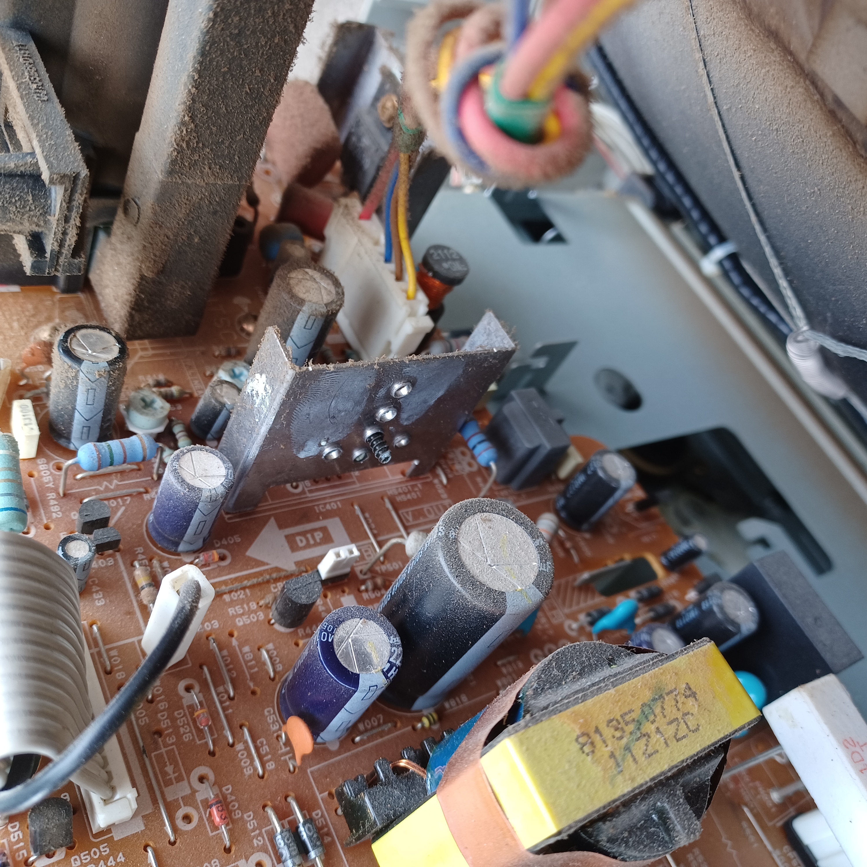

          another pic of ps

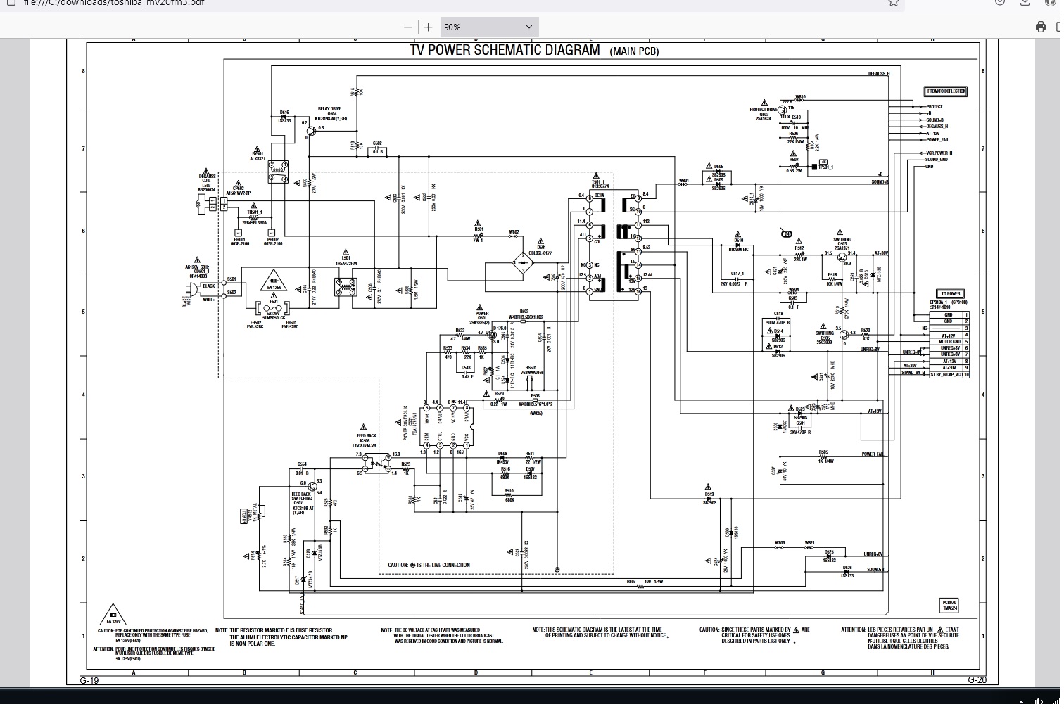

            i found a service manual with voltages so when i get time i will do some probing ..

              here is ps schematic

                If you do not have any B+ voltage on the secondary side, check the primary side.
                Check the resistance of R501, if it is ok, check the resistance of R527, If they are good, check for DC voltage across C507, If that is about 165vdc, Check the voltage across C542, and I would just replace C542, it is likely bad

                  Re: toshiba crt tv 100% dead
                  Looks like the set uses mostly Rubycon capacitors, which are likely going to be OK. But nevertheless, a cap failure is not excluded yet.
                  First, before touching anything too much with your bare hands, make sure the large black 400V (or 200V?) cap next to the transformer (the one seen on the bottom-center of this picture) is discharged. Take a multimeter and read the DC voltage across its terminals. It should be less than 30V, preferably close to 0V. If non-zero, use a 1 kOhm resistor and put it across its terminals for about 10-20 seconds to discharge it. Alternatively, you can use something like a 25-40W "dumb" soldering iron (one with no temperature control or electronics) or a 10-30W hot glue gun - just stick the plug end directly onto the cap's terminals for 10-20 seconds, and that will discharge the cap too.
                  Next, take a small paint brush and remove as much of the dust you can so that you can see things a little better.
                  Then, use your multimeter to check the following:
                  - Resistance of the large white 7 Watt 0.1 Ohm resistor --> should read close to 0 Ohms or whatever is the lowest your MM can measure.
                  - Resistance of R529 --> looks like a 0.22 Ohm resistor on the schematic, so it should also read very low resistance like the 7 Watt resistor above.
                  - Resistance of R511 --> should be 22 Ohms if I'm not mistaken, and read close to that value even in circuit.
                  - Diode value (use diode check on your MM) of D508 - should show a normal 0.5 - 0.7V (or 500-700 mV) diode reading one way (in the diode's forward direction) and high resistance or open-circuit when you reverse the probes.
                  - Diode values of all of the output rectifiers. That is, D505 (or is it D508?), D509, D510, D512, D514, D513, D523, and D519. These should show a normal diode reading in the forward direction. Alternatively, and just to verify, use lowest resistance scale on your MM to measure across each of these diodes. If any of them show a very low resistance (under 100 Ohms) steadily, note which diode(s) this is and report back here.
                  If all of these check out OK, take a hair dryer and heat up capacitor C542. It's a small 25V, 47 uF (according to the schematic) electrolytic cap that's used for starting up and running the PWM IC (IC501: TEA1507p) and is right next to it. Then try plugging in the TV and see if it starts up. If it does, that cap is probably bad/exhausted. Alternatively, if you have an ESR meter, remove C542 and test its capacitance and ESR out of circuit. If this "startup" cap is bad, the PSU won't start.
                  Other things that can cause the PSU not to start up: shorted HOT (Horizontal Output Transistor) and/or shorted "damper" diode on the HOT. The HOT should be mounted on a heatsink and not too far away from the flyback transformer. It might be the transistor seen on the lower-left of this picture. Note that CRT circuits often place a low-resistance resistor (typically 8-47 Ohms) between Base and Emitter of the HOT. So if you test the HOT diode junctions in-circuit, you might erroneously conclude that B-E junction is shorted.

                            The STAND_BY pin voltage comes from D617 which is supplied through R532 from the unregulated 8v. This unregulated 8v also supplies the voltage regulators for the main processor etc. (page 63, syscon pcb)
                            This is an always on power supply but in standby (tv/vcr off) it only supplies a small amount of current to keep the micro etc. alive.
                            also check R529, this supplies the voltage to the drain pin of the ic which seems to have a misprint I believe pin 8 should be 165vdc.
