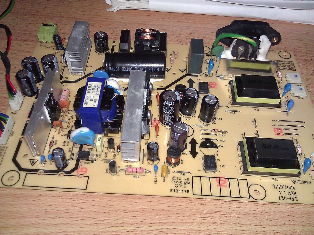

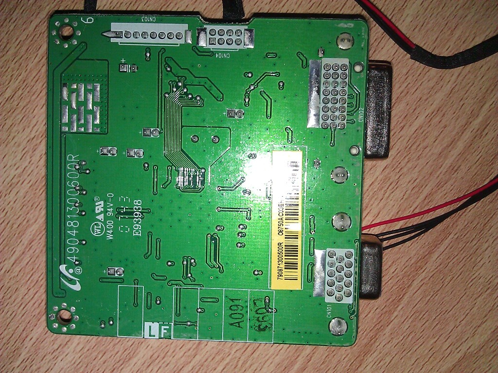

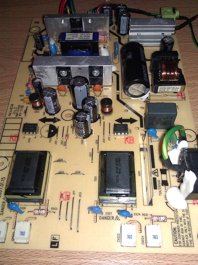

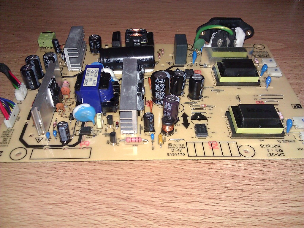

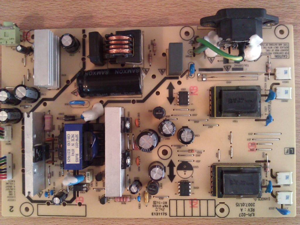

      Re: HP w1907 monitor blown(no power at all)

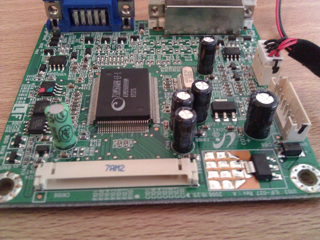

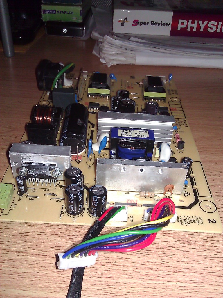

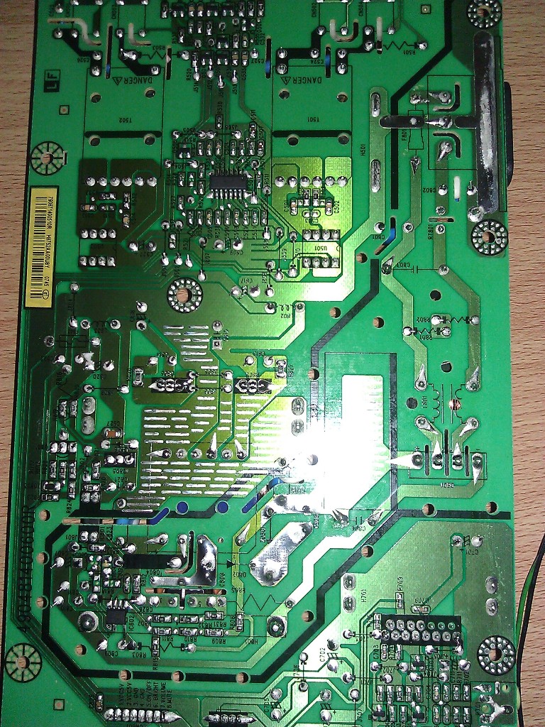

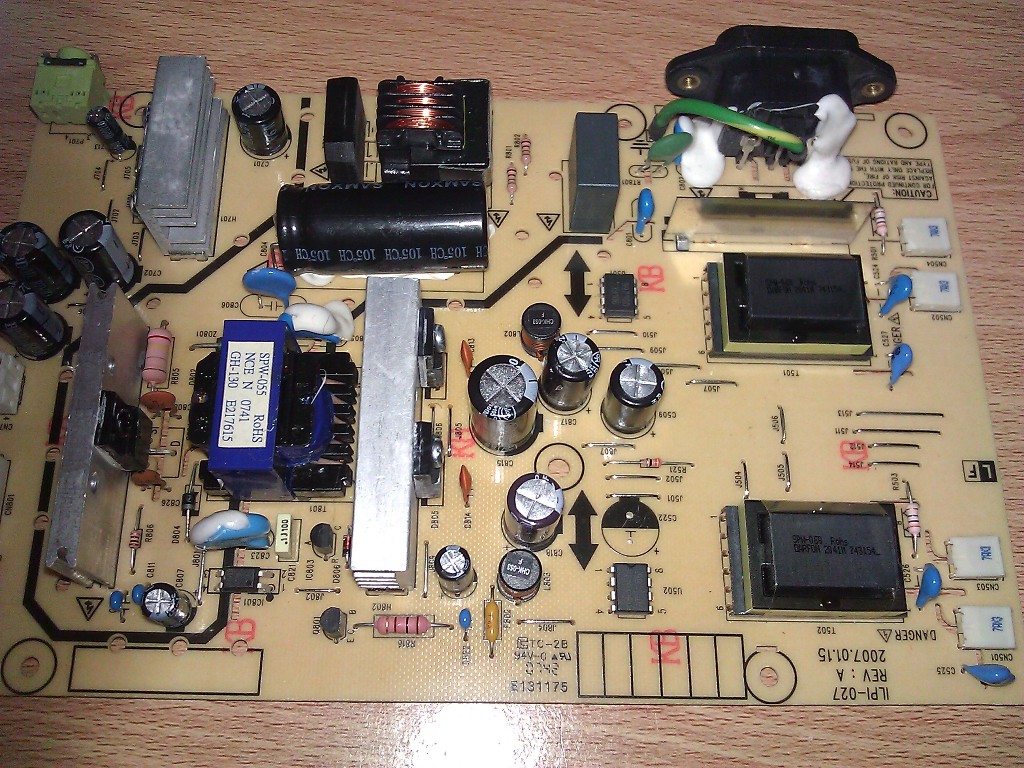

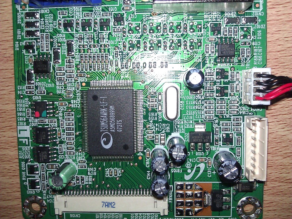

      These are the board pictures

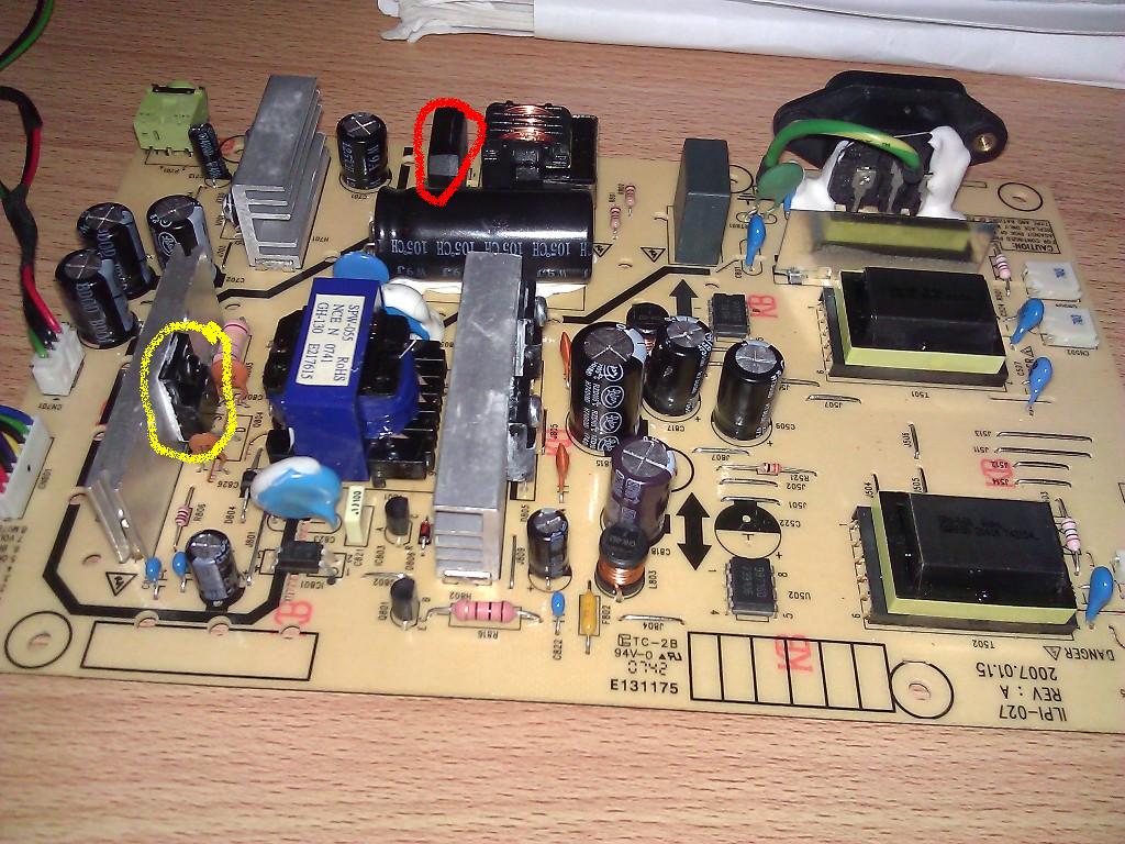

            Notice everything inside the black dark line is HOT including all the heatsinks when lcd is plugged in and power on.
            If you are going to learn electronics you should know how to read a pcb board.
            http://en.wikipedia.org/wiki/Electro...e_designations
            Red is your rectifier. Yellow is your power mosfet.
              I checked the bridge rectifier D801 and mosfet Q804 both in circuit.
              Rectifier
              1-2=4.86Mohm
              1-3=4.82Mohm
              1-4=177.7kohm
              2-3=1.768Mohm
              2-4=4.84Mohm
              3-4=4.86Mohm
              mosfet
              S-G=9.09kohm
              S-D=174.9kohm
              G-D=191.5kohm
              I guess the bridge rectifier and mosfet are not shorted.

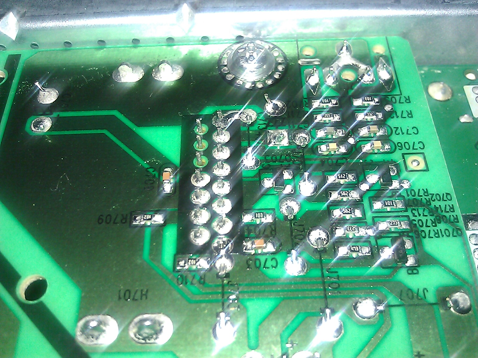

                  Amazing the power light(blue and amber) came on or worked when i plugged it into the power bar. Before there was no light or the monitor would not response. I didnt do anything to it. All i did was remove F801 and soldered it back. Hmm whats going on? Do you think its advisable for me to assemble the monitor with the lcd screen and try if it will work.?
                  I also found some solder joints that were never soldered and I don't know if it was accidental or intentional by the manufacture. I have attached a picture of it. It will be weird if accidental though.
