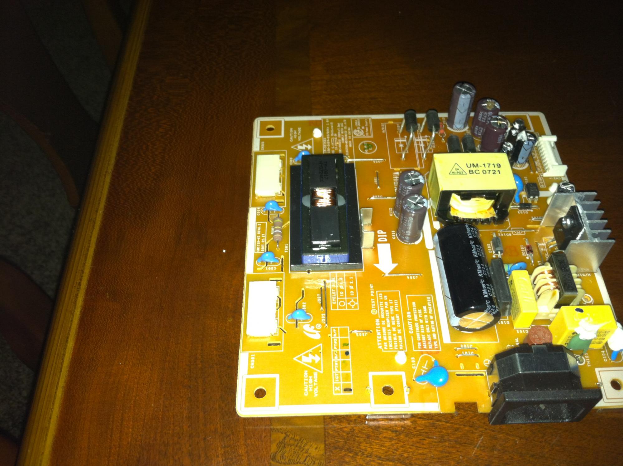

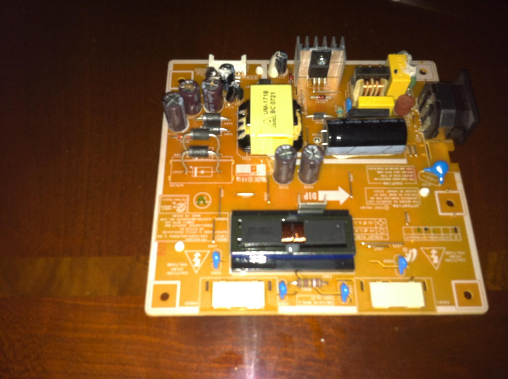

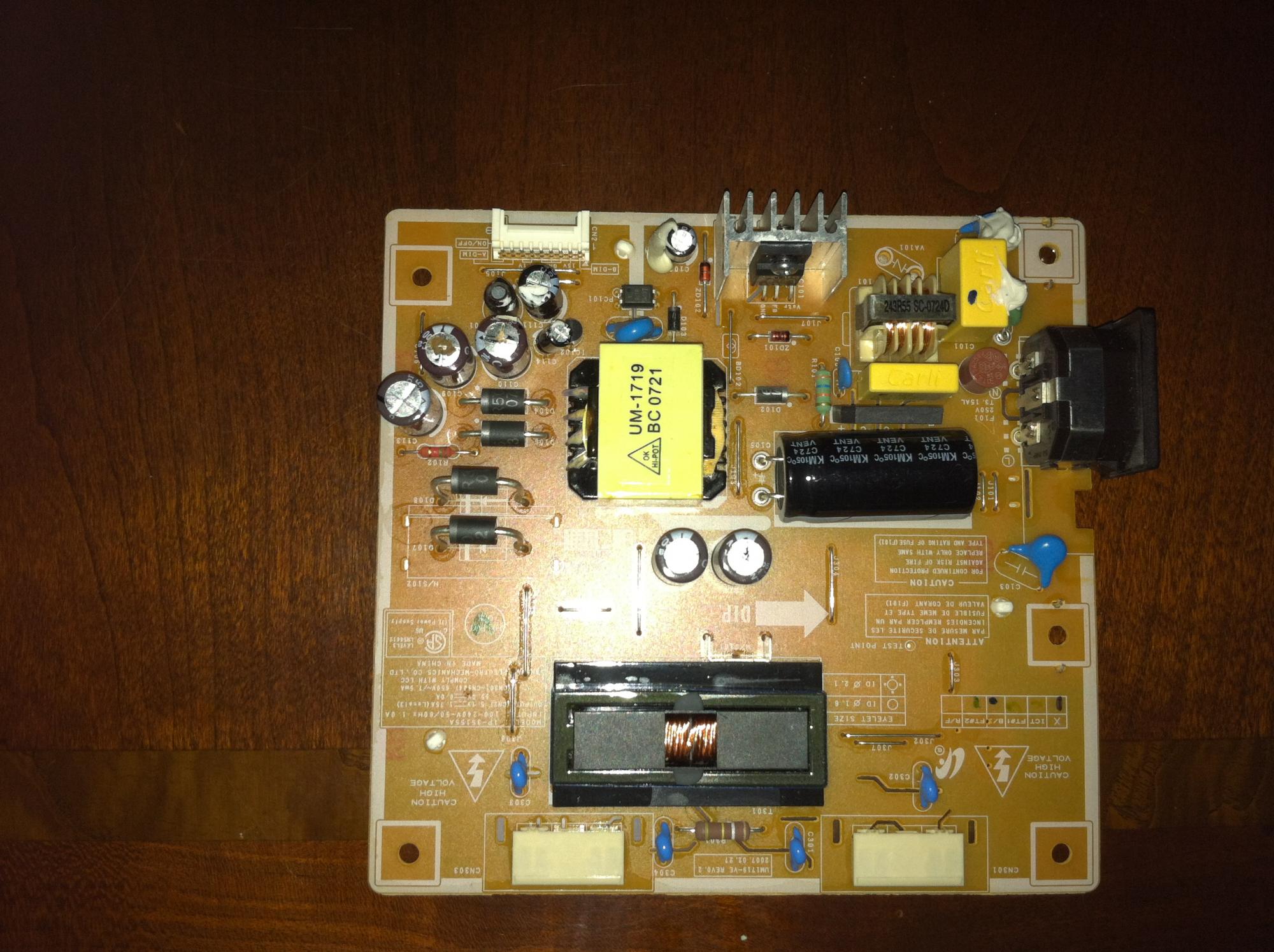

              I was incorrect. It is a 941BW, so thank you very much for double checking. I will upload pictures shortly.
              • alexsquared
                • Nov 2010
                • 40
                Re: Samsung 941BW
                Here are the pics.
                As can be seen, the caps in the Upper left of pic 2 and 3 show bulging/leaking caps.
