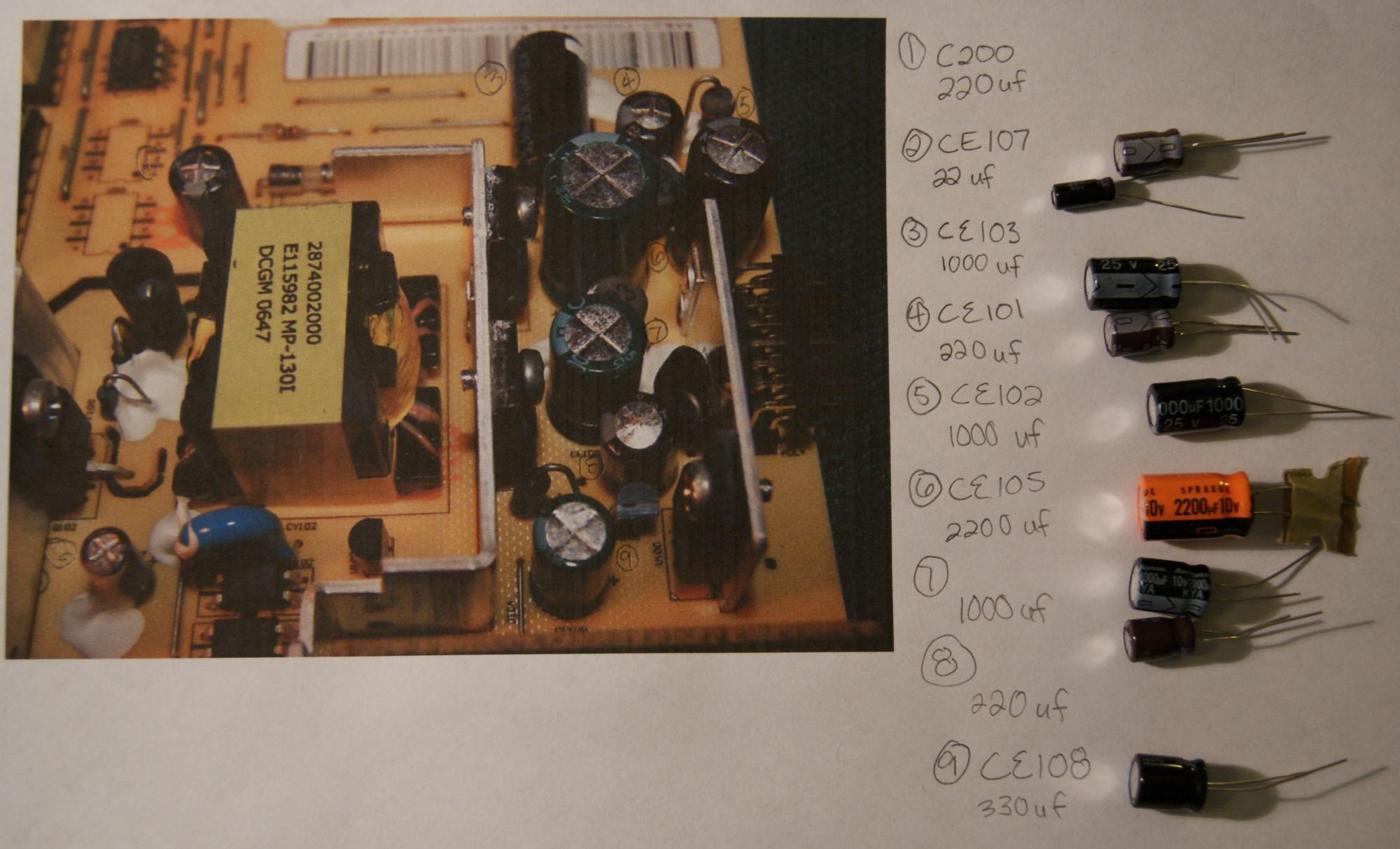

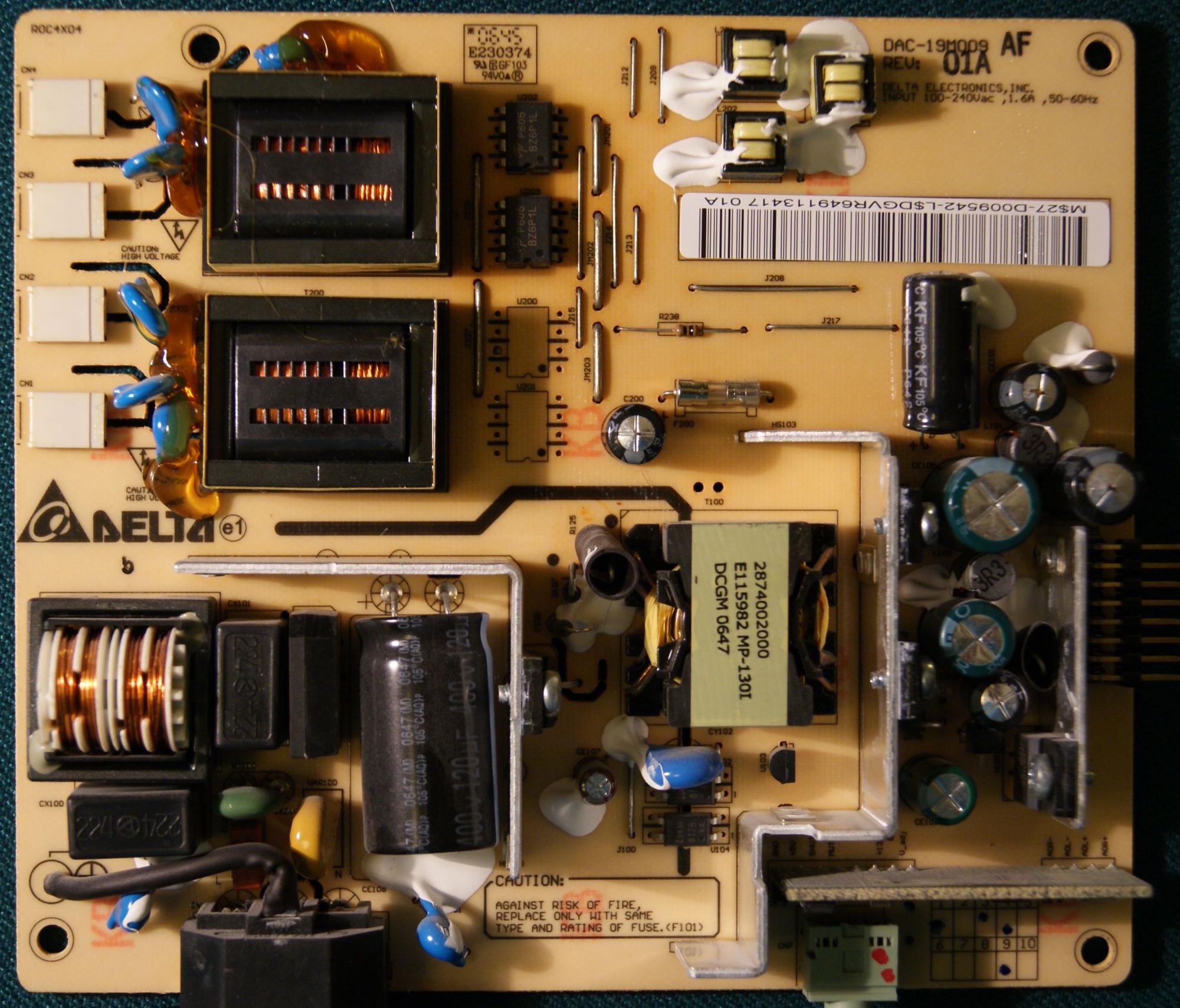

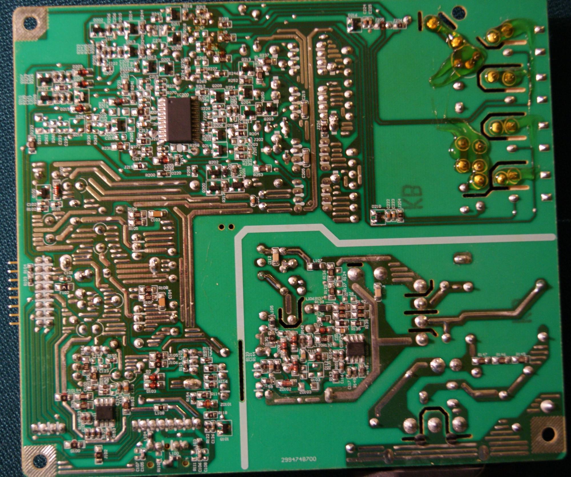

    Hello - this is my first time replacing caps and I'm wondering if there's an easy way to know where to solder on the back of the board? I don't see the matching numbers on the back as what's on the front next to the caps.
    DAC-19M009
    I'll take some pictures if that helps at all...
    Thanks in advance!!
    Some boards have it marked on the back others don't.
    If you are having problems do what I call spatial mapping, get a bright strong flashlight and shine it directly down on the cap that you want to change. Then look at it from the backside and mark which solder joints they are.
