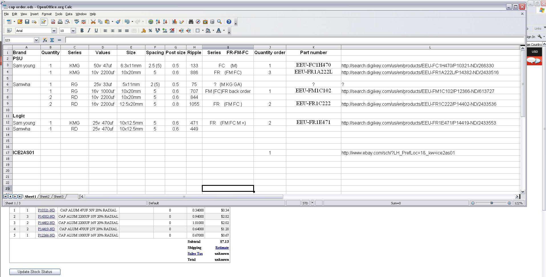

                          Anyone have a suggestion for what series caps to use to replace these? I see they are all general but they use two different kinds so must be different specs. I was going to try and find them all in panasonic and i think Fc was a good general cap. Might order a ICE 2as01 also. Or do you think my problem is some where else on the PSU?
                          PSU
                          1x 50v 47uf sam young KMG
                          1x 10v 2200uf KMG
                          1x 25v 33uf samwha RG
                          1x 16v 1000uf RG
                          2x 10v 2200uf samwha RD
                          2x 16v 2200uf RD
                          Logic
                          1x 25v 470uf samwha RD
                          1x 25v 470uf sam young KMG
                          http://www.samyoung.co.kr/download/miniature/KMG.pdf
                          http://www.soselectronic.com/a_info/...e/a/pdf/RD.pdf
                          I have some extra 25v 470uf rubycon ZL if they will work for either of the 2 on the logic card.
                          http://www.rubycon.co.jp/en/catalog/...minum/e_zl.pdf

                                  Can you recommend a good series match from panasonic for that cap and the others? I don't know how to figure out the ohm and ripple when they don't have it listed.
                                  It's $5 shipping if i order one or all of them anyway and never hurts having extra parts laying around. Unless like now none are of the same values i happen to need other than a couple and they are low esr i think. Hopefully that fixes it ,the last PSU i worked on was two of the sink mounted resistors that was bad.

                                      Well i found a PDF for the samwha RG on this site.HERE
                                      Seen the bottom number where it shows dimensions is the ripple so that helps.
                                      • junktv
                                        • Nov 2010
                                        • 3065
                                        #39
                                        Re: Dell 1800fp
                                        Does this look like it will work? I wasn't sure what to get for the RG 25v 33uf. It looks like they have a series M, KG and GA that are in the specs that i could figure out. Would one work better than the other?
                                        In my list the ones in brackets () are other series available. From column I left are the original specs.
                                        RG datasheet
                                          When ESR or impedance is not listed, it is a general purpose cap. The datasheet even says general purpose.
                                          So you want ripple at least 75ma or more. I would get this Pansonic one (75ma)
                                          http://search.digikey.com/us/en/prod...491-ND/2504580
                                          The rest look okay.
