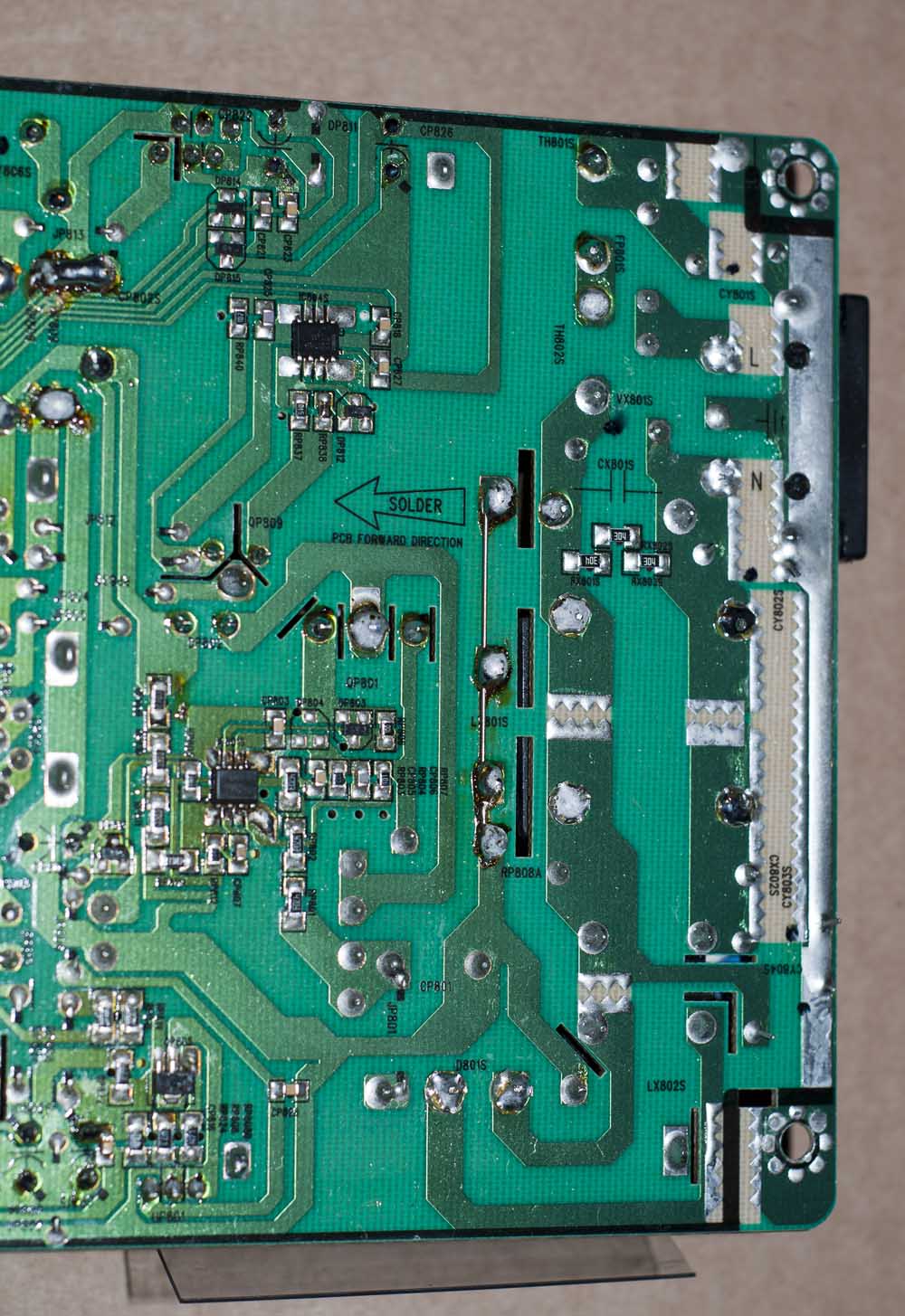

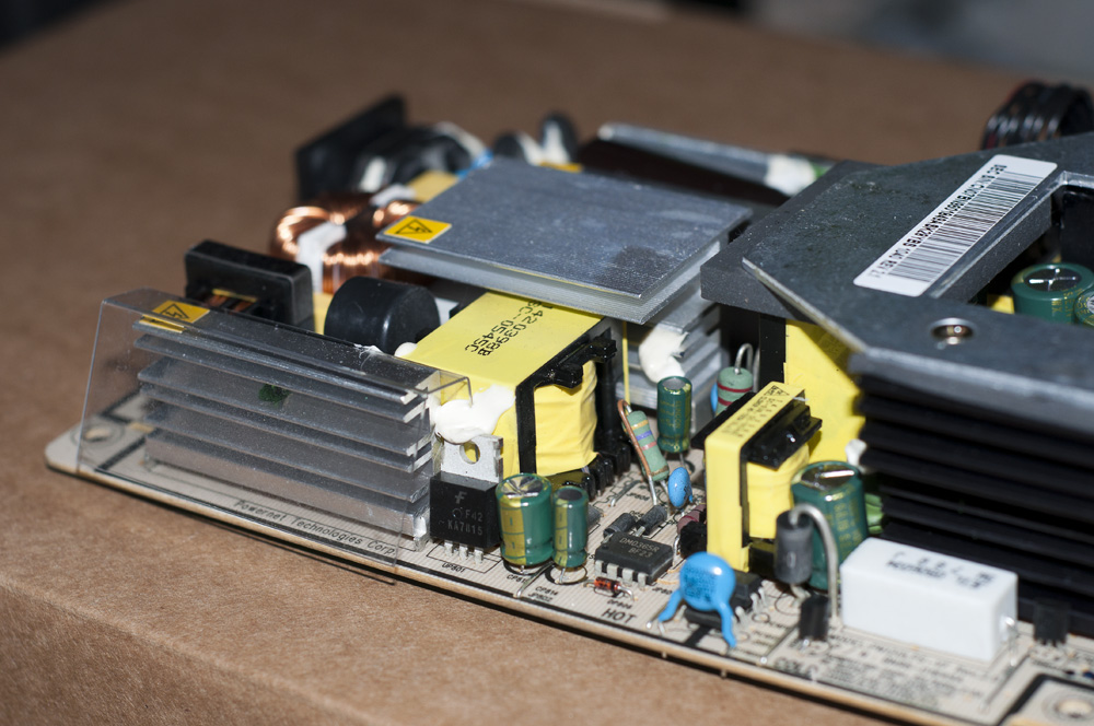

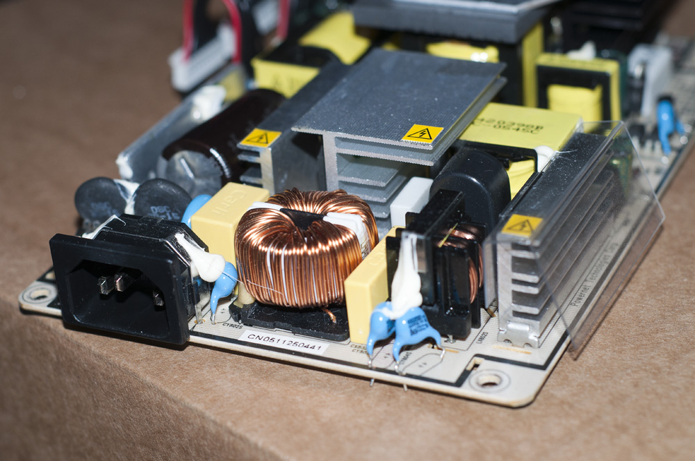

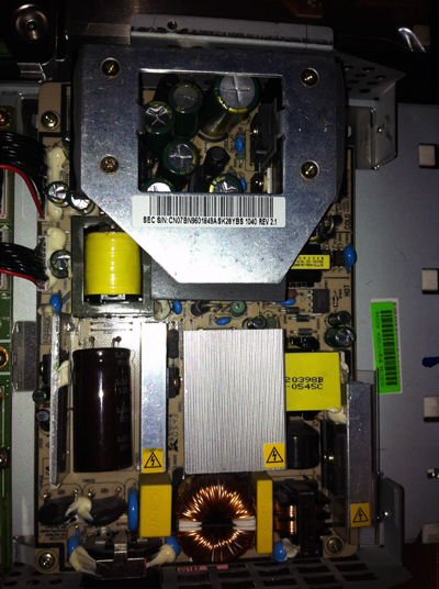

    Samsung 242mp PSU problem
    Samsung Syncmaster 242mp
    PSU model: PN120LPS-VF rev 2.0
    Code: BN96-01849A
    Mainb model: P024FS
    Code: BN41-00552C
    Description of problem/defect:
    Monitor works fine at all inputs if leaved unplugged for 2hrs+, until power off. It will not power up again unless it has been unplugged for those 2hrs.
    What i have done/measured:
    Changed a bunch of caps (bottom leakage). Reheated/solder entire PSU. All this whitout any positive effect.
    Measured at full function:
    392v at big 450v/150uf cap
    24v to inverter
    12v and 5v to main
    all ok
    Measured when refusing to power up:
    306v at big cap
    18v to inverters, slowly dropping to zero!
    12v mainb feed measures zero
    5v mainb feed is fine.
    I have not been able to find any schematics for the PSU. I have very little knowledge of how such PSUs work.
    Supplied form wall is 240v/50hz.

    Re: Samsung 242mp PSU problem
    Hi I have been unable to upload the Pdf but the manual is here
    Its very impressive and lots of tests.
    Can you post a picture of the underside of the board
    Voltage at the Big Cap is too low when not working - did you change that?
    Whilst it fails less often than smaller caps it is between 2 heatsinks so may be
    "cooked" What make is it?

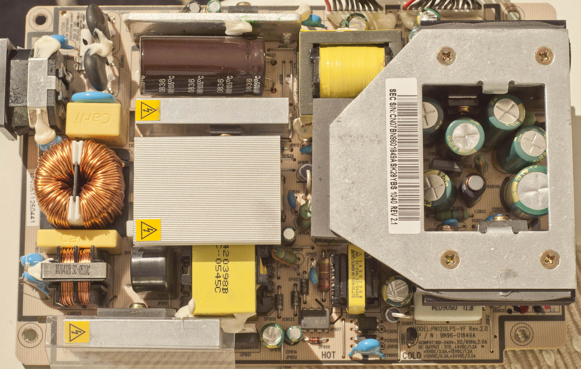

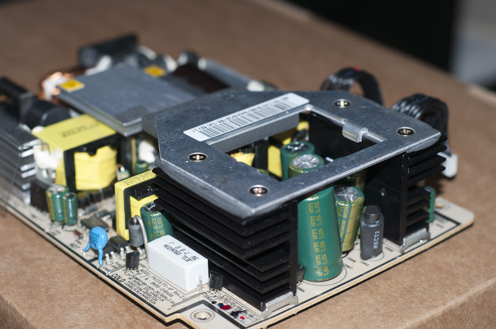

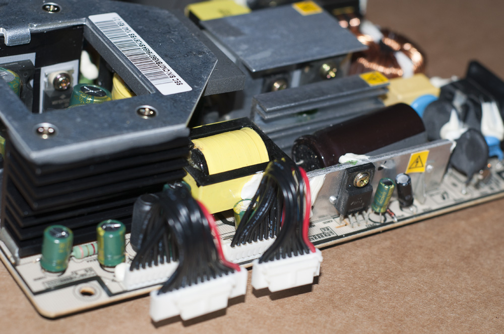

        Yes i can fix a underside pic tomorrow. Actually i changed the 450/150uf with one taken from a samsung 32" as it is a little stupid place to put a cap on, lots of heat there.... But same readings with both caps so there is something else messing it up. don´t know what make it is as typing, check tomorrow.
        • Jont3
          • Jan 2012
          • 24
          Some joints look "cold" but i belive it is the original "solder wire" charactheristics, they have been reheated by me.

            • retiredcaps
              • Apr 2010
              • 9271
              Where did you buy those Suncon caps with the "X" vent? If ebay, there is a good chance they are counterfeit/fake which might be part of the problem.
              The Sanyo/Suncon caps should have a "K" vent like the smaller caps by the black/red connectors in your first photo.

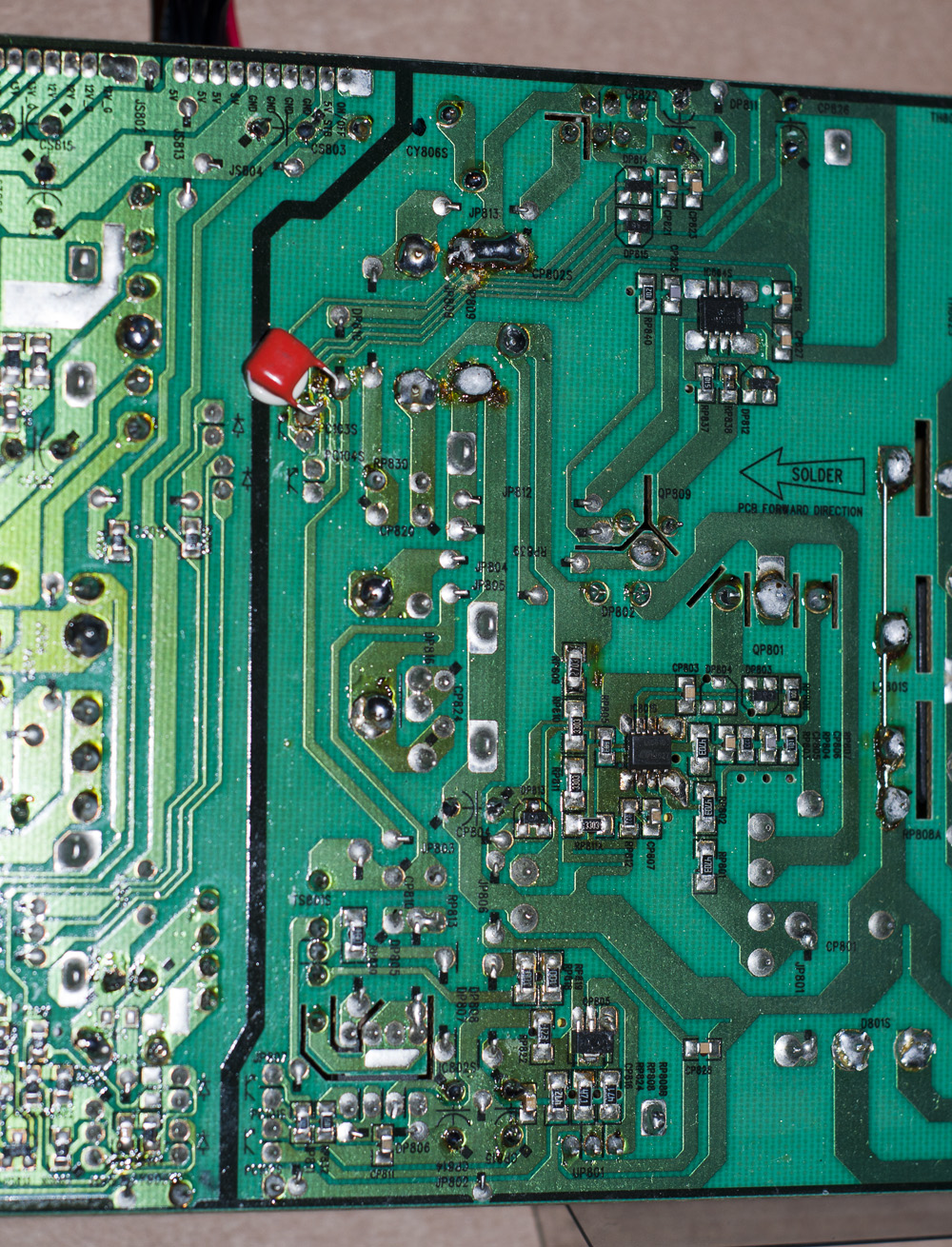

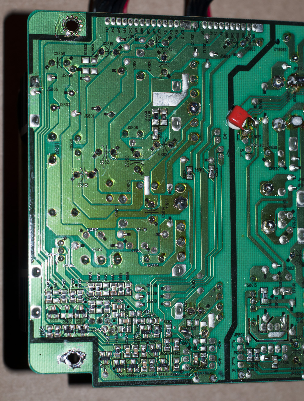

              • retiredcaps
                • Apr 2010
                • 9271
                Originally posted by pe9ghz
                The absence of even the 5V stdby voltage, makes me think it must be one of the SMPS management IC's or the power FETs, but I also don't have a schematic diagram, which would be really useful for further diagnosing. Right now I have no clue where to look.

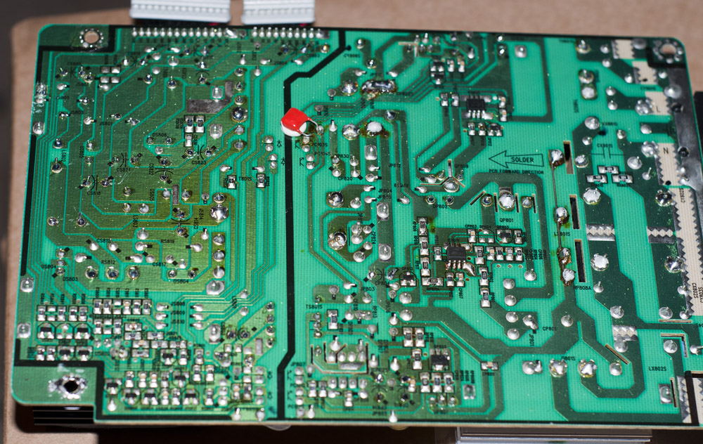

                Start by looking at the multipin ICs (like 8 pin) and looking for its datasheet. Once you find the correct datasheet, they might have a "typical" application circuit diagram that shows an example schematic.
                For example, looking at the pictures, it might be IC604S on the backside because it is close to the AC plug. What is the part number of that IC?

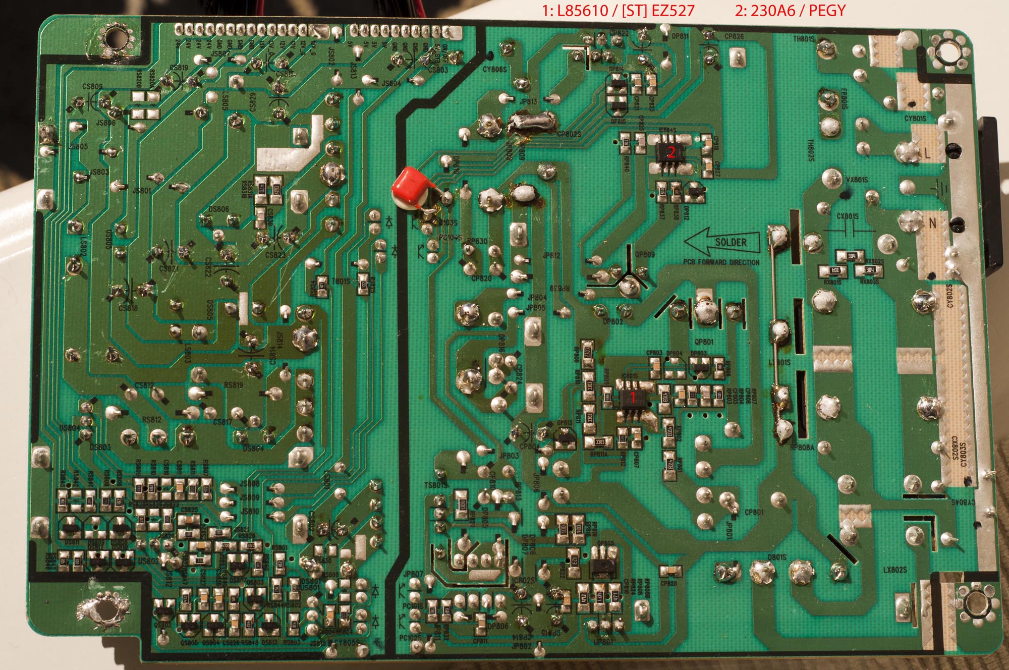

                    • pe9ghz
                      • Jan 2012
                      • 13
                      Thanks,
                      IC804S (hard to read from the pictures) has a marking 230D6 (SOIC8).
                      Some others:
                      IC801S = ST L6561D SO-8 Power Factor Corrector PDF
                      I'll study the application note and try to compare it with the actual PSU board.
                      IC802S = DM0365 (probably FSDM0365RN - Green Mode Fairchild Power Switch) DIP8.
                      This could be the regulator for the stdby_5V.
                      • selldoor
                        Slow Learner
                        • Dec 2010
                        • 7870
                        Probably attached?

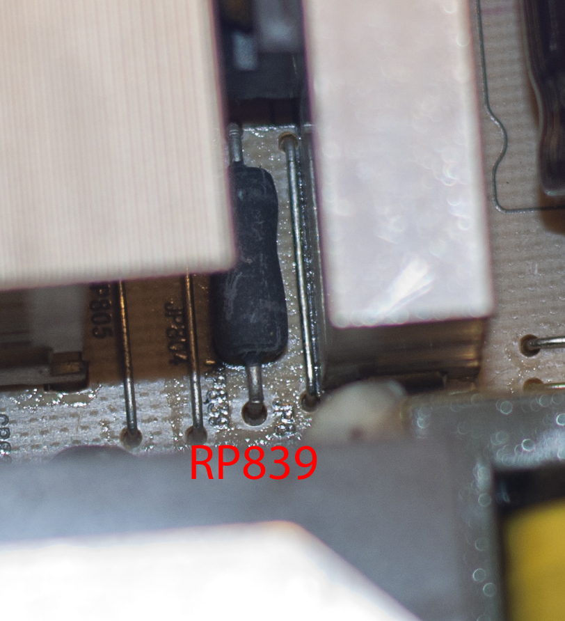

                          Also noticed a component RP839 (see pictures), doesn´t it look a little to black? from heat maybe? I just stick to the cold/secondary side of electronics, this hot/primary side PFCed stuff is not my area. Right now i´am lost.....
                            Your RP839 looks the same as on mine.. Black body power resistor. It has a (faint) marking: 8.4Ohm, maybe.
                            • pe9ghz
                              • Jan 2012
                              • 13
                              Originally posted by selldoor
                              Probably attached?
                              Thanks! that must be the right datasheet NCP1230
                              • retiredcaps
                                • Apr 2010
                                • 9271
                                in standby mode 311V
                                No function:
                                309V
                                Since your bridge rectifier is 311V DC when standby and 309V when not, the 2V DC difference is not significant. So I believe your rectifier is okay. 311DC /1.414 = 219.9V AC.
                                When the lcd is on, the PFC should be around 392V DC as you first reported back in post #1.
                                Refer to datasheet found be selldoor.
                                On NCP1230, it looks like pin 1, PFC_Vcc, controls the PFC chip. Figure 29 shows how everything is connection in a typical application. If everything is working correctly, pin 1 connects to pin 6 (VCC) and provides bias to the PFC controller. In standby mode, the PFC_Vcc is not active. PFC_Vcc is also shutdown when a fault condition is found.
                                Pin 6 is enabled when the voltage is between 11.6 and 13.6 with typical being 12.6V. The startup capacitor is recommended to be at least 47uF according to the paragraph just under Figure 38.
                                There are many possibilities, but I'll just point out some that I would check first.
                                1) Check the startup cap. If it has not been replaced and you have a quality cap, it is easy to change out. These little caps can be bad without bloating. This cap may be 47uF 50V and is nearby NCP1230.
                                This is also a good time to mention that if some caps were visibly bulged, most here would recommend that you replace all the caps unless you have an ESR meter to check the uF and ESR of originals.
                                2) When the lcd doesn't work, check the DC voltage across the startup cap. It should be at least 11.6V DC and steady.
                                3) If the startup cap is good, then check NCP1230 pin 6 (pin 4 is your GND). It should be around 12.6V and steady. If it is not 12.6V, there are a couple of components in figure 29 that could be at fault like a diode. Or the NCP1230 chip itself could be bad.
                                4) If pin 6 is at 12.6V, then check pin 1 (pin 4 GND again) and see if it is working and sending the info to the PFC chip.
                                PS. Great clear focused photos. It took 3 tries, but this is by far the best because I can read everything clearly.
