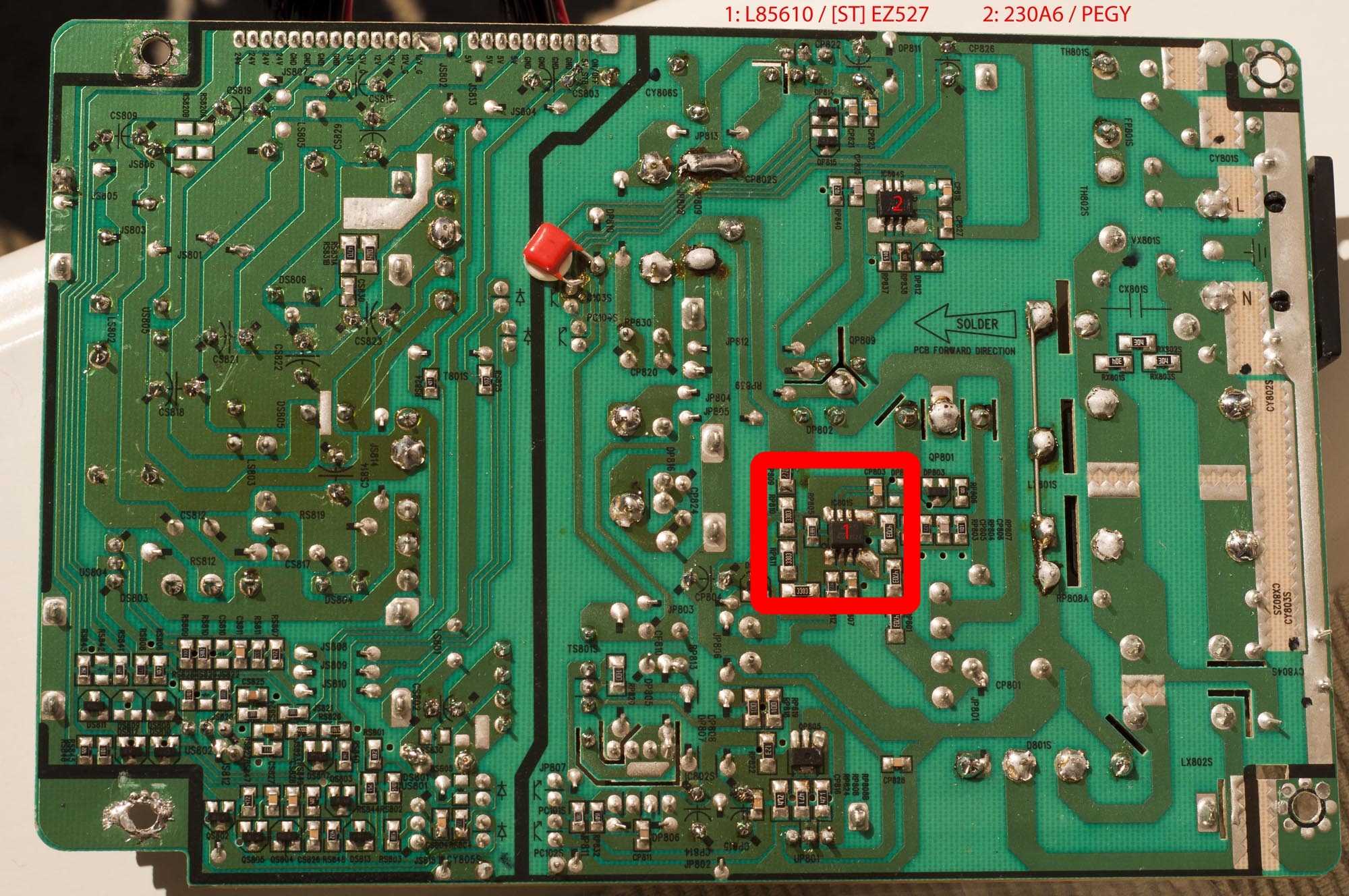

                                          please any one can tell me what is this Ic (with the red color square) number ?
