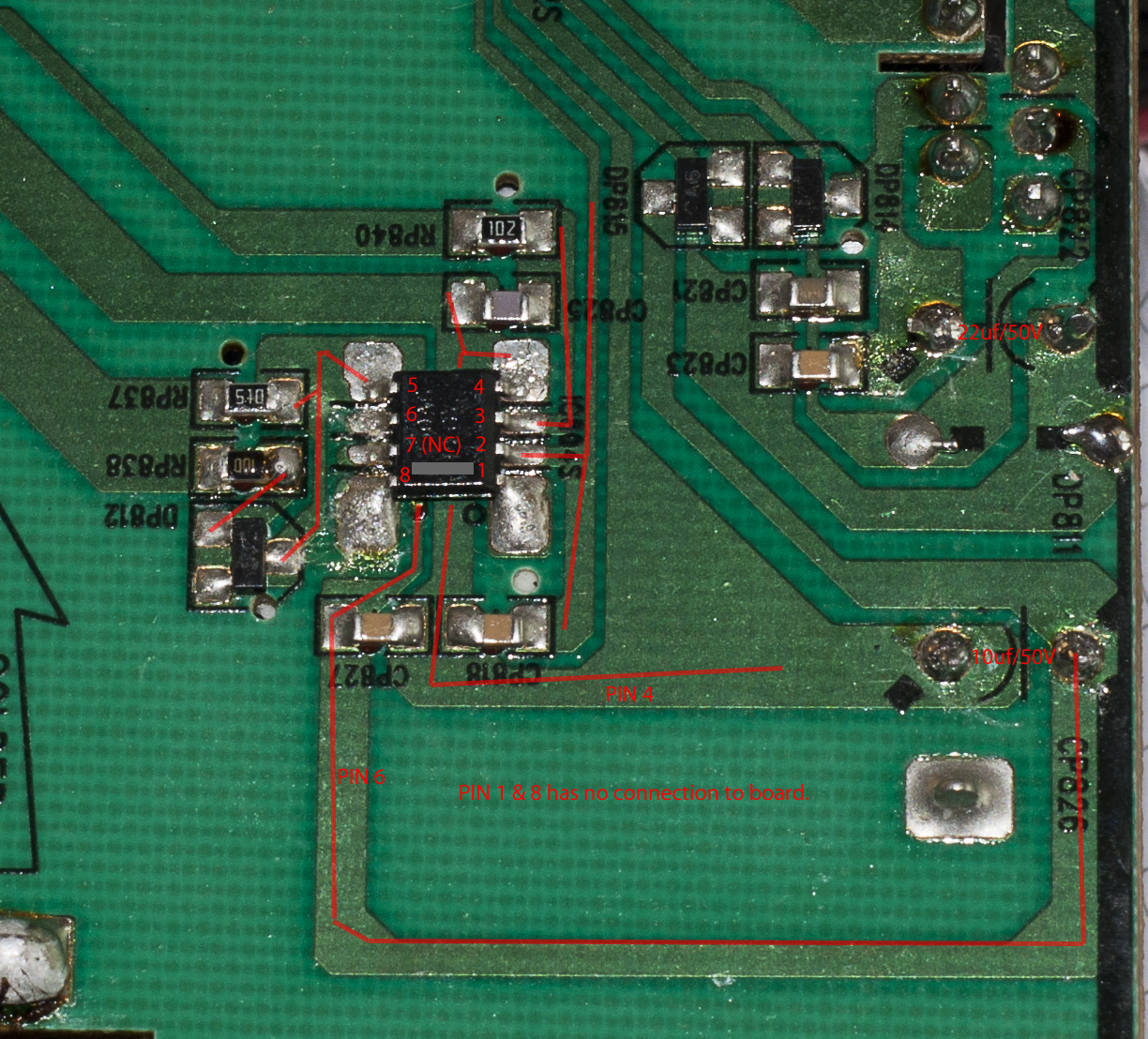

    Maybe i should be more clear as the CP822 & CP826 read 0V when not working.

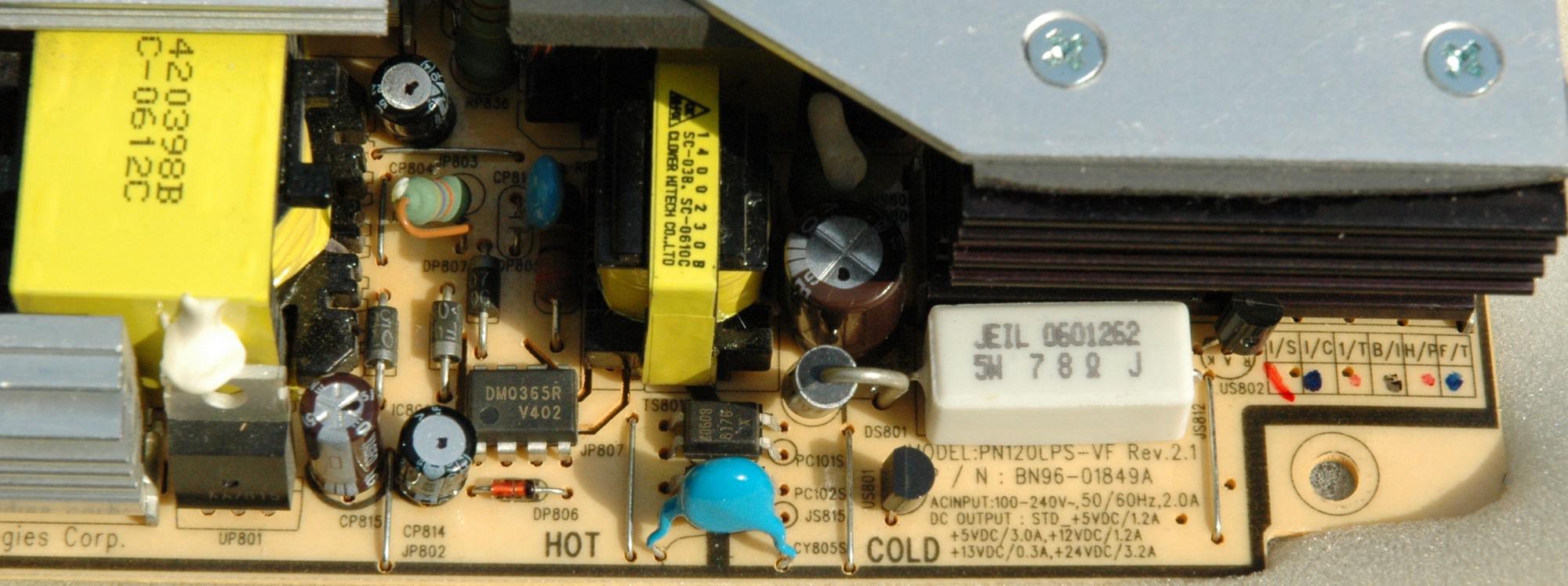

      @pe9ghz Please can you post a picture of the bottom of your power supply board. Rename it pe9ghzPSBTM.jpg so we will know it is yours.
      Please can you also check the values of your small caps & see if you have a 47uF 50v in there.
        Re: Samsung 242mp PSU problem
        I would like to see the p/n number & revision ver to, since "mine" seems to be somewhat older and they could differ. I mailed samsung trying to get a schema for it, was redirected to convena who said there is no such avalibe, could order a spare from them but that isn“t all that fun, is it? :P

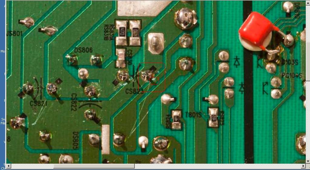

          I have been looking at the soldering again and attach a picture for you check.
          In the small section there is a blob which may just be on the surface or may have burnt through to the trace or it may be it should be there connecting something through the board. The resoldering within the large section may or may not touch the blob - does it and is it supposed to?
          There are other bits as well which might need looking at - the rectangular blob (I think its the heatsink?) near the CP802S marker - probably just flux over the nearest trace but can it be cleaned off. Also the red component has a
          whisker of solder on it - can you check its not touching anything you think it shouldnt. Looking at the board the middle of the "low voltage side" looks like it has been running hot so I would be inclined to recheck the soldering
          in that area for a cold joint.
            Originally posted by Jont3 View Post
            Not working:
            8-4 0V, 6-4 0V, 1-4 0V
            Working:
            8-4 0V, 6-4 14,5V, 1-4 14,5V
            It seems like pin 1 and 8 is not connected anywhere on the board, can it be another config than the one in figure 29?
            My interpretation of the datasheet is that when the lcd is working pin 8 is turned off to save energy. Pin 8 is there for bootstrapping. See page 17, startup sequence.
            A simple test can verify if pin 8 is connected or not.
            1) Turn the power off and unplug the lcd.
            2) Wait 3 minutes to let the large capacitor discharge.
            3) Verify with your multimeter on DC voltage that the large capacitor has 0.0V voltage.
            4) See if pin 8 has "continuity" or "beep" with the positive leg of the largest capacitor.
              I“ve like tripple checked this since i posted the pictures, and did so again. it should be ok, and "beeping" (at right places) when tracing on board with DMM. There is no short its just flux and removed now.
              Lcd been unplugged over night when measuring, 450V cap 0,0V, No "beep" between pin 8 and 450V positive leg. Pin 1 & 8 does not have any trace on board (see picture). There is no wire trough board from "chip side" related to pin 1&8, since chip is located otherside of the 450V cap it is easy to check if any wires comming trough.
                      I finally could take some pictures of the PSU board today.
                      I didn't want to scale them down (and loose sharpness), so I host them on my website (I hope this is OK):
                      I've searched the board for any 47uF caps, but there aren't any. Biggest ones are 22uF/50V:
                      CP804 22uF/50V at pin8 of IC801S (L6561D)
                      CP814 22uF/50V at pin2 of IC802S (FSDM0365).
                      CP822 22uF/35V at pin3 of IC803S (DM0565R).
                      I've also traced that the (15V) Vcc of IC801S (L6561) (pin8) and IC804S NCP1230 (pin6) are both obtained from UP801 (KA7815) which has a 100uF/35V near it's input.
                      The NCP1230 has a 10uF/50V between pin 6 and ground.

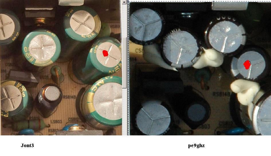

                          Evening chaps - thanks pe9ghz for the pictures and additional info. Looks like your board is a later revision. UnfortunatelyI dont know what the additional info means but perhaps it will help Jont3 .
                          What I have noticed is that one of you APPEARS to have a cap in the wrong way around, see attached.I get positionally challenged (aka lost) working from photos and trying to visualize where things are back of boards to front so ive not tried to prove my theory. Perhaps you can look at your boards and physically check if the diagram on the back of the board doesnt match the stripe on the cap.
                          What is odd is that I believe they usually pop if inserted the wrong way so maybe it is just another board variation but hopefully it will be good news for one of you.
                              Naah, mine is right. The darker half circle on pcb i minus. Ooh yeah.... They pop and smoke

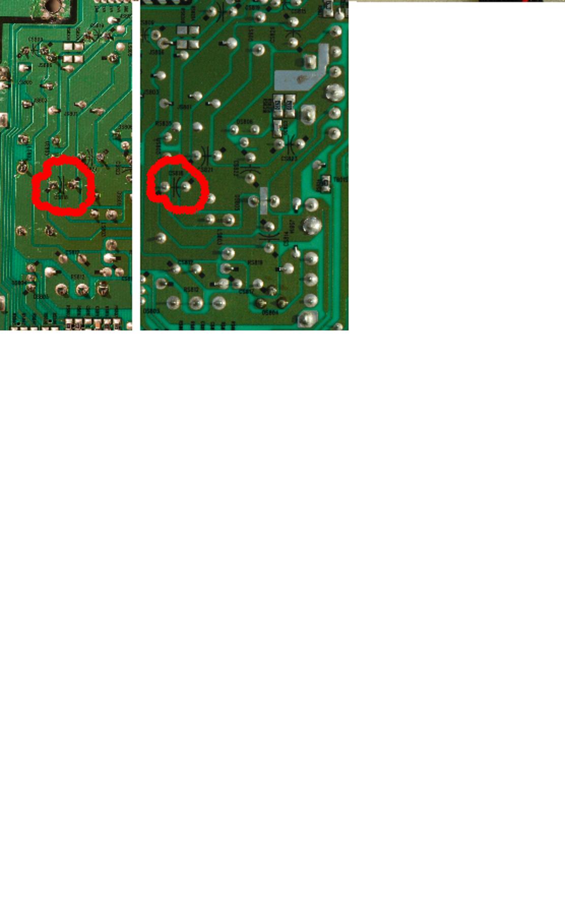

                                    Hmm not sure it is the printing as I guess both sides differ - I dont know enough about circuits - how can they just change a cap around or are there some other major changes that I cant spot to make + - and - +
                                    Attached pic of back with Caps marked.

                                        #39
                                        You really got the eagles eyes, thats a really good thing i think. This is a revision diff, but thanks!
