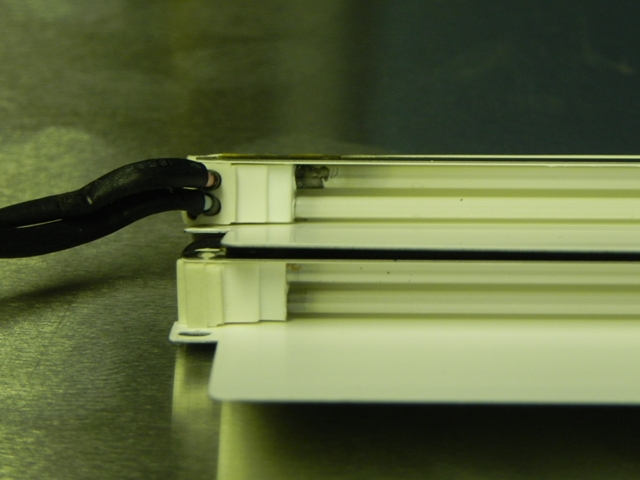

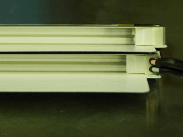

            OK, thanks for the links to the educational material. I read through and performed some tests on the board components....hoping to find a problem without tearing down the screen assembly to look at the ccfl's. I could not find anything wrong-everything seems to test A-ok.
            Sooooo, I started the tedious process of tearing down the screen, it is a pretty delicate assembly. I got the ccfl assemblies out and guess what I found? It looks like I have some bad ccfl's.
            Any recommendations as to where is the best place to find some replacements? The assemblies have some numbers printed on the backside of the metal shrouds they are:
            HWVO (printed in the center)
            9408BDF W19X (printed on the wire harness end)
            by the way, I think I figured out how to properly attach thumbnails to the post....

              Only the top one looks bad to me. Alexanna is the king of this type of repair.
              Members here have good experience with ccflwarehouse.com.
              You can call them and talk to a live person who will help you get the correct replacements. You can buy them "bare" or "pre harnessed". The latter is easier to replace, but more expensive.
              If you order the bare ccfl, they have a tutorial at
              http://www.ccflwarehouse.com/lasotu.html
              As you can imagine, replacing the bare lamp is a very delicate and fragile operation.

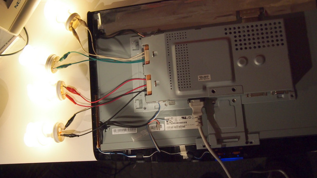

                Hello Brian D,
                I have a 2233sw with the same PCB has your's. I am now about 100% sure it has a bad CCFL.
                I checked the inverter impedance secondary and primary and they look ok; (off board)
                Replace all the caps with quality caps (except the large one);
                Checked the inverter output with CFL lamps (13w) and they all light up and stay on (picture included);
                So my next step his to check the CCFL's. How did you proceed to confirm what CCFL was at fault? Tear down the screen and just take a look at them?
                Thanks.

                  Yes, plug in the ccfl plugs one at a time keeping the others plugged into your cfl. It could also be a faulty wire to the ccfl or a failing ccfl.
                  Then carefully take the screen apart.

                      Thanks for the replys,
                      I connected the CCFLs one by one while keeping the 3 other secondary outputs connected to a CFL. For one of the CCFL's the monitor will go 2 sec to black (2secTB). I guess that's the faulty one (wiring or lamp).
                      Just curious, for the 2secTB to kick in do you know if the system detects any load imbalance or does it take a absence of load on one of the secondary outputs. Hence I have all 13w CFLs but what if I had a mix of CFL's, 11w 14w etc.
                      Another question, does it make a difference on what secondary output the CCFL are connected if the secondary outputs have the same specs.
                      Next step is to get to the CCFLS. Before I do I will clean up the work bench and get the camera. Help's when reassembling.
                      Thanks.

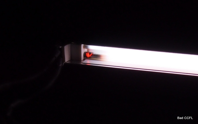

                        I got the CCFLs out, they are bundle in pairs (2 X 2). One of them seems bad. It does light up but has this pinkish color.
                        I switch the CCFLs position on the transformer secondary's with the same result, still the same pink color.
                        But after cycling the ''on/off'' many times, the bad CCFL lit up ok and has the same white colour than the others CCFLs !
                        I'm testing it right now, it's been on for 10 minutes with no ''2 sec to black'' but I expect that it will eventually go bad. Reminds me of CFL tubes that sometimes won't ignite and then you get them going but only for a short time.
                          Re: Please help with a Samsung 2233SW monitor.
                          When it is pink it is bad, after it heats up then the lamp will glow white, you better replace it before it takes out the Inverter transformer.

                            Attached is a picture of one end of the bad CCFL. There's this ''hot filament'' (that would be the electrode) which look's abnormal...
                                When the lamp is bad, it will glow like that (and sometime when it is really bad the glass will crack or deformed, and solder at the end of the tube will be crystallized and wire and the silicone boot will be over heated), there is no filament in the CCFL.
