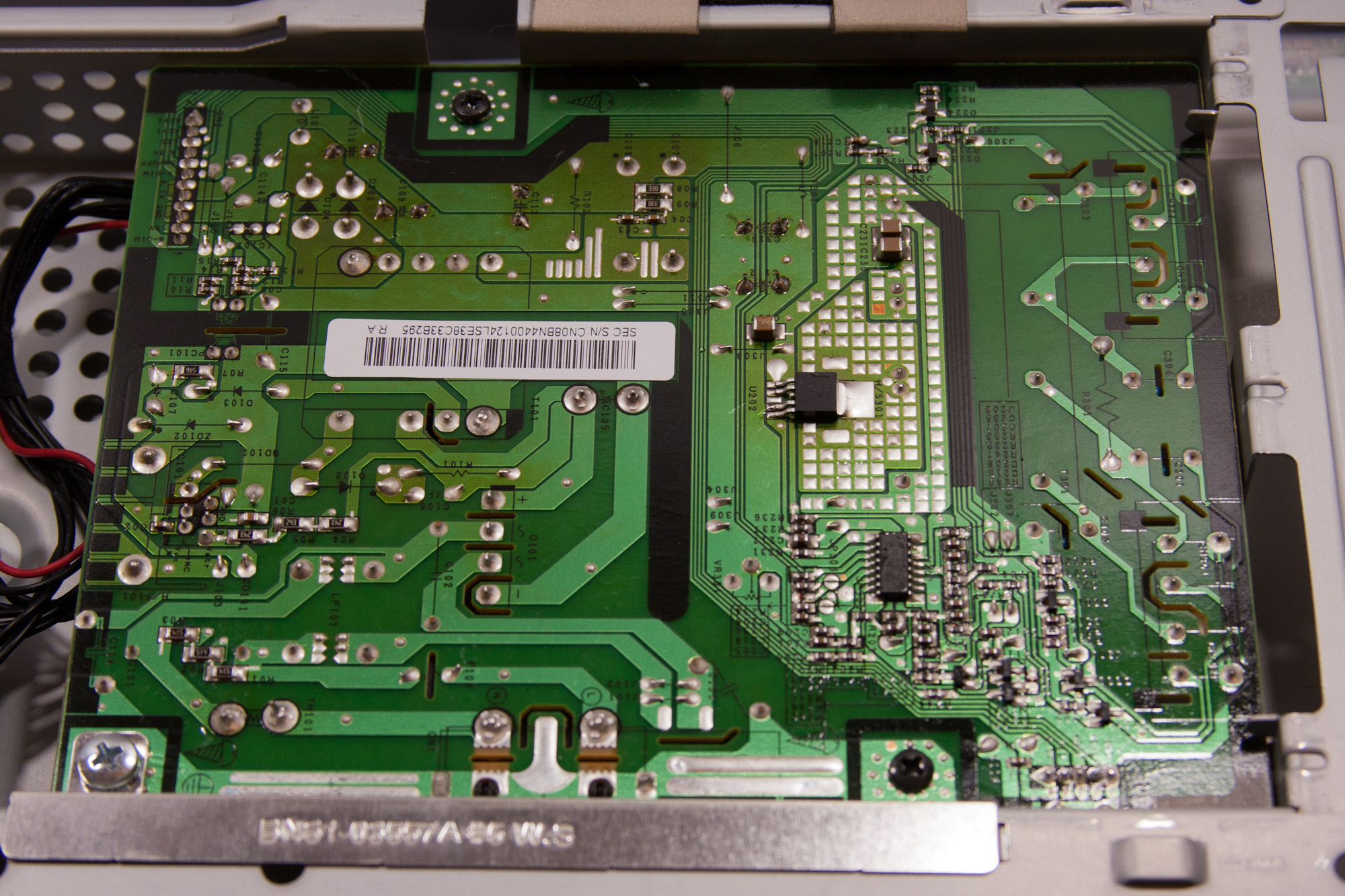

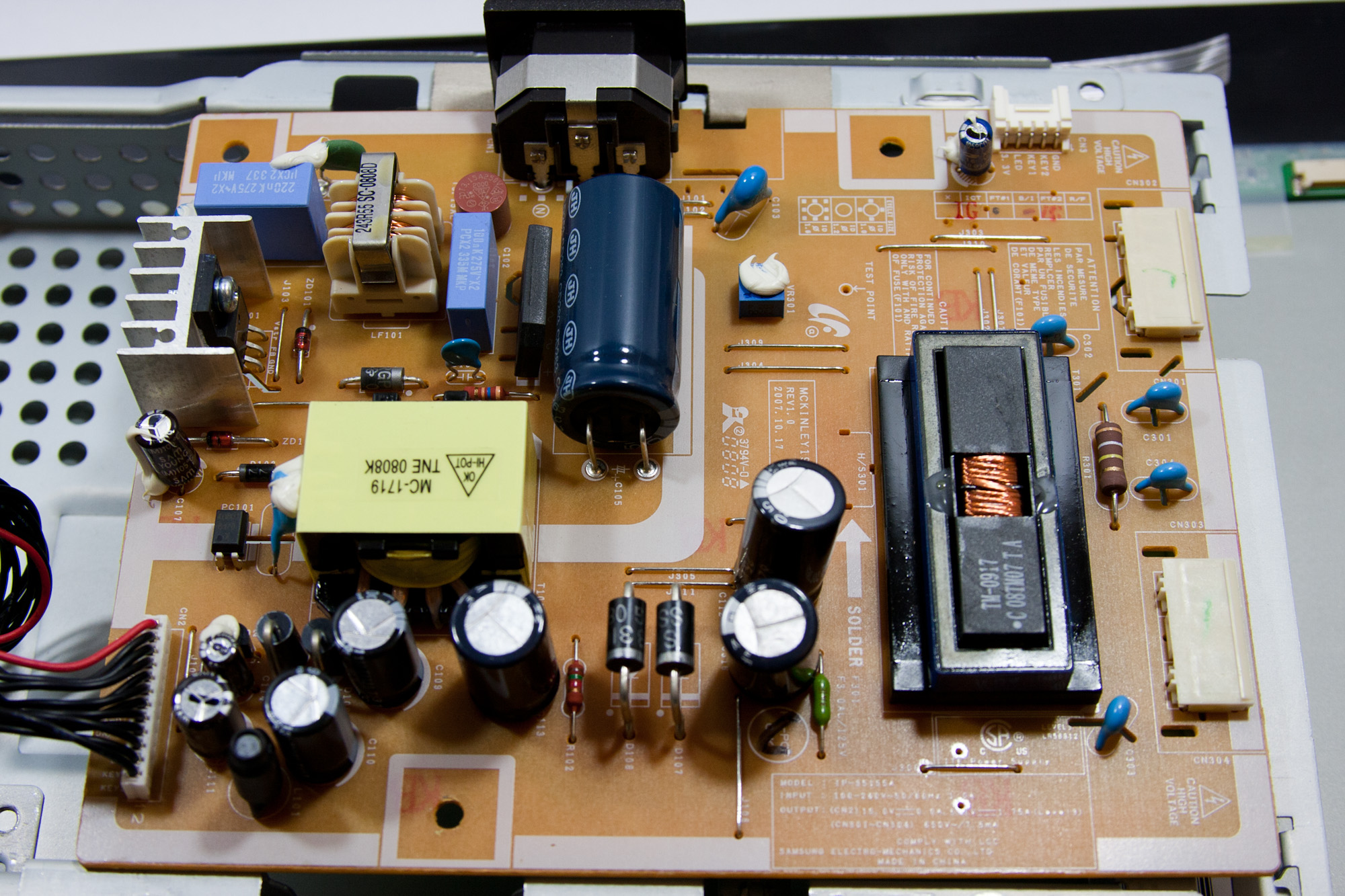

        Okay,
        So I recently acquired ANOTHER one of these monitors so I have two of these to repair, each w/ it's own issue, so we'll just start with one.
        The first one had bad caps and wouldn't power on, so I replaced the caps and now powers on, but it turns the display on and off for a few seconds and then it will stay on. It also makes high pitch noises when it does this. (Video below of what happens)
        http://youtu.be/aO7aGVPB_kU
        • retiredcaps
          • Apr 2010
          • 9271
          Re: Samsung SyncMaster 953BW
          Well I noticed you replaced most, but not all the caps so there still could be problems with the original caps.
          That sound could be the ccfls high voltage arcing?
          PS. Those are great photos.
                I replaced what I could but still getting that sound, it seems to be coming from the lower right corner where the cluster of caps are. Maybe I got a new 'bad' cap.
                I'm half tempted to start board swapping between the two to at least get one good monitor working.

                      By this, I assume the power board that produces a strange sound has a faulty transformer. With a multimeter check the values on secondary side, this will help you with the values :
                      http://www.4shared.com/photo/LDJ9GV_...Schematic.html
                      Probably you have to raise the transformer from the board to get accurate values.
