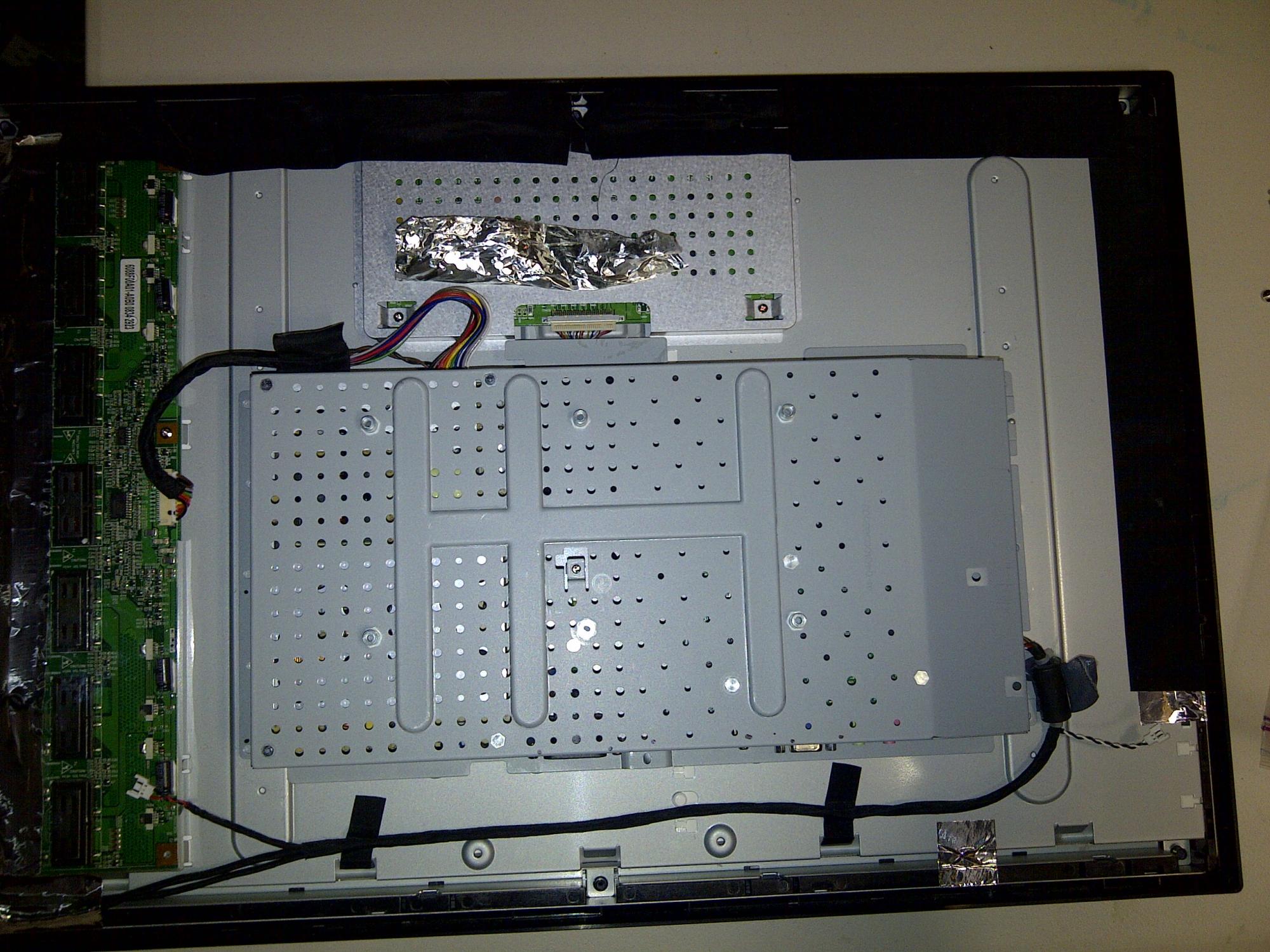

    I opened up the monitor and looked at the boards inside.
    I took a photo of the main board that the HDMI and other connections go to and a second board that the display itself appears to connect to.
    I did not look at the power supply board since it powers on and can show each of the colors brightly. I did take a photo of the bottom side of the power supply board since it was exposed.
    I don't notice anything burned or discolored. The monitor worked great for years I had it. There were no signs of degraded performance. It was working like new until it stopped working. :-(
    If you have ideas of what I can check or probe, I would be most appreciative. Unfortunately, all I have is a multimeter for test equipment.
    Also, please let me know if the photos have too much reflection. I can take them at an angle next time.

    Re: HannsG 281 Monitor doesn't display video
    With your meter set to DC volts (use 20V scale), try measuring each pin of U7 and U8 (located in the upper left of your photo). One or both of them are voltage regulators. Report your readings. And you mentioned pushing the "top button". Just exactly what is that button supposed to do?

            Good morning!
            With a fresh pair of eyes, I reconnected the cables (except speakers), including the case switch.
            Two corrections on behavior:
            When I apply power to the Monitor (turn on power strip or plug in power cable):
            The Power LED is OFF
            1) When I press the POWER button,
            a) the power LED goes to BLUE
            b) the screen is black
            c) after about 7 seconds, the screen lights RED briefly (less than a second, I can see the back lights come on)
            d) the screen goes black and the power LED goes to AMBER
            2) With the power LED AMBER (STANDBY), Pressing SW4 (the AUTO button, NOT the MENU button as I previously reported)
            a) The power LED turns BLUE
            b) screen lights RED, then GREEN, each for about a second, then BLUE (for maybe half that time)
            c) the back lights turn on during the screen color cycle
            d) the power LED goes AMBER again
            Photo 1:
            The switch board shows:
            SW1=POWER, SW2= LEFT, SW3=RIGHT, SW4=AUTO, SW5=MENU
            Photo 2:
            Probing the pins of U7 and U8 from LEFT to RIGHT:
            U7 - 1.81v, 0v, -3.3v
            U8 - 1.48v, 0v, -1.8v
            It measures the same as long as there is power applied to the monitor whether the power LED is AMBER, BLUE, or OFF.
            Hope this info is helpful!
            Thanks again!
            David
              By your description you seem to have eliminated 'two seconds to black'. The monitor is going into standby.
              It's a minor point, obviously there was an error in your technique measuring the voltages on the regulator, you should not have gotten negative voltages. However, the regulators are clearly identified and the outputs are correct.
              I note that there are several eBay auctions of capacitor kits to repair the main board. There are also several main boards, however there appears to be at least three versions of the main board and I suspect they are not interchangeable.

                  The tab and the middle pin (pin 2) are usually connected internally. On both the true pin 1 (which you called pin 3) is either ground or the adjust input. the true pin 3 is the input. I usually use a mounting screw as gorind.
                  Originally I suspected the problem is on the power supply board, the inverter, or the CCFLs. Your description of the behavior leads me to believe it is NOT a case of 'two seconds to black'. That tends to reduce the chance the problem is on the power supply board. Further, the presence of several sellers offering replacement cap kits for the main (signal, logic) board is unusual.
                  There are several anomalies - usually we see 'No Signal' (or equivalent) appear if the video signal is missing. That usually indicates 'two seconds to black'. But the power LED indicates the monitor is going into standby.
                  I'd suggest using a known good VGA source to test the VGA input. If the problem persists, it is your decision if you with to recap or replace the signal board.
                  PlainBill

                        Re: HannsG 281 Monitor DOES display video!! :-) For a few minutes... :-(
                        Hello again!
                        So I decided to punt (for now) and went to reassemble the monitor and store it through the holidays.
                        Just to be safe I checked the behavior in the middle of re-assembly to be sure I didn't make things worse and to my surprise, the HDMI input was working!
                        I continued to reassemble and check that things were working. All was good through the completed assembly, and after transport and connection to my PC.
                        I logged into the computer, logged out, and logged back in. I took a photo to attach to my 'Thank You' note to all the helpful and encouraging folks on this forum!
                        But... sometime, while I was looking down emailing the photo(s) from my BlackBerry, the monitor went blank and into standby.
                        I tried moving the mouse and pressing the non-power buttons on the monitor but it stayed in standby (AMBER).
                        When I power cycled the monitor, the blue light came on for about two seconds and went back to amber. I repeated this several times.
                        After disconnecting the power cable for a few seconds I am now back to the original problem (flash of red screen after 7 seconds or so), pressing the 'AUTO' button cycles through RED, GREEN, and BLUE.
                        The monitor worked for several minutes when I periodically checked on it during reassembly. This was HDMI input from the DVD player (albeit with just a screen saver) and it was laying flat. After moving and connecting to the computer, it worked for a few minutes before failing.
                        I am curious if the orientation of the monitor has anything to do with it... or if there is some difference in the HDMI output from my DVD player vs. the graphics card in the computer.
                        One thing I didn't give much thought to during re-assembly was the connector between the 'secondary' board and the LCD panel was not well seated. I figured I probably dislodged it while twisting things around to get them back together. I had not noticed it being askew previously. I just reseated it and put the tape back.
                        In any case, everything was working after I put it all back together, so I didn't give it more thought.
                        When I open the case again I will carefully inspect the seating of the connectors. There was some tension on the heavier ones and settling may be unseating some of the pins.
                        The glue on the original tape isn't holding very well, but I don't have any tape similar (other than duct tape), so I didn't replace it. I'll be sure to pick some up and apply new cloth tape in the locations that tied things down.
                        Sorry for the 'stream of consciousness' post. Hope things are clear enough to respond. Let me know if you have other suggestions.
                          Those symptoms are characteristic of a bad solder joint. The fact that the flaw manifests itself as a 'no signal' condition (rather than a complete shutdown) indicates the problem is almost certainly on the signal card.
                              I've encountered the red/green/blue problem (although the colour is usually fixed, not changing) when the LVDS cable is loose. The problem turned out to be the glue on the connector: it had loosened over many temperature cycles. See if pressing on the connector while it's exhibiting the problem helps fix the problem.
                                    The LVDS cable is the one going from the signal card to the panel.
                                      Hello again!
                                      It's been quite a while since i last added to the post. Finally had time recently to pull everything out again and tried re-seating all of the cables. But to no avail.
                                      Very strange. Nothing appears to be seated poorly. I plugged all the ribbon cables in and checked the behavior. it's the same as the original post.
                                      At this point, I think I'll have to punt and get a replacement (with an extended warranty).
