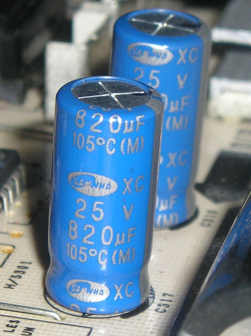

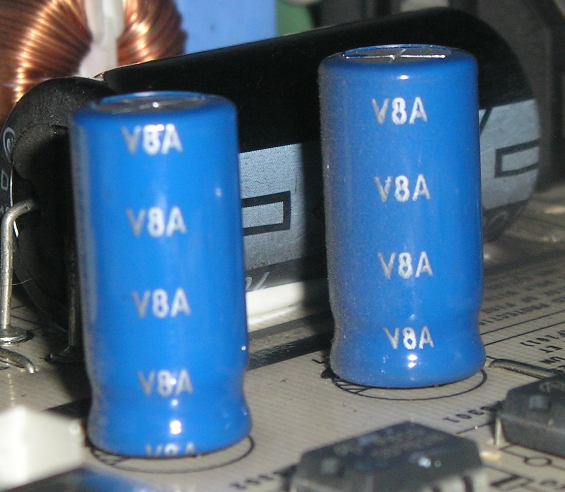

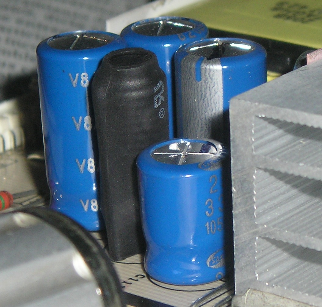

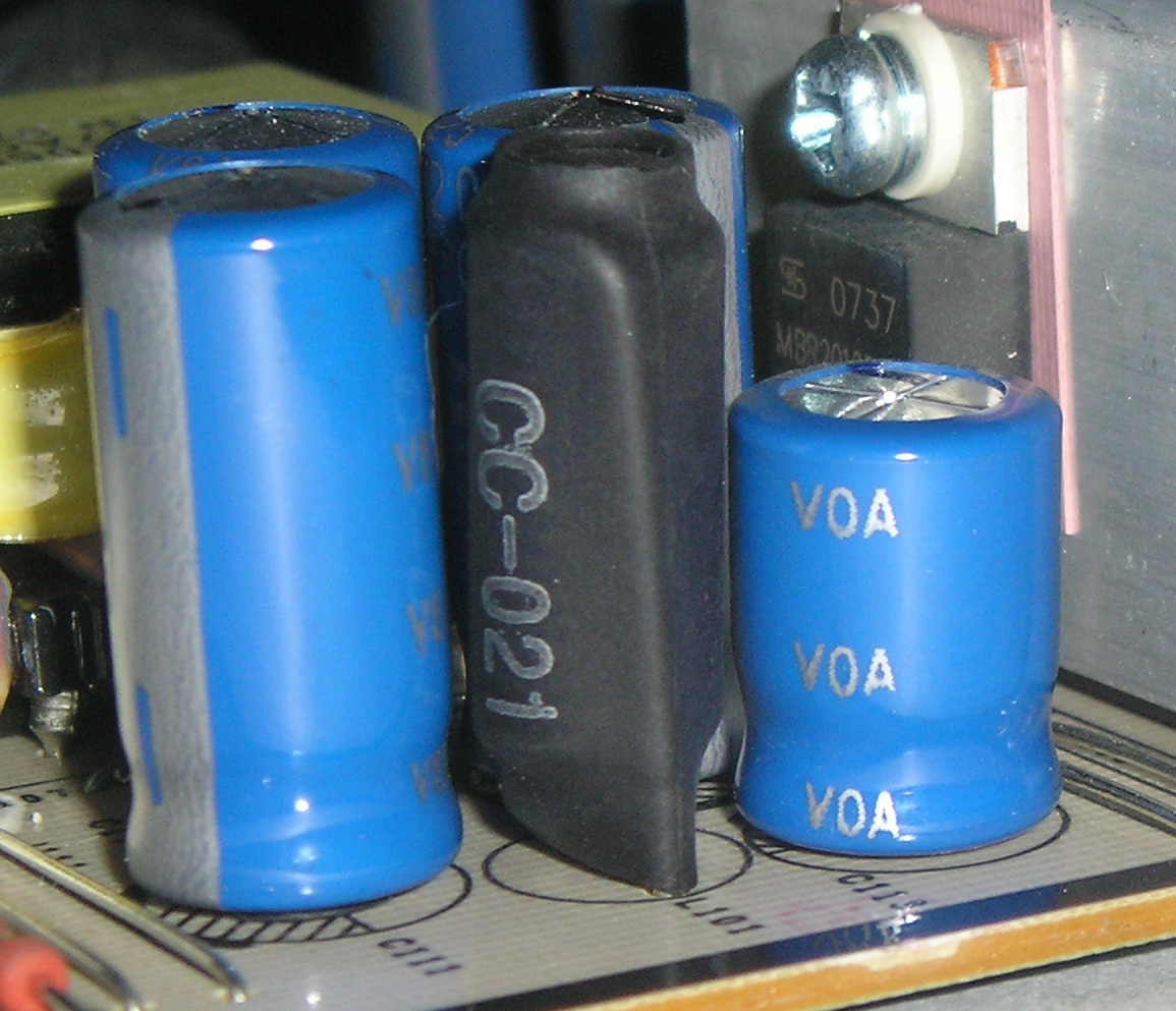

    Hello.
    I´m going to replace bad caps from a Syncmaster 226NW (same as 226BW but only VGA output). Caps are 5 x 820uf 25v (10x20 mm) and 1 x 330uf 25v (?x12 mm).
    Is it ok to replace them with these (ESR question involved) :
    820uf:
    https://www.badcaps.net/store/produc...roducts_id=151
    330uf:
    https://www.badcaps.net/store/produc...roducts_id=166
    or
    https://www.badcaps.net/store/produc...products_id=52
    Photos of bad caps following (front and back).
    Thanks in advance.

    I don't think anyone has found a datasheet for the Samwha XC caps. Given that, the choices you made look like good low ESR caps.
