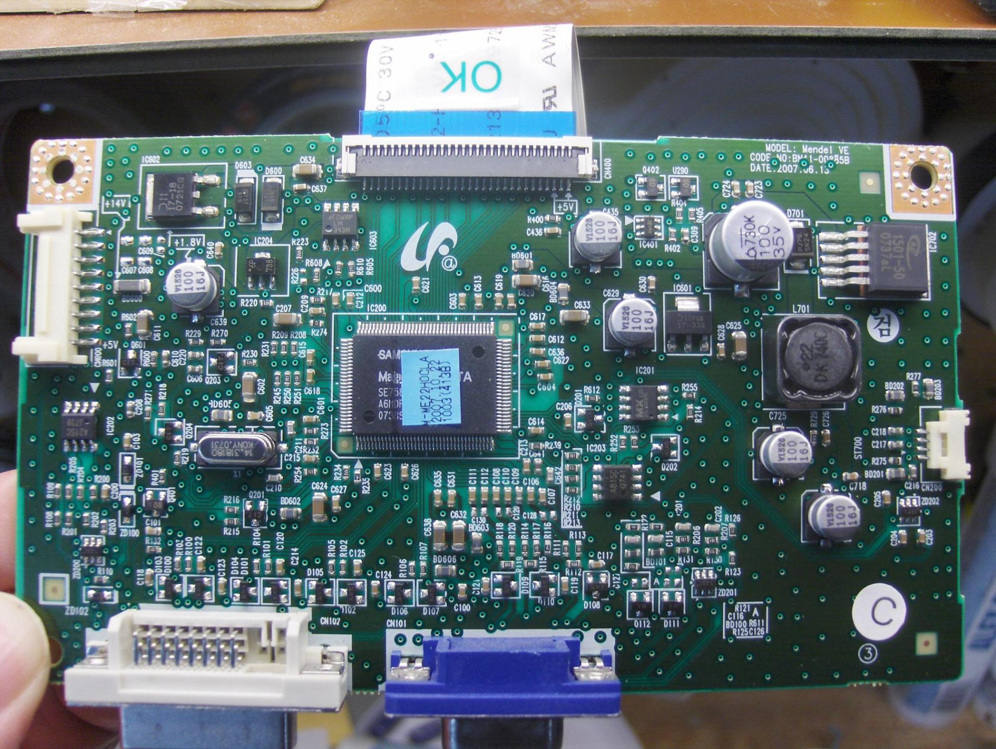

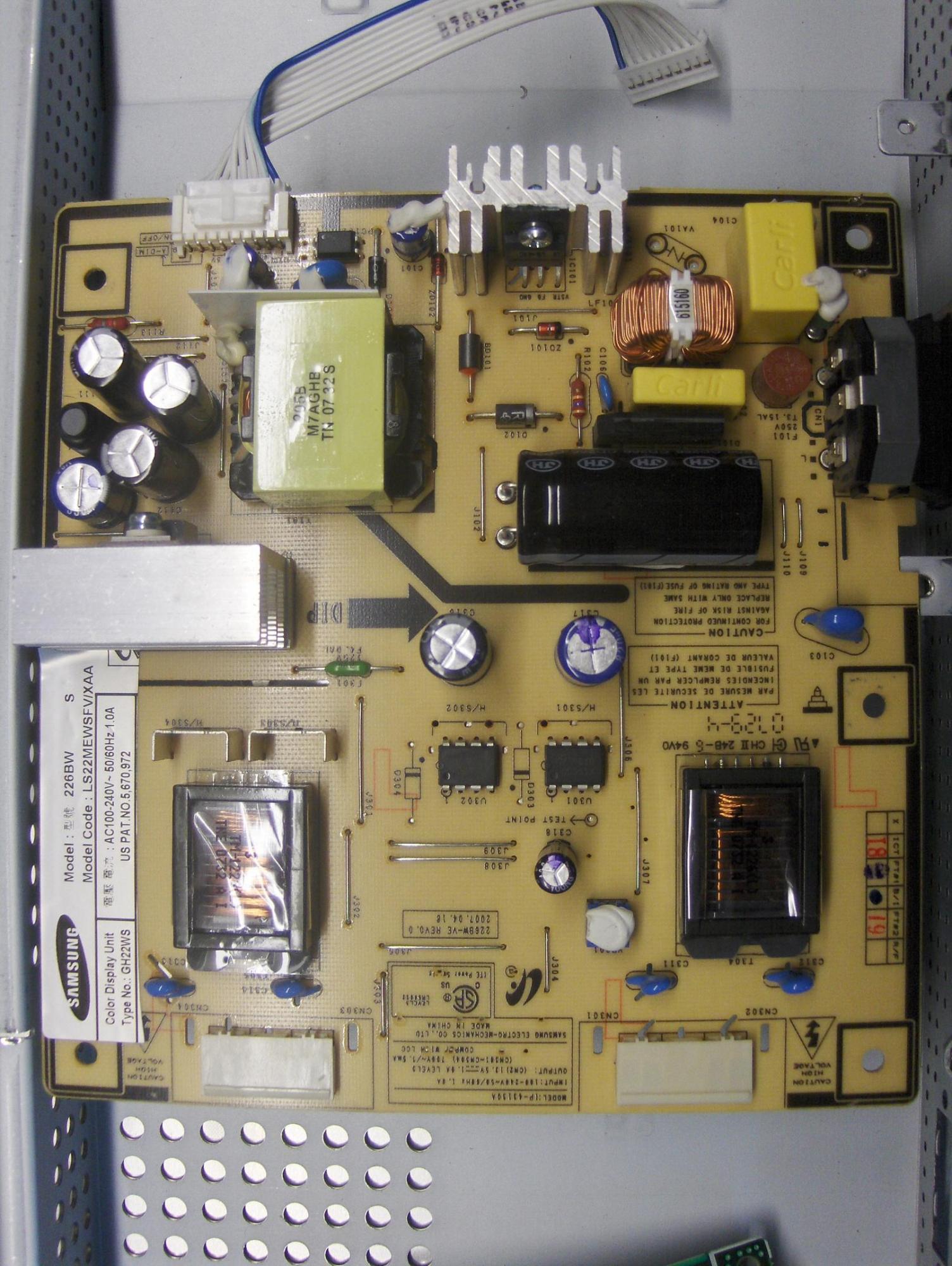

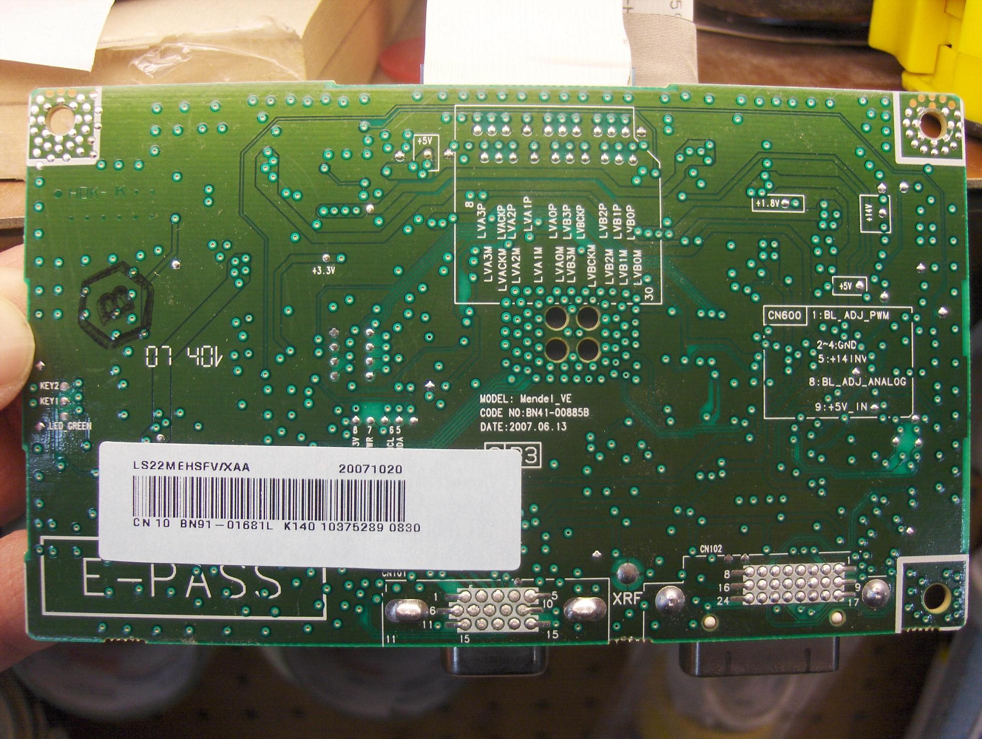

                Ok. Here I have taken pictures of both the PSU and the other board, back and front.<

                  I see a combination of Samyoung, Capxon, and a third brand I can't identify... You should start by replacing all the electrolytics and thus eliminate them as a possibility.

                    • retiredcaps
                      • Apr 2010
                      • 9271
                      Re: Samsung 226bw dead. No power
                      Those are excellent pics. It helps a lot when remote troubleshooting.
                      I also purchased a multimeter for the cause.
                      You will find it a handy tool not only for this project, but around the house use as well.
                      Be gentle, I have never used one of those devices before.
                      Can you post a picture of your new multimeter so we know what you are using?
                      I also suggest viewing this 4:36 video on a multimeter tutorial. View it once all the way through and then view it again and pay attention to the 1:00 to 1:55 mark.
                      http://www.youtube.com/watch?v=bF3OyQ3HwfU
                      Then practice measuring a 9volt or AA battery to make sure your multimeter is working correctly.
                      After that, then you can move onto the next post.

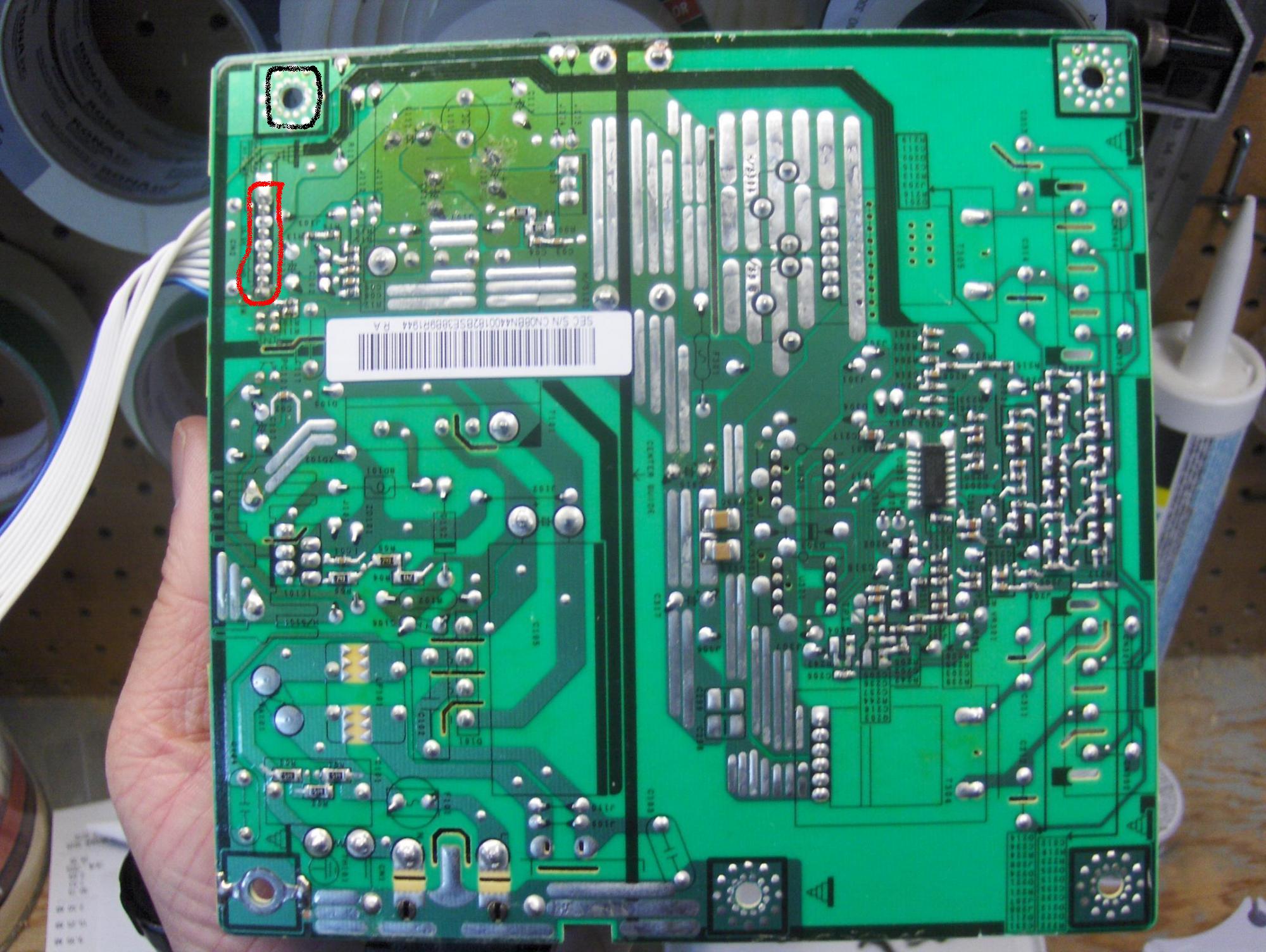

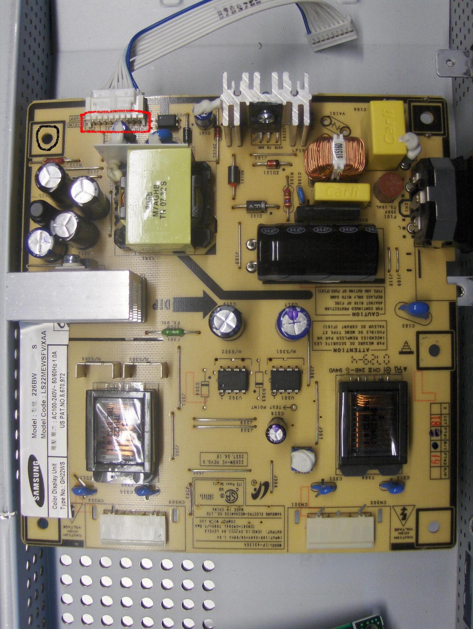

                        Part 1.
                        Okay, now let's verify that you are getting what is the called the secondary voltages on your power board. Let's measure your replacement board.
                        Look at the attached pictures for the power board (the yellow one). Depending on how the board is installed (facing up or down), put your black probe onto the ground screw (denoted by the black spray paint). Obviously, the screw has to be put back in so that the black probe can actually touch it.
                        This is your cold ground. You will leave this probe here for all your measurements. Now set your multimeter to 20 V DC (if manual ranging).
                        Put your red probe on each pin (denoted by the red spray paint), one at a time, and record the pin number, its legend value, and the multimeter reading. So we want it reported like
                        pin 1 - legend says 12 V - dmm reports 12 V
                        pin 2 - legend says 5 V - dmm reports 4.99 V
                        etc
                        Be CAREFUL not to touch 2 pins at the same otherwise you may short out the board.
                        Part 2.
                        Let's measure the voltage regulators on the logic board (green board). Again, your black probe will go onto the ground screw (denoted by the black spray paint) and be left there the entire time. This is your cold ground.
                        Put your multimeter on the 20 V DC scale.
                        Put your red probe on each pin for each IC circled in red. The top part (tab) does not need to be measured. For example, on IC 601, there are 3 pins. Measure each pin with the red probe. Report it like this
                        IC601 - part number 17-33G
                        pin 1 = 0 V
                        pin 2 = 5 V
                        pin 3 = 3.3 V
                        --- begin sig file ---
                        --- end sig file ---

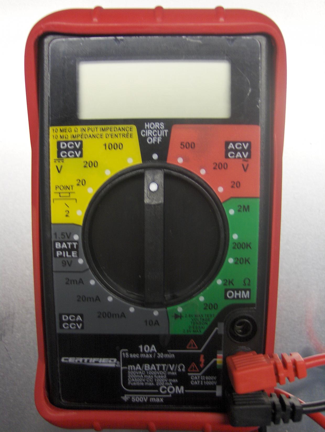

                          Here is a picture of my newly acquired multim. I will get to work tonight with the steps you have given me.
                          Thank you
                            Did you buy this from Canadian Tire? If yes, I hope you got it on sale. They usually have multimeters on sale for about 60 to 75% off on a bi-weekly to monthly basis.

                              Actually yes, got it from Canadian tire just this morning. It was 25$.

                                    Ok. Had the time to measure those tonight.
                                    On the power board :
                                    1 - on/off = 0
                                    2 - A-Dim = 0
                                    3 - 13.5V = 15.62
                                    4 - 13.5V = 15.62
                                    5 - 13.5v = 15.62
                                    6 - GND = 0
                                    7 - GND = 0
                                    8 - GND = 0
                                    9 - B-DIM = 0
                                    On the logic board : (since I dont have pin numbers, I will refer to #1 as closest to the top of the board (ribbon cable) or closest to left of the board (power cable in)
                                    Part IC602
                                    17-18
                                    #1 = 3.8
                                    #2 = --
                                    #3 = 0
                                    Part ic204
                                    6p738
                                    #1 = 5.19
                                    #2 = 0
                                    #3 = 5.19
                                    Part ic601
                                    17-33g
                                    #1 = 0
                                    #2 = 3.15
                                    #3 = 5.19
                                    Part #ic702
                                    1501-50
                                    #1 = 15.62
                                    #2 = 5.09
                                    #3 = 0
                                    #4 = 5.19
                                    #5 = 0
                                    Hopefully I did that correctly
                                    I will await further instructions.
                                    Thank you!
                                      1 - on/off = 0
                                      2 - A-Dim = 0
                                      3 - 13.5V = 15.62
                                      4 - 13.5V = 15.62
                                      5 - 13.5v = 15.62
                                      6 - GND = 0
                                      7 - GND = 0
                                      8 - GND = 0
                                      9 - B-DIM = 0
                                      Pins 3, 4, and 5 are a bit high, but that could be due to the inverter not drawing any power right now. Secondary voltages in lcd monitors may not be regulated and will fall to the specified voltages where there is a load present.
                                      Since you have secondary voltages, this implies that the power portion of the replacement board is working. We don't know about the inverter section yet because of below.
                                      Part IC602
                                      17-18
                                      #1 = 3.8
                                      #2 = --
                                      #3 = 0
                                      IC602, if the readings are correct, is bad. The suffix -18 denotes 1.8 V DC output. What is --?
                                      Part ic601
                                      17-33g
                                      #1 = 0
                                      #2 = 3.15
                                      #3 = 5.19
                                      IC601 is also bad as well. The -33 denotes 3.3 V DC. You measured 3.15 which is low. A voltage regulator should be +/- 1% tolerance.
                                      The two suspect parts above are widely available. You can try your local electronics store. Take the board with you and tell them you want replacements. The parts should be less than $1 each.
                                      The parts are also available through any online store like digikey, mouser, but the shipping costs to Canada is $8 USD. If you choose this route, consider what mockingbird said regarding the cap replacement as many local stores in Canada will not carry the proper low ESR caps (like Panasonic FM) that are required in a SMPS application.
                                      Alternatively, if you have any old unused or junk boards (sound card, etc), you may find a suitable replacement. Just look for the correct size and suffix (-18 and -33).
                                      You will also need a decent solder iron to remove those ICs. With my cheap "sort by lowest price" ebay solder iron, I cannot remove those types of component packages.
