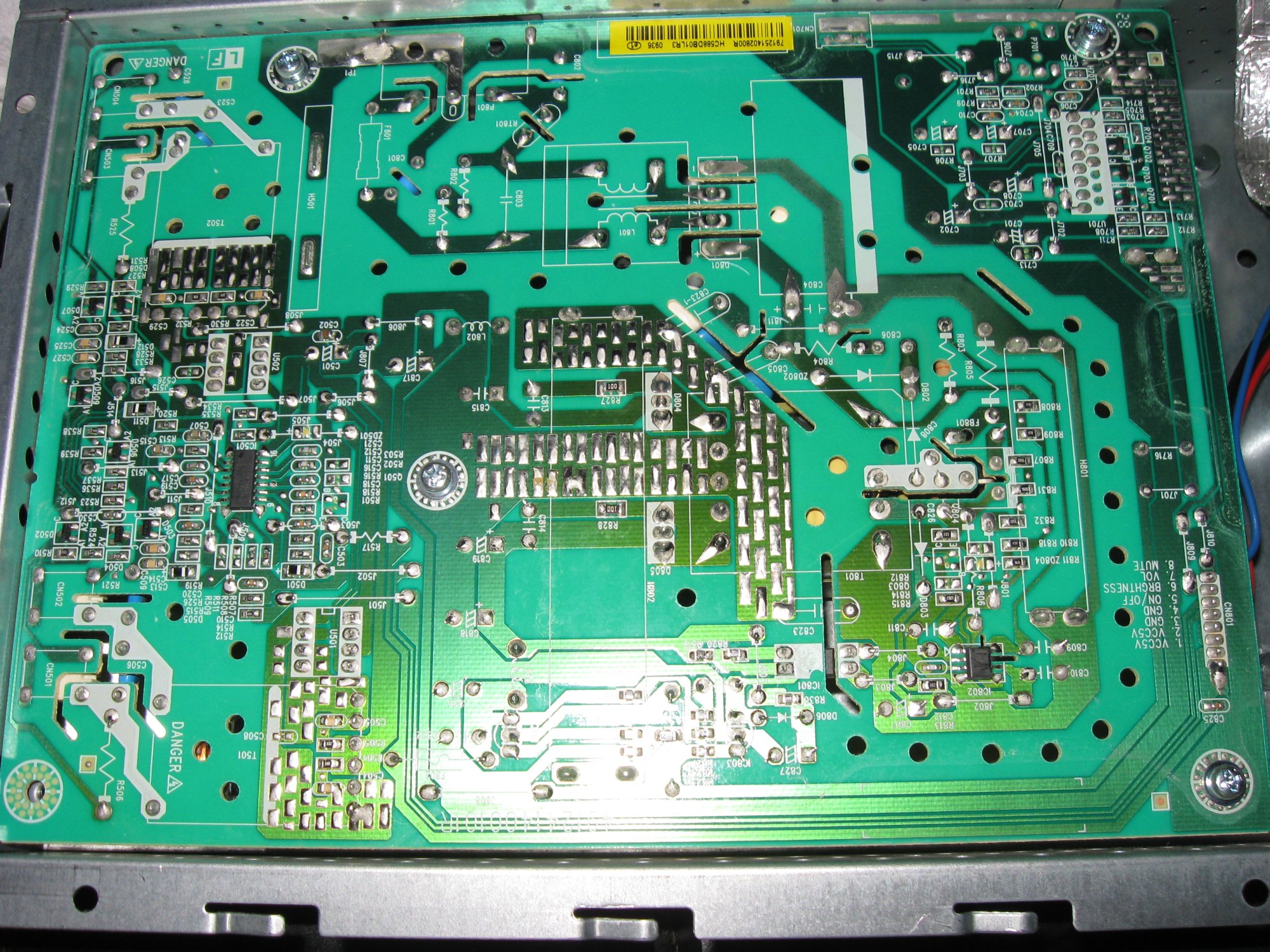

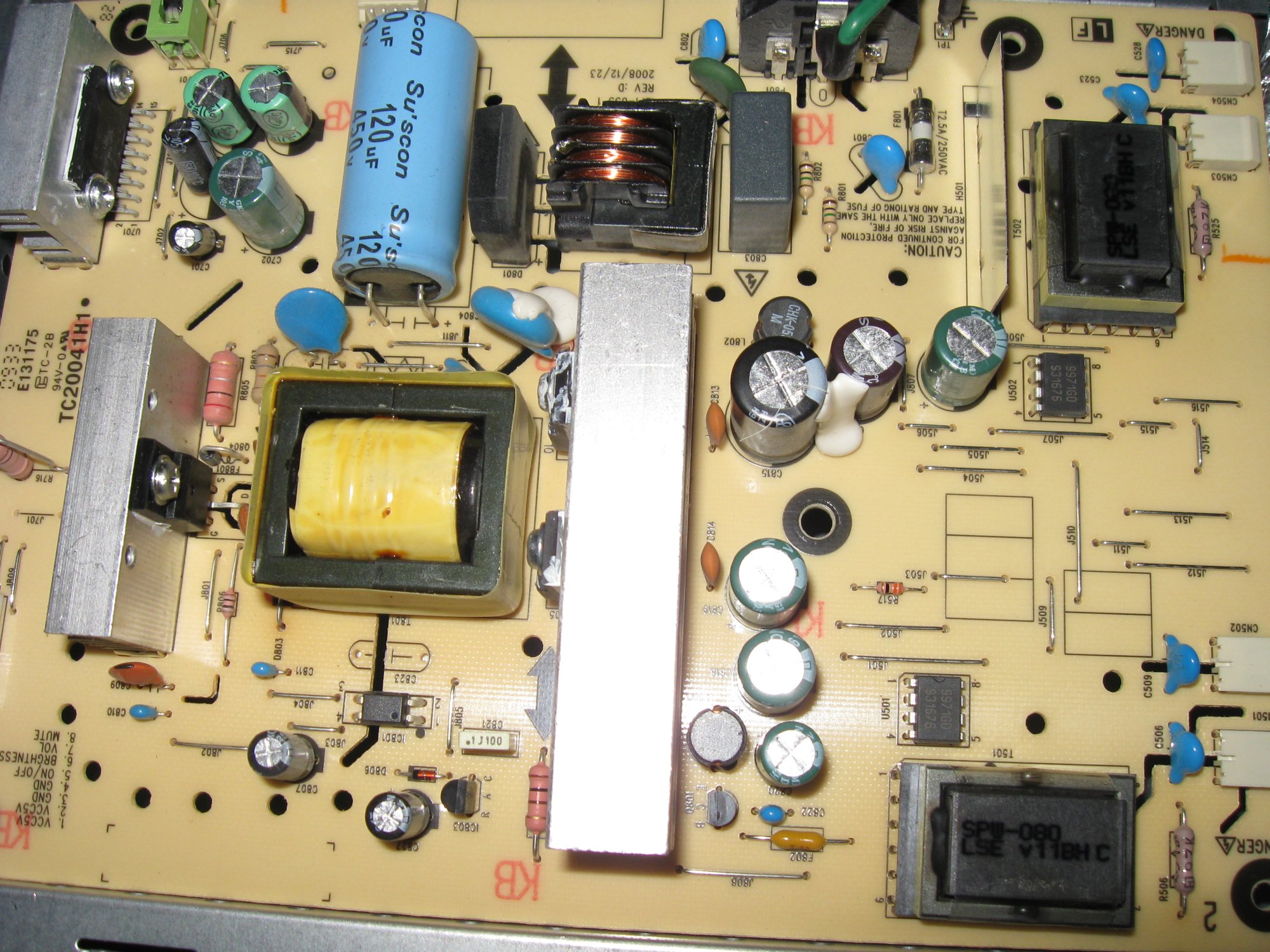

    The power supply looks OK... no capacitors swollen, nothing looking like it's burned or smoked. Capacitors are a mix of Suscon, Lelon and probably another brand as well but they all look ok visually as i said.
    Voltage output is 5V, tested with a multimeter and showed 5.2v - when led turns orange it changes periodically between 5v and about 3.7v (but maybe i also wasn't holding the probes very fixed)

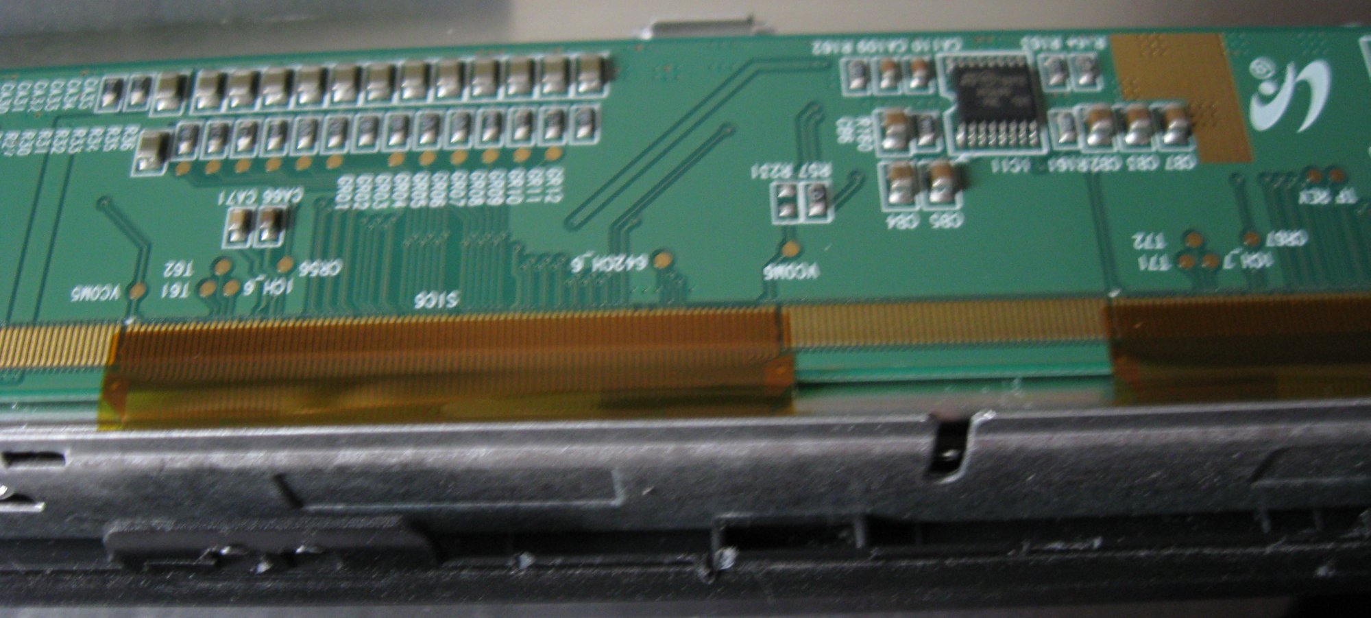

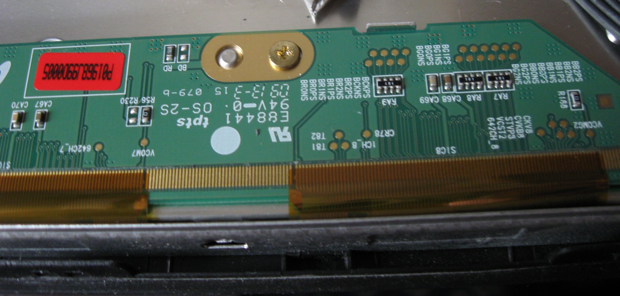

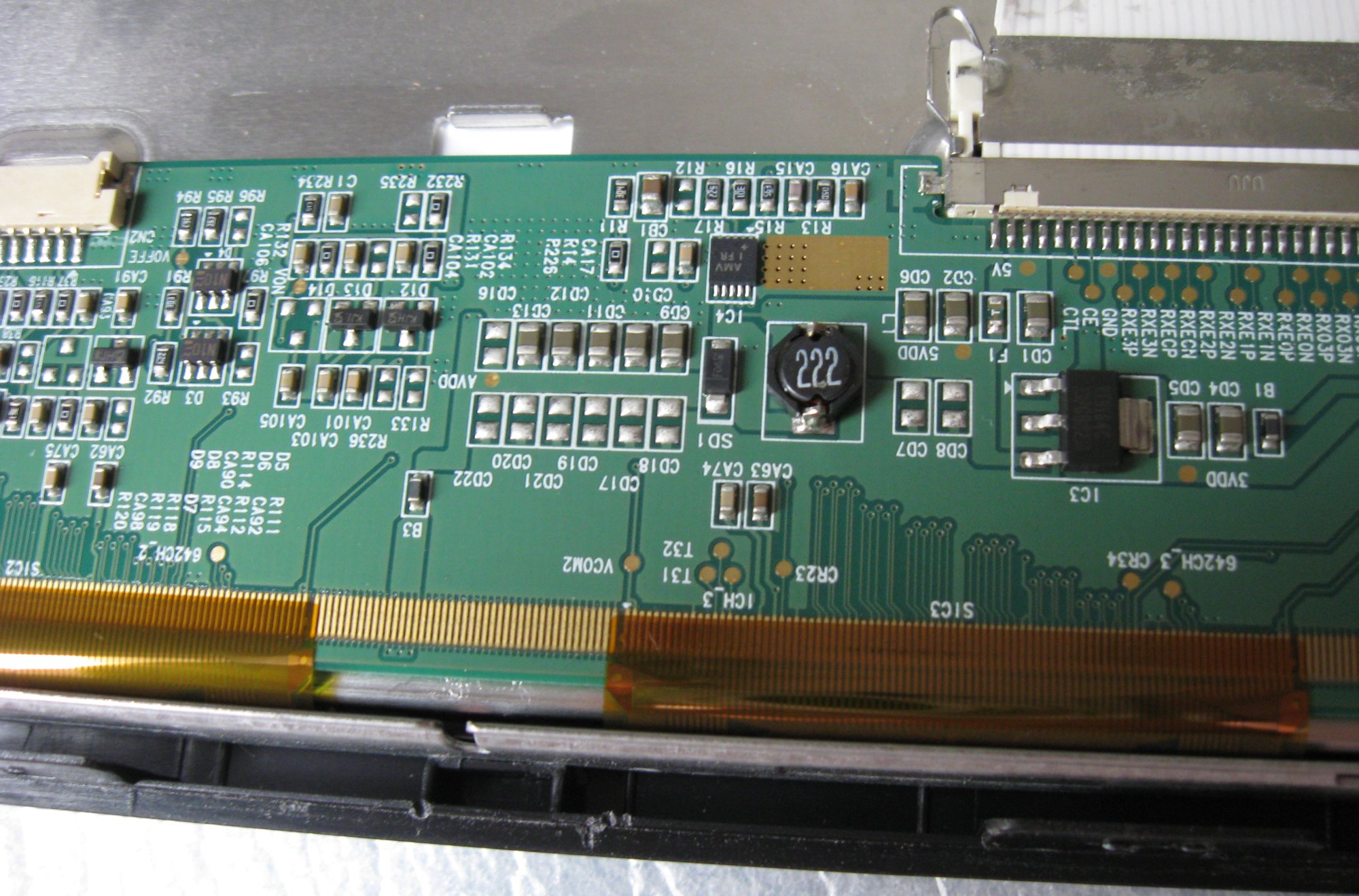

    Gray or white screen without colored lines is usually related to t-con issues - either LVDS cable is loose or a shorted ceramic capacitor on the t-con.
    Since you do get colored lines with the gray screen, a bad t-con may or may not be the issue in your case.
    Either way, check the fuse on the t-con board as well as the main boosted voltage rail (usually labeled as AVDD). If the fuse is good or AVDD shows more than 30 Ohm to ground, it should be okay.
    Checking these two items is not a definite answer to whether the t-con is bad or not, but those are usually the two most common issues I've seen on t-cons and they are very easy to check with a multimeter.
    In case you can't find it, main boosted voltage rail should be wired to the cathode of a diode which usually sits next to or close to a SMT inductor.

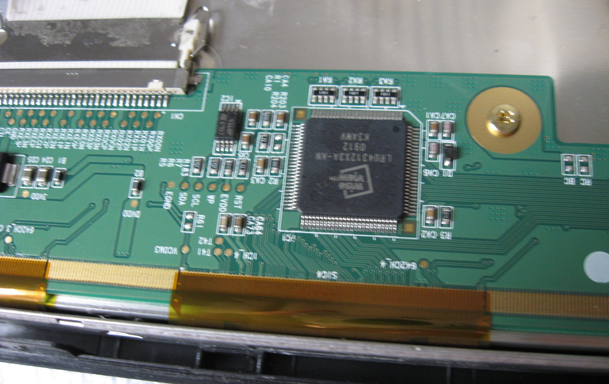

      I'm also attaching pictures of the board attached to the lcd panel, if there's anything I can check with a multimeter on that one please let me know.

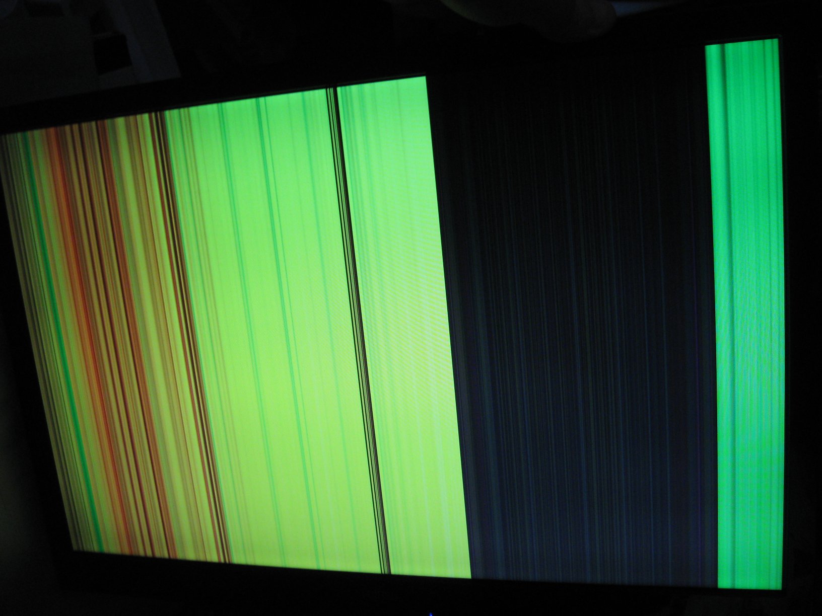

          Ok, this is interesting.
          I put it back together. Tested a second computer's dvi output , powered it and it remained on showing the picture in the attachment.
          Pulled out the dvi, connected vga cable on same card and it went in stand by (i guess, the orange led). I think this is normal because the video card isn't smart enough to switch outputs while running.
          Turned off the PC, took out the dvi cable and left only vga, monitor stayed on and showed the same picture.
          It shows up after a while, which seems to be consistent with the number of seconds the PC needs to finish with the text modes and show the classic windows wallpaper.
          The monitor also turned to black after a few minutes (without led going orange), again after about the time it takes to stay on Windows login screen to get the screen saving feature.
          Next step, going to connect it to the computer I'm actually typing from which has a card that can do 2 x dvi outputs - connecting it as a second monitor I'll be able to see if the resolution and all that is detected properly. Going to edit my post and add the info asap.
          PS. Monitor properly detected on this computer, not showing the same picture but all light gray (probably the plain light blue I had as background for the second monitor), when moving a window about 720x576 in size across what should be the second monitor I see a basically that area getting darker but can't distinguish anything resembling that window's content.

            Check the output of the regulators on the logic board. If you see any fluctuating, replace its output capacitor. I've had a bad cap after the 1.8v regulator cause this kind of picture.

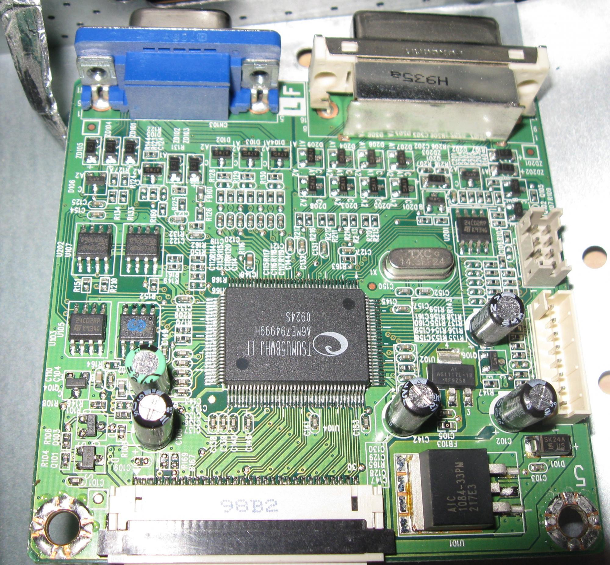

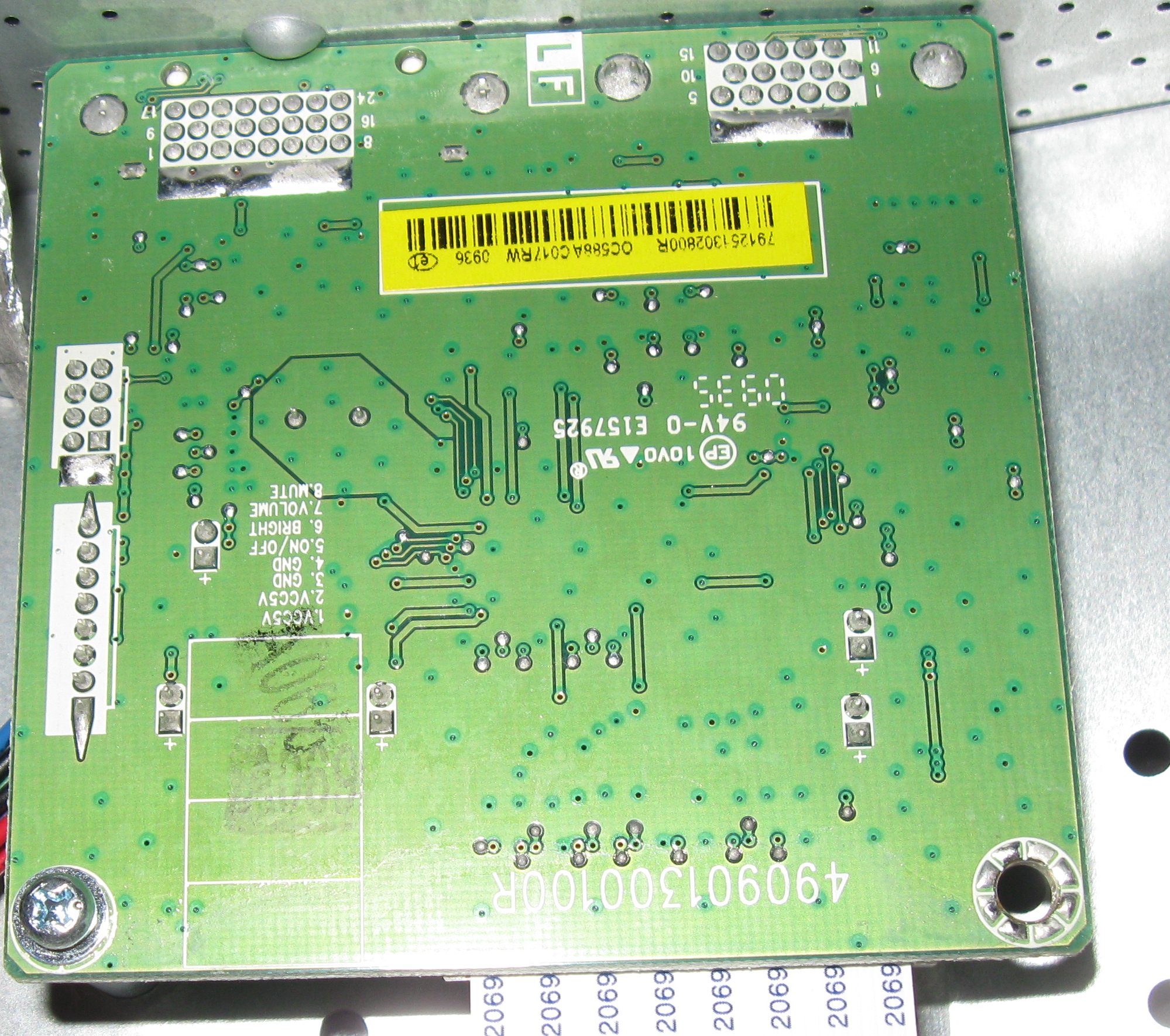

                  I'm currently working on a "Belinea O.Display 2 22 Wide", which seems to be identical to a Viewsonic and several noname (Yusmart/Yüsmart, Novita) 22" LCDs.
                  Mine has a blinking power LED and nothing else works. PSU/Inverter board is OK.
                  The other threads I've found had problems with garbage on the screen (sound familiar?) or the monitor simply being completely dead.
                  There's one thing all of them (including your Fujitsu-Siemens and my Belinea) have in common: The TSUMU58WHJ-LF controller IC.
                  I'd say that's the prime suspect here and probably not possible to fix unless you can get a working controller board from somewhere
