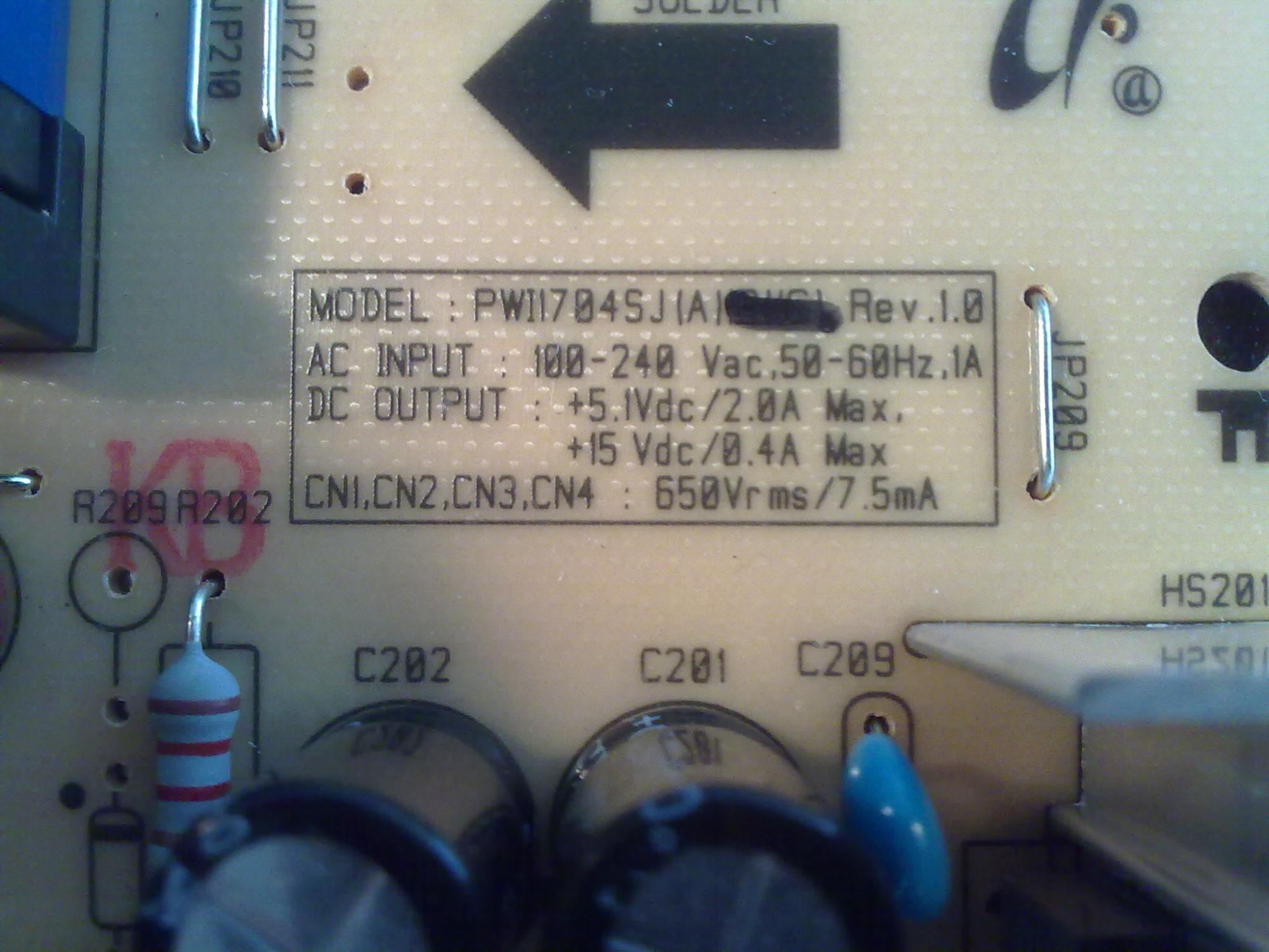

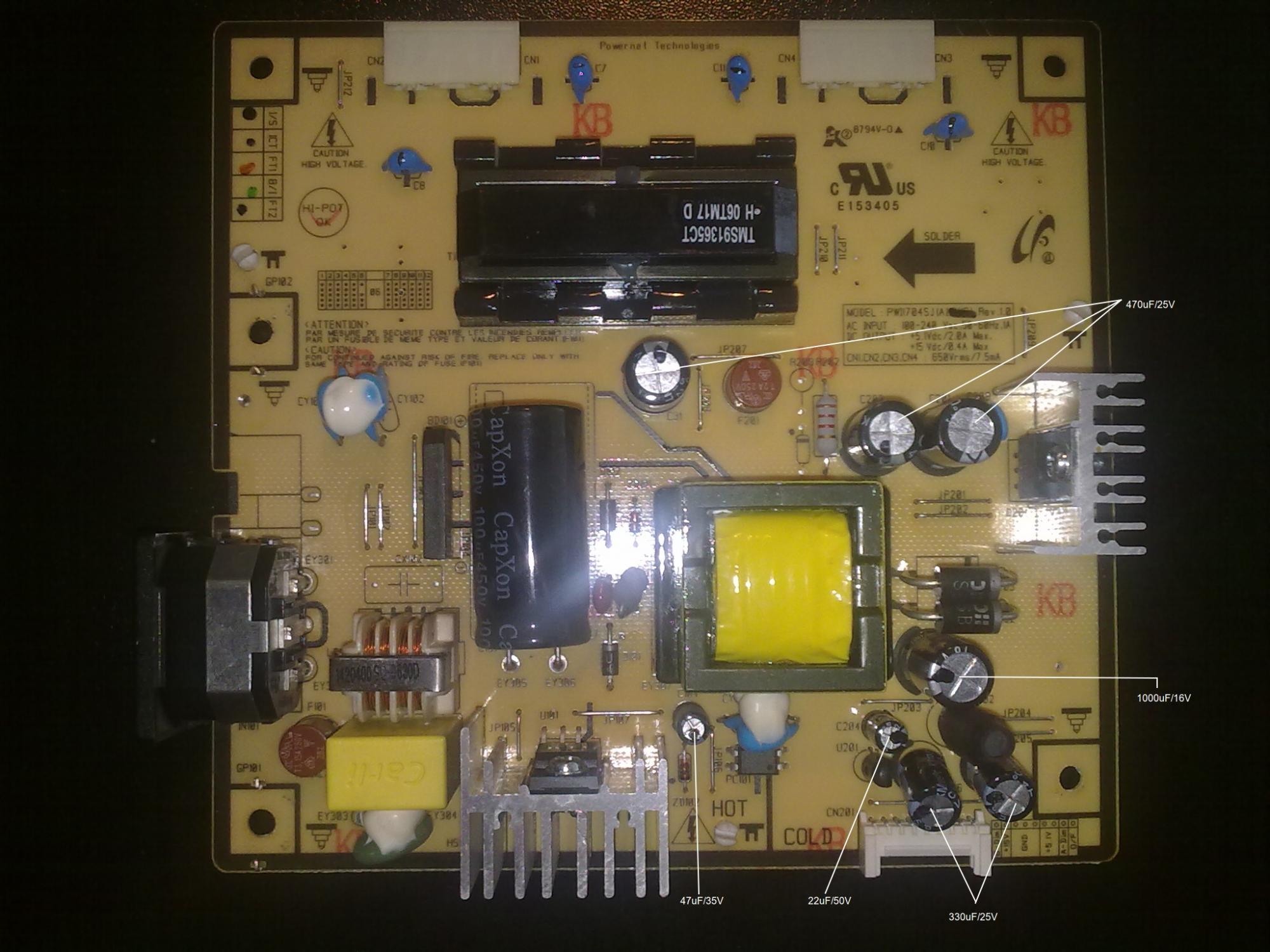

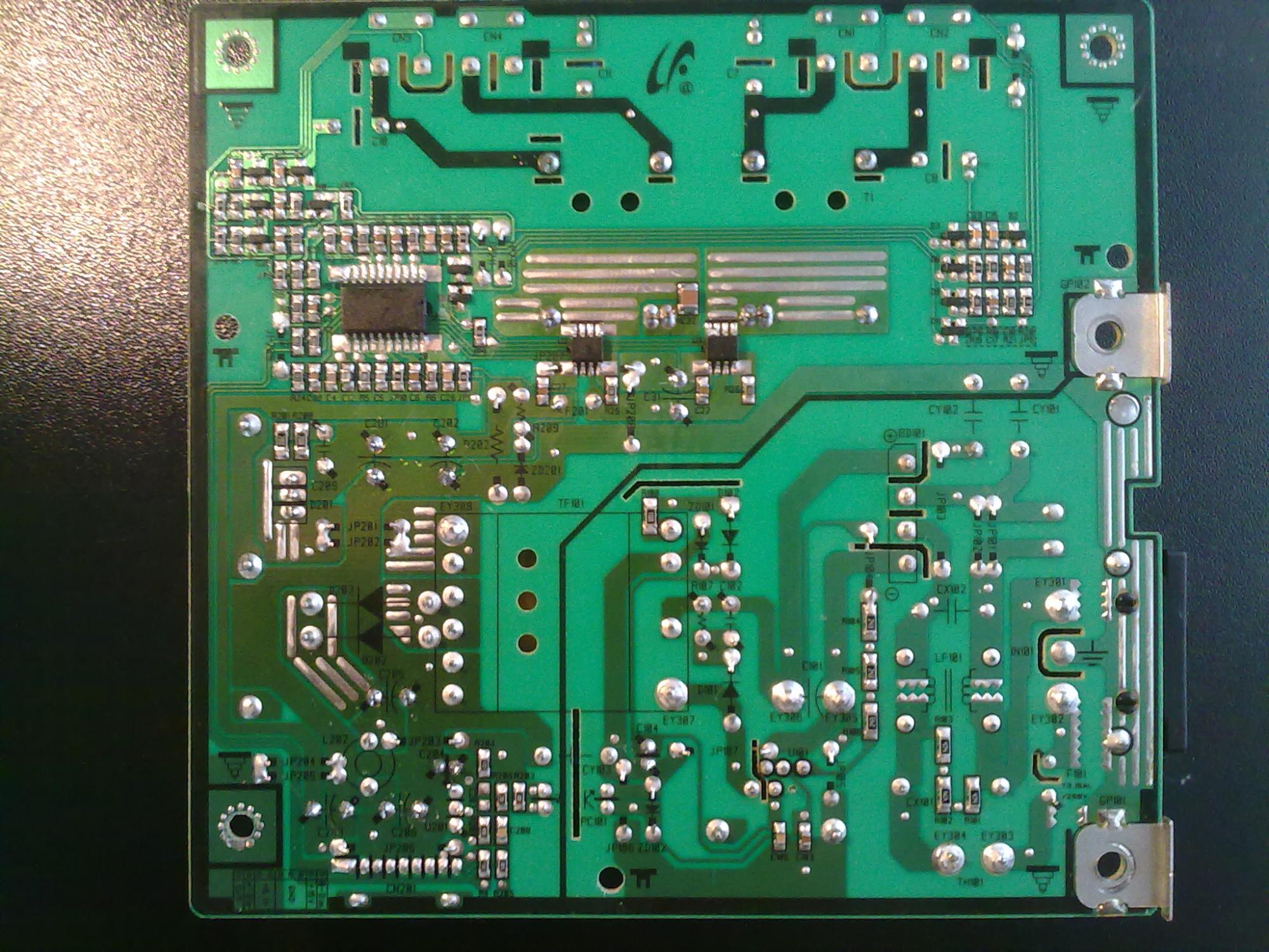

    Hello.
    So my 931BF has the typical "two seconds to black" problem. On a rare ocassion, the backlight will stay on if i power cycle it alot of times, but this takes time and there's a scary buzzing sound coming from inside the monitor and the backlight flickers. Every time i turn it on, the inverter transformer makes a really weird short noise that resembles the sound of a moving laser inside a cdrom. This short noise from the inverter is always heard, even if i disconnect the CCFL's. There's also some constant hiss coming from the yellow transformer. So far i have tried blindly replacing all the caps and the inverter transformer. The problem persists. The original caps were C(r)apXon's. Almost all the caps are replaced with new ones except the 22uf/50V which i salvaged from an old but perfectly working stereo. Also, one 330uf/25V cap is left unchanged since i didn't have enough caps. I did try replacing it with a new 470uf/25V but it didn't make a difference. The biggest cap is also left unchanged. I also blindly replaced the inverter transformer with a new one bought on ebay. I ran continuity tests on the F101 and F202 fuses, the are both closed. I have very little EE knowledge and experience but i can use a solder and i do have a DMM. I never measured anything on a powered on circuit.
    I don't know what to do next so any advice is very appreciated.

    Re: Samsung 931BF, the infamous "two seconds to black" problem.
    That it stays on once in a while could still be a capacitor problem. Were the replacements low ESR? It could also be a CCFL going bad, which may not be practical to fix.
    The 22uF from a stereo would have a different problem. It's probably only rated for 85 degrees C, not 105.
      Is the big capacitor swollen in the second picture or is it just my eyes playing tricks?
      Just yesterday someone was complaining his monitor was buzzing and it turned out his big capacitor was swollen as well.
        Considering it's the exact same type of cap, it's likely. It could just be glue tho, can't tell from this angle... but if the big cap is bloated, here's your replacement: http://search.digikey.com/scripts/Dk...me=565-1481-ND

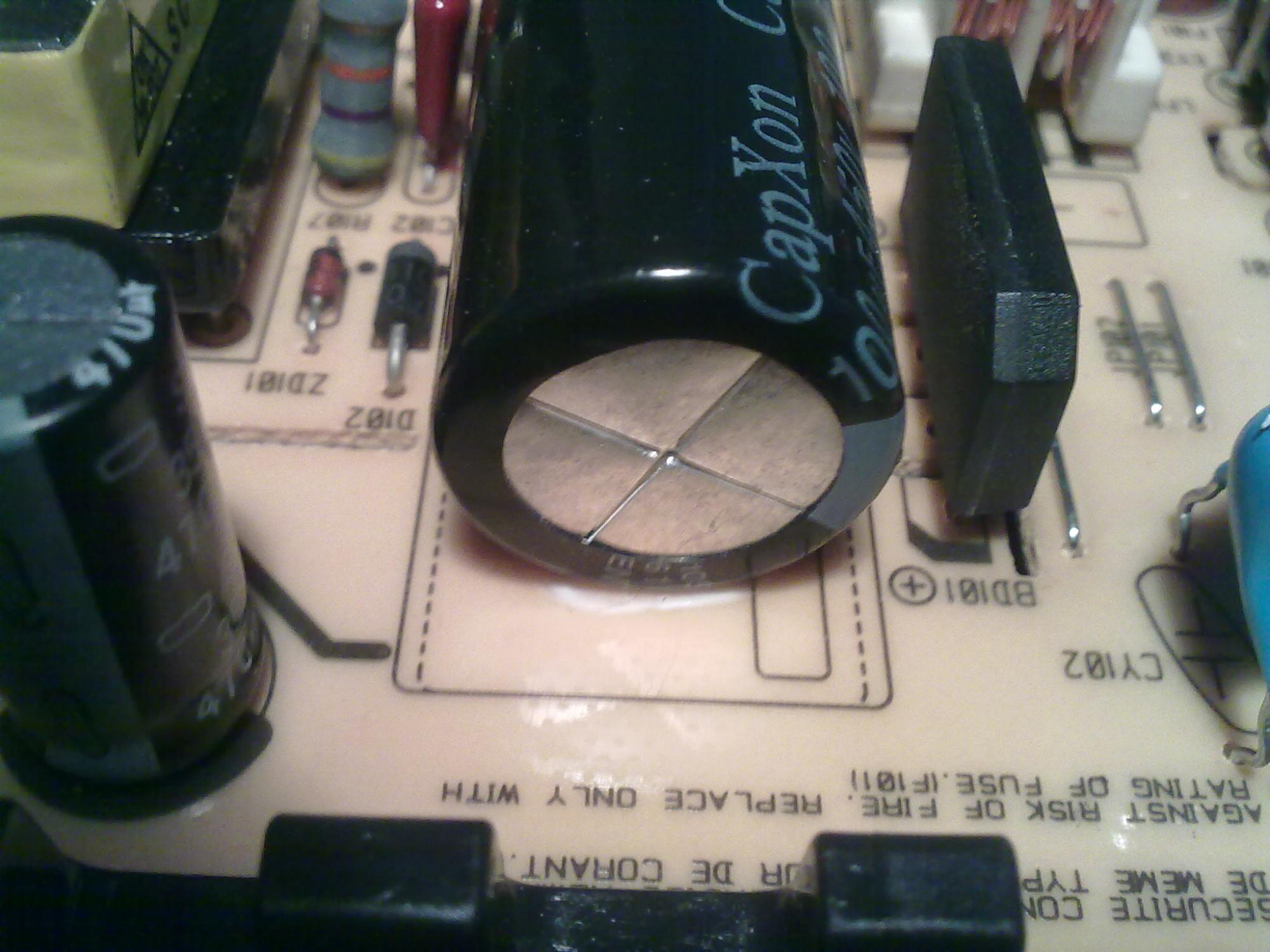

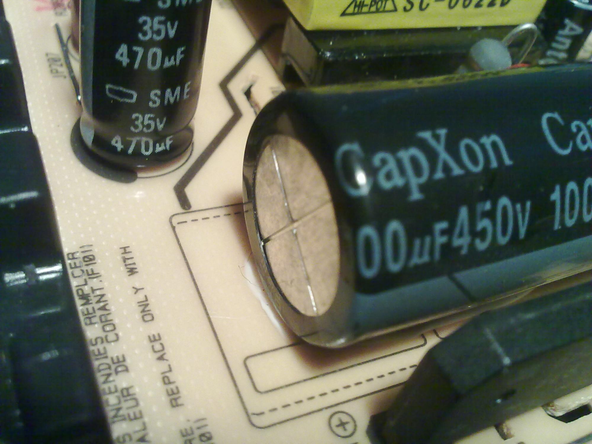

          Here are more pictures of the big cap.
          http://img203.imagevenue.com/img.php..._122_545lo.jpg
          http://img296.imagevenue.com/img.php..._122_171lo.jpg
          The replacement caps mostly came from a lcd repair kit bought on ebay. I accidentally ordered the wrong kit so i only half of them were usable on my power supply. These are Luxon and Nichicon branded. I got the missing ones from a local electronic repair guy. These are KSC branded. And yes, the 22uf is rated for 85 degrees.
            Well, it isn't swollen. But only an ESR meter will really tell if it's still working.
            Luxon... not a good brand. Never heard of KSC, might or might not be a problem. It's the low ESR that's important.
            The last picture shows a United Chemicon (I think) SME series, which is 85 degree and not low ESR, either. The label looks weird. Counterfeit?
            The 22uF is probably a startup cap, it can cause this problem. Use something good, like this or this.

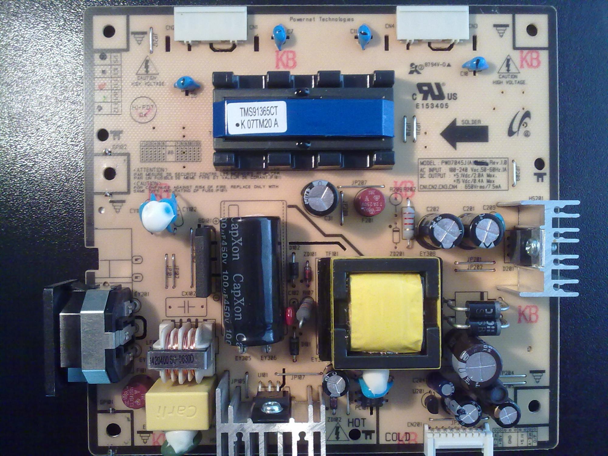

                  Ok, things just got weird. I replaced two 470uf KSC capacitors with original CapXon ones since i can't find specs for the KSC capacitors (KSC == KINGSUN ELECTRONIC). And the backlight came to life. It works, there's no backlight flicker, but there's a nasty, very irritating hiss coming from the power supply. The weirdest thing is that it only works if i remove this aluminum plate. Here's a picture.
                  http://img186.imagevenue.com/img.php..._122_499lo.jpg
                  Original capacitor set is a mixture of capXon KF and KM series.
                  Right now, 47uf, 22uf, 1000uf and a single 470uf are replaced and the rest of them are original capXon ones. The replaced 470uf is rated as low esr and is currently replaced with a KSC cap.
                    A power supply operating on the edge can behave in many funny ways. My recommendation is to replace all C(r)apxon capacitors with good quality ones like Rubycon, Samxon or Nichicon. The capacitors you have bought are obviously not adequate.
                            My apologies for my choice of the image hoster. I am not aware of the ads since Adblock blocks almost all of them. I will reupload the pictures.
                            I have also noticed that the lower part of the lcd panel is dimmer than the upper part.
                              Those are excellent pictures (OK, the first one suffers from camera glare). I hope to be able to read component identifiers; on these I can almost read the resistor's values!!
                              I'll confirm what others are saying. The best approach is to use name brand low ESR caps. In particular, the small (22-100uF) caps can cause weird behavior.
                              If you still have 'two seconds to black' after replacing the caps, the most likely cause is is the CCFLs or the wiring to the CCFLs.
