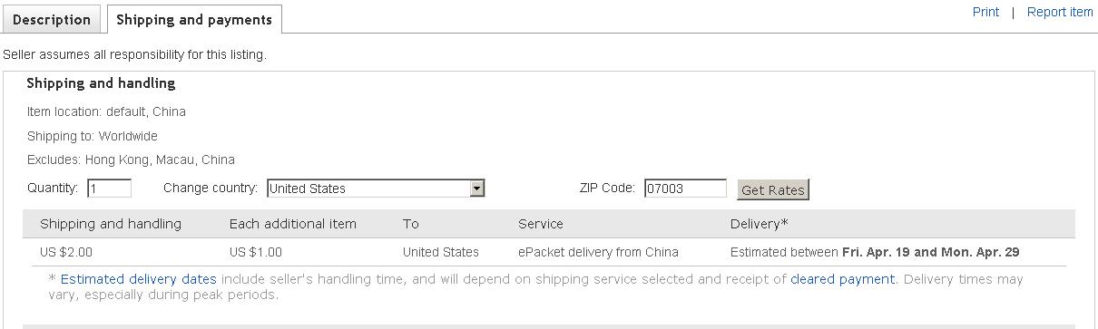

      Found one even cheaper. It is $2.85 + free shipping. The one that you found has a shipping cost of $2.00 USD.

          Since I'm using ebay.com, it sets my default country to USA. Shipping to USA is $2.00 for some reason. Shipping to Canada and Czech Republic is free.
          I guess the seller wants a few more $$$ from the Americans.
