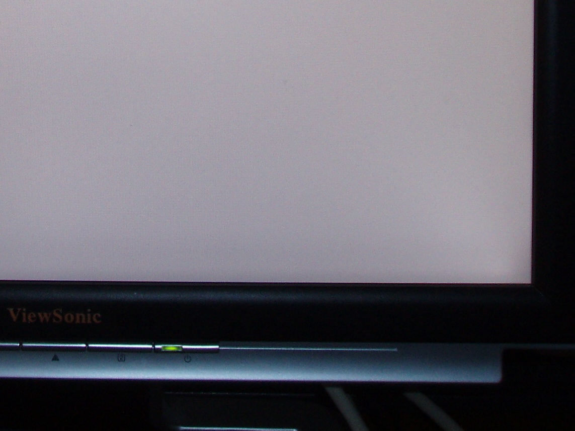

    Purchased repair kit and replaced all of the suspect caps. All looked good, reconnected and now just a white screen, no color but the green light does stay on. I tried but the DVI and the standard connector but no luck, just a plain white screen. No menus or anything.

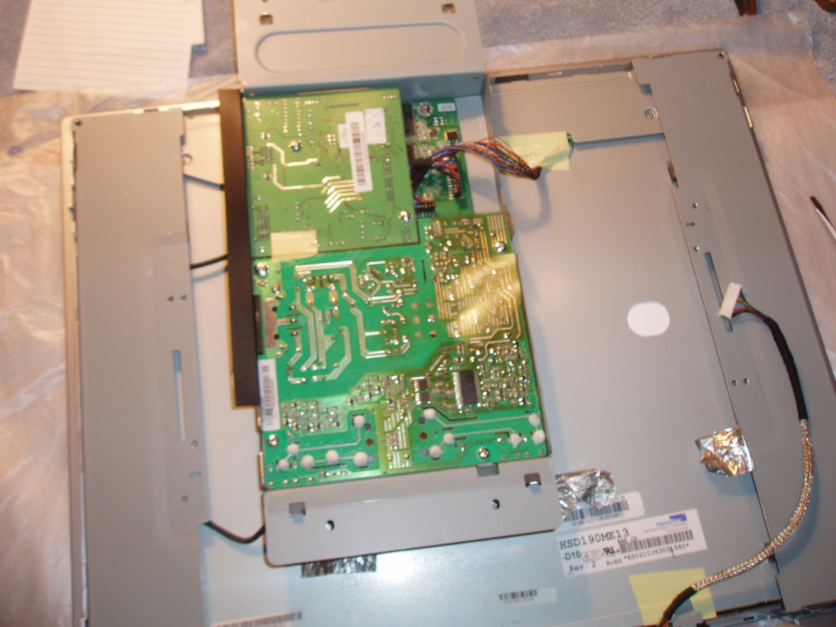

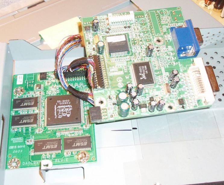

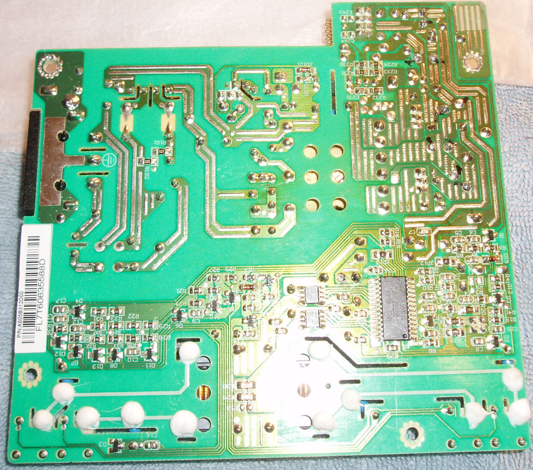

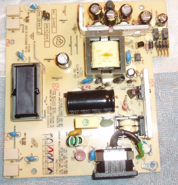

      I hope the pics are good enough, let me know if there is something else. PS - I didn't find any small fuses when I looked. I did not pull the black tape off

        On the third picture, near the top. There is a bundle of twisted pair wires going under a piece of yellow tape. That cable is going to the panel card. Check carefully, this is more complex than the usual setup. You may have pulled something loose.
