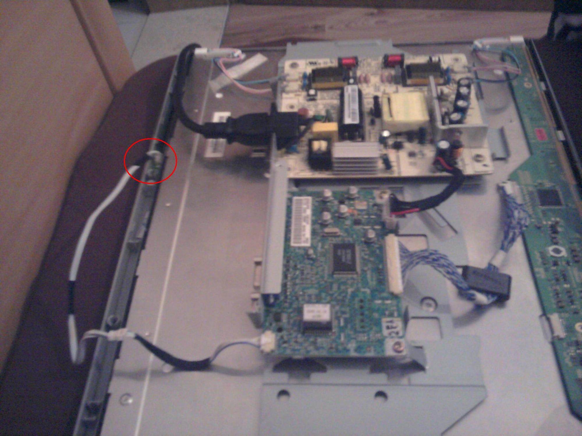

                  • SmartVision
                    • Jun 2011
                    • 58
                    #29
                    Re: Samsung Syncmaster 713N
                    Ok I did that (see the picture to know if we meant the same).
                    But there is something weird , in my first video I posted , when I turned monitor on it went from white to blue and to black.
                    Now it went from white to blue then some weird lines blinked and then it went to black.There is some difference now and before but I dont know does it mean anything ? You can see the new video.

                      #30
                      Not sure what the change on the video means .
                      No that is not the lvds cable it is the one that goes to the board attached to the panel/screen with lots of wires (Look mainly Blue& white?) in it. Checking for broken pins.
                      Something I dont think you have done since replacing the transistors is to test the output voltages from the power board (the socket with the black and red cable). These need checking with it all switched on and connected up.
